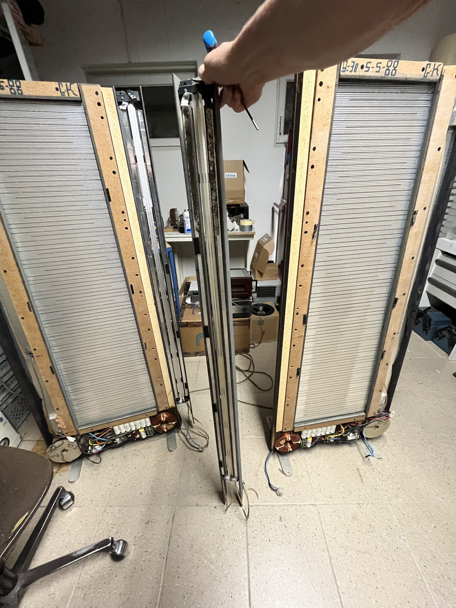

Correct on the bass panel. The speaker are wired and verified to be configured for one ohm operation.From the picture Carlton these look like the 4 ohm version bass panels.
are you using the purifi amps to drive these at the 1 ohm strapping or the 4 ohm ?
Most of the class D amps spec 2 ohm ps limit so want to know any issues if you are driving them at
the 1 ohm setting
I thought the 1 ohm vs 4 ohm bass panel was determined by the physical structure of the panels ?Correct on the bass panel. The speaker are wired and verified to be configured for one ohm operation.
The 1///4 bass panel has the option to connect in series or parallel. Series configuration for 4 ohm versus parallel 1 ohm. Later versions were strictly 1 only with wider traces.

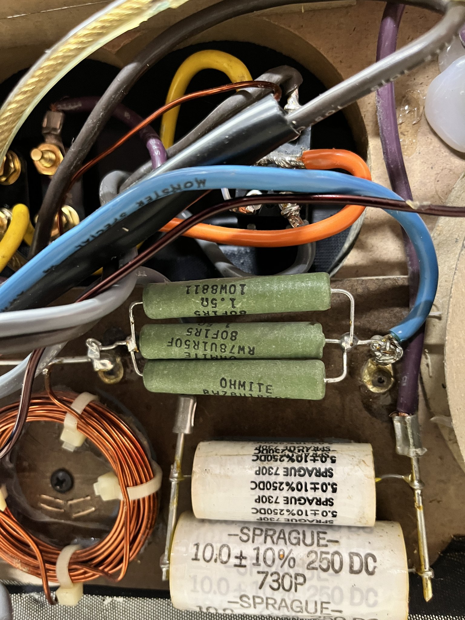

Hi AVWERK,
Question:
I'm currently refurbishing a set of Apogee Duetta Signatures with lots of help from Rob Dingen. They are performing very well now after repairing the bass panels and replacement of the tweeters.

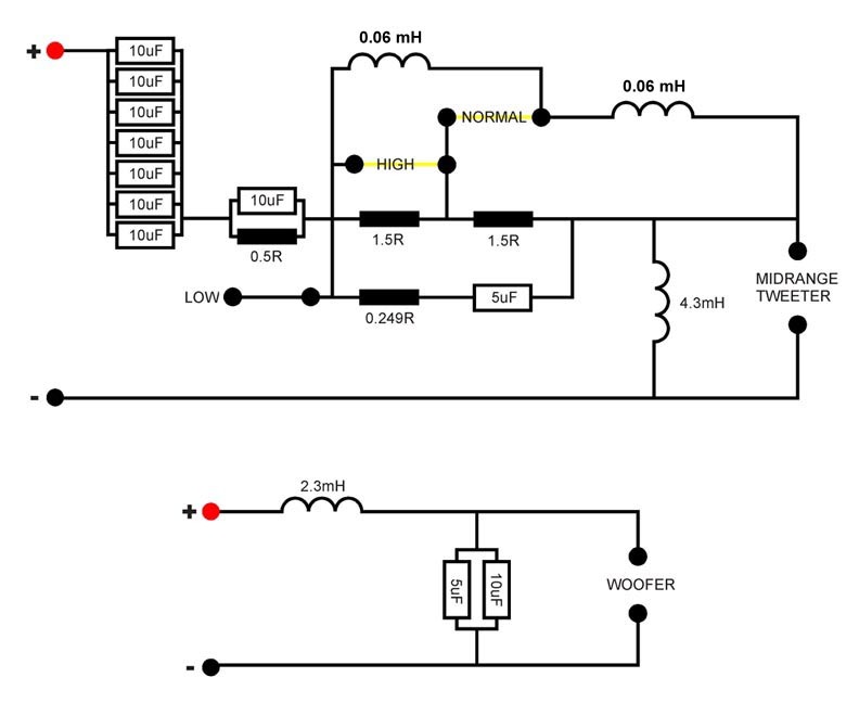

I've encountered a loose wire connected to the tweeter filter, it's connected to a series resistor and the other end of the resistor is connected to the ground rail of the tweeter filter. see attached pictures. I can't find this connection in the schematic, I was able to reverse all the modifications introduced by the former owner except this wire connection. I do see a similar resistor and wire in the picture shared in the thread about the Duetta bass panels above in the specific picture it's impossible to see the connection. Can you please tell me where this wire is connected in your apogee duetta?
Question:

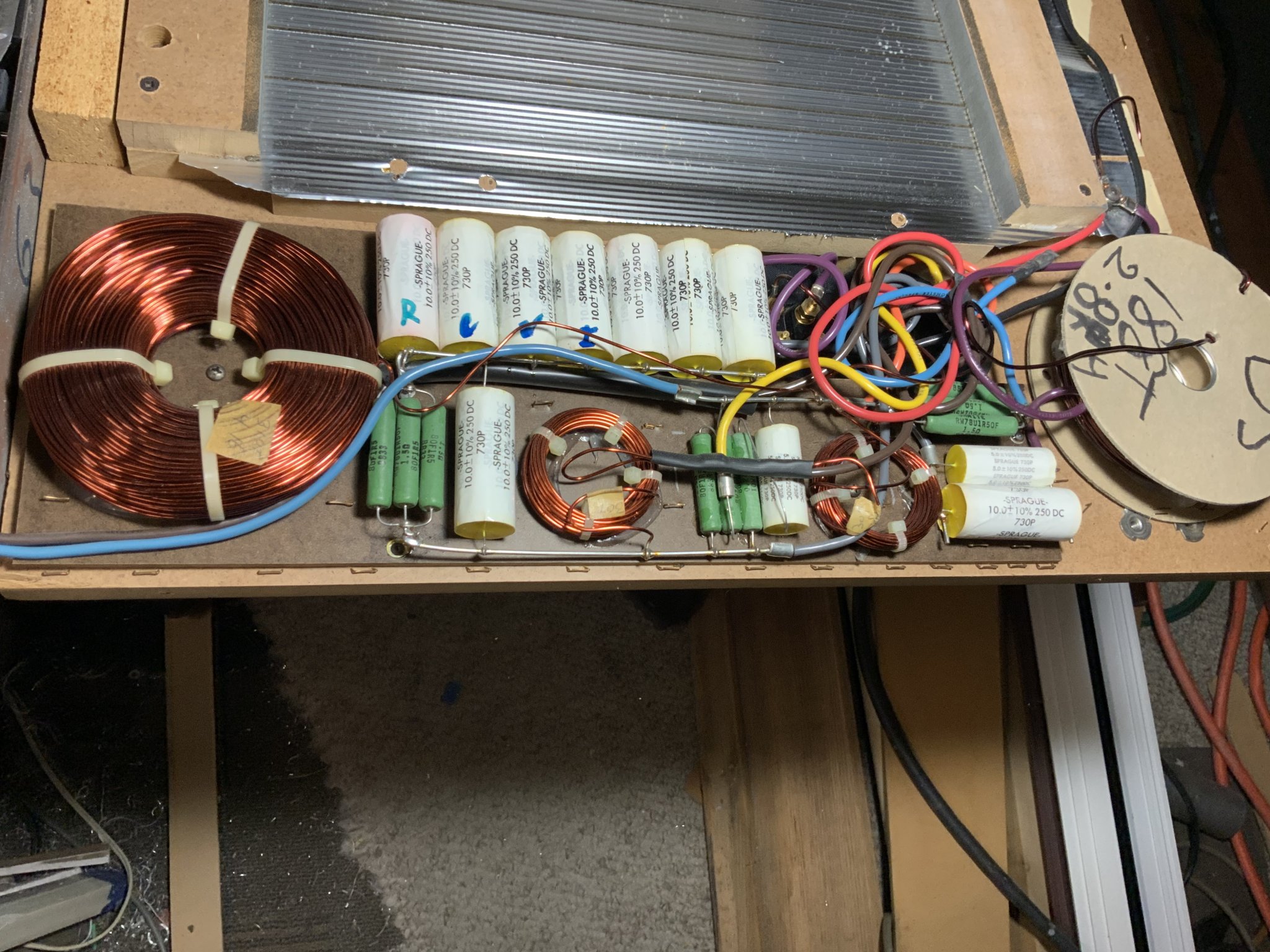

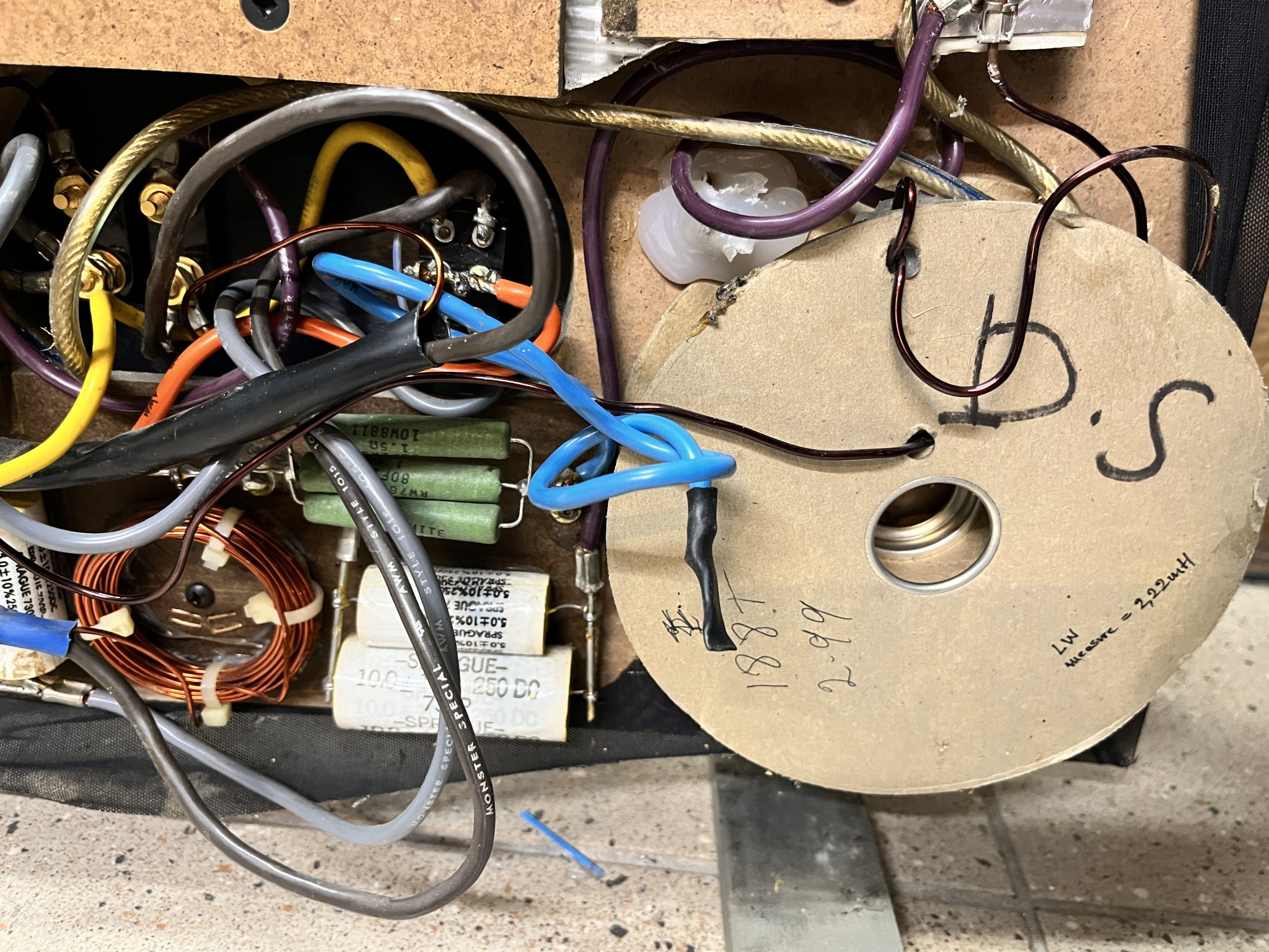

Based on a hunch here, I see non-standard apogee speaker cable in the mix (the clear stuff) so maybe the previous owner simply swapped for a different cable for some reason and used heat shrink on the loose one instead of removing it completely?
Yeah looked at the older photo above and it appears maybe at one point this person tried to run the MRTW ribbon active at some point or used an external XO.
That could be the case indeed, the former only did use an external filter passive or activeYeah looked at the older photo above and it appears maybe at one point this person tried to run the MRTW ribbon active at some point or used an external XO.
Thanks, do you have a clue what the purpose might be? Maybe an additional series resistor for extra tweeter attenuation?Same as my signatures. Zoom out and you see the heat shrink on the blue wire end
The Duettas have shaping circuit for flatening the TW response.
when driven bi - active ,with the blue wire the circuit remains for correct frequency response
At least as far as i know.
