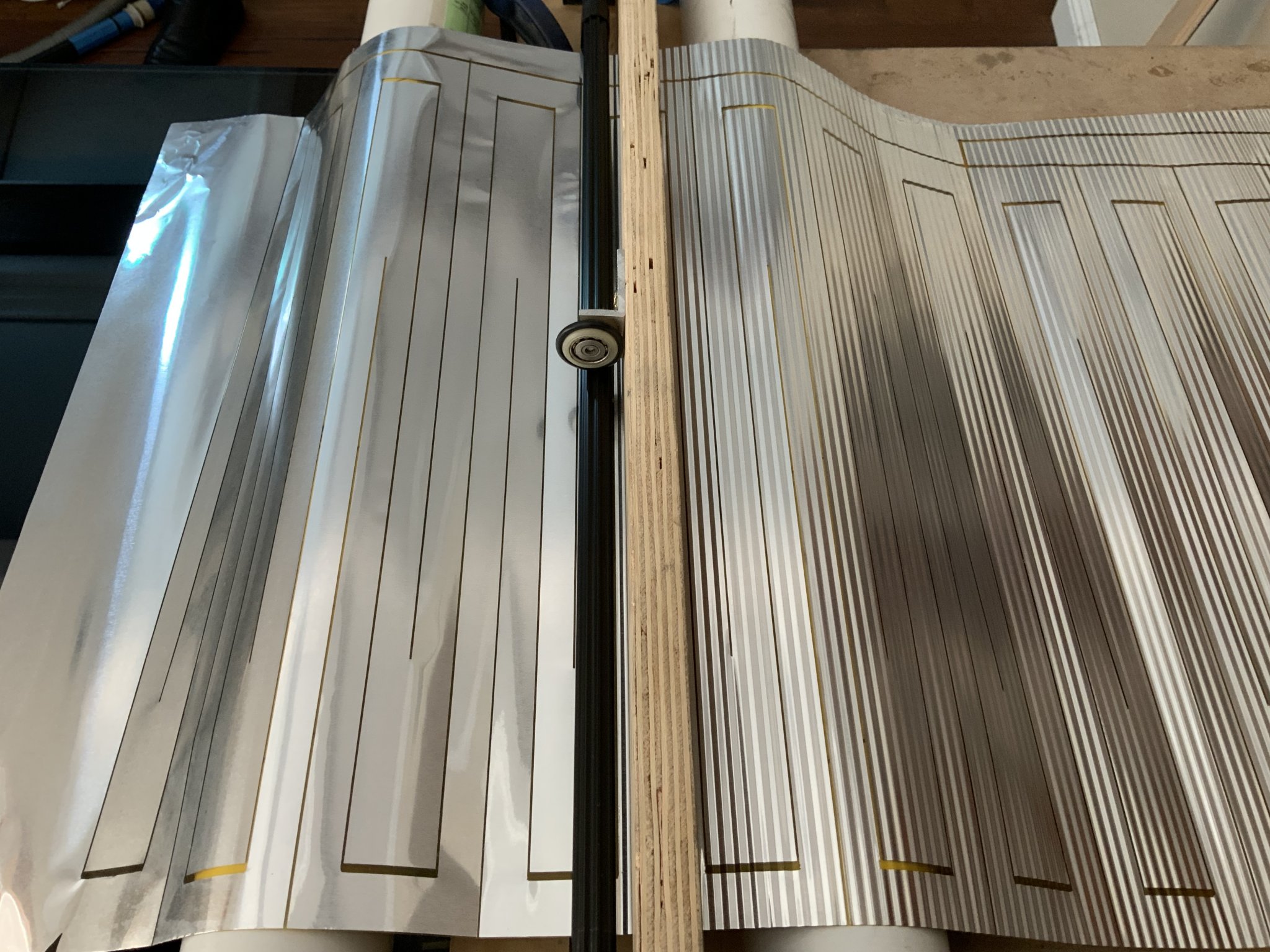

Apparently unable to resist temptation, a set of apogee Duetta signatures came up near me so here we go again with making some
bass panels once again.. .
Cutting these out and rolling flat , widths and spacing are all over the place. There is no clear consistent width to each section so the approach
will be different
will be different

I have no illusions of making as good as their offerings, but at the end of the day it’s still a strip of foil in a magnetic gap
What I didn’t do on making the divas and scintilla panels that will be done here , is pre run a sheet thru the “machine” stretch out to a final lay pattern,
lay it against the magnet rows, mark the magnet centers on the strectched foil, then flatten the foil out again to mark the cut sheet
more out of curiosity more accuracy and a different approach then before.

One side done and ran out of foil for the other side so more is coming.

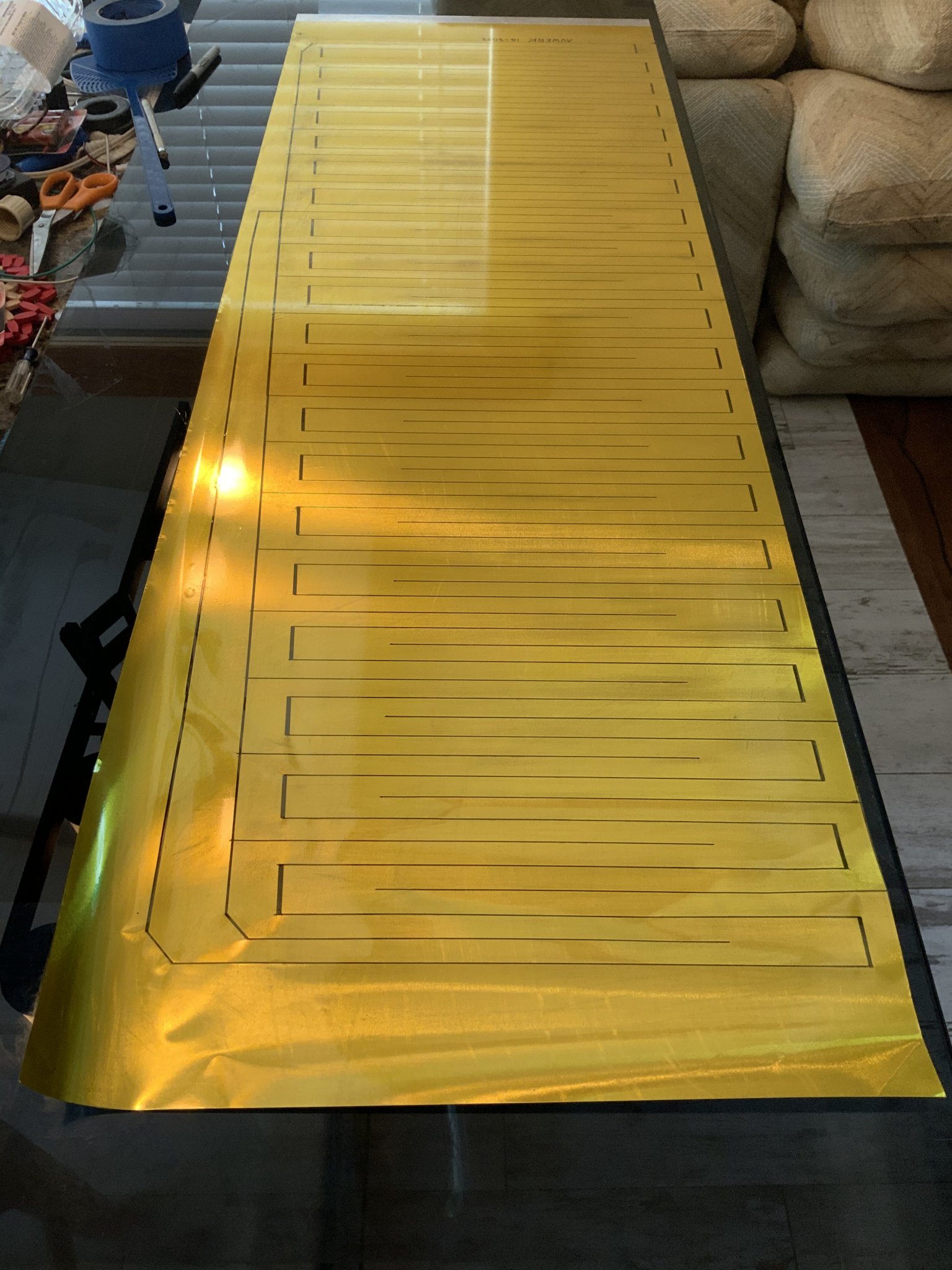

looks like I will have to move some magnets around to accommodate as an experiment on trying to match existing magnet dims didn’t work out as planned. The original sheet had wildly different foil widths for some reason. (1989 mfg.)
Maybe they were trying to suppress or distribute resonance ? Not sure their thinking here
The scintilla and diva foil widths for each run we’re consistant unlike these

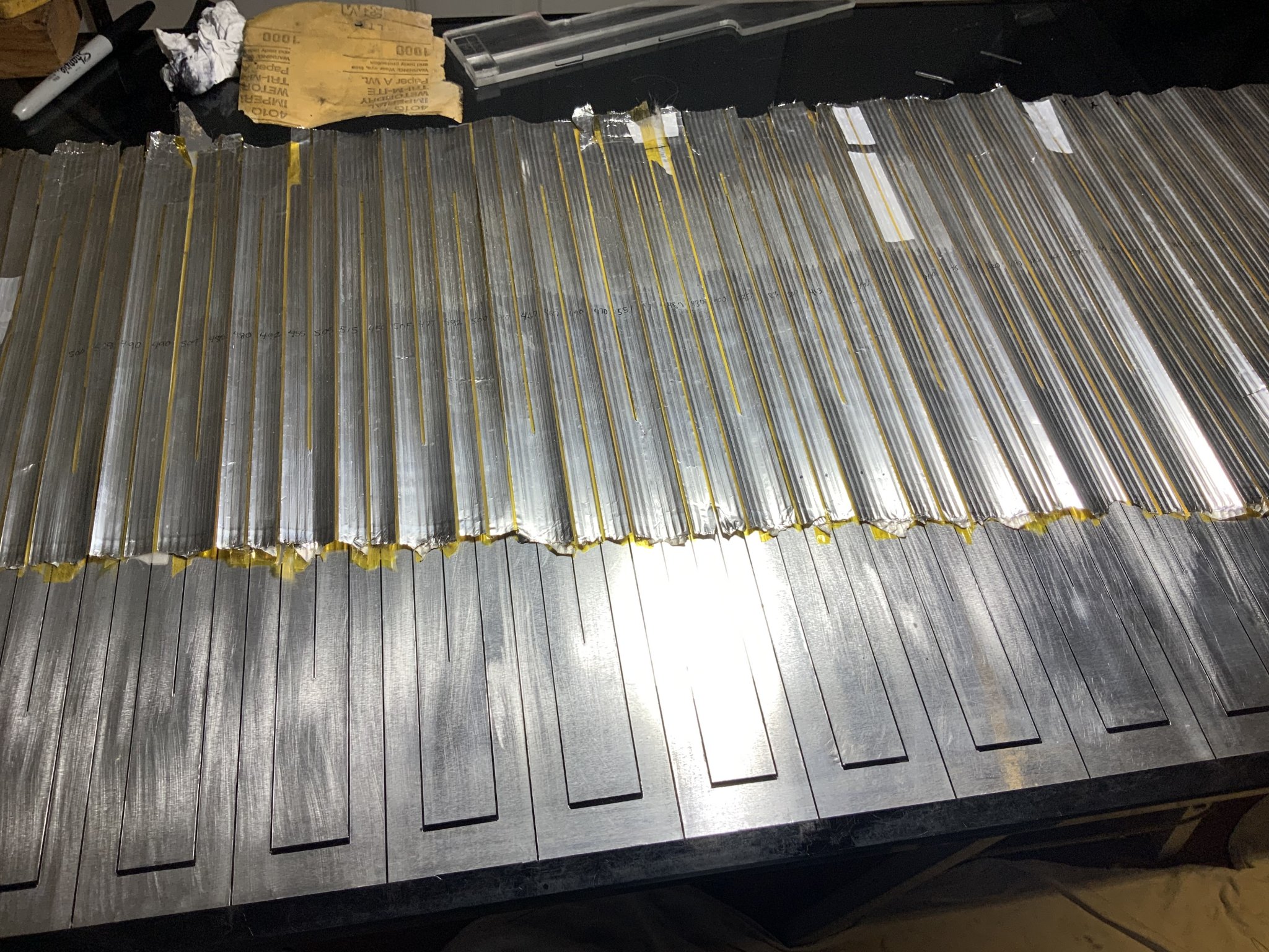

made a jig to twist off each magnet and will use gorilla glue - just more work

Even though all the magnets are the same size as well as symmetrical spacing , post 369 shows where I measured each original foil width and indeed they are Asymmetrical widths so you have slightly different field strengths
acting on the panel
I would just go off the magnet spacing and forget trying to mimic their spacing because it’s hard enough in itself just to get
a perfect stretched layout over existing magnets let alone trying to alter each trace width along the way
