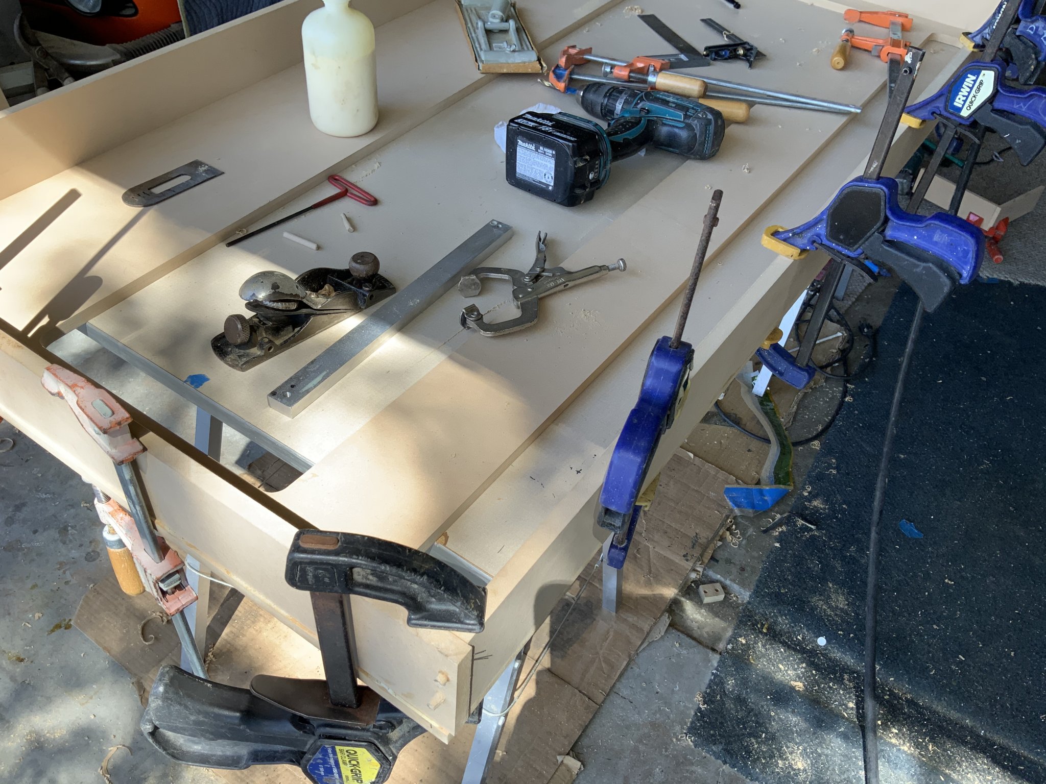

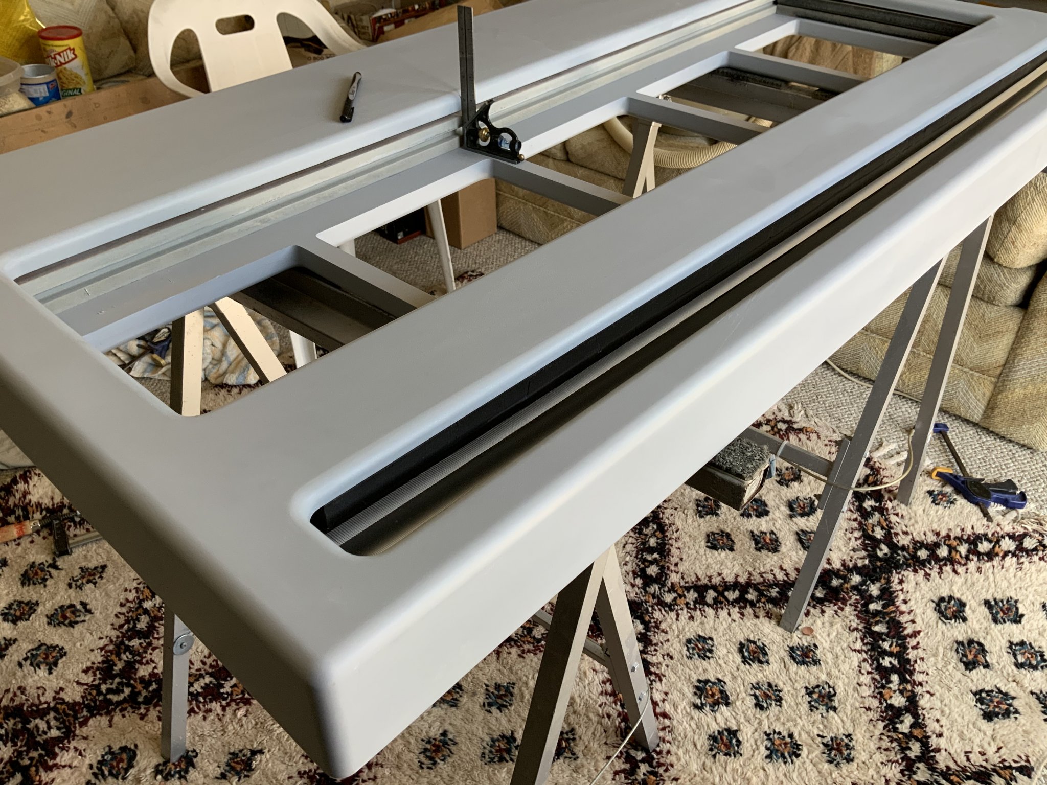

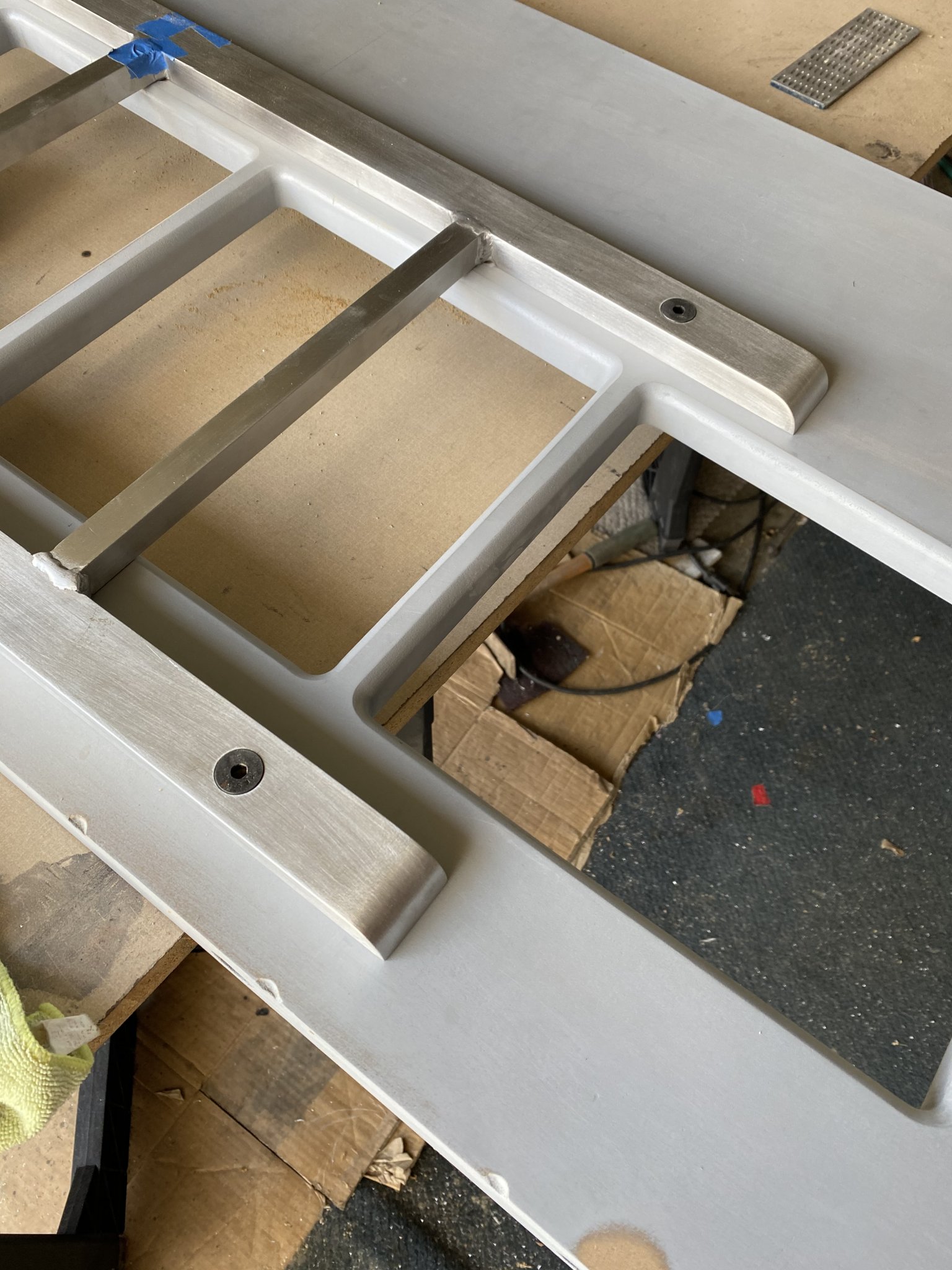

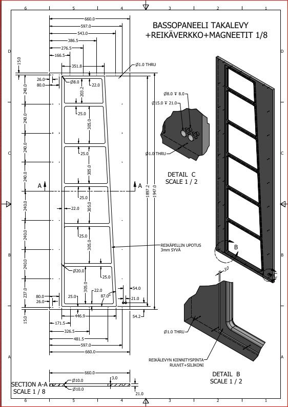

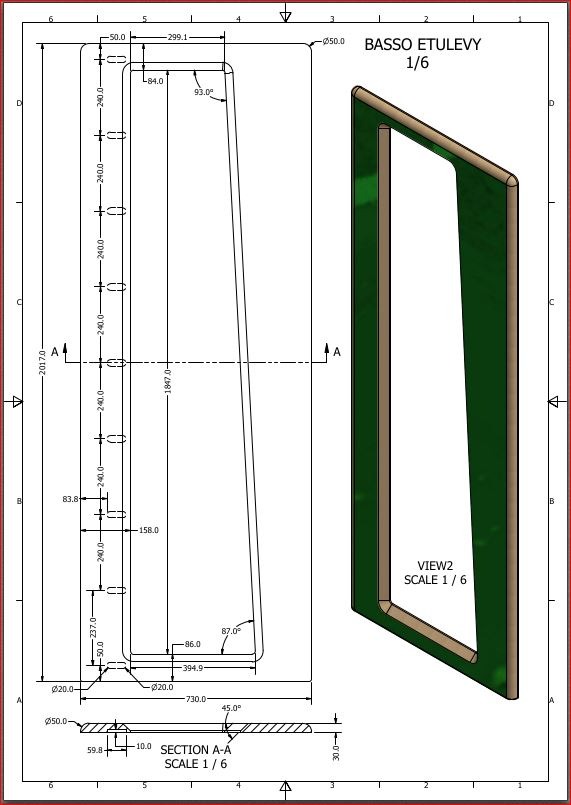

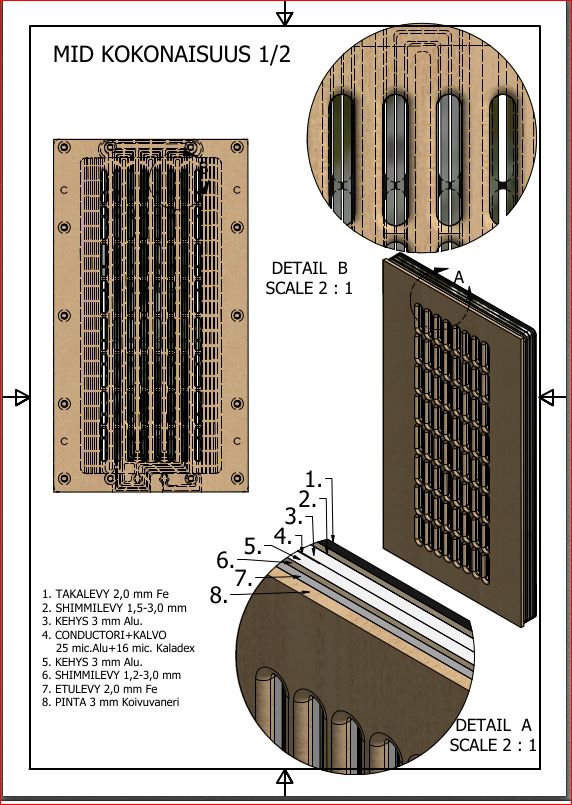

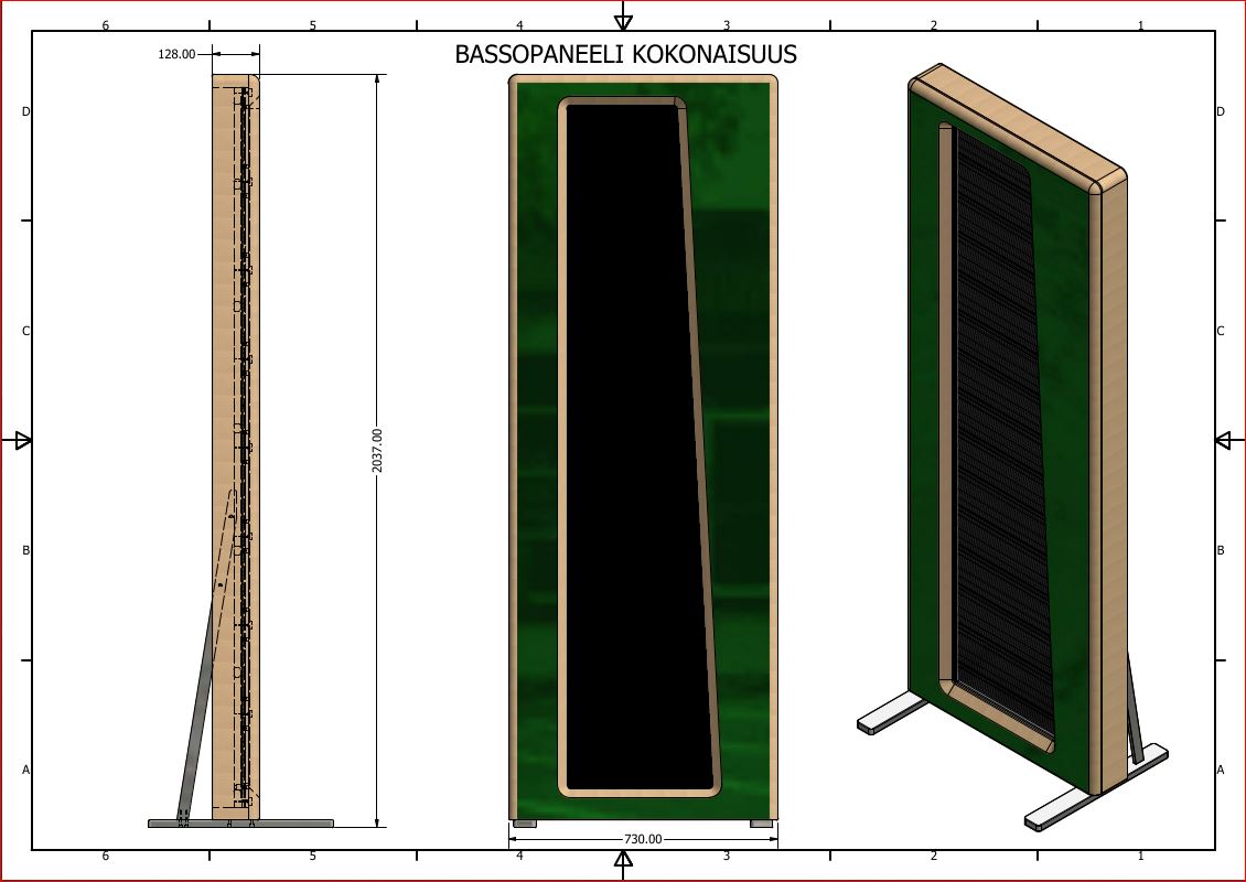

I have progressed here, slowly but surely.
For Apogee-style bass panels, the plans and drawings are now complete.
Membranes have been completed. Only the hardest part is ahead. the workshop needs to be cleaned.

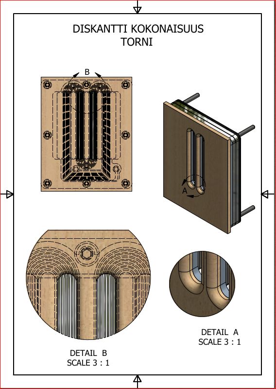

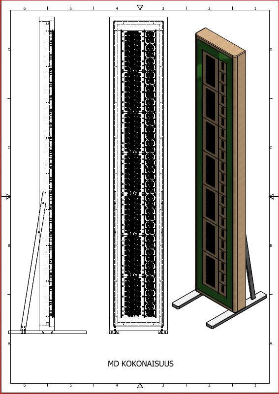

The buddy of this bass panel will be the midrange treble tower.
This is also under construction.

Why abandon the trapezoidal shape of the frame? That's an iconic shape.
So, these are not simply Apogee copies since there are multiple mid/tw drivers. Is this arrangement proposed to be much better than the original? Or, did you simply decide to go that route just to see if you can do it (which is certainly admirable)?
I would think keeping the original technology and improving it where needed would be easier. For example, using a butyl (or similar) surroung for the bass panel so it's serviceable in the future. Analysis Audio does that with some advantages, lack of resonances and tuning ease being two of them.

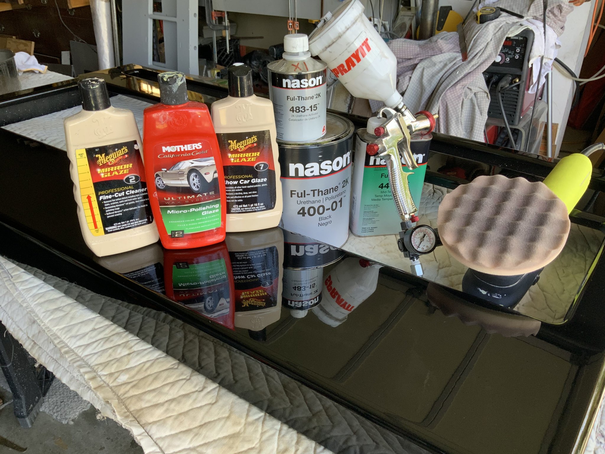

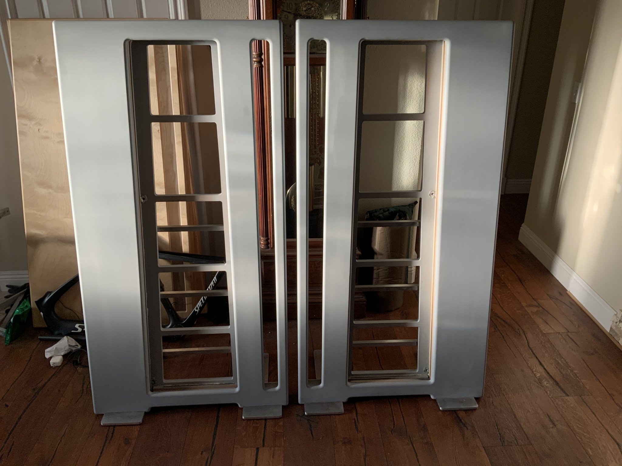

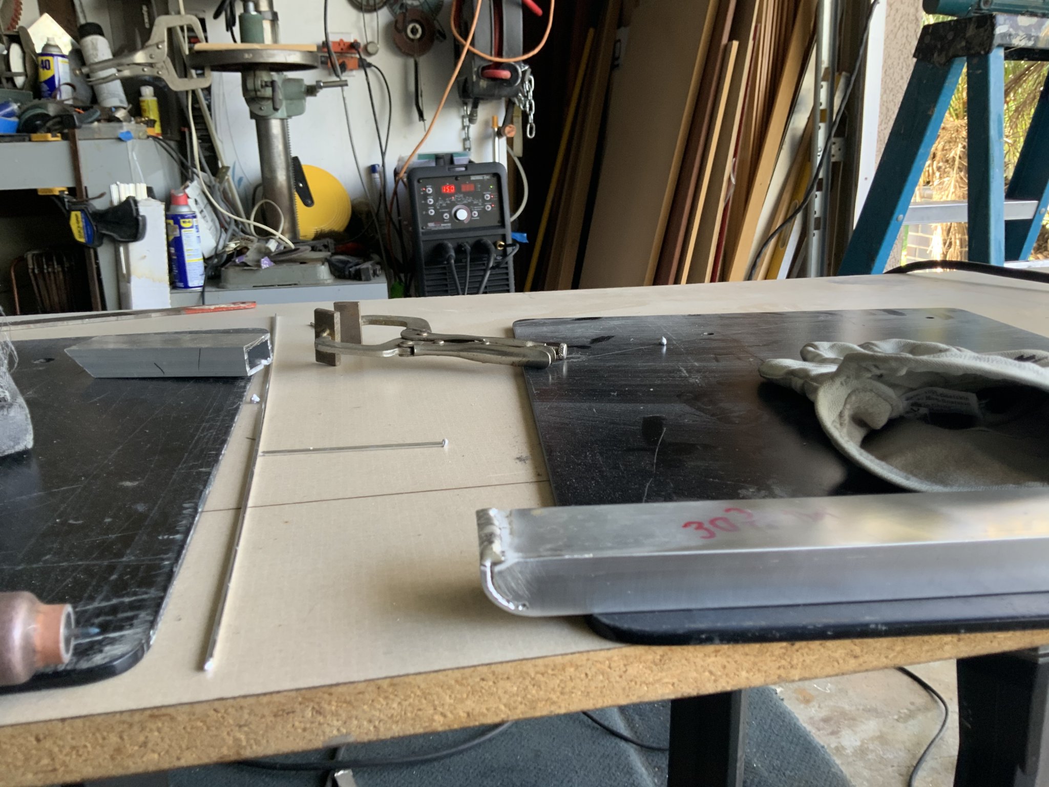

New covers with 2K primer and eagle eyes will notice I reduced the width
on the bass side by 1” as it was overkill IMO and never occurred in later models
no consequences in tuning

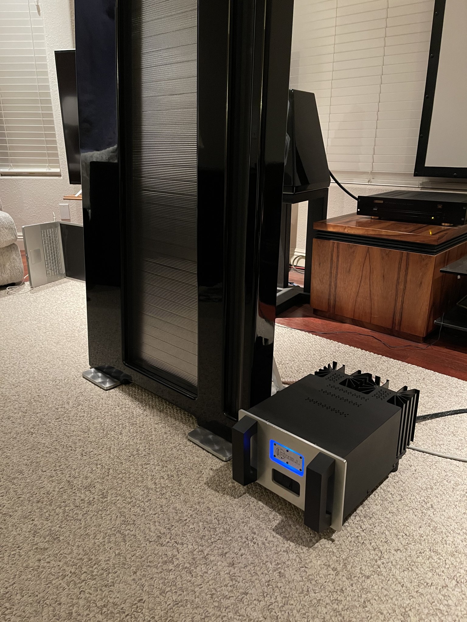

Quite the project and tons of work but Scintillas are worth the effort overall !

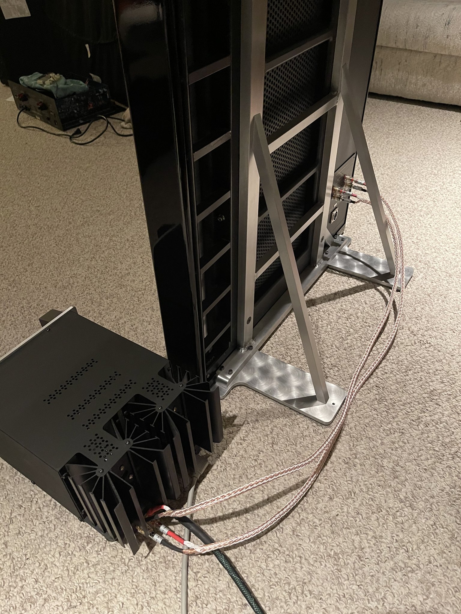

currently using a Sunfire 300 with a protection limit modification
top to bottom coherence and unrestrained dynamic flow is amazing
The old tacked on outside series bass foil was remade and placed inside
