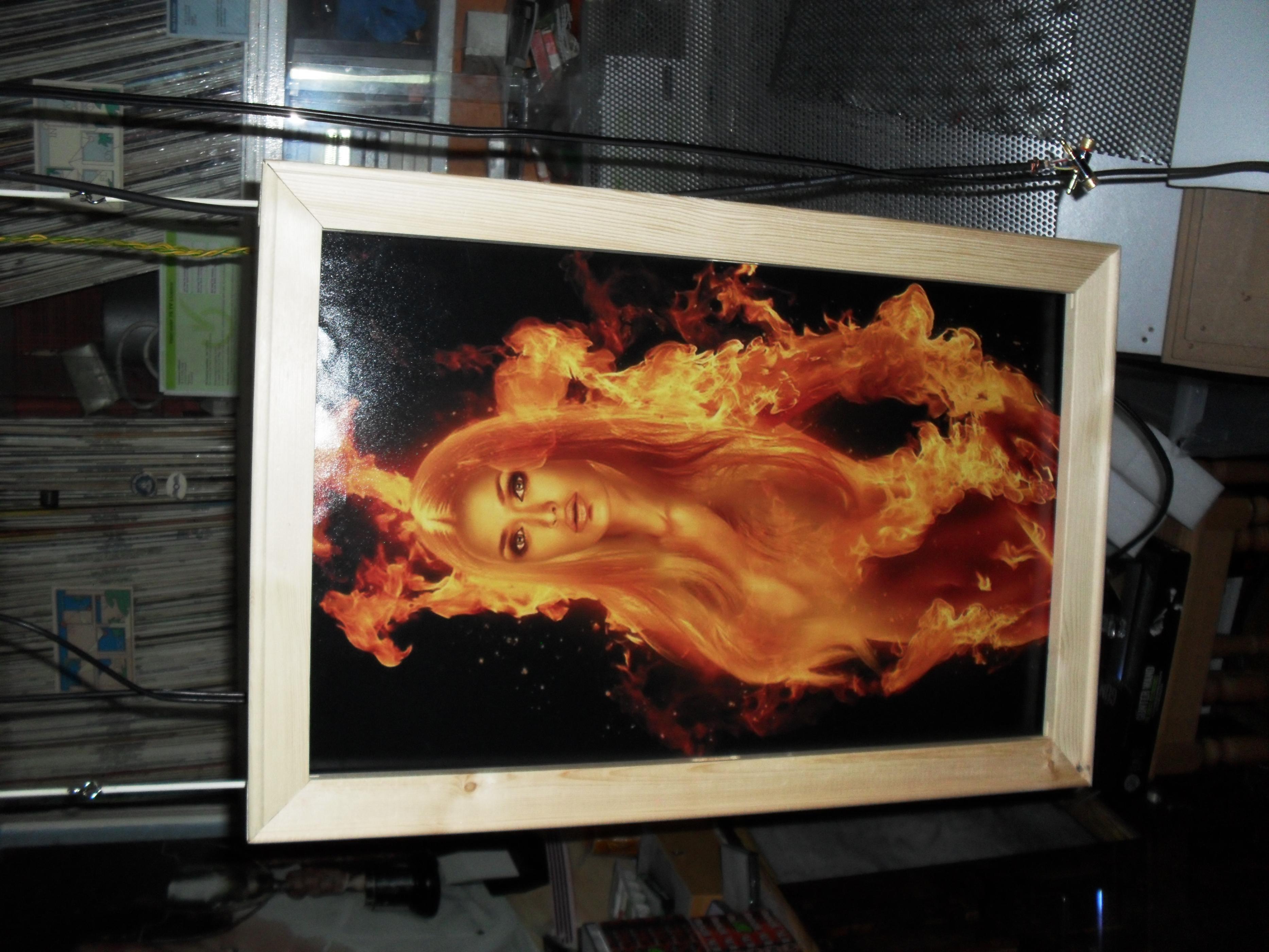

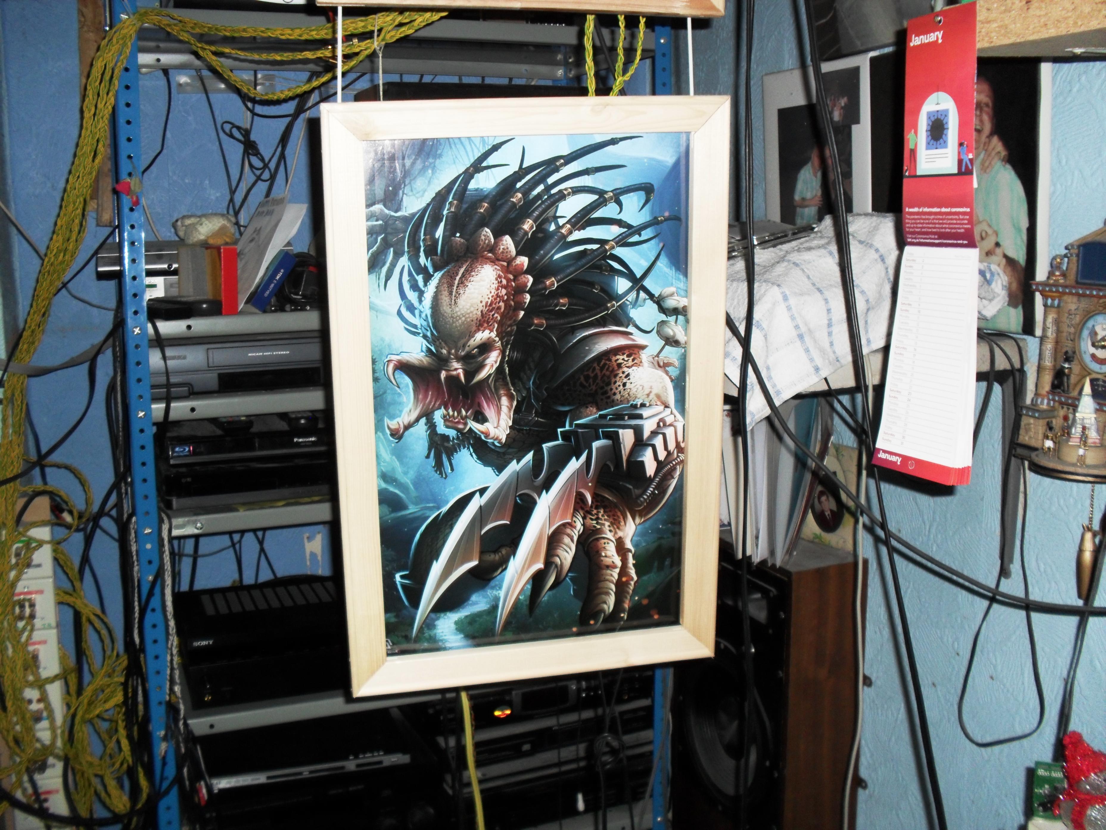

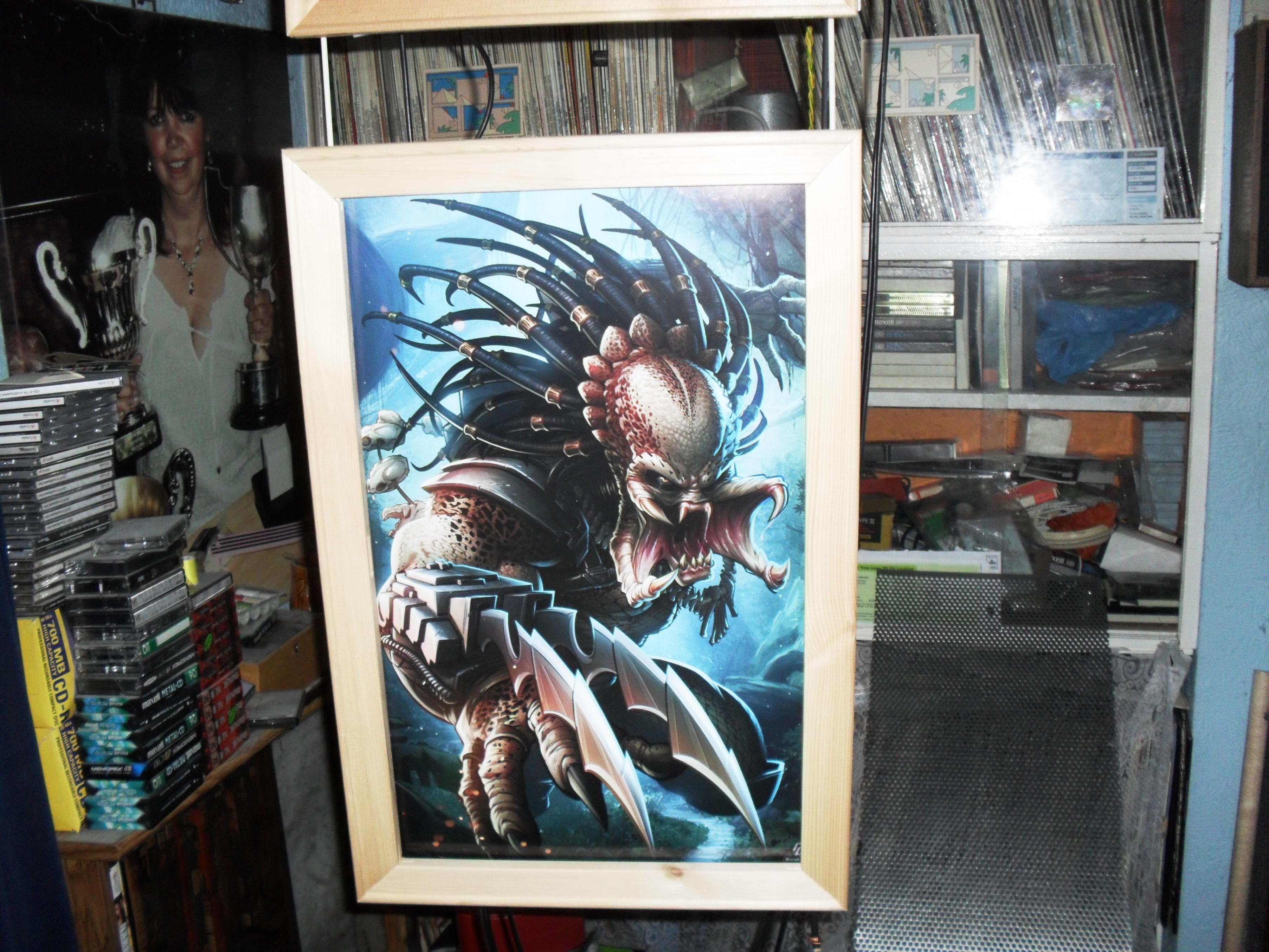

full range planar 24 x 16 inches
don't use plastic anymore, use pictures which can be any one you choose including family pictures or whatever. You don't have to stretch the diaphragm at all use double sided tape to stick the diaphragm in position. Easy to do.Have built about a hundred or more. Have also placed the aluminium foil completely different and only use a very small amount, less than a quarter which I used in my old designs, and it is louder by a long way. I also use less magnets as well and it is more sensitive.Tried to put my photos in but it didn't work!!
uploaded at last you have to do them one at a time.

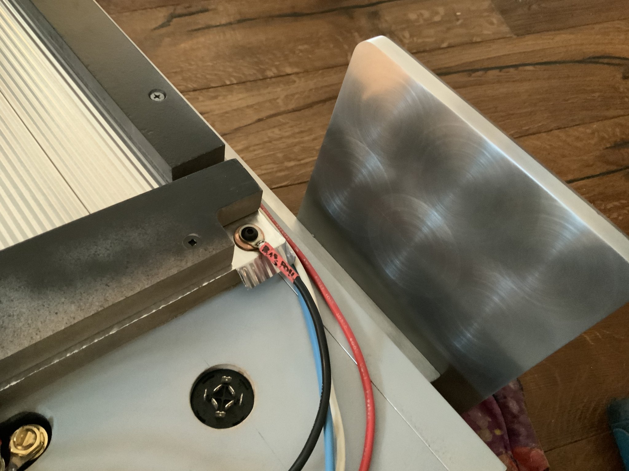

pic Is the Scintilla panels I made and attachment point needed to fit
