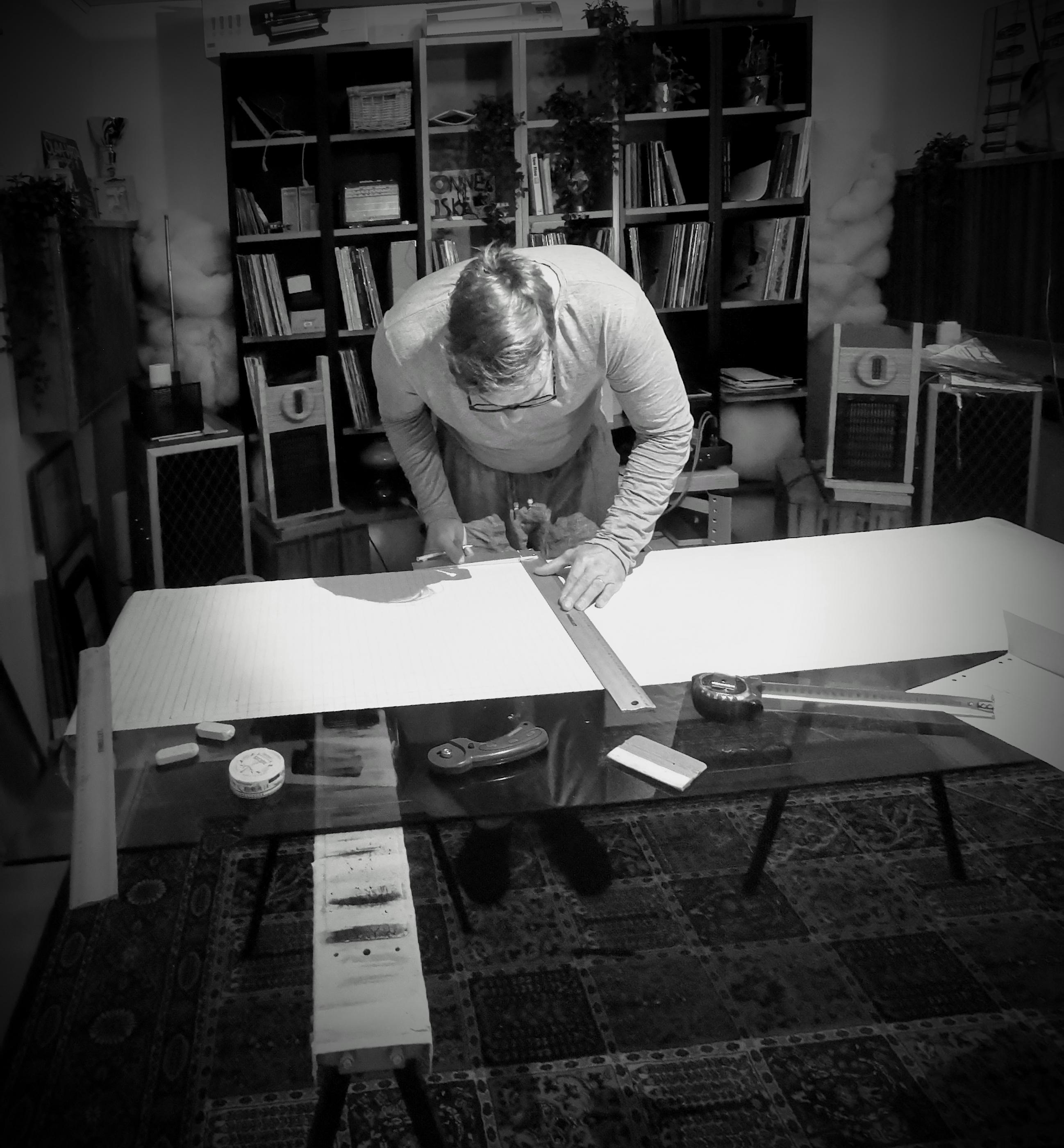

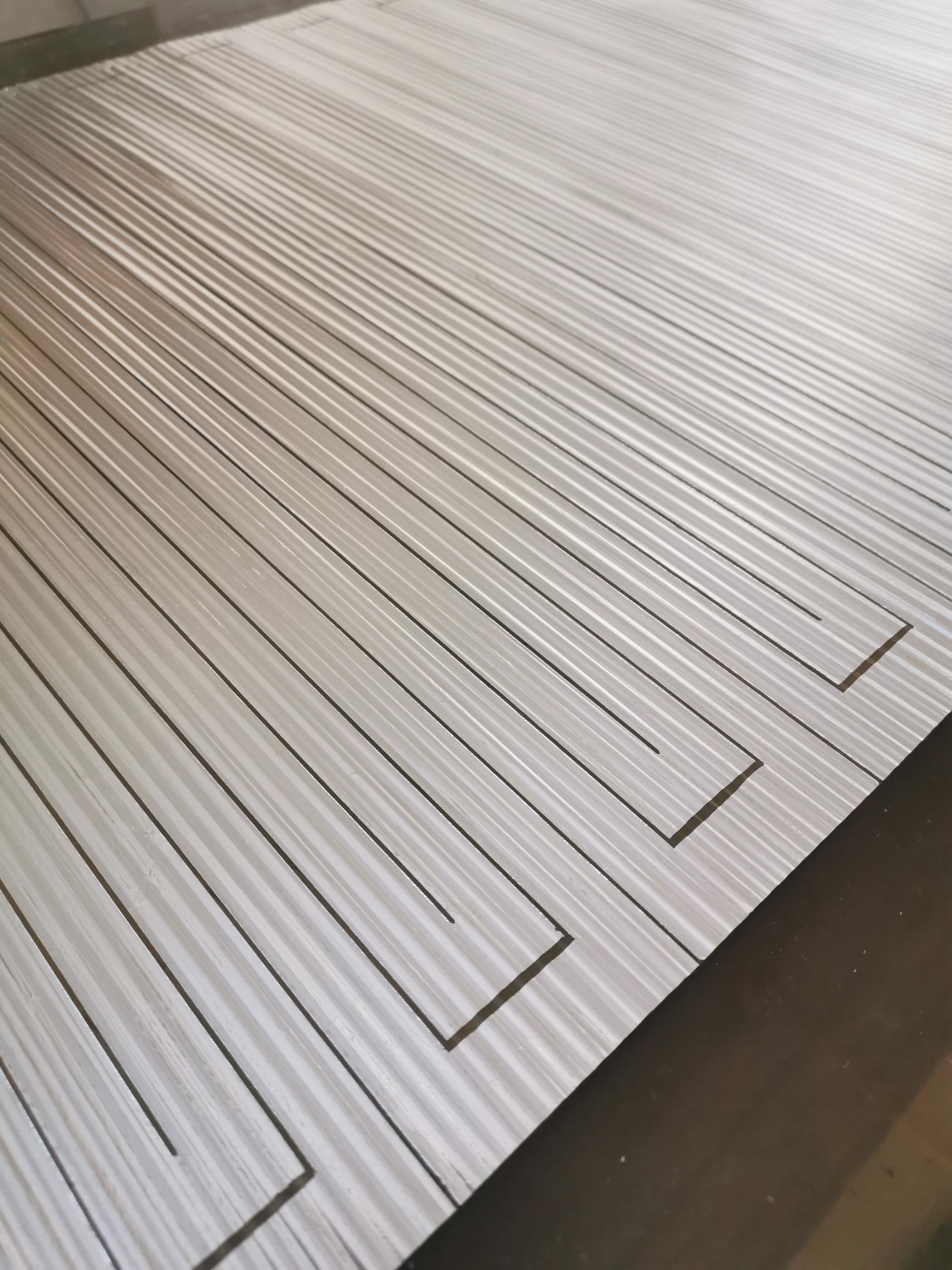

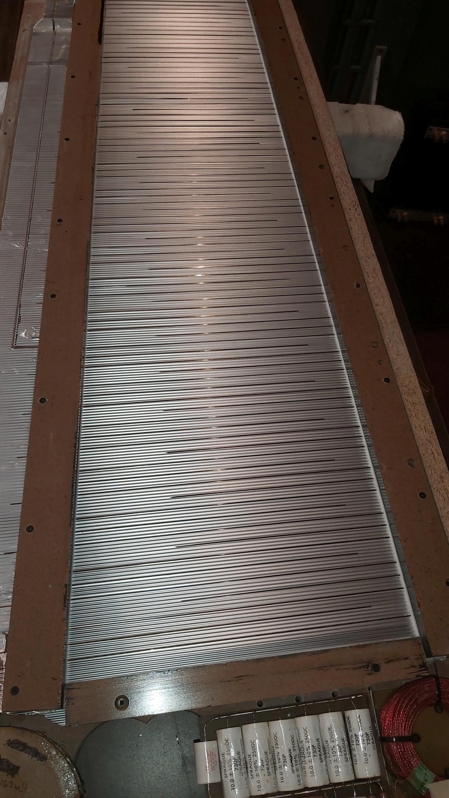

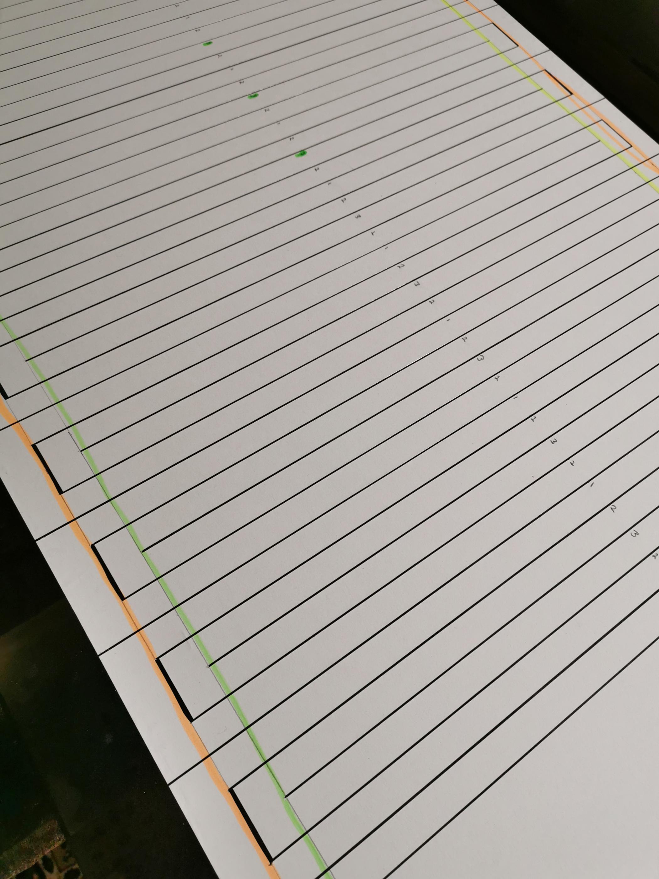

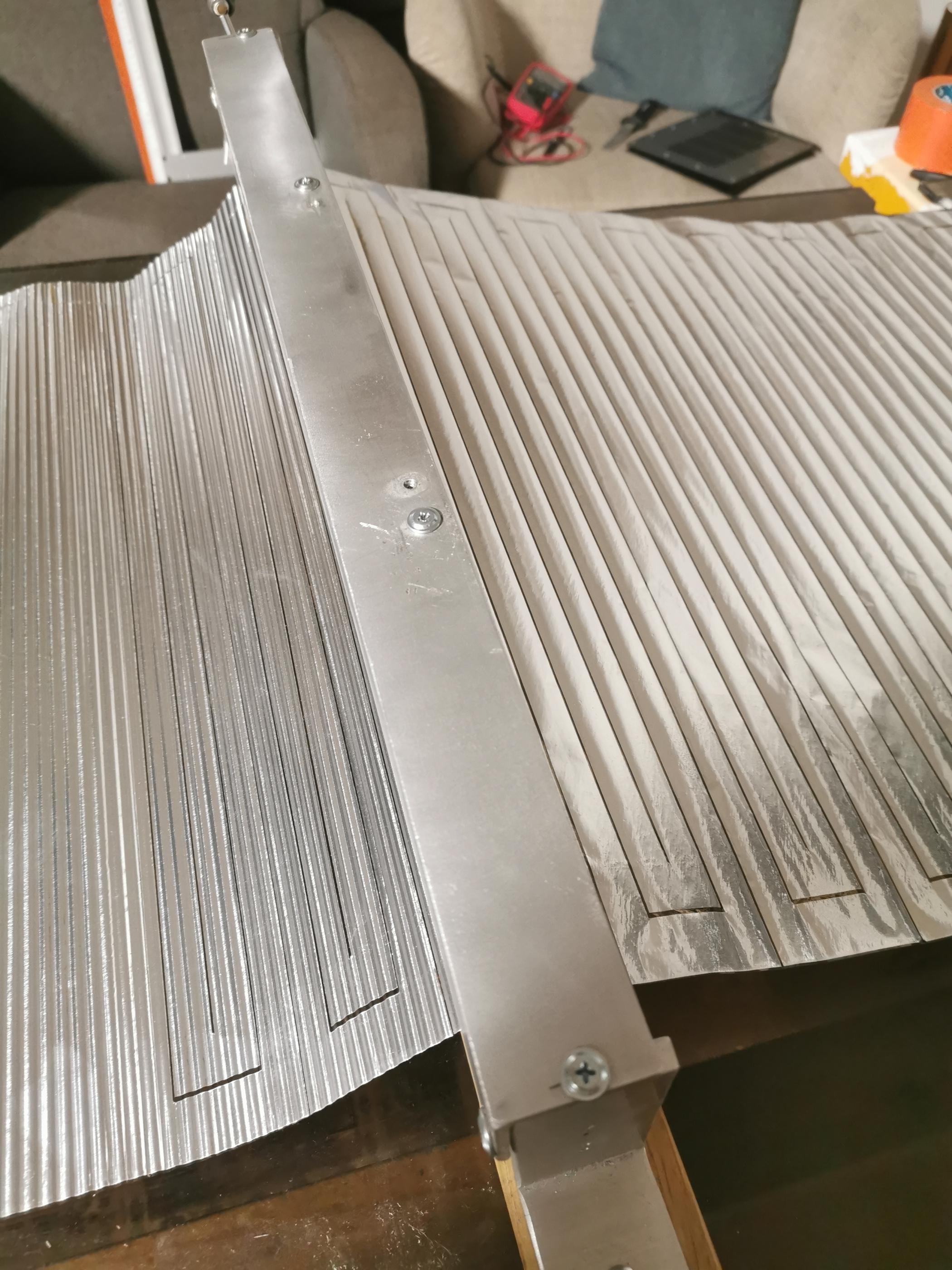

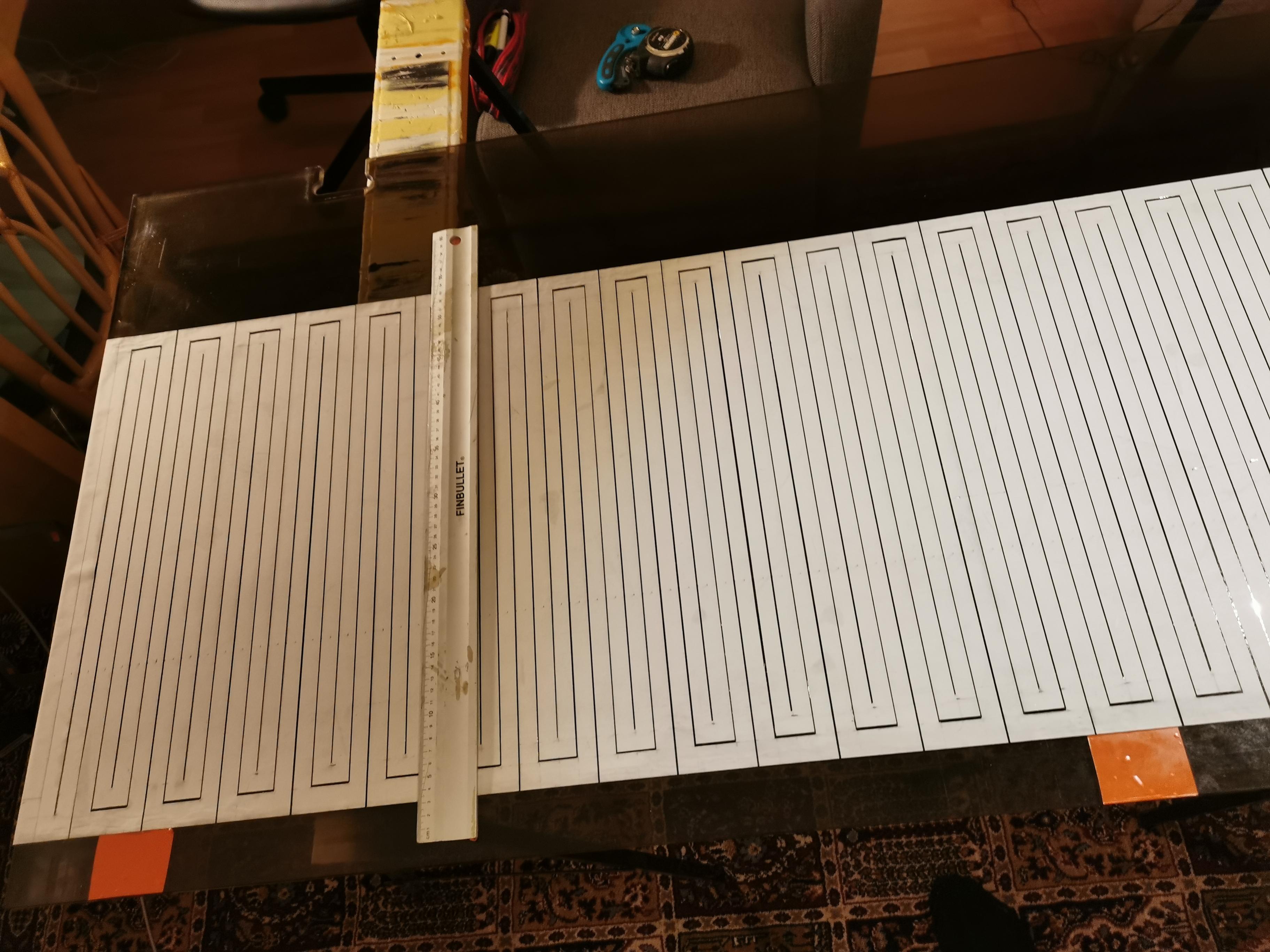

Despite everything. I will now post pictures of the progress of my project here. My intention is to build a Planar Bass panel. as a friend this gets a planar midrange and treble line sources.
One piece of advice I can give. If you can’t find a huge amount of patience. don't even think about this.

well thank you. but the result is ... well mediocre to be honest. i know its a small panel but i can do better with typical planar :( of the same size. maybe not rach as low. but at least with far less distortion :(
allot of things did not work out as i planned. or think it supposed to work either :(

that looks very nice !!! all by hand. thats insane !
Up to part 7 now, a very entertaining watch. Joppe is is very capable and uses a CNC machine to both build the frames as well as cut the membranes (drivers). Nothing I'd ever be tempted to do. Imagine all of this being done in the 80's/90's before computers were used!

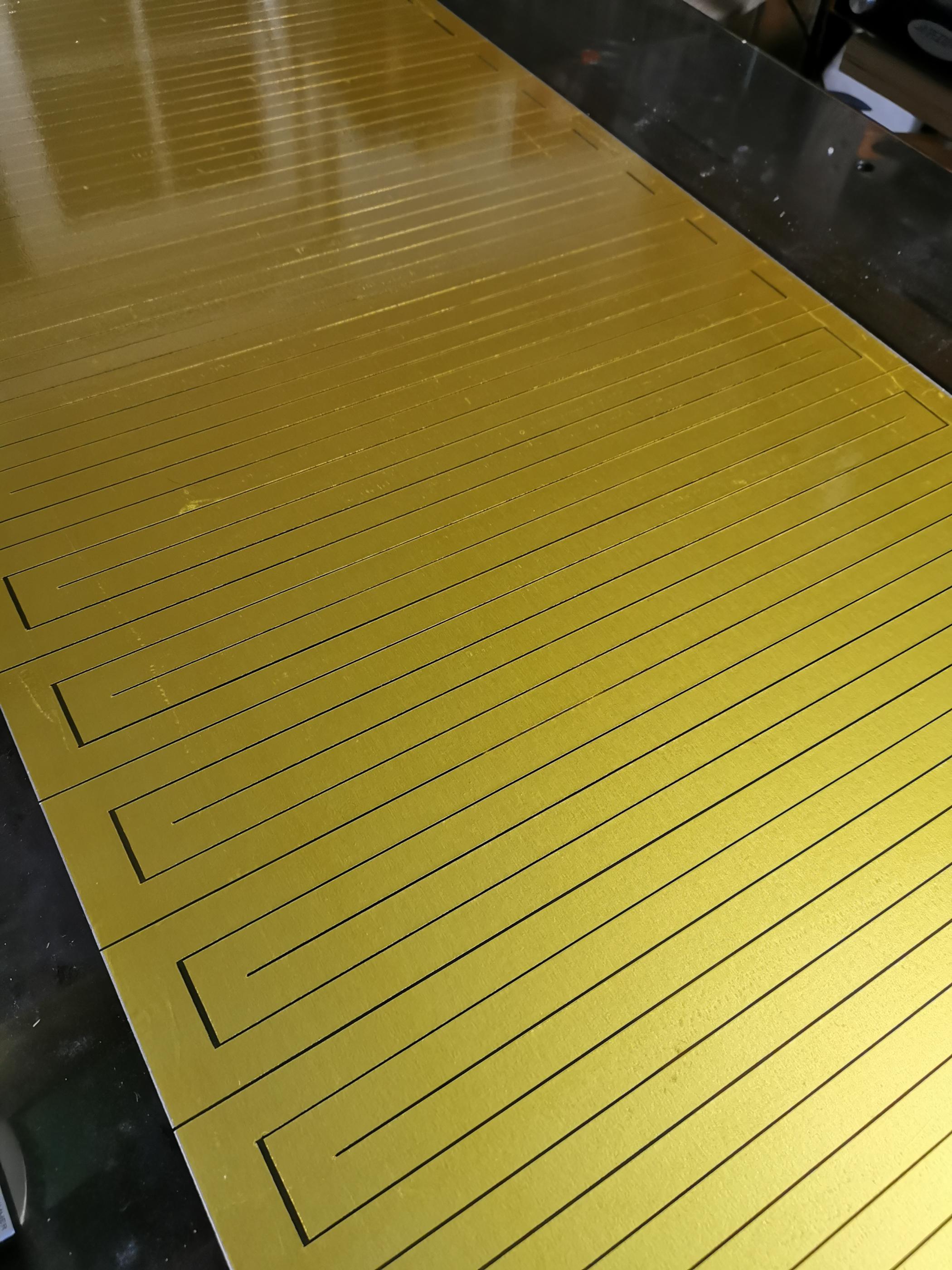

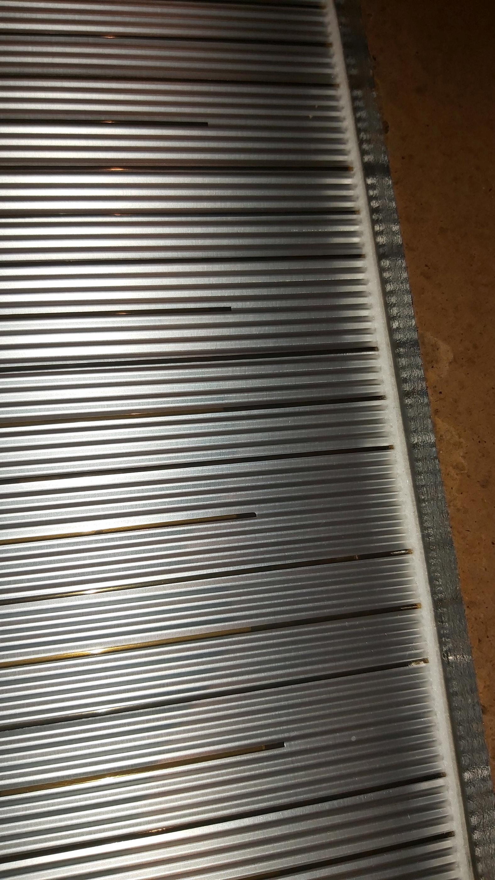

Well, there were pictures in the Hifi News & Record Review back then in the 80's, showing how they cut the aluminium foil and sealed the gaps with tape. Later, I think the started using a laminate of plastic film (Kapton) and aluminium, probably etching the "cuts". That is how Eminent Technology is doing it. A friend of mine tried that technique as well but never finished his project.
well e thing or cutting both are the same :) , down side depending on the design when ethcing is the glue is left behind. most plotting/cutting to but in my latest attempt that is completely different then the apogee side ways coil.. uses only glue on the alu parts. the rest is clear mylar.

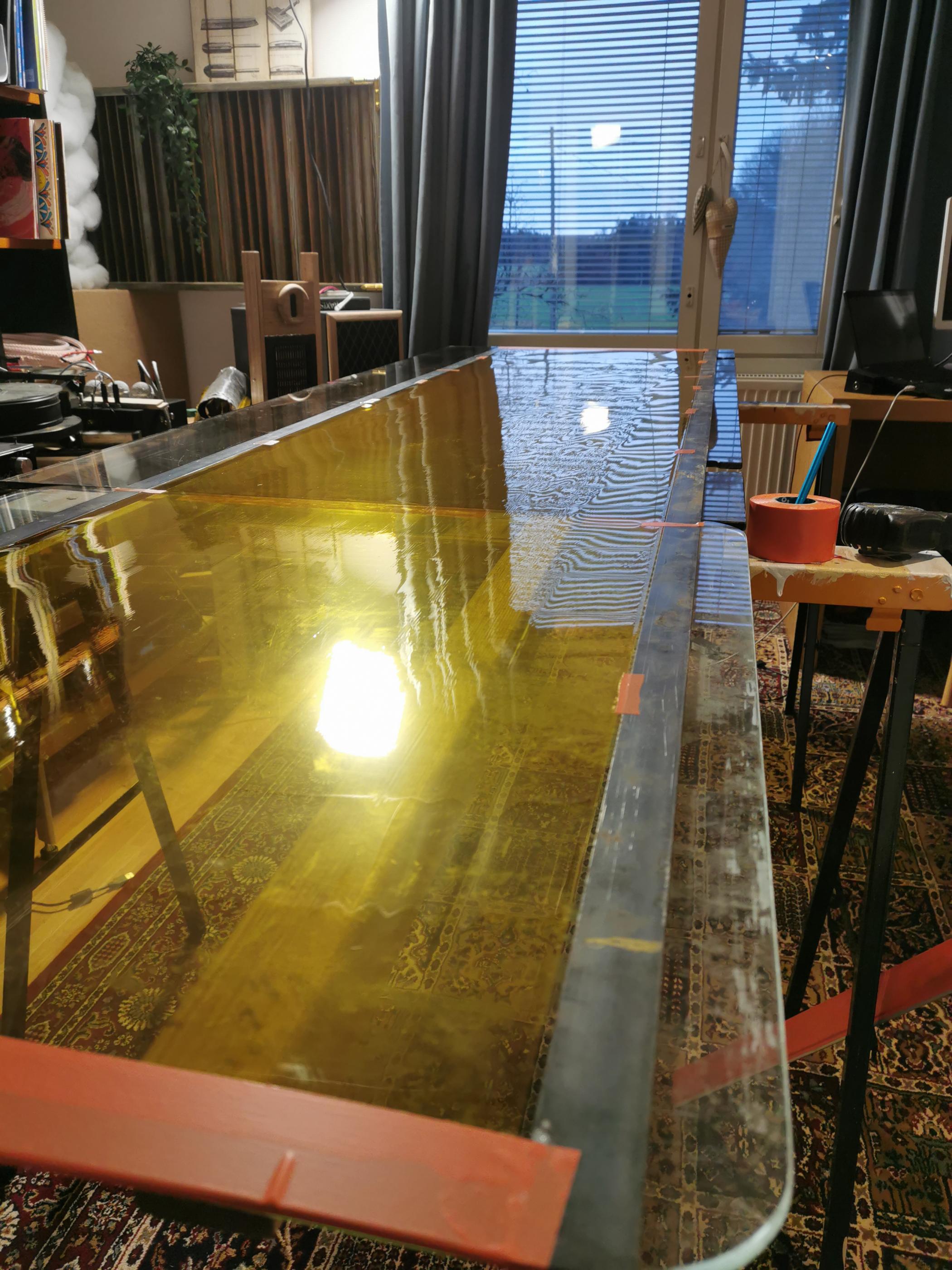

uploaded video 7 and 8 :) it plays allot better then the apogee style i made before.. the insane failed one. although i must admit i managed to drop my allen key in the magnets twice... :(

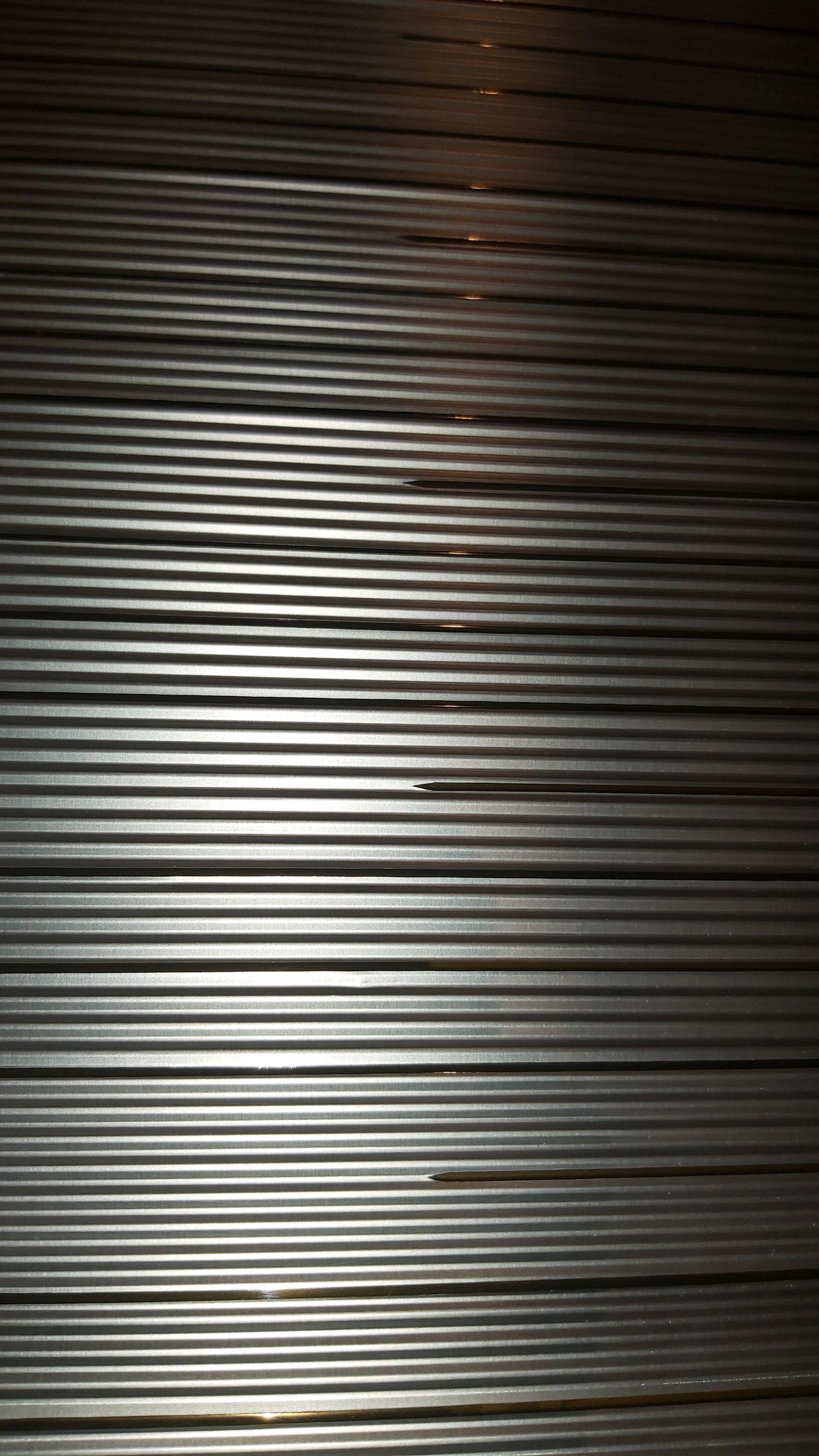

Here are pictures of the bass diaphragms from Clarisys that I just installed on my left Duetta speaker, one more to go:). Clarisys use white felt for the damping material around the edge of the diaphragm like felt used on a piano to damp strings. In my opinion the diaphragm looks like the original.

Felt? I would think it would be overdamped for one and unable to fill in the uneven panel consistently and completely, like foam. Why not use a modern foam - similar damping, similar complete contact, lasts a lifetime.
You need to take some measurements with a signal generator to see the response.
No, the foam is not compressed beyond its function. There's a ridge (rabbit) where it rests to keep it mostly uncompressed.
OK, maybe you should ask Clarisys. I'm not here to defend the way they damp their bass panels. I'm just letting people know that there are Apogee diaphragms available from other suppliers. There always the other supplier where you have to pay to get it installed, you take your chances either way.
I am very glad to see all the unique and creative talents in this thread, all with wonderful results. We use felt because it does not rot over the years and works perfectly fine for rebuilds and also on our new and upcomming speakers. Of course, if someone doesnt "trust" the felt, he can choose to use foam, its DIY after all :) --- Keep enjoying it - Florian

Interesting these have a V notch cut on one side and a round cut on the other
More movement area on the V cut side I,m guessing
