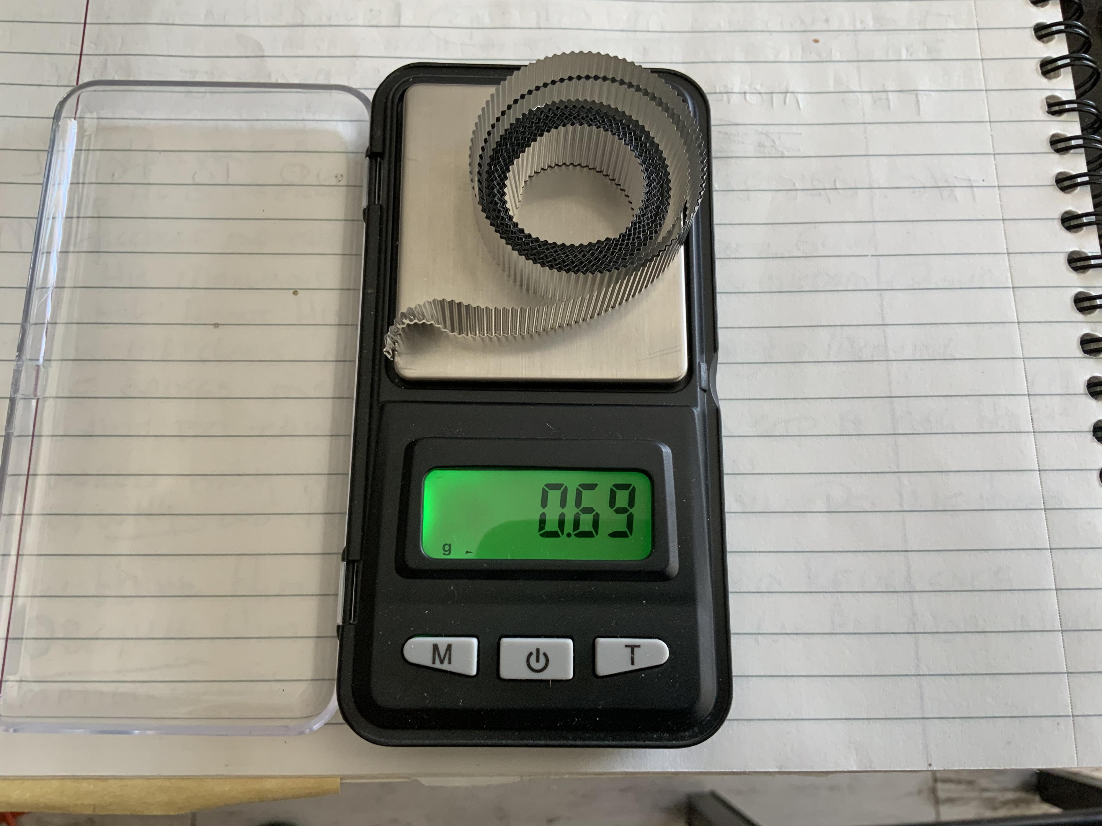

I think there is not grams but milligrams or so ??
No, it should be grams. It must exceed the mass of the foil.
About 6-7 years ago i changed mrt's on my Stages, alu foil with capton backing was very light. As I remember, stretching force for montage was 92 grams.
Well, very light it is not. The aluminium foil of the Diva tweeters or the Magnepan ribbon tweeters are low mass but still about the same as a dome tweeter.

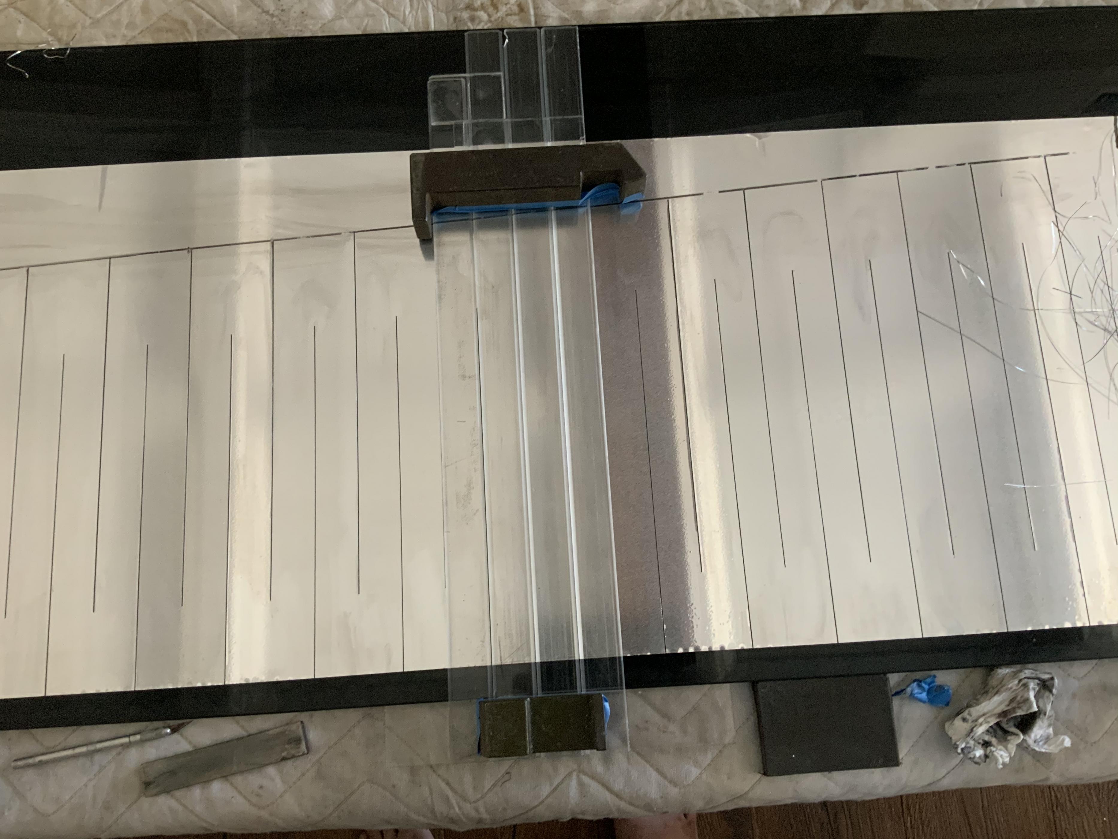

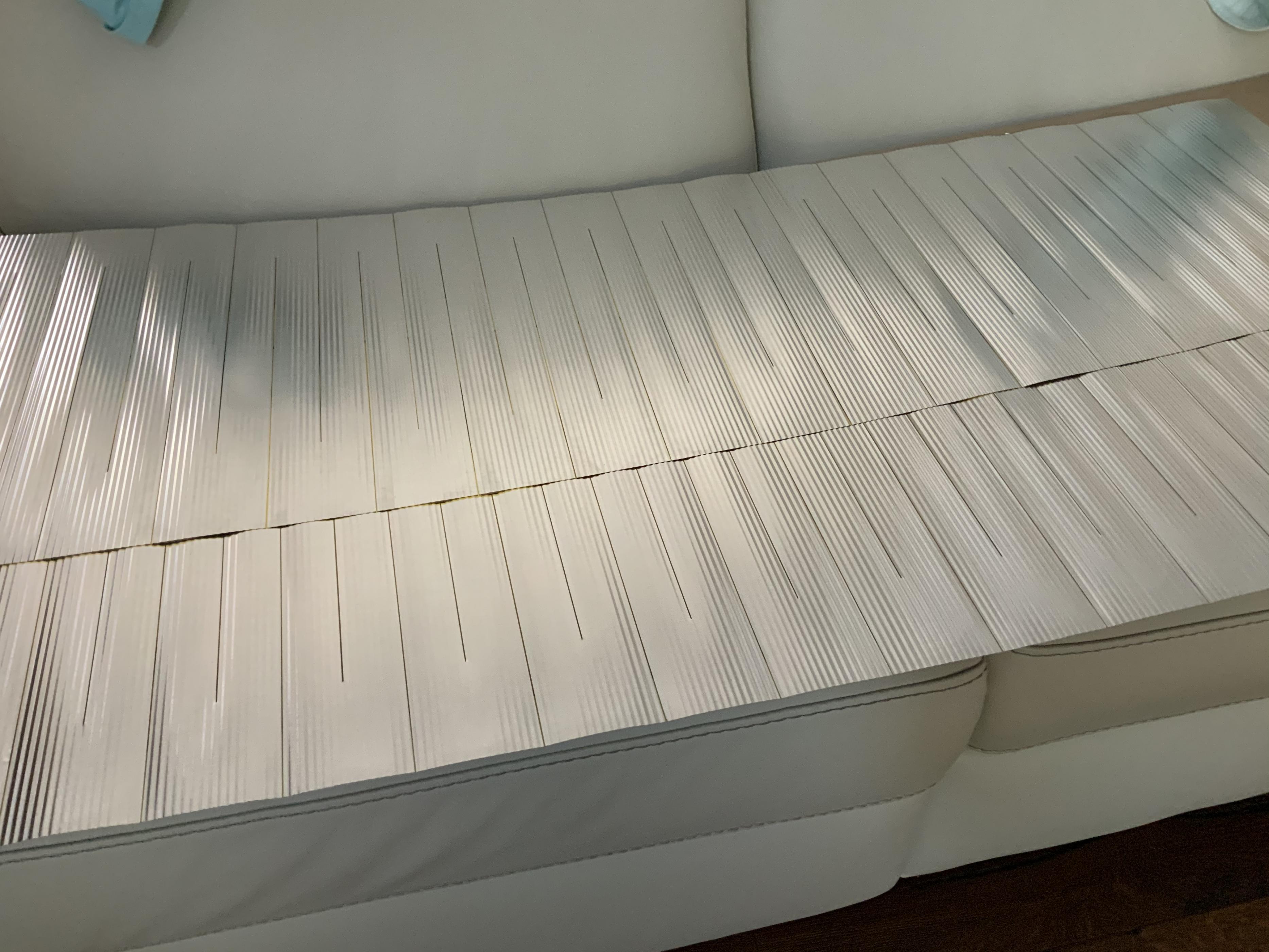

This time around decided on .033” wide cut traces made up of 1/4” acrylic strips glued up to form a framing square and you just move it around to replicate exact magnet rows.
There were 3 rows that were off and closer together so this will shift all rows above those, so it’s important to match and transfer all rows exactly to make the best match per magnet panel.
Center to center magnet length total is 49 13/16”
Sanding down all surfaces with 400 grit on an acrylic block takes any rough cut marks down before the Kapton goes down and actually increases impedance slightly as a bonus
This panel wound up at 1 ohm and used the open return field to run some extra traces to bring the panel up to this impedance.
The rebuilt panel that was pulled off measured .9 ohms so I am in the ballpack
And close enough
This cutting template made the whole process much more simple and was able to reduce trace width down significantly compared to the Diva template with the routed traces shhhss , You live and learn..,

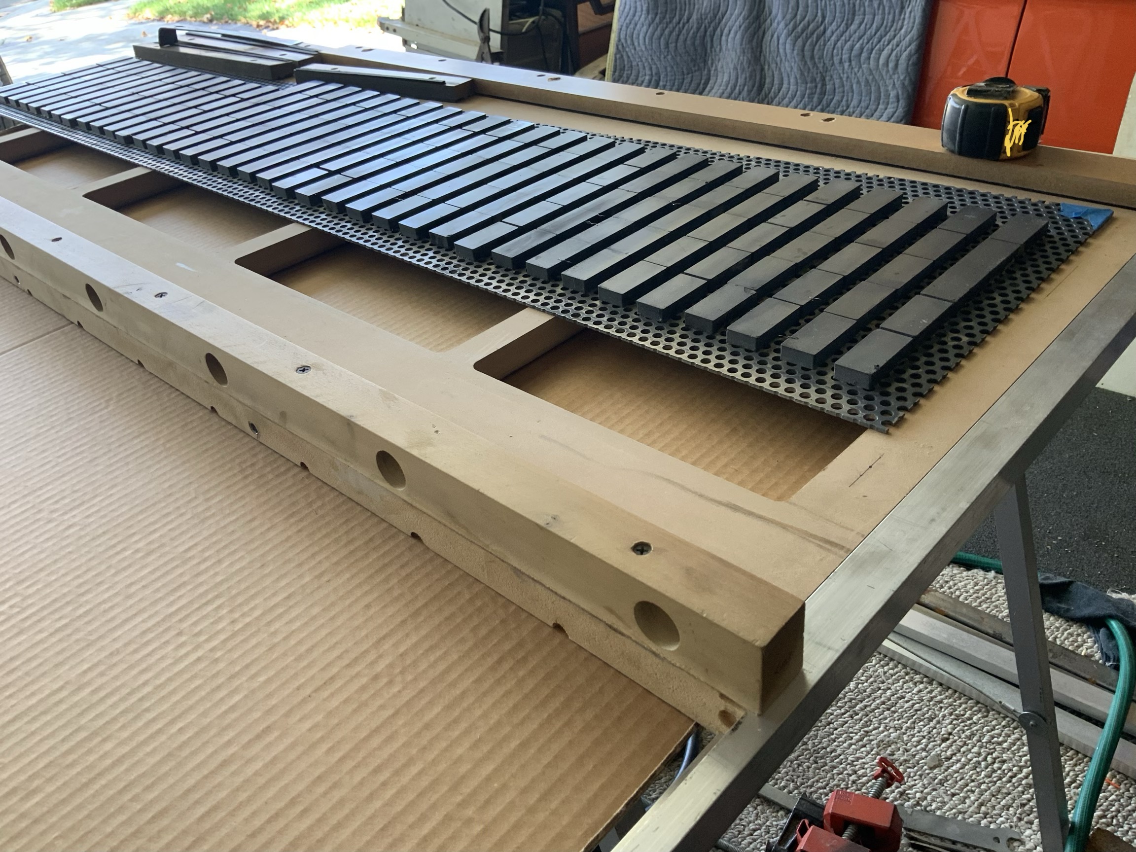

I have a question on the air load on this new chassis for the Scintillas and if it might affect Bass response.
As you can see I have run stiffing ribs across and underneath each magnet row the same width as each magnet section
The original had steel flat braces 1” away on the back side area in the same horizontal configuration.
Also the tops and bottom ends of the magnet frame itself never touches the top and bottom frame structure and its the same on the Divas.
I could rout out and area under the steel magnet structure and leave a small center contact area so it can breath better and at the same time connect and glue this area to stiffen the magnet frame and wood frame at the same time
I want to attach top and bottom sections and was considering some big bullnose
reliefs on both sides with say a 2” center attachment area to simulate a more open area like the original design
I have bull nose rounded all the back side cutout area unlike the square edge stock versions and maybe this will aid in air movement in some way
So do you think this might affect air mass loading enough to worry about and if it reduces bass remember the frequency response on this model is set at least 15 dB above the rest of the spectrum and maybe a reduction is a plus here ?
Welcome some opinions

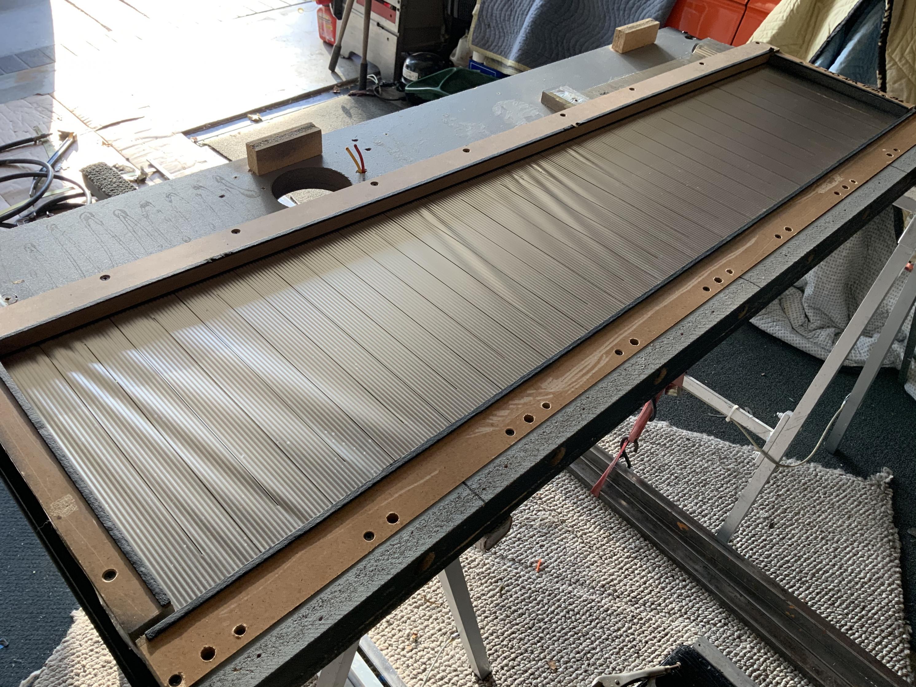

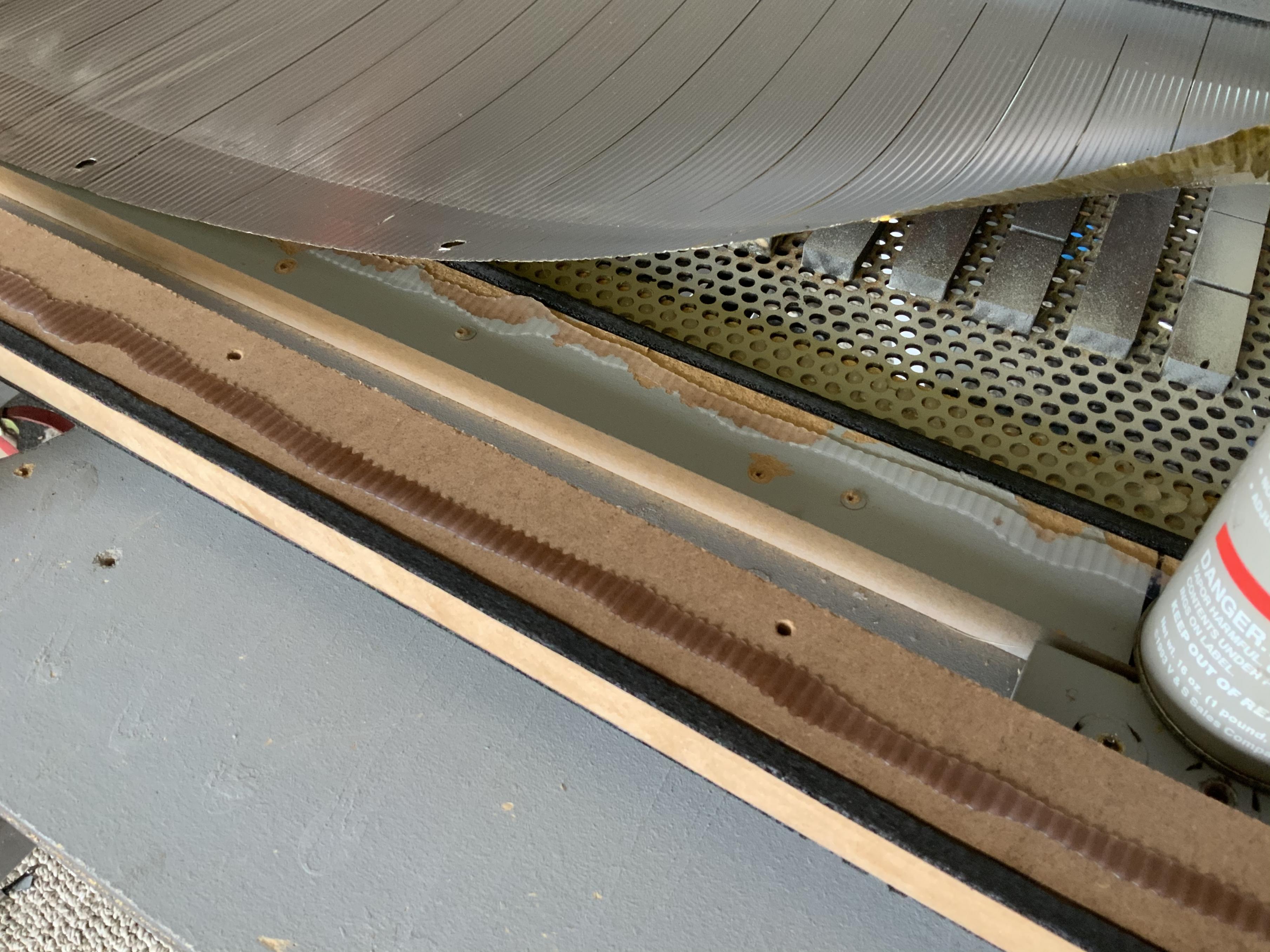

Thanx Pete. The reason yours had these ripples is sections pulled loose .
I was able to pull both speaker foils from the silicone without damaging either one.
Perhaps the installer (2008) assumed new foils were already clean before applying silicone and maybe
a good cleaning with acetone would have gotten them further along
I shouldn’t have been able to peel these free so easily.
Did I understood it right, you managed loosen old foils intact? And made new ones from scratch? GREAT JOB!🙂
Thinking about this for those with decent panels but bad foam and the possibility of removing them intact to be reused , reformed and reglued again , I was able to remove the Diva panels and also the Graz Scintilla panels rather easily.
