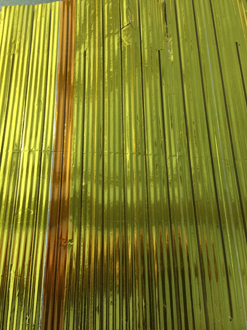

RedAlert, I have done as you said, the math didn't work, at least not for me, Apogee didn't corrugate the way were doing it, they used a narrow roller going across the ribbon, which I believe displace and stretch under pressure kept the ribbon at length, I seen a video of this as well many years ago from a factory tour, it still may be on audigon, unless it was removed. Al

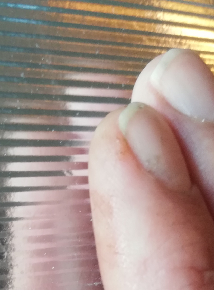

Thats the first time I seen their rollers and their close to an 1 1/4” in diameter thereabouts
That fine pitch makes sure all surfaces are contacted and pressed for consistency.
This work hardens the foil I believe just enough for long term durability
I wouldn’t be surprised if they also had alignment issues as they went and from the ( flat feed side only ! ) a slight pull keeps it straight and parallel as you go.
Hard to beat their roller system

They must have made that corrugator later, it's not what I seen, also thier wrong on the scintilla circuit slits, 75 not 83

These rollers might work well for mid/twt ribbons though. Without a better close up of the ribs it appears the peaks are too rounded off and when placed together it looks like the foil might not reach the depth to make a clearly defined profile transfer.

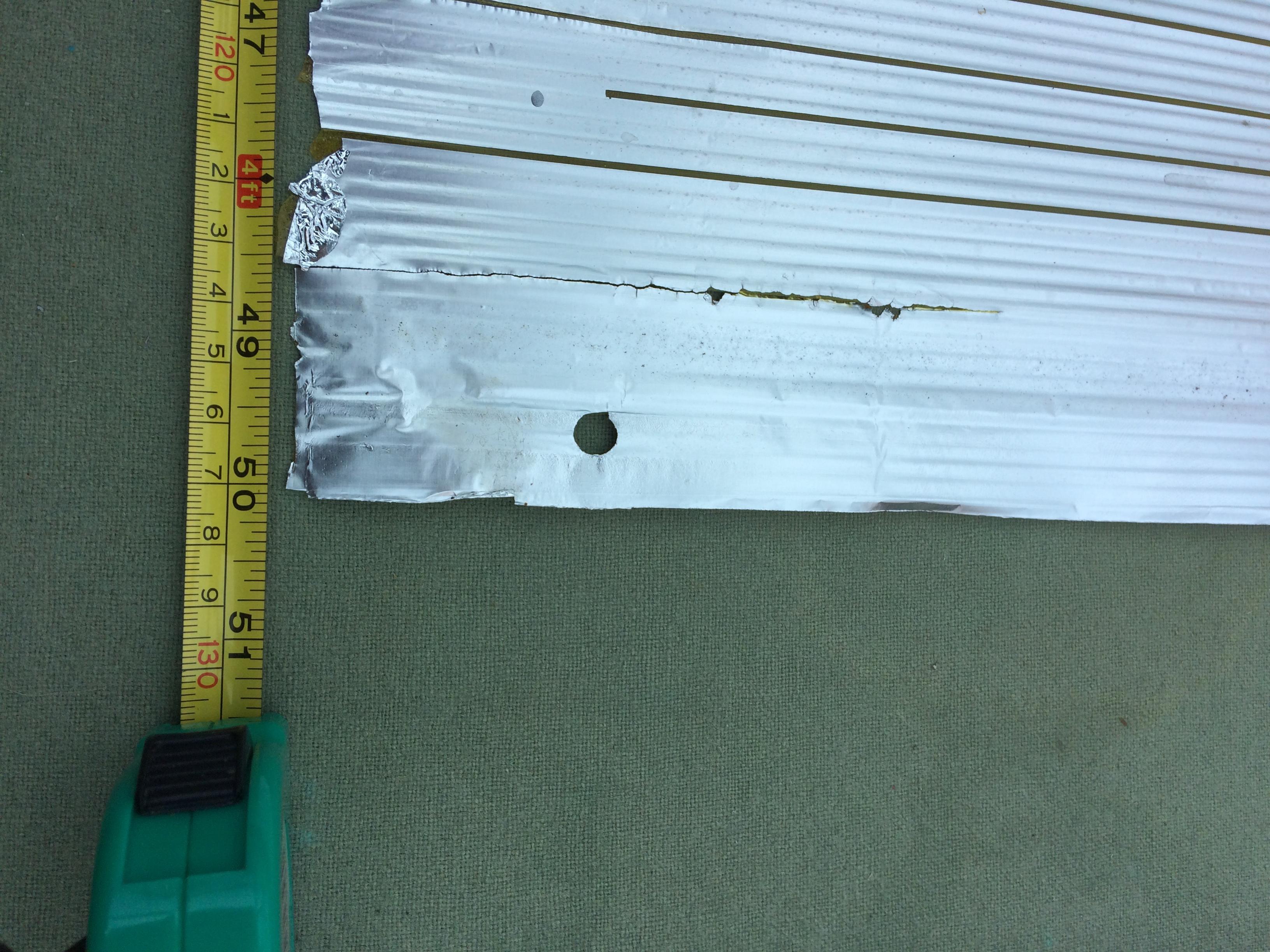

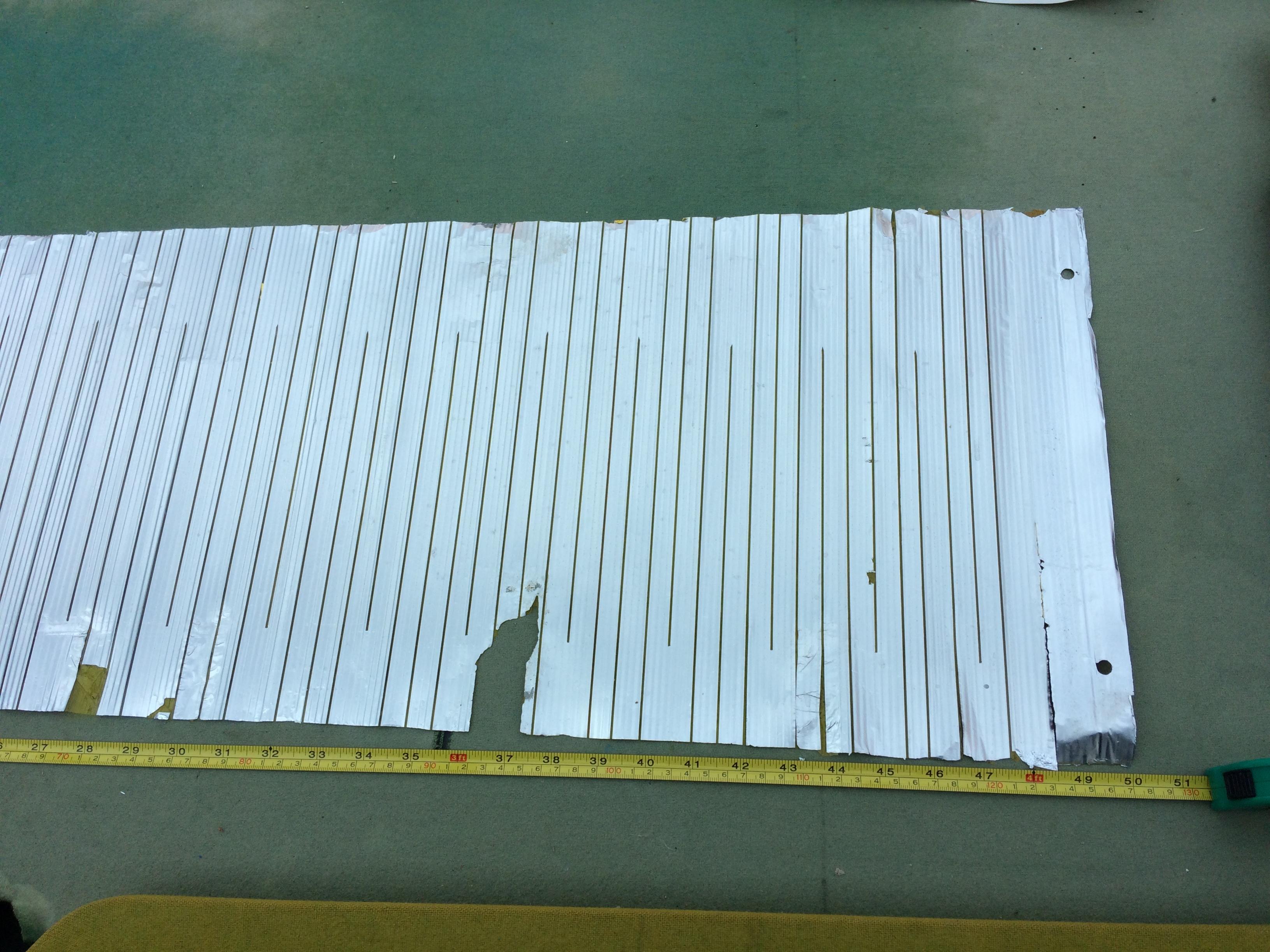

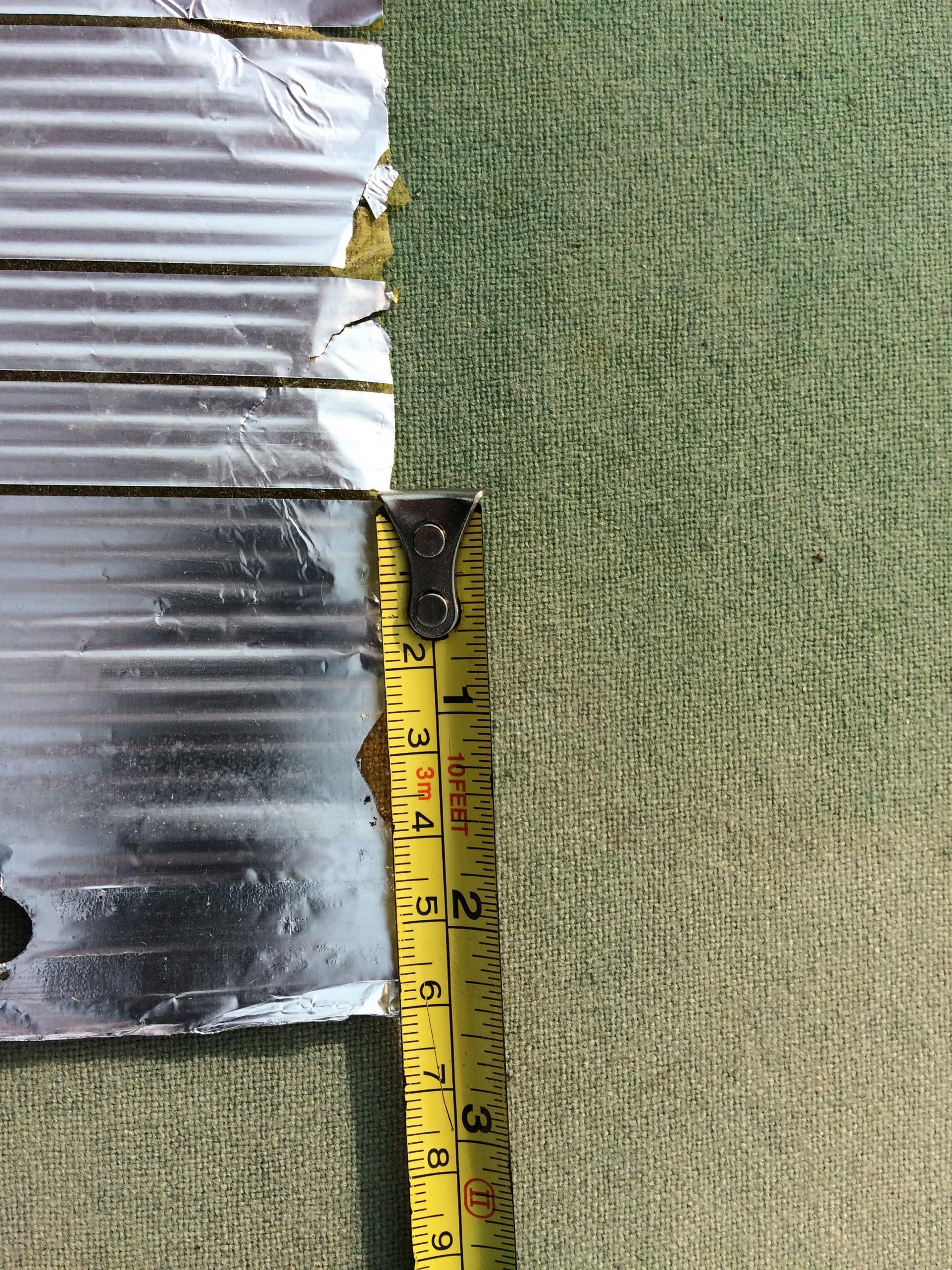

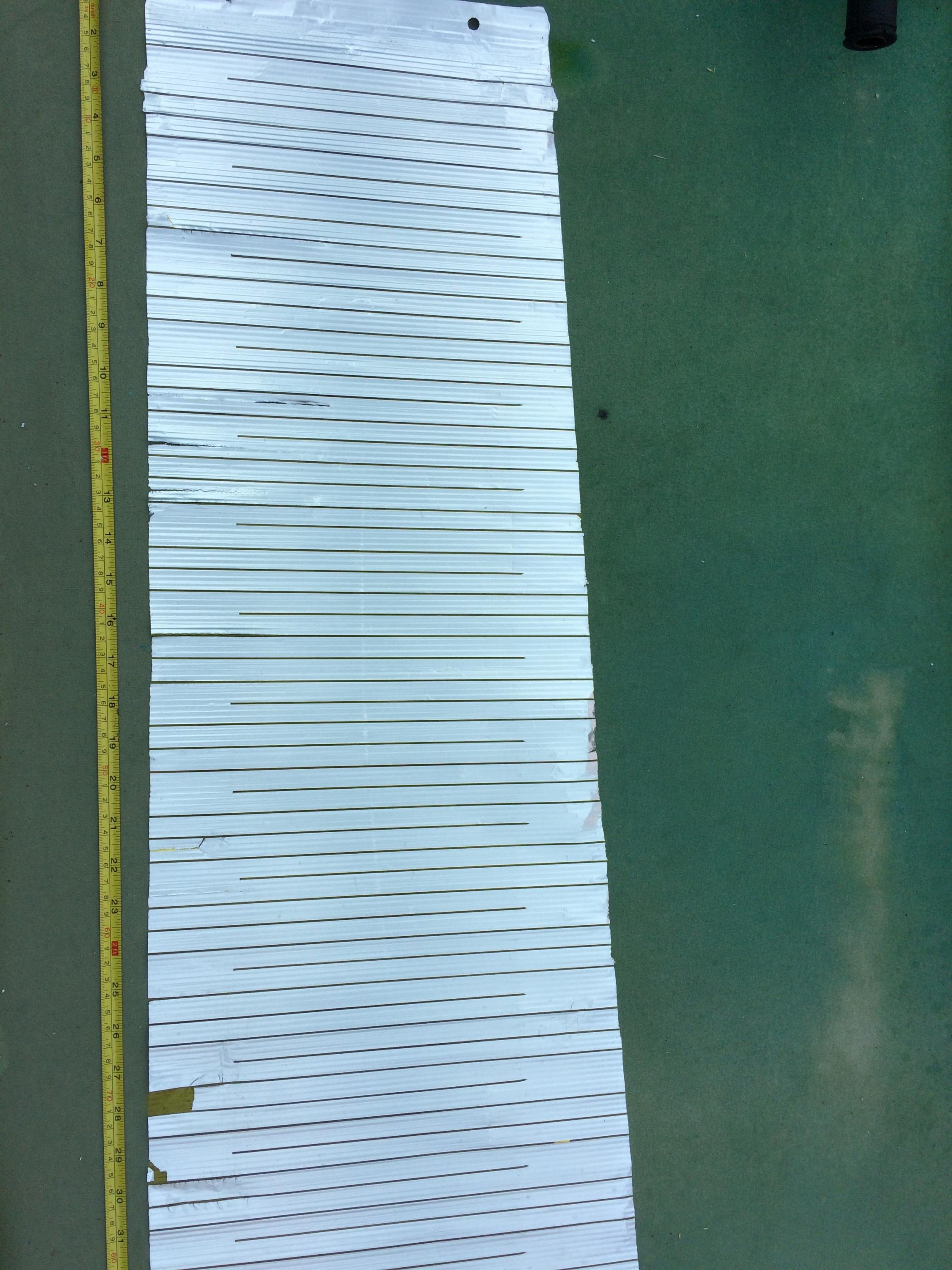

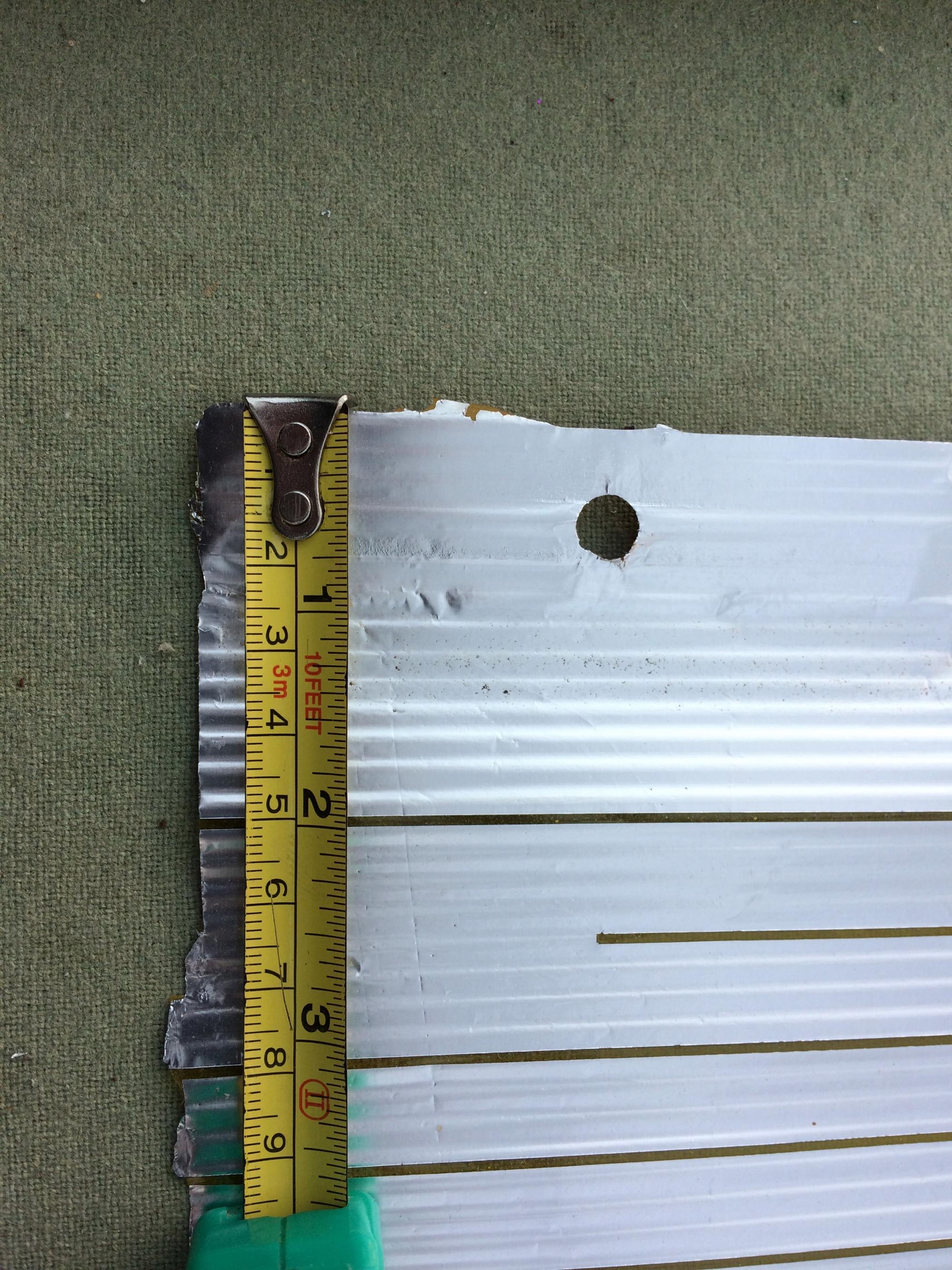

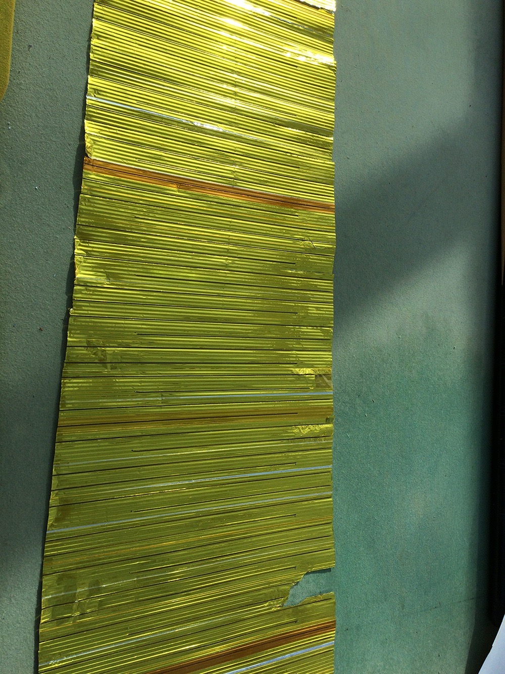

I Have a Duetta Foil rolled flat as best I can prob another 10mm

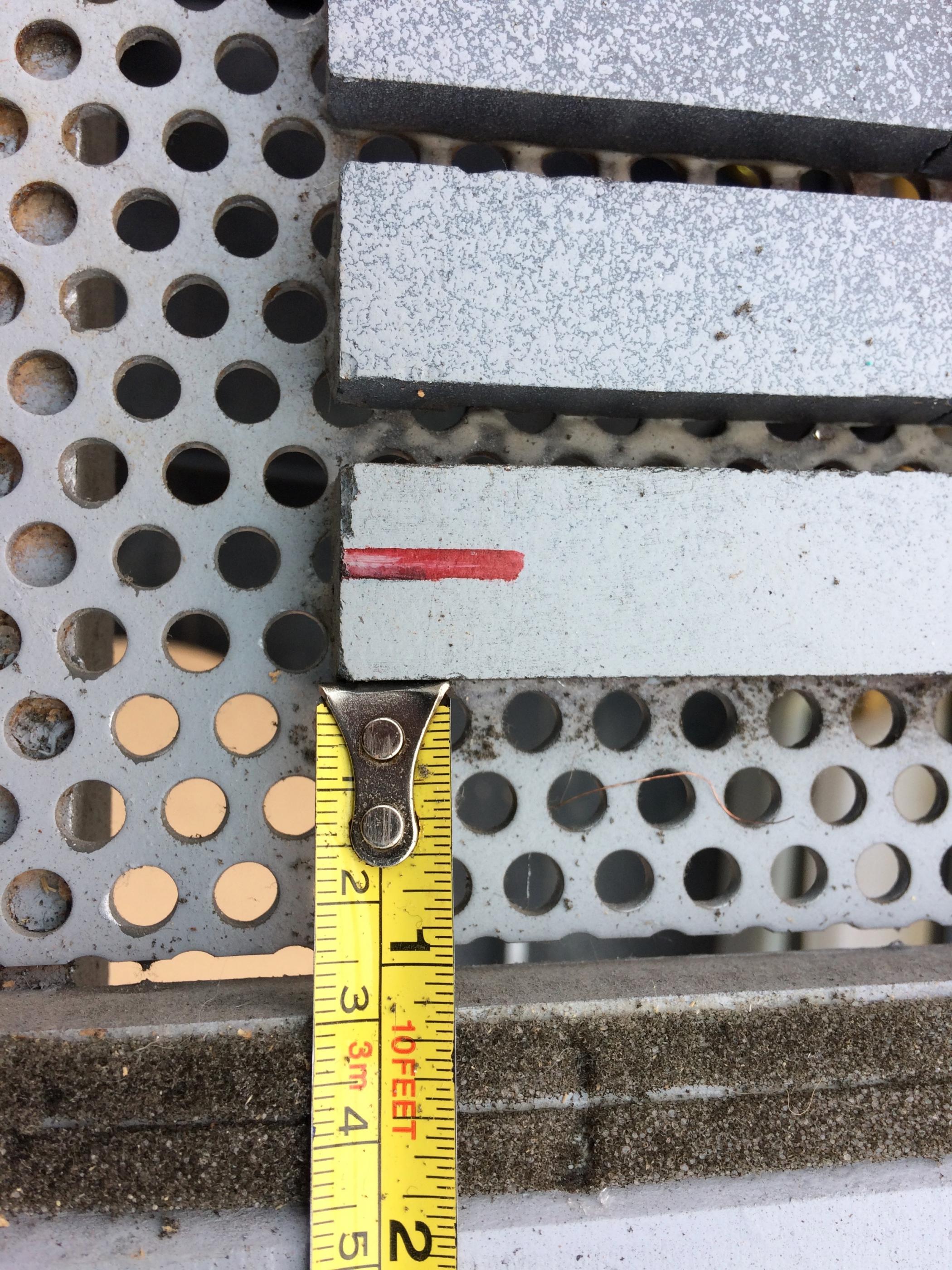

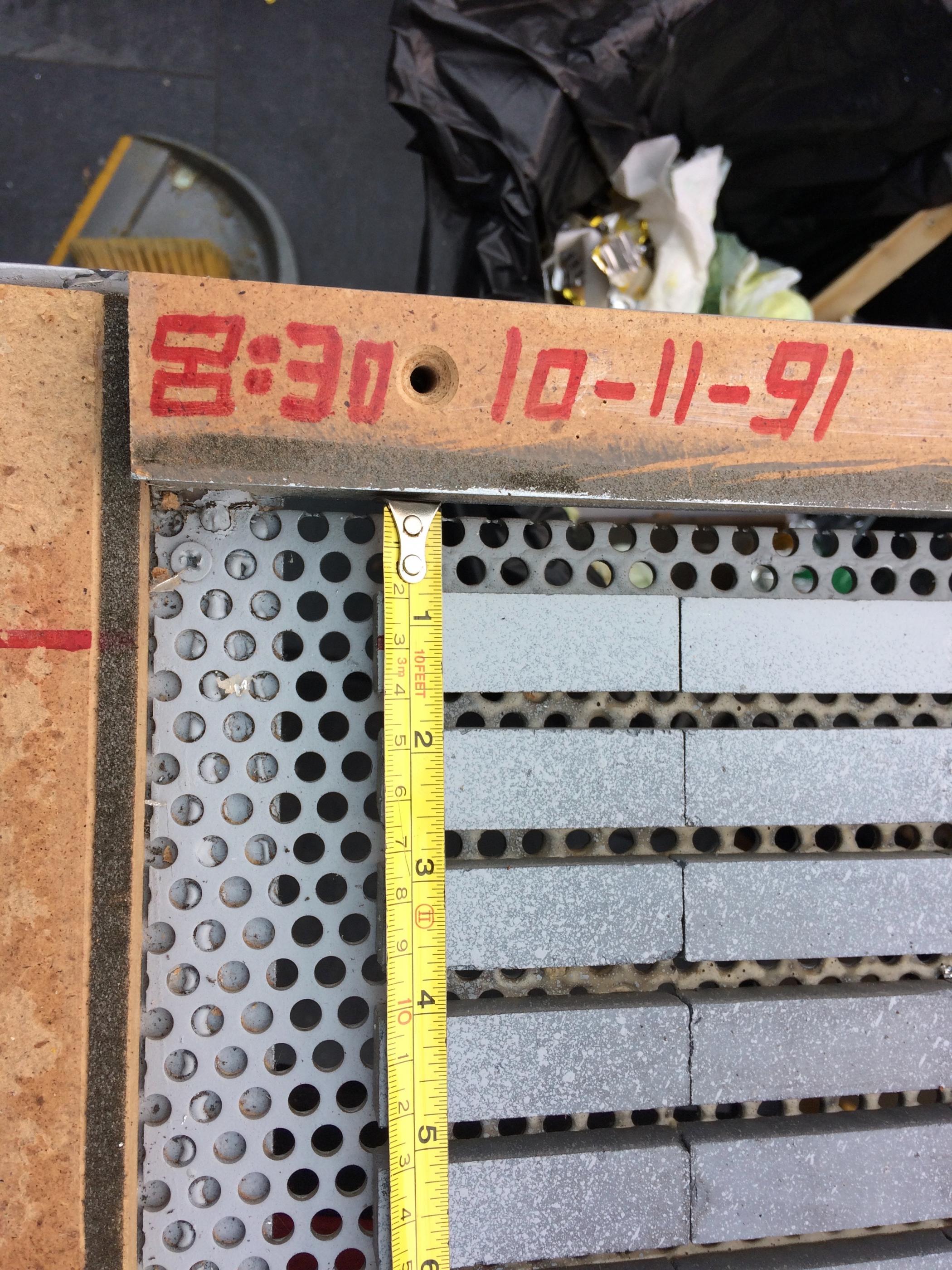

Very good, thanks 🙂. Could you please measure the distance between the first upper and bottom cuts of the flattened foil? When the distance between the first upper and bottom magnet rows is know, one should be able to estimate the effect of corrugation. How many cuts there are on Duetta-foil? When you know that, you could calculate the average distance between cuts and if the magnet rows are in the right places, cuts should be in the middle of every row.
Ok, so if cuts are about 5 and 6cm from top and bottom of the foil, and the total length of the foil is 127cm, the distance of the top and bottom cuts is about 116cm. Now just the distance between top and bottom magnet rows (middle of those) must be measured...
So the foil strips are 12.7mm (1/2") wide, that's 'think of a number and double it'.... please don't let anyone tell you their is some kind of scientific calc for this? It's like when they tell you about speaker cabinate size ...BS! it's just how many they can get out a 8' x 4' sheet of MDF without wastage! I like the marker pen bit about finishing the speaker at 8:30 in the morning?? they where 'aving a larf' as we say the UK. No, I doubt very much any 3 sets of Apogee Duetta ever sounded the same! The construction of a great speaker design is very 'CRUMMY' lets be honest? it has to be said? I would hate to hear the pair made on a Friday (16:00) afternoon after a liquid lunch? Sorry for the rant! (oops)
If you need any more measurements let me know.

Might be month and day and those outside dimensions are not important. They are part of the voice coil circuit and they can be in excess.
Unless you are using Apogees exact rollers , all the stock dimensions wont get you aligned over the magnet rows for optimum performance. BTDT.
I think Al ( deltastar) found this out like me also
What is important is your corrugator and its stretched vertical state and how it relates to the magnet rows and how you transfer those cut dimensions before corrugation.
