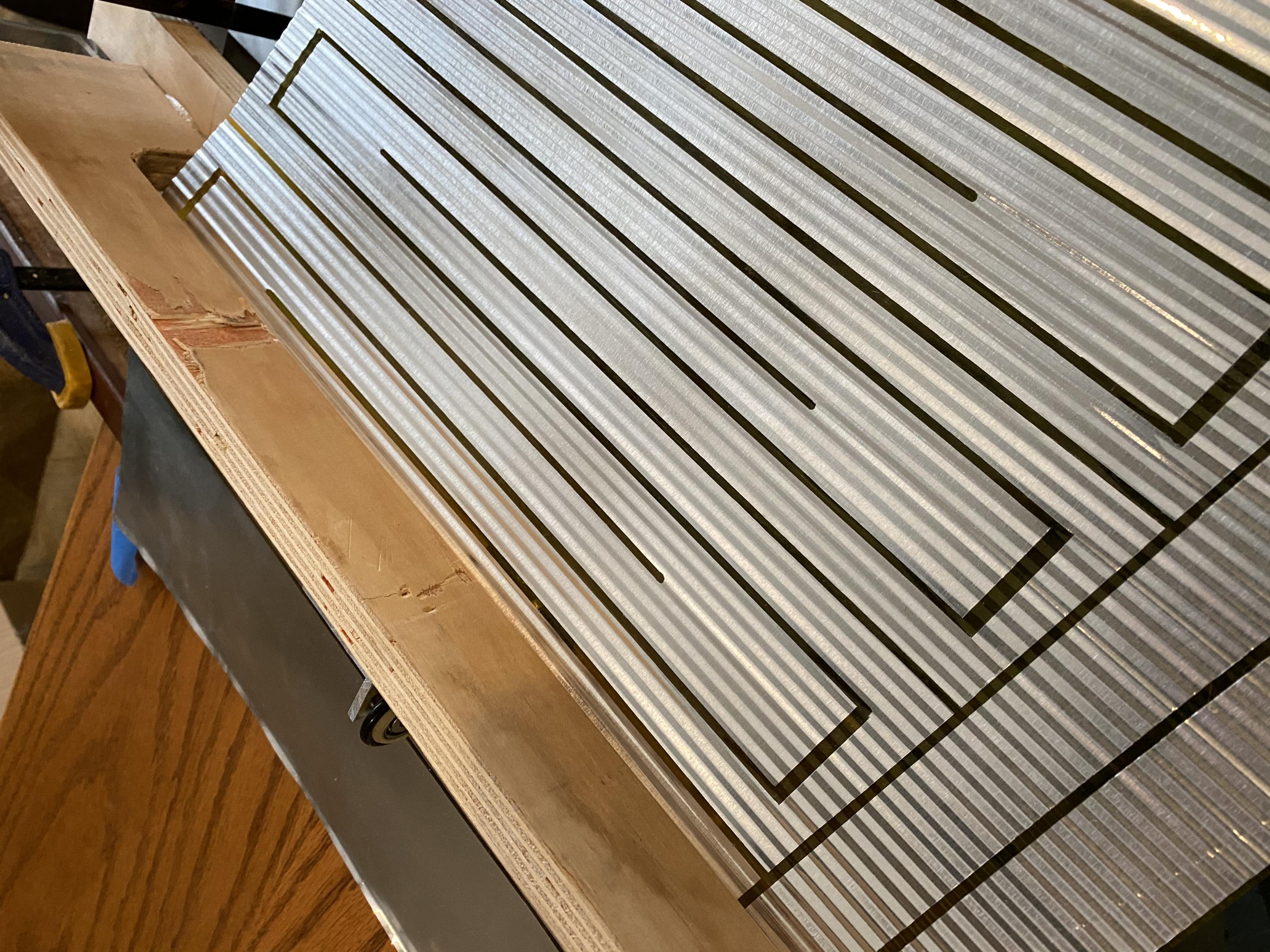

This is the mid section

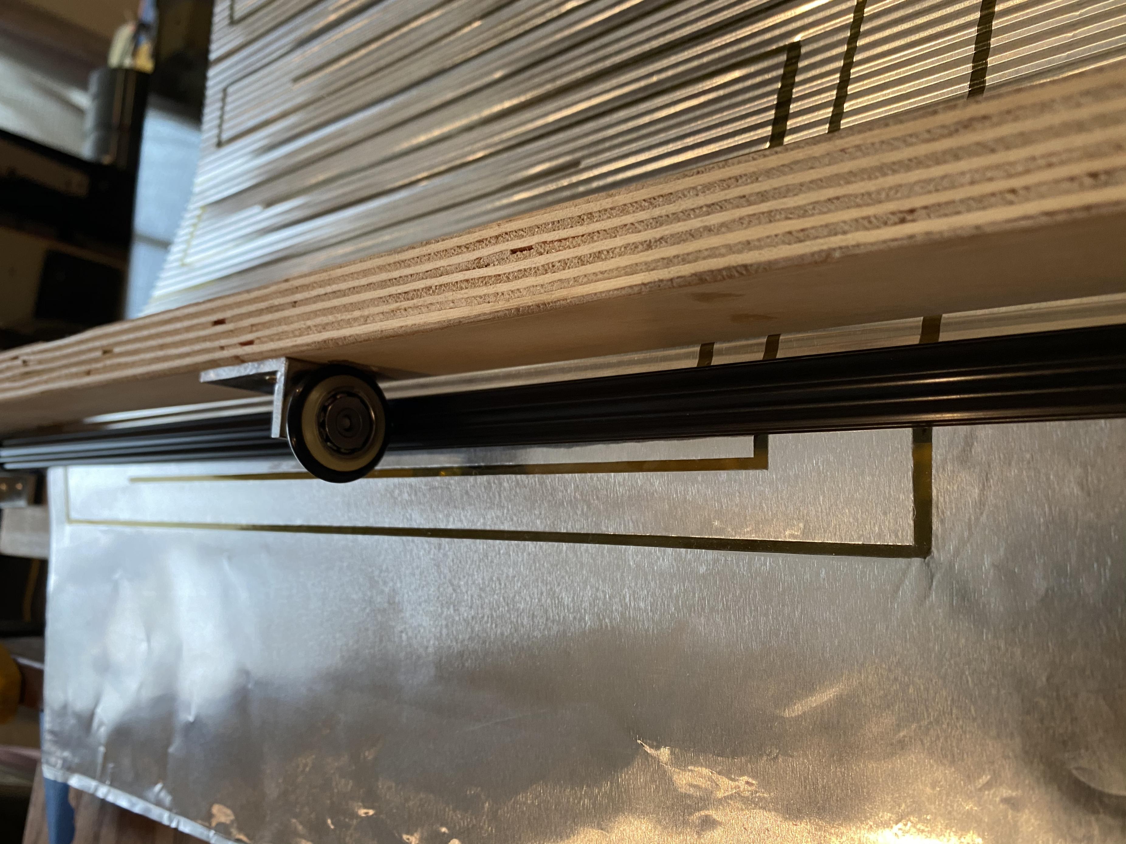

Go slow and rock back and forth slightly as the exposed glue lines want to stick to the upper rod and a slight tug releases it
A note to be made as the panel did start to go out of alignment , and all you have to do is start pulling on that side and it will come back as you continue rolling.
You cannot tell in this photo as I had corrected it a few inches back
So here I am in 6 feet , and the top section of the foil and alignment is still parallel to the rollers
It is quite easy as you go , to keep it in alignment by gently pulling as mentioned
No need to panic here !
In retrospect , 2 roller sections equally spaced would be better overall I believe and lessen hand alignment but still easily solved

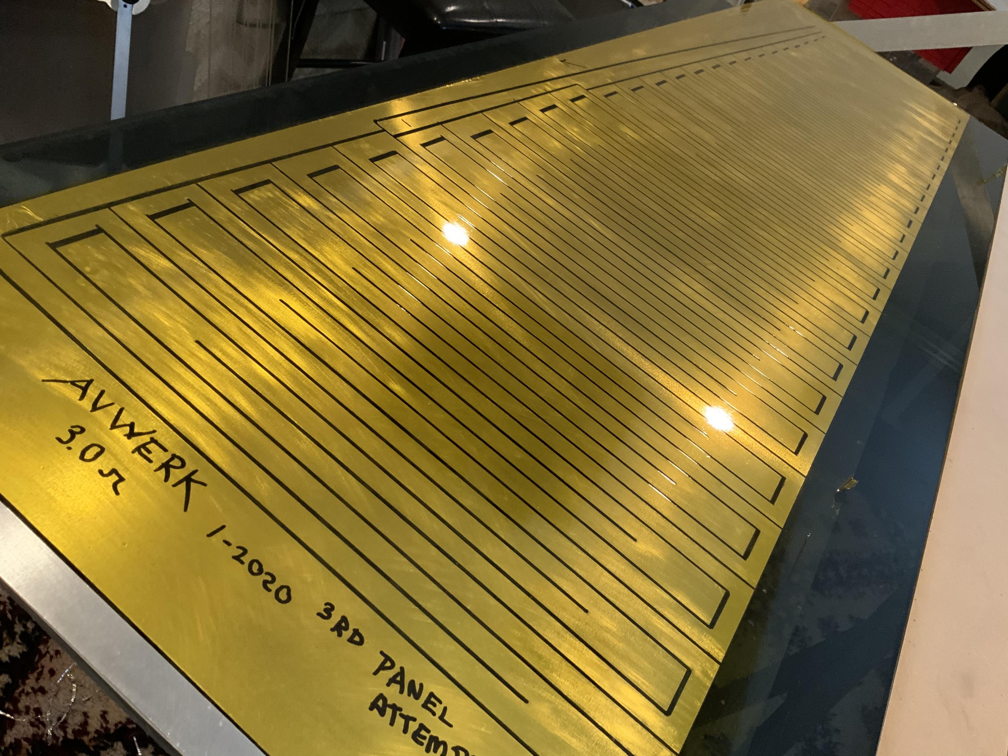

I will be making the first panel over as this one turned out better. That Kapton crease on the back and some of the open trace edges were not as good as this one . Going slower and rocking bk and forth made for a better finished panel

that looks really slick !!! nice work !!! im no fan of kapton 🙁
Agreed, great job! A couple thoughts:
1. add a couple more "support" wheels to keep the rod more firmly.
2. add a motor to do the work, with a foot pedal, so your hands can be on the panel guiding that.

The motor idea is unnecessary as you need to rock the wheels in each groove as the valley is wider than the peak profile and this rocking makes sure you cover the area completely.
This gives the ripple better uniformity
You also have to be careful of each open glue area as it sticks inconsistently and requires some TLC as you go.

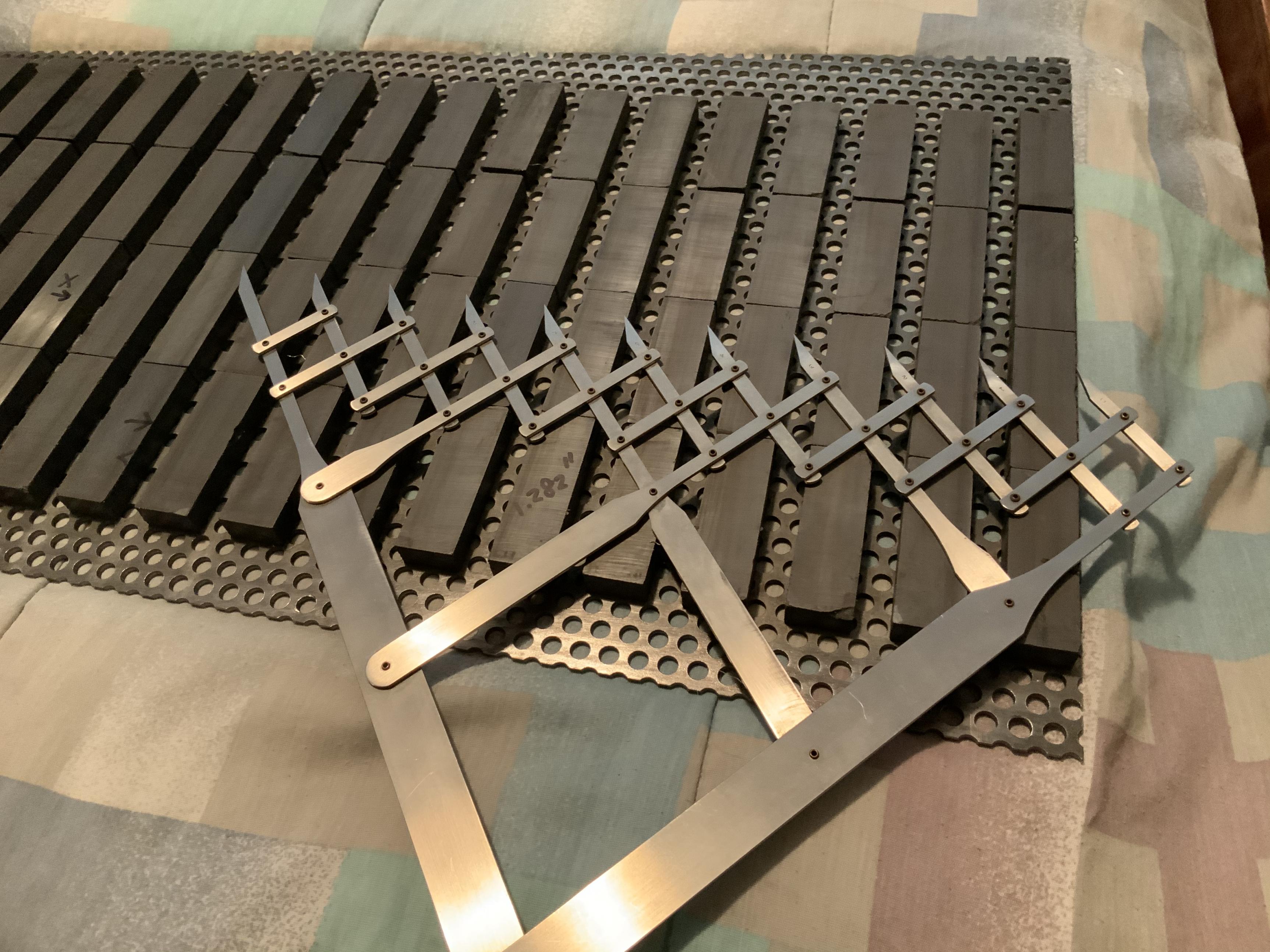

On the second panel I used this to check Diva magnet spacing.
It allows you to spot which magnet row is off if any. There were 3 rows slightly off in random spots
This spreads to 13” and I got between 1.281” to 1.300” ( Ctr. To Ctr. ) variations in each section
and made the panel to match exactly each section area
Total top to bottom magnet spread center to center Diva magnet spacing is 64 1/4”
Pulling magnet rows and moving them around was something I didn’t want to mess with

I have no idea what that is, but I want one!
