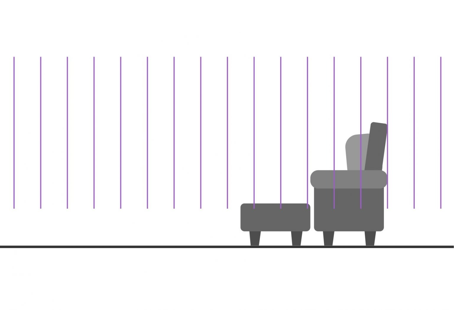

Yes, Dave, I think you’re referring to the boundary condition at the very ends of the line source interfering with the shortest direct radiation. In other words “missing vectors”. Yes this is part of the non-ideal reality of lines sources. This can be mitigated by two things. One is sitting closer to the line source as you suggest (which is the same conceptually as increasing the length of the line). When the “direct” path is close relative to the line length, the higher received amplitude from the direct path of the line can swamp the effect of the farther-away discontinuity. The second mitigation is your ceiling and floor virtually extending the line to infinity, reducing the gap. If the floor is pretty close to the bottom of the ribbon, as it is with the models discussed, there is only a small gap before the reflected image starts. Ideally a lower ceiling that just brushes the top of the speakers is ideal. This may seem counter-intuitive but it’s how the line sources can be made virtually infinite and closer to the ideal. Closer than any point source can be. Acoustat, Beveridge, Soundlab and Infinity used to make floor-to-ceiling speakers to take advantage of this effect. In practice the ear can still take advantage of a non-ideal line source to create magic. I argue more so than with a point source with its many destructive reflections.
Here is a pretty decent non-technical explanation of line sources:
https://counterstrikess.com/line-source-speaker-advantages/
