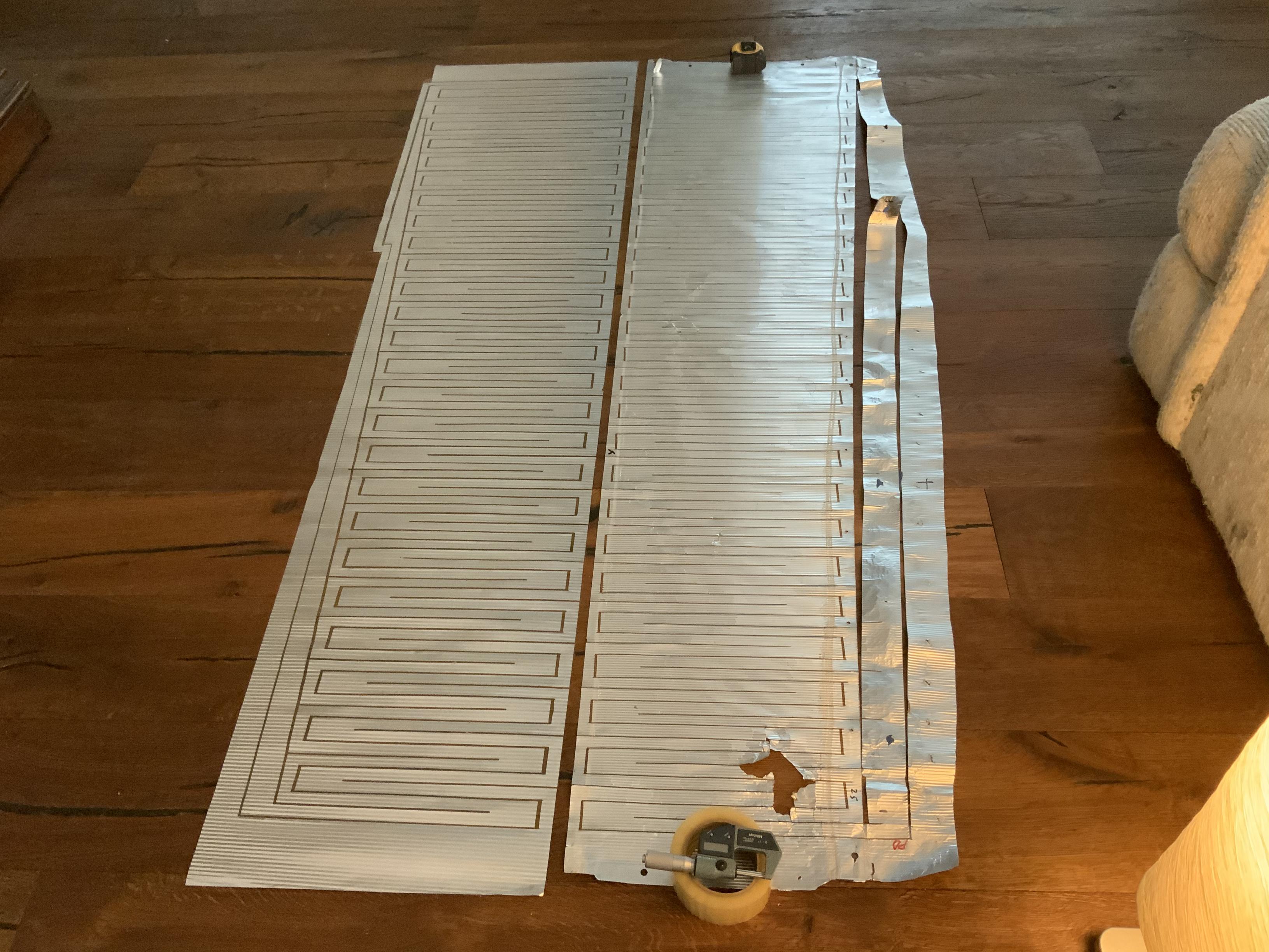

The laminating process is the white knuckle time since your trying to lay a big
Sticky sheet 20” x 72” on top your traces without disturbing anything and also trying to
Prevent air bubbles.

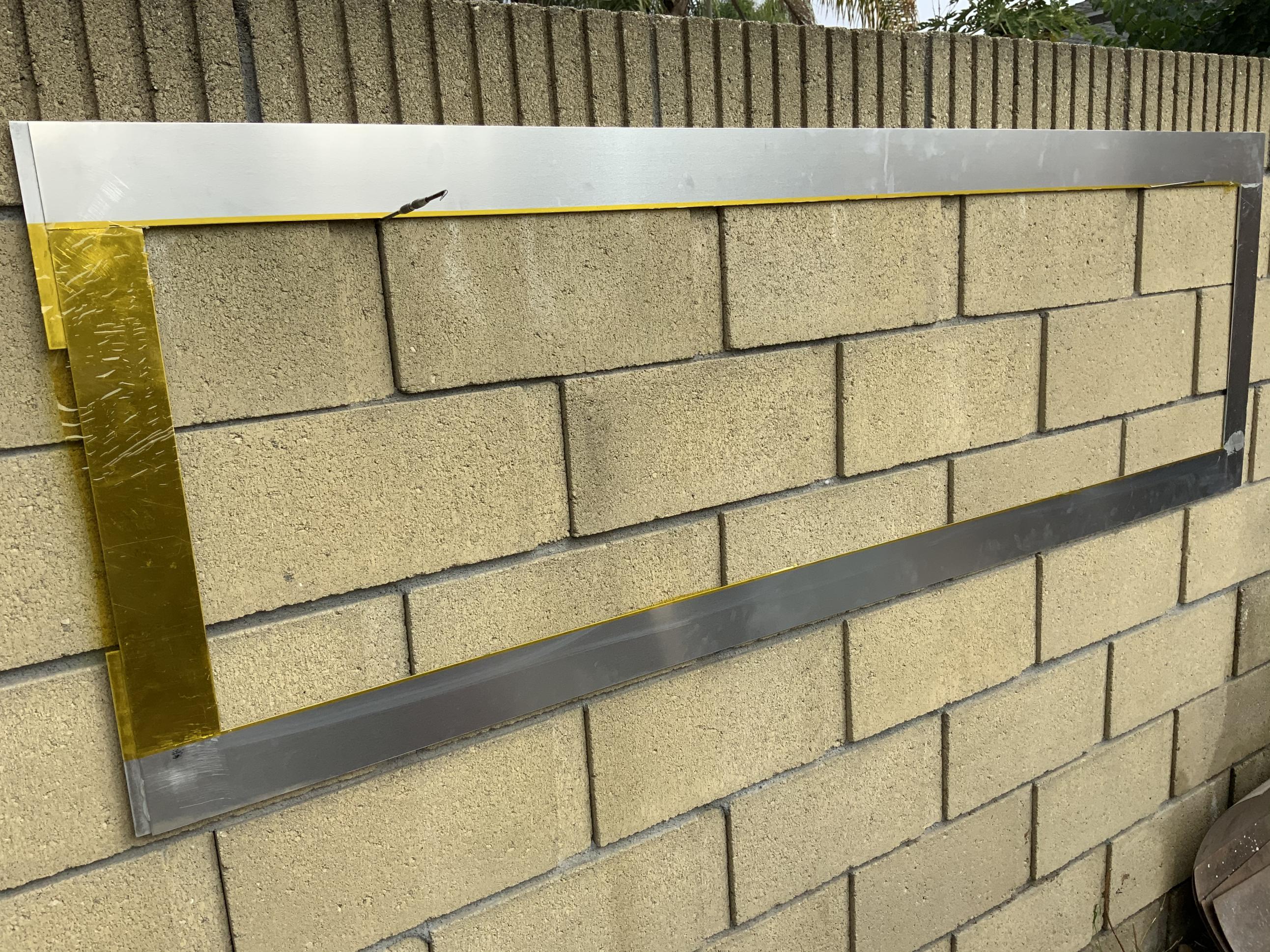

I made a picture frame of 3” wide pieces of aluminum where the inside border is 1/4” smaller than the outside dims. of the Kapton for the purpose of being able
To stick the sheet to it , so as to have a taunt film before positioning over the aluminum
Sheet.
You lay the kapton stickiy side up on a big table and place the “ picture frame “ on top and
Press down around the edges.
So now you have a workable and taunt film ready for placement..

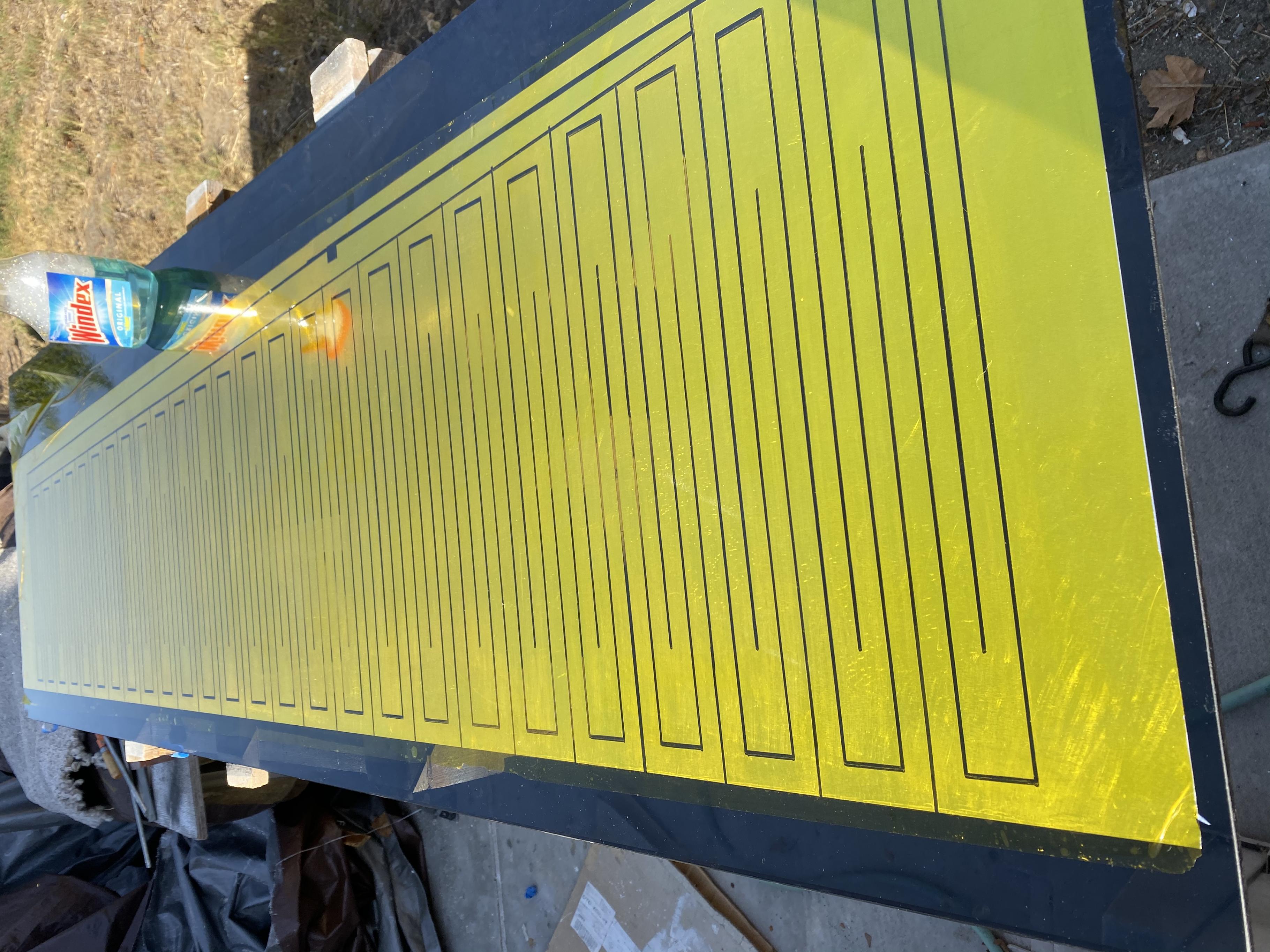

ok yes I too put the film on a frame under just enough tension to flatten out. Lay down over the foil, and work from center out to avoid bubbles. Care taken to work it all in a gentle way that doesn't move or stretch anything until all is down and no bubbles . Then can go back and rub down with more force
Because you dont know the amount of fluid the problem becomes trying to move too much
Liquid in certain areas.
This is where I did it in 2 stages meaning if you try to squeegee too fast, that “Wall of liquid”
Will start folding or wrinkling your Kapton against this wall of liquid. The stuff is .001” and cant compete with too much force
I took a small diameter Paint roller (7” 1” dia foam ) and first you move at right angles (your flushing down the traces of aluminum ) out to edge.
Your trying to equalize as much fluid as you can before using a squeegee. You wind up with small ripples ready for the squeegee
Important that you relieve and round the rubber corners with a belt sander or something
because that sharp corner will ripple your Kapton and your toast.
Spray or wet the squeegee side with Windex or water and start looking thru the film and you,ll get the picture on fluid exiting out to the edge.
Right angles work best against the traces. Keep pressing hard until you see no more liquid
Coming out the borders.

Dave what "fluid" are you using to help with Kapton install? I usually use distilled water with a little soap and some alcohol mixed. Sort of like Windex but I know whats in it

On test sheets I tried distilled water and 2 drops of dish soap and it worked well.
I did use Windex as the layer. I had 3 cans of CRL window cleaner that lost it pressure so poked a hole in some spent cans and mixed it in with some windex
So its not all windex but close enough..,
I sprayed the glass section pc and the upright Kapton sheet before placing it over the table

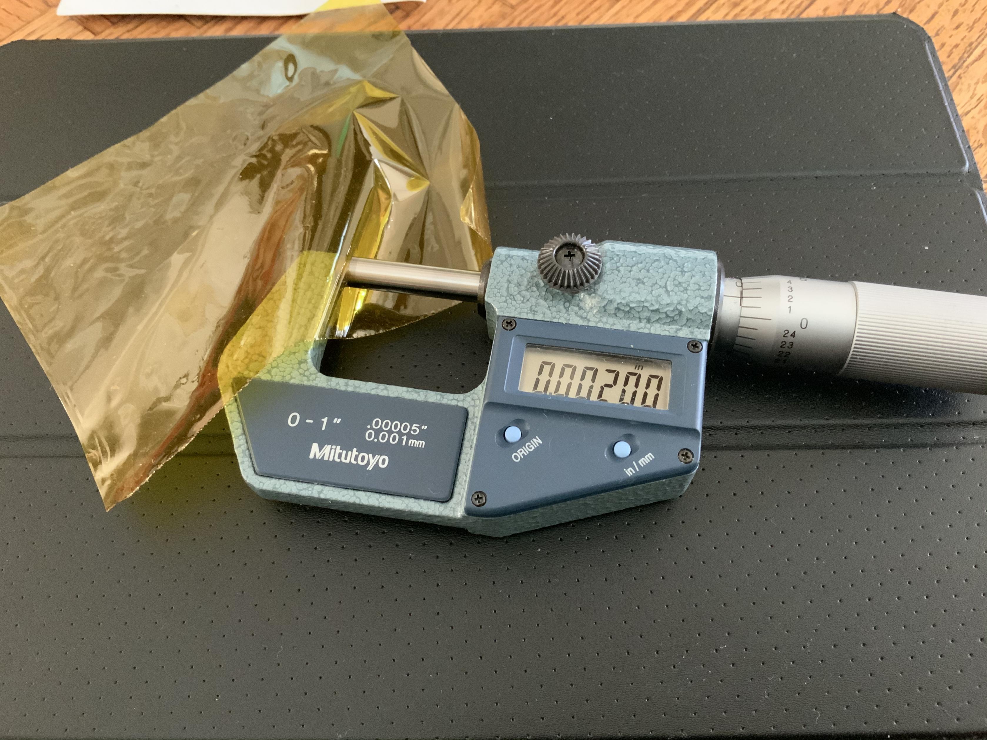

On the thickness of .002” ( glue and foil) you do need some material strength as it is under tension for bass

So here is the corrugation and its not like you can find an abundance of choice out in the market on what will work.
We do want a cheap solution to work with.
Even though it doesn’t match exactly, the actual height is in comparison is the same although it looks higher.
My cuts are bigger and that will more than likely result in less output but every frequency graph I have seen on Apogees shows huge bass gain relative to the rest of the spectrum.
The Scintilla being one of the worst at 10 to 15 db so maybe a good thing in the end.
Time will tell and a new template with thinner cuts is possible.
This is the first panel attempt I made so go easy

First panel attempt and it should pull taunt when pulled horizontally
Although its hard to see, near the top the Kapton got a small diagonal ripple I mentioned earlier in application
And when stretched it might be an issue. I will have to apply heat when doing this, so as for now , I will consider this panel a fail and might remake it.
I have my doubts on this one
The second panel was no problem and was able to equally squeeze out evenly
You live and learn...
