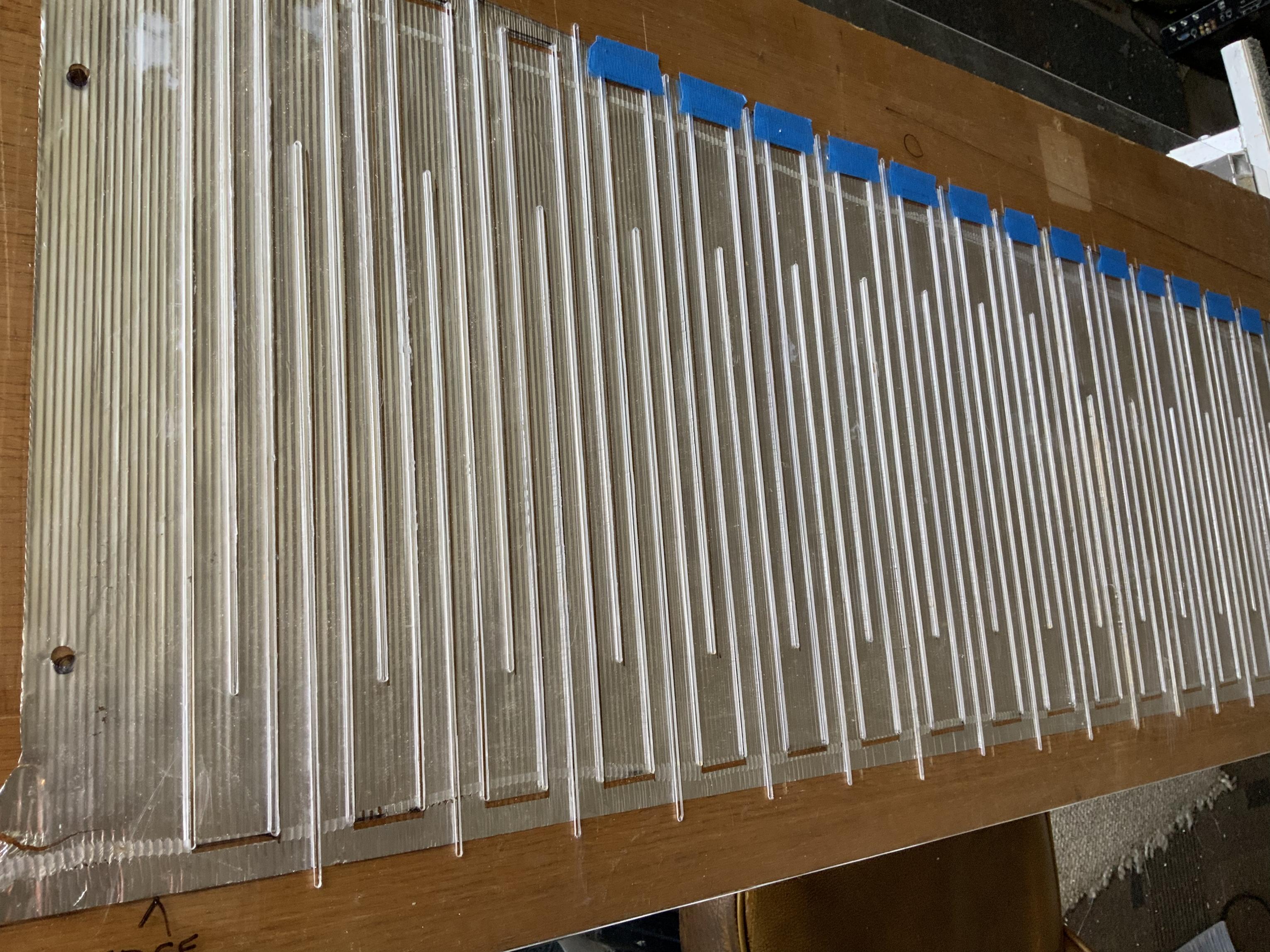

I think you don't need the corrugations for the sound but only to make it possible to install the bass panel.
Because it doesn't bent and you can stretch it one way.
I made a wooden frame stretch the Kapton on a flat table glue the frame onto the Kapton.
Later when I cut the aluminum I glue the frame and kapton over the aluminum.
This way its alway wrinkle free.

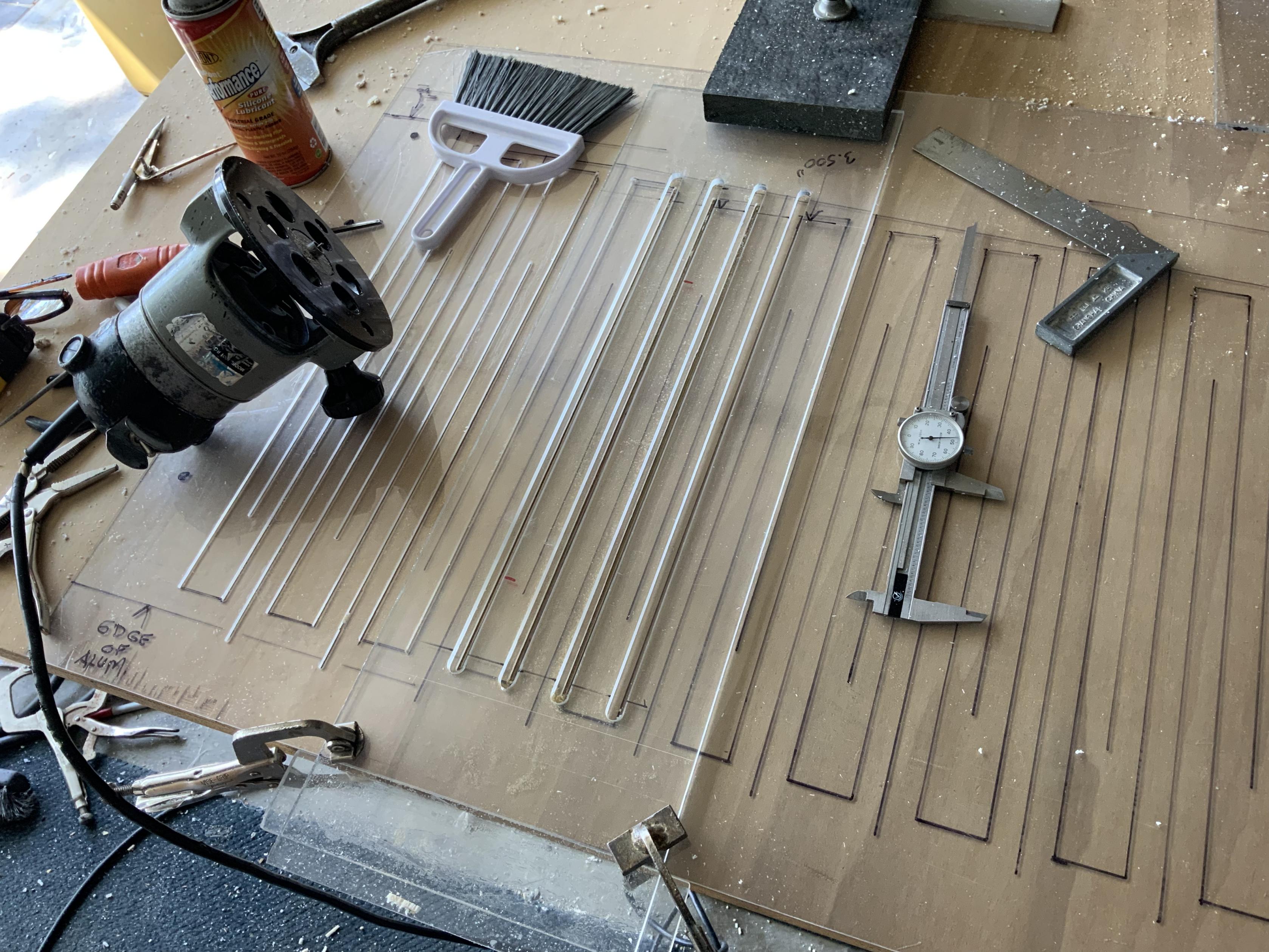

I did add up and check the magnet spacing dimensions along with the corrugating jig and its reduction dim. To make sure when its laid out, that each division is squarely over each row of magnets.
Regards
David

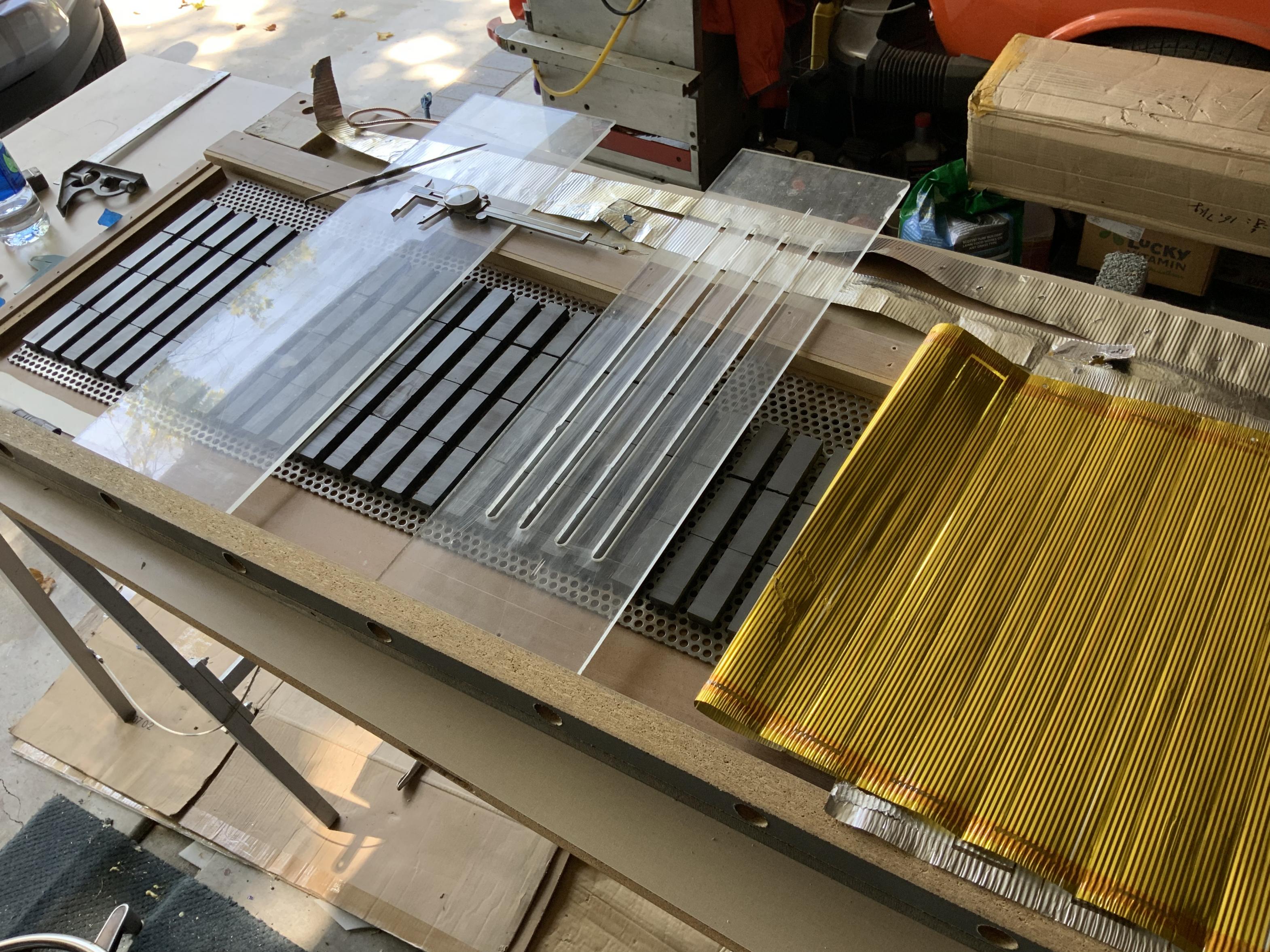

The foils I used were soft temper 1100 pure aluminum in 18” width -.001”
I believe the soft temper might work better on midrange and tweeter foils with better internal damping but after experimenting with 1 foot wide pieces, I found for the bass panels the hard temper 1100 aluminum works and handles better overall IMO
You can tell the difference in grain. It looks like it has been work hardened thru rollers possibly before being rolled onto the tube. It is the same 1100 material in either version
A stock Diva panel is 19 3/4” wide so 18” width requires some manipulation to connect
The “voice coil” circuit . You have to get creative here and think it thru
Grainger sells the stuff and its not to expensive at 18” widths both .001” thickness

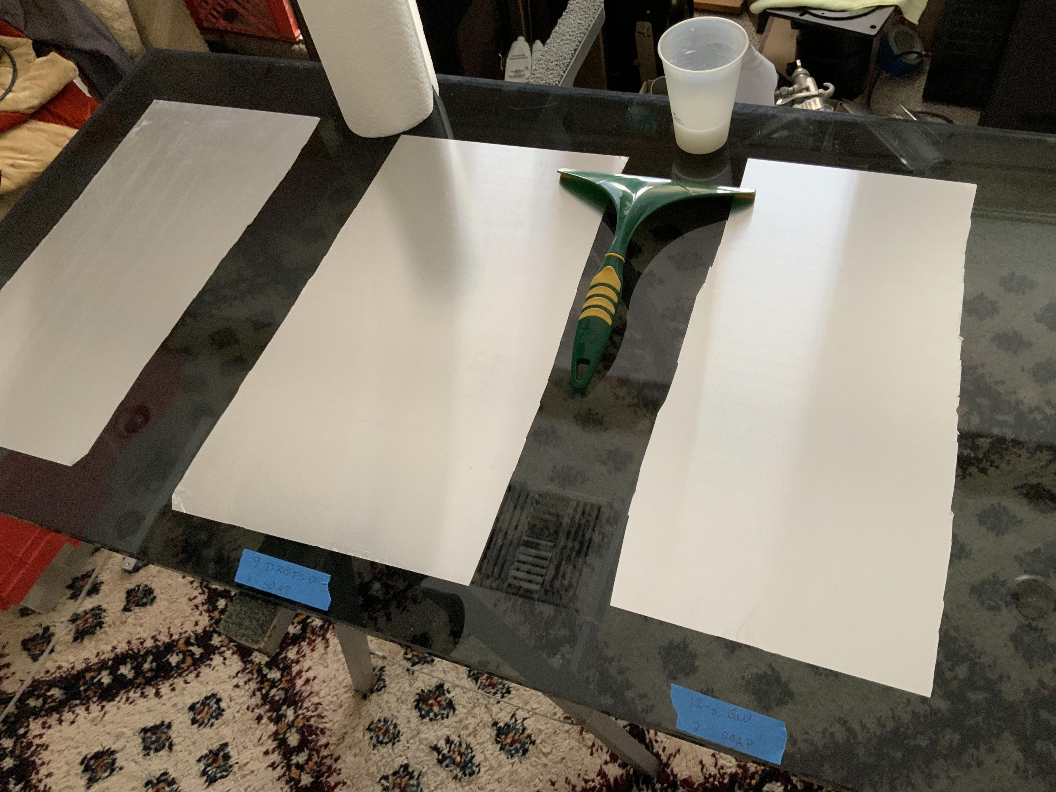

Holding the foil down on glass so it doesn’t move around is another issue.
I tried 9 different combinations of distilled water with soap,and yellow glue.
Ivory soap and water corroded the foil if left too long.
Water with drops of various soaps or glue or just water/soap all corroded the look or discolored the face surface.
If you act fast enough you can probably get away with water/soap combo
You would need to acid etch this surface to clean it up unless you found a coated foil of some kind
The best most workable hold down liquid that did not affect the hydraulic action necessary
Or corrode the pristine surface was WD-40.
Spray on glass and squeeze the contents out with a rounded corner window squeegee
The rounding of the squeegee edges is important as the sharp rubber corners can streak or bend the foil as the Wd-40 exits to the edges. It doesn’t take much force to bend .001” foil
