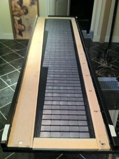

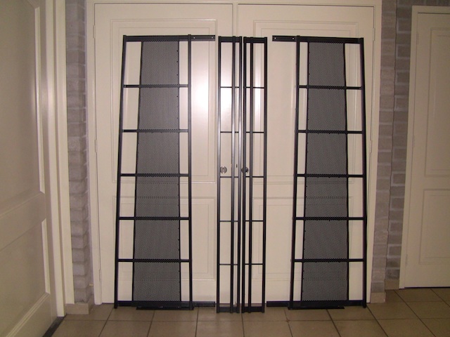

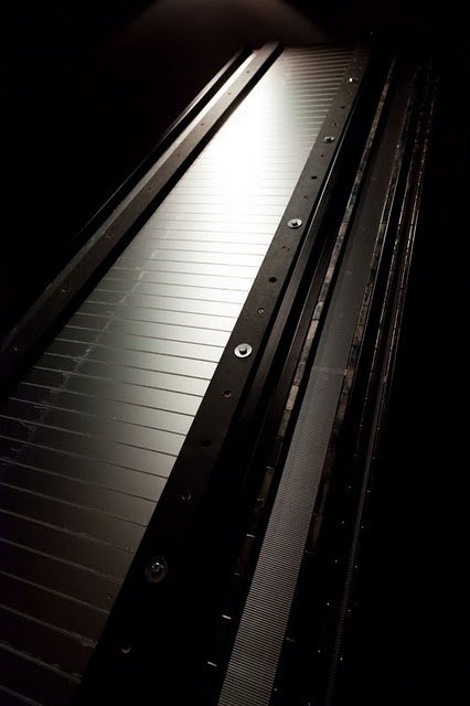

Hi
I build my own apogee style speakers only with neo magnets for mid high and normal magnets for the baas panel.
I cut a 1,5 ohm bass panel from 18u aluminum and glue it to spinnaker cloth witch is 30 gr/m2 and no corrugations and I'm very happy with the result.
I also build a panel with 25u Kapton and 18u aluminum but listened to only one panel still building the second one.
I also want to build one with 6u Mylar and one like Analysis with a rubber surround.
I first cut the aluminum on a glass plate stuck with soap.
Then I glue a frame on the Kapton when it's dry I glue it to the aluminum and mount the frame to the speaker.
Still fine tune the methods but the result is already very good.
Rob

I'm truly impressed
Hey Rob,
that's fantastic
Wow. Lookin' gorgeous
Did you measure the resonance of the bass planar?
What effect has the absent corrugation regarding fres?
Really stunning. Nice to see.
Regards
Olaf

That is some nice work. What type of blade did you use to cut the slits in the aluminum?
