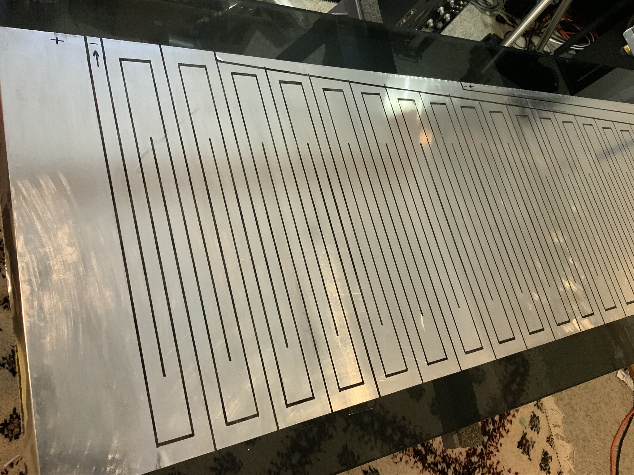

Cutting the foil is easy as long as the edges are sharp.
The triangle ceramic sharping stones keep the xacto blade sharp.
Every 3rd trace I would just resharpen an edge instead of replacing blades
continually

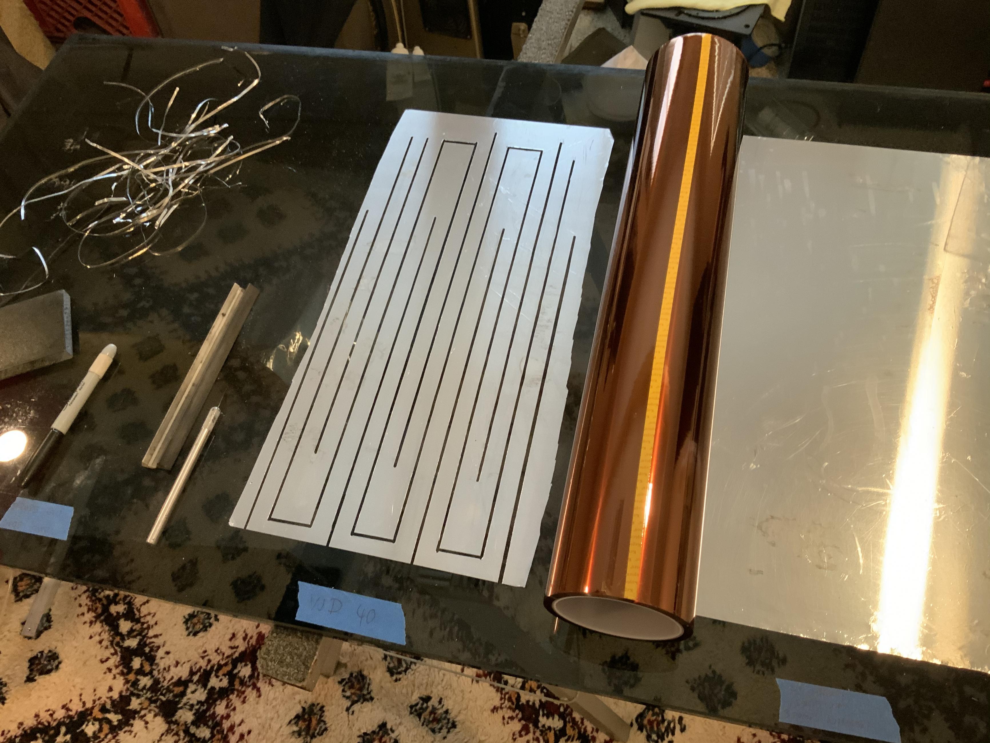

This Kapton roll has silicone glue on one surface BTW.
I did purchased .002” Kapton raw without glue the first time and was going to use thinned contact cement.
After experimenting with this idea , that got jettisoned quickly in favor of the pre
Silicone glued Kapton sheet. - superior in every way but other issues that make it difficult to use and handle.

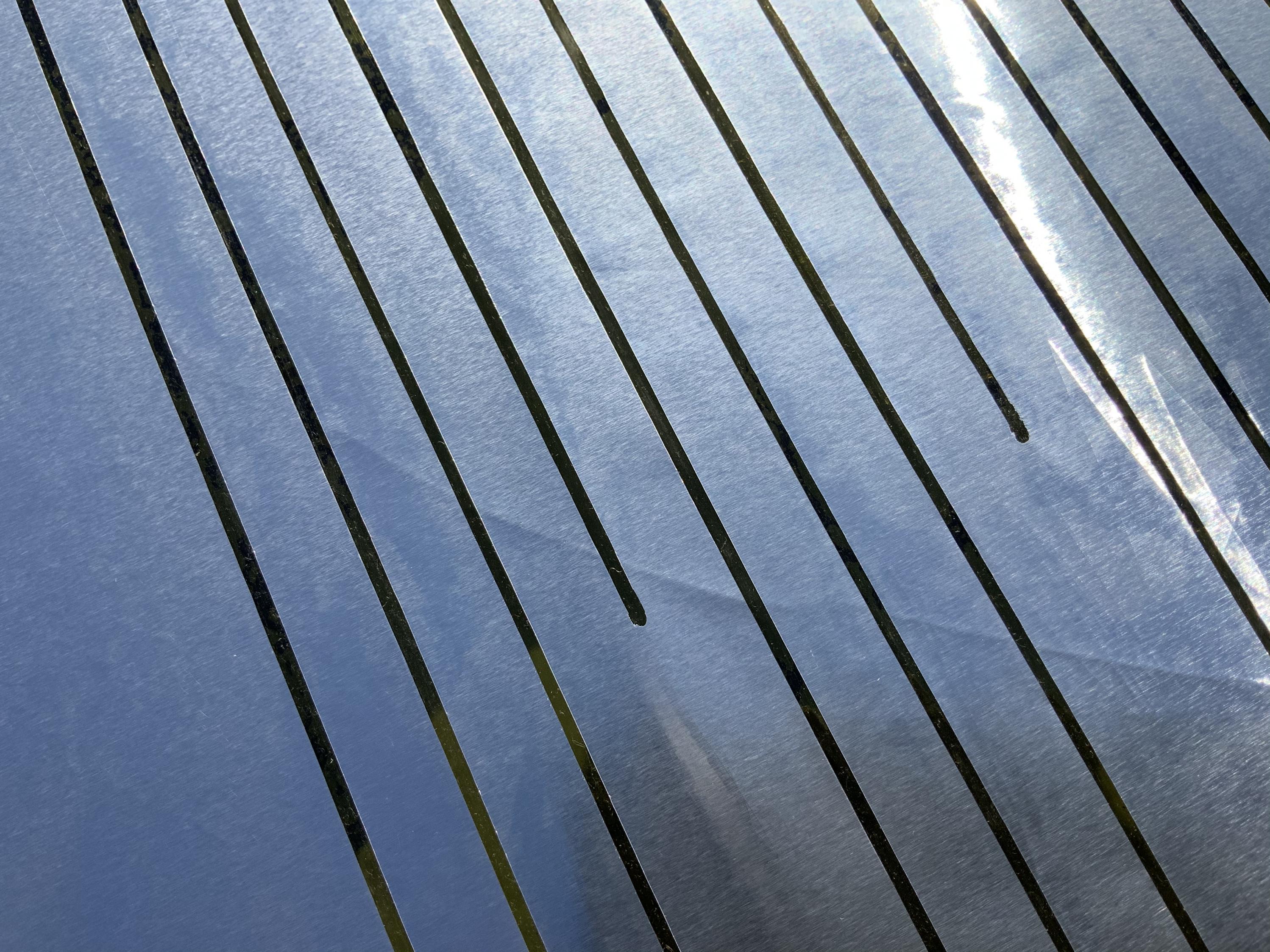

Upper left you can see a crease again
This was my first full height Diva hand cut panel and a learning curve to go with it
This represents the Kapton glue side and the crease goes away after corrugation.
Another aspect that need addressing is lightly sanding the rough cut edges

As far as glues go their is no comparison to the adhesive backed premade Kapton foils.
You cant beat the evenness with any spray adhesives. Spray 90 is superior to 77 at any level if you go this way
I will post the process of how to use this Kapton without getting air bubbles under the foil and its a tricky process to do it right and probably the toughest procedure in this whole sheebang

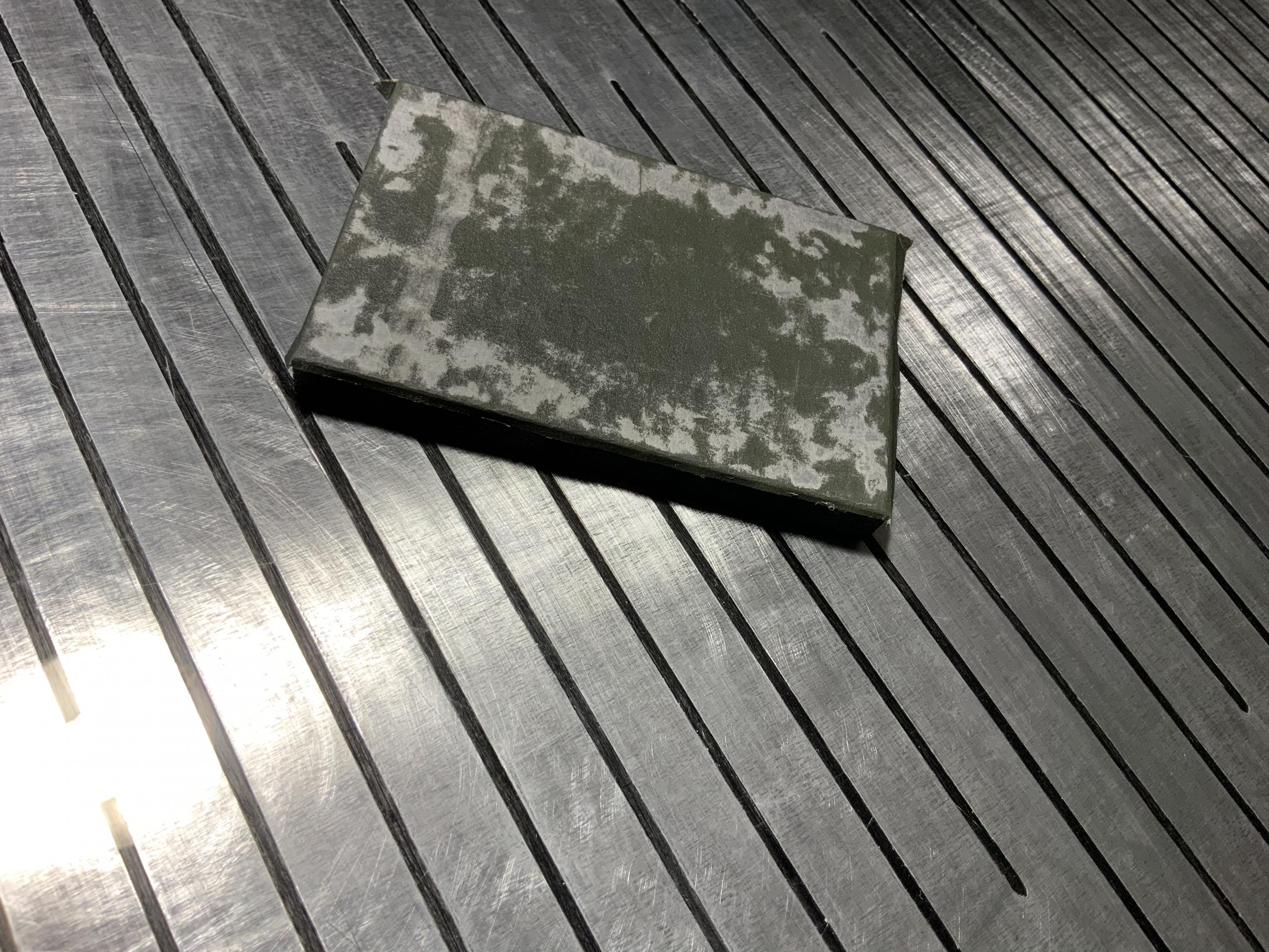

The hand cut traces will require some light sanding to remove rough edges
I spray glued some 400 grit to a 1/2” acrylic block with slight rounded edges so as not snag an edge.
To go all this way and ruin a pattern will drive you to drink,,, so go easy
This is important as the thin Kapton could be scratched or even punctured when you tension it horizontally
The stuff is fairly tough in itself but not when it gets a chance to run away from a weak point you create
Cleaning the sandpaper back to original just spray some Lime-a-way on it and in 30 seconds with some water, it will be gone completely.
If I decide to make mid ribbons I believe with a weighted sanding block, one could easily get the .001” foil down significantly before
Before adding the Kapton but thats for another day

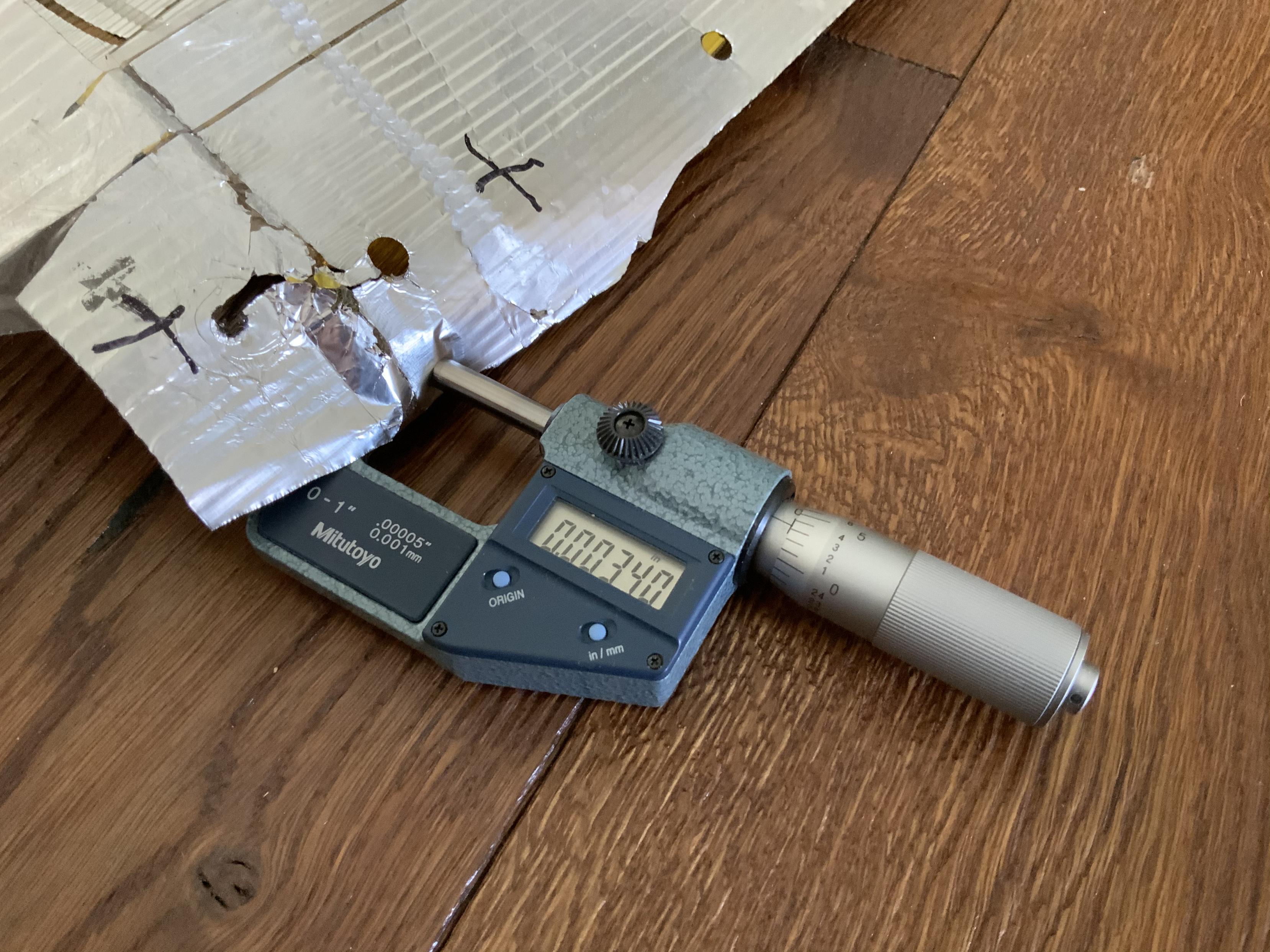

Somthing doesnt look right in your measurments.

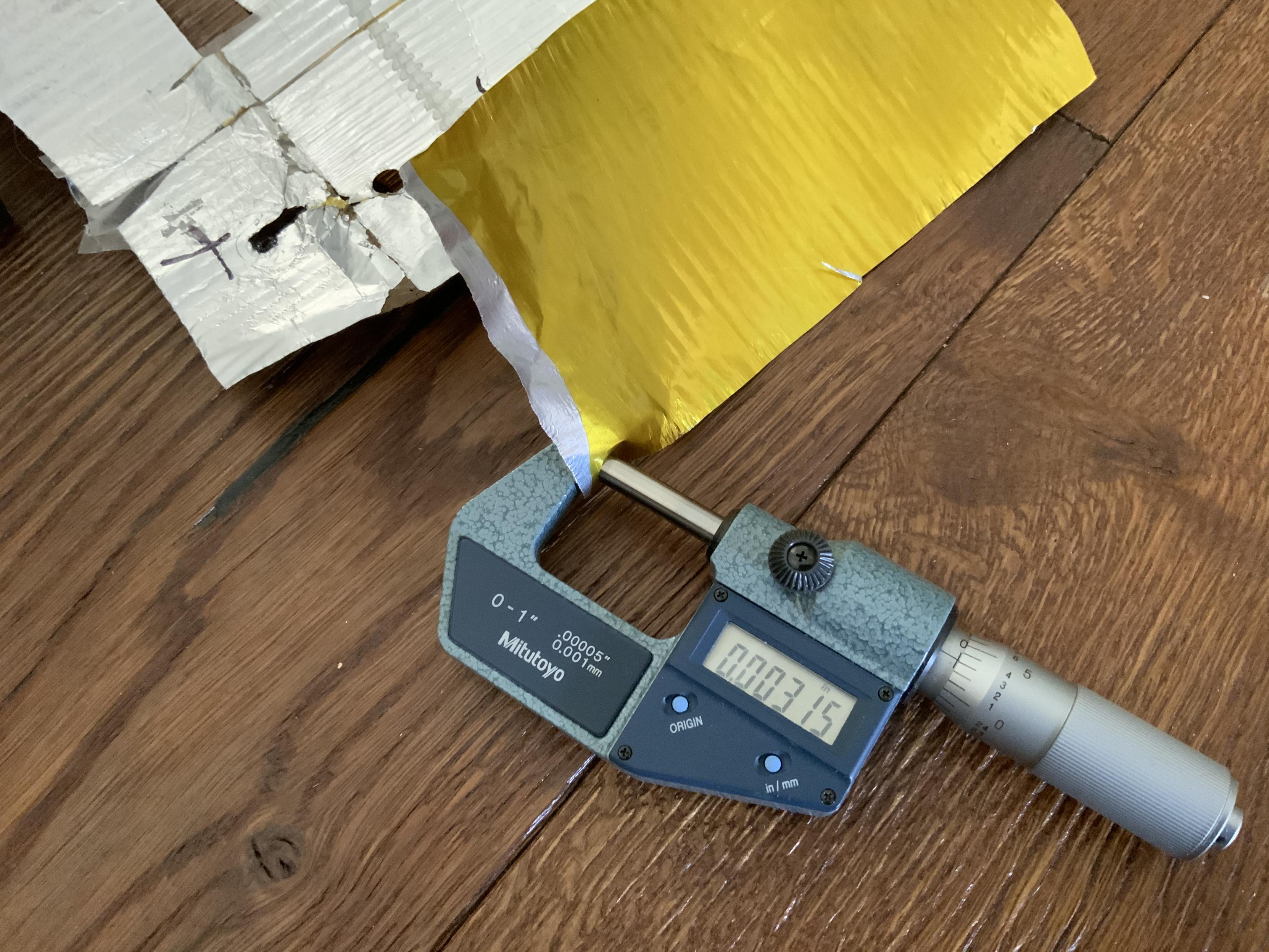

I have actual roll of original Apogee laminate from many years ago
foil is .0007, silicone is .0003", kapton is .0003" total of .0013"
not sure but this roll may be to make the Stage MRT
Anyway in my own experiments ( hundreds) making bass panels from all combinations of foil/adhesive/backing thicknesses I found that if u stray too far from the above formula you wont get same performance, and too heavy adhesive and backings tend to suck some life out of the sound.
After much experimentation I can say its the balance of foil mass to dead weight mass/ damping thats key here. The Stage base panel is double sided foil so its overall heavyer BUT that extra weight is driven so not a big issue

This is from a 1989 diva bass panel and maybe they changed to thinner materials

yes it is the big issue. All the readily available stuff is generally 1 mill or thicker. Getting a roll coater to do what u want will be a 20 K $ min order.
IDK, maybe Diva panel thicker BUT my gut says different.
The Stage bass panel used Kapton and adhesives well below 1 mill and the foil was around .0007 to .001"
Also, and I was suprised by this, you would think that everyone would use MUCH thinner on the MRT. I found in my own work this wasnt nessasary, AND later find that Apogee and Magneplaner use .0007-.001 " foil on some of their MRTs.
Its hard for me to see the Diva panel being as thick as your measuring there. Even Maggie uses approx the same thicknesses I mention and I land at those dimensions through trial and error of many listening/ measuring sessions.
Sometimes it can be quite difficult to measure these laminates once they have been corrugated or kinked in any way. When I measured the Stage bass I actually de laminated a small section and removed the silicone , then measured the foil and backing
You made me want to double check to see if this digital is off as I purchased it at a swap meet
Not long ago. I did put new batteries in it and always zero the scale
I checked with another Mitutoyo MM direct read mic and came up
With
.085 mm and that equals .00346” so still ballpark measurement
Thats on a clean and flat area Apogee bass panel total thickness
With my veiner calipers ( not as accurate ) it was still over .003”
So I’m confident on this panel at least, of the measurements
Regards
David
