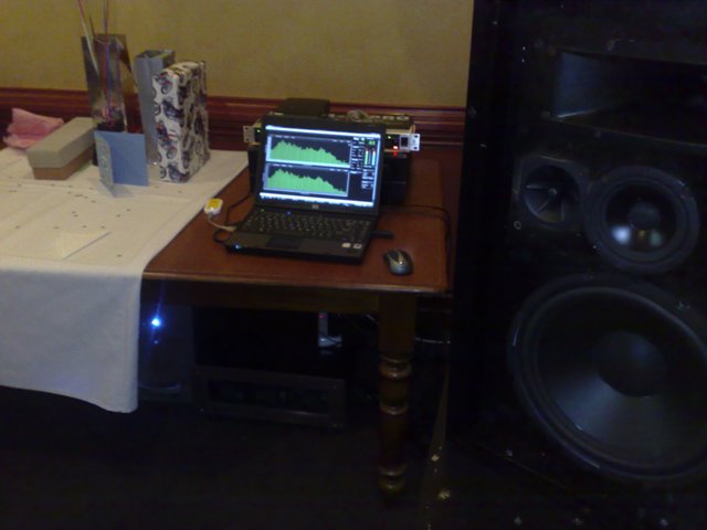

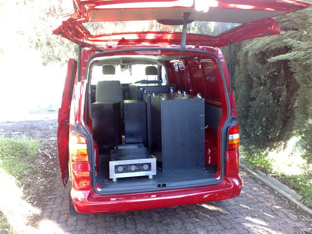

Hi There Quasi,
The high power version of the ACTRK600 saw some daylight on the weekend... for a friends 30th birthday in terms of performance - driving the L+R speakers for ~5h solid the last 2 hours at quite high volume the amp did not even click on to use the fans.
see pic attached of the amp on the bottom left in a red TDI volksy transporter LWB.
-Dan
