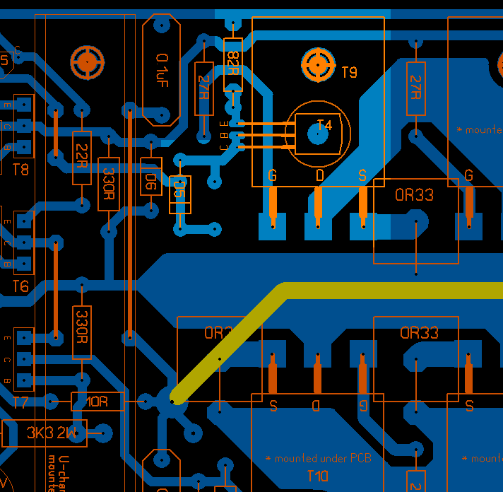

Another quasi-complementary design
Ok, I've made a few more changes to accomodate the good suggestions.
- I have inserted a resistor (82R or whatever final value it will be)
- I have moved D5 away from the FET so that it is less affected by heat from the FET. D5 can also be a zener or a link I imagine.
- for D5 I have added an extra solder PAD to potentially accomodate a LED.
- a couple of spare pads across D5 for something else....
This board will give me a few options as I play around.
Cheers Folks
Quasi

Hi Quasi,
First of all I would like to thank and congatulate you for creating such a beautiful amp. (Havn't made it yet, but looking at everyone's response to it...it sure is.)
Cheers Folks
Quasi
You seem to have made some changes in the schematic for the betterment.
So ultimately what are your findings (I am curious) and also would you suggest the changes to be included in your final schematic?
Thanks once again.
Biren.

Quasi,
