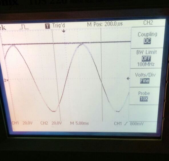

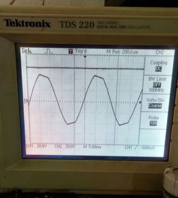

In the interim I disconnected the R20 and connected base of T7 to ground to see any difference but nothing Output voltage swing remains 41volt max.

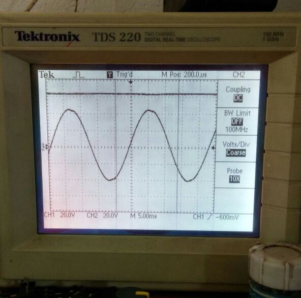

Attached image of rail voltage and output swing @29hz
Can any one suggest me a way to measure voltage across 0.33 ohm source resistors while feeding 29hz @40volt peak on output rails.
My multimeter measured 27 mV across the 0.33, in DC range which does not add for said output.While trying to measure with oscilloscope I noticed ground looping and noise, my oscope is not isolated.

You must not try to measure across the source resistor with a grounded oscilloscope probe. The grounded link will blow up your amplifier.
A stand alone battery powered meter can measure across the source resistor.
When the load is removed and the input is shorted you can measure the output stage Vre/Vrs bias voltage. This will tell you the current if you know the resistor value.
There is no value in trying to measure the AC voltage across the source resistor when the amplifier is shorted input.
If you measure from Output to Signal return you can see the output noise+hum whenon the mVac scale and see the output offset when on the mVdc scale.

Thanks Andrew, I got it now.

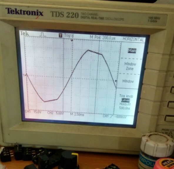

Happy to say that I figured out the issue. It was input transistors,
I thought why not give it a try for a fresh pair of C1845.The previous Transistors were of different make and showed Hfe of <40 while the current one is showing >150 in multimeter.
Now the Output swings touching Vrails without clipping.Will Post Screen shots soon.
Thanks to all suggestions and support .
Rgds.

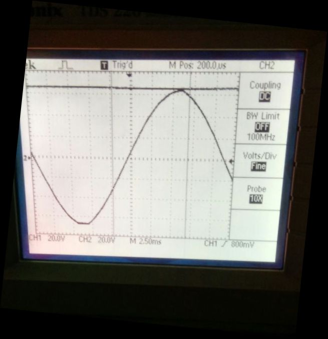

One thing I remember - the clipping will be non-symmetrical.
Lower half clips sooner than upper (or the other way around).
Quasi was working on it to make it symmertrical, but in the end
it wasn't worth it...
There was a fix from someone else involving Bandaxall diode
in the lower half, that helped a little...

Thanks for the reminder Minek123,
I thought it was again some anomaly with components.
Screenshots attached.The waveform is with 4 ohms loudspeaker connected.
Anyway I am going to drive my home subwoofer with this ,I wasn't happy with Class D amplifier hence the transition..

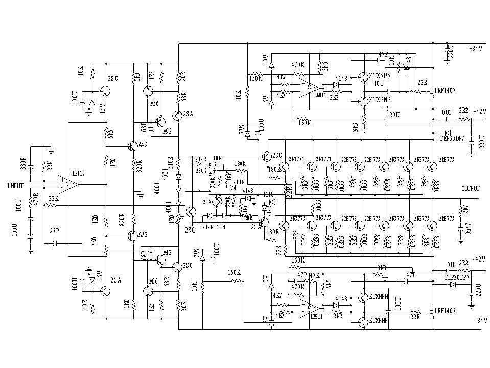

All the 6 mosfet on negative rail failed along with fireworks of gate resistor 27 ohm .
Amp was warm playing around moderate volume when I disconnected the Input from the mobile phone.Heard a loud pop and noticed gate resistors smoking.
Desoldered all the 6 mosfet,it shows Gate to Source shorted. Gate protection diode 8.2volt is fine.
Please advice why mosfet failed abruptly ?

8.2volt Zenner diode is in shorted state ,I wrote Fine instead of
I still haven't been able to figure out as how exactly the Mosfets failed.But I am now sure it was due to oscillations but where.
There seems to be a lot of information on Mosfet failure on the internet . From what I read so Far this could any of the below reasons..
1.Oscillations from Input (Input cable was 1 meter long shielded wire with 3.5mm stereo socket directly soldered into amp without volume control)
I heard a loud pop sound and probably Mosfet shorted and protection triggered
2.Parasitic oscillation at Gate (which zenner diodes are useless to prevent above 1mhz)
I thought with a 330 ohm shunt resistor at the gate of the Mosfet , chances of high voltage is very rare, added with an 8.2 volt zenner.
But Sh** happened ,mosfet are fried along with the Zenner. Probably the oscillations didn't start here but the from the Loudspeaker.
3. Transient spike from Loudspeaker which body diode couldn't absorb.
Thinking of adding a Schottky diode parallel to the Mosfet?

Bob Cordell recommends small Zobel circuits (R + C) between Gate and Drain of each mosfet.
If I remember correctly 47pF and 100Ohms, check out in his book (must be available somewhere on the net).

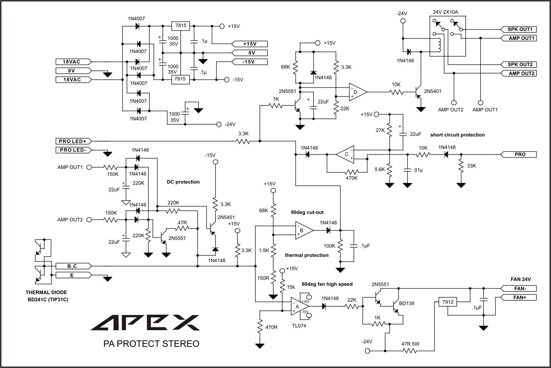

4. Have add Over Current and Short Circuit detect from APEX AX16
5. Apex PA Protect circuit for H900 / B500 can add to over current detect circuit.
4 - 5 is from diyaudio member APEX
