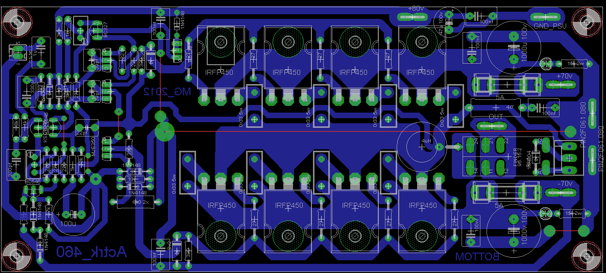

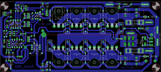

In order to power a subwoofer i planed, after been fully pleased with BOQ, to use Artck with +/-70Vdc rail and 8xIRFP450 unit in output stage. I redrawn Quasi borad for MPC071 resistor use in output stage and put DC protection relay on board. Next stap after one more checking will be board etching.
Marc
Pretty nice - I may follow your footsteps... 🙄
I hope all goes well with your project.
Cheers!

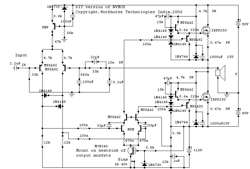

Dear Quasi,
Can we not device some method to prevent Aktrk600 mosfet amplifier from self destruction due to thermal run away. Can T5 transistor which is being used as diode be replaced with NTC thermistor so that in the event of high temperature, the drive to T4 is reduced.
I want to construct this amplifier but am I am afraid from damage of MOSFET transistors as these are still expensive here in India. Long time back similar topology MOSFET amplifier was published by Elektor which used Siemens BUZ mosfets here NTC was used for thermal protection. Your valuable suggestions will help many constructors of this amplifier since you have designed it. Awaiting your reply.
I think BUZ are Lateral mosFETs.
Quasi's designs use Vertical mosFETs and one uses BJT.
T4 provides temperature compensation for the T5 current.
Your proposal of replacing T4 with a thermistor completely changes the operation of the tempco.
No Mr AndrewT, I did not mean this. I want to reduce the drive of T4 by putting a parallel NTS to T5 which is used as diode here. Please comment if my interpretation is correct or not. The Siemens circuit did not use lateral MOSFET's it used BUZ23.
