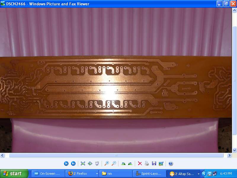

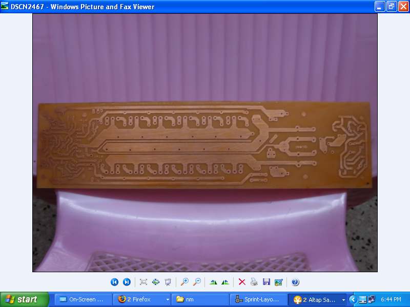

i didnt find anything wrong or earth missing in the board.i modified the output stage pcb layout but didnt altered the predriver layout below is the pcb layout.setting 0.35 volt across 10 ohm resistors iam getting
r32=7.1mv r33=10.8mv
r19=2.28 volts r17=3.85 volts and diffrential on r7(18k)=32.5 volts
removing the output pairs and checking the dc offset its 5 volts which could not be vared through vr1.

hi danieljw,
i added one more output pair to the board and powered up. now threres another problem.rebiased it.around 0.60 volts across 10 ohm resistor.powering the amp of and then on.the reading goes to 15 to 18 volts.i again set the bias and do same thing the reading also comes to be the same 15 to 18 volts.changing the trimpot doesent make any difference.but when i set bias to around 0.44 volts it doesent happen anymore the same.the reading stays around 0.40 to 0.44 and dc offset can also. be set to 3-4mv.all the arts i used are new.

Hi ravslanka,
Kindly check the grounding ,it looks like you missed the big/long jumper wire from the main ground connection going to another point.
Take a look again from quasi web page.

hi stcboy,
please have a look again ground is connected through a small jumper in the red circle.
