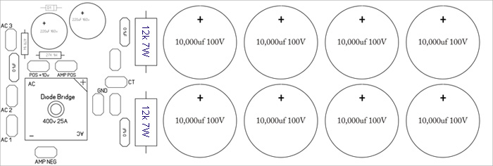

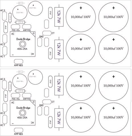

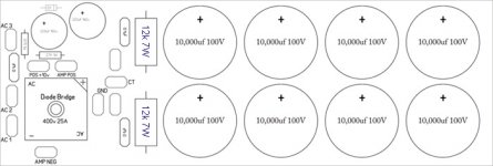

Hi Quasi,
One question can I use one supply with 8 (10,000UF100V) caps to power up the both Acrk400 Amplifier. (See the diagram) or I must make the two separate Power Supplies to power up both amplifiers?
because I do not have much space in the enclosure.
Regards

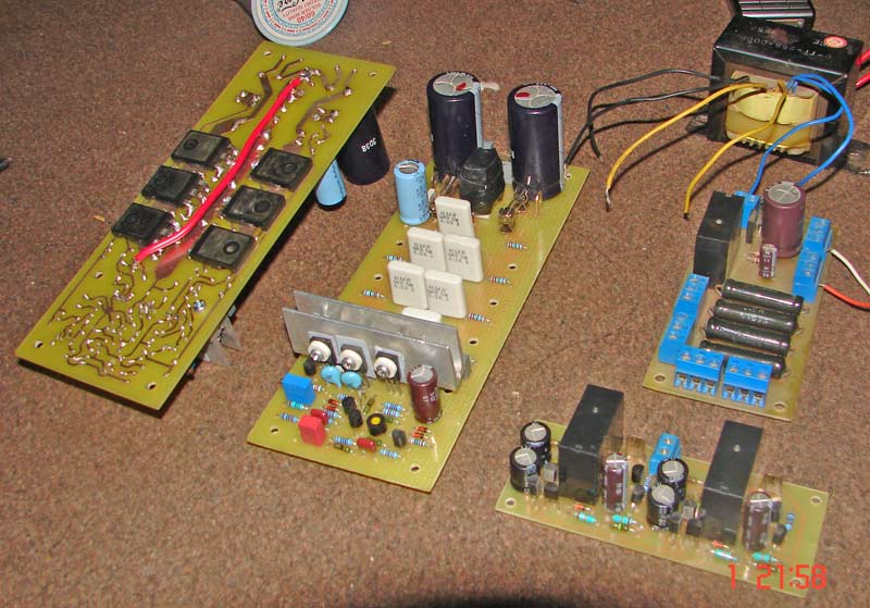

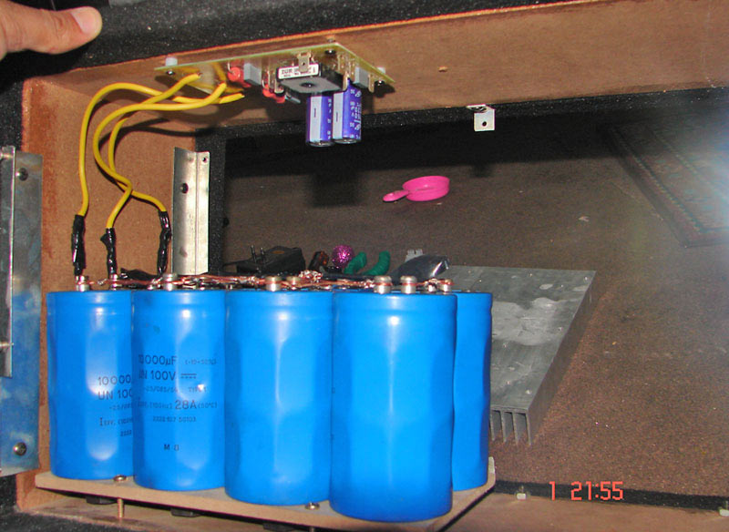

Hi Quasi,
I have finished the amplifier. Just placing everything in the box. Just have look.
On the amplifier I just used three thing which are not in your diagram. The Power resistors I use are 0.5ohm 5w and The Caps I used are 440UF200V and the third thing is the 1845 transistors I used 2240. Is it fine will they effect the amplifier quality? I have those and I do not want to buy things from the market but if you say I will get them.
The Out put FETs are IRFP460.
Regards
Wasim
Regards
Wasim
