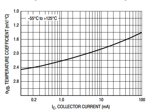

Look at your curve.
All BJT transistors will have a similar curve.
@ Ic=0.2mA tempco is -2.4mV/C
@ Ic=12mA tempco is -1.8mV/C
you can set which part of the curve and what value of tempco you need by setting the Ic.
You can do this for any BJT. The curve "shape" is the same. It just moves up or down a bit depending on the physical size of the die and the doping etc.

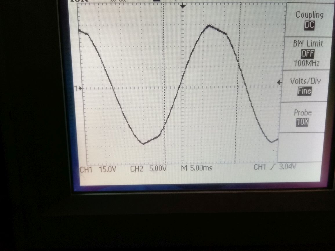

I have built this Amplifier,powered it with DC+/-65 volts and 75 volt bias (1000VA transformer.) as required in schematic .
I have some doubts.
Maximum out put swing I am obtaining is 41 volt peak on speaker terminal into 4 ohms speaker ,using oscilloscope,beyond that sine wave distorts ,while power supply is at 65 volts.
Quiescent current requirement is somewhere around 300mA for a clean sine wave,anything less makes sine wave distort (in my system)
Mosfet used are IRFP 460.
please clarify what should I expect maximum voltage swing at speaker terminal .

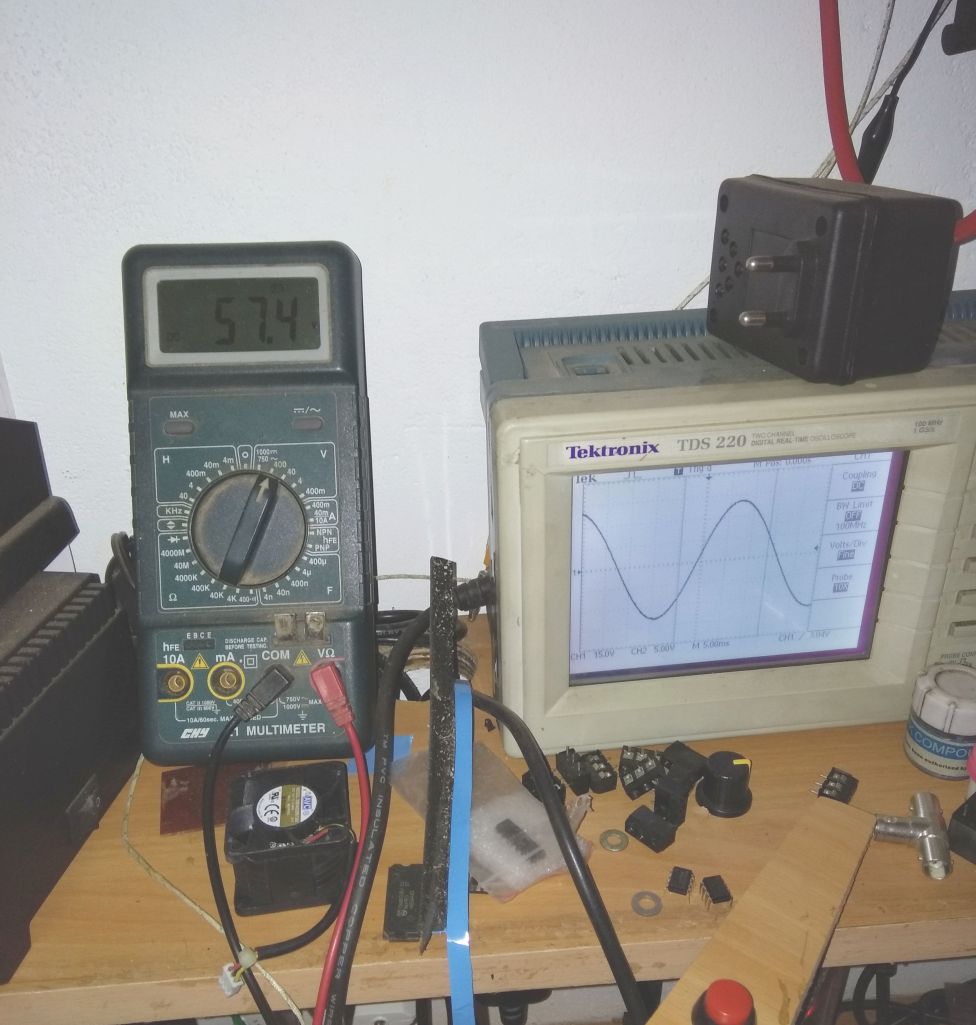

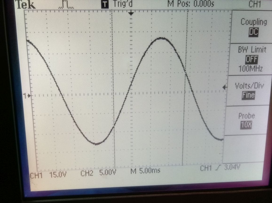

screen shots
Please see the attached screen shot of wave form and assy.
Applied sine wave is 29 hz from PC
While doing the measurements ,Ac main voltage dropped to 197 volts hence the Vrail is +57 volts as in multimeter.
Is my Vpeak normal at speaker output ?

Hi Ian,
My Mains power line dropped while I was clicking pics,this happens in the evening time here in rural areas,unfortunately.
I was expecting near rail to rail output swing or at least within+/- 5 volt limit but my observation was clipping occurred nearly +/-15 volt less than v rails.
I have measured loaded as well as unloaded and out put clips at similar levels.

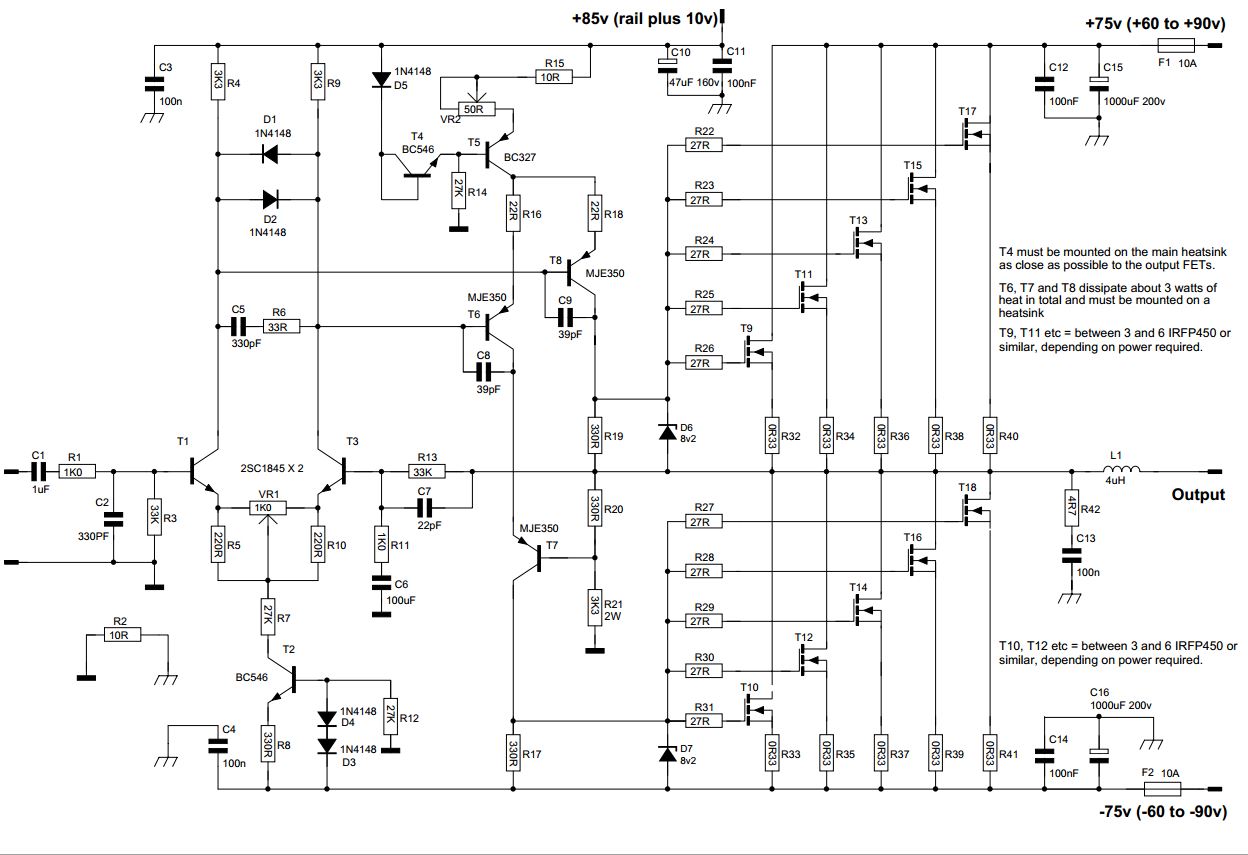

Schematics is the same from Quasi's website I am attaching it here for a review,no change of any components except output mosfets ,I have used IRFP460.
This is my first high power Amp,Building and powering up was cake walk thanks to Quasi,no smokes no surprises.The AMP is dead silent at power on but the quiescent current had to be around >250mA for distortion free waveform ( i.e 32 watts class A).I do it by oscilloscope/sine wave instead of series resistor method suggested by the Author.
TRafo is big enough I guess its 150mm at least 750+ Va I assume.pic attached.

OK, that's good that the difference is only in the output devices. If you read the article I linked, you will notice the emphasis on the loss of drive voltage to large Mosfet output stages - particulary Hexfets and even worse vertical types with high capacitance that may require a more powerful voltage amplifier stage to overcome the loss.
The signal voltage from the VAS stage determines output voltage so you should measure it with and without the output stage connected to verify that the VAS still functions correctly when loaded by the output stage. The disconnection should be the links from the collectors of both MJE350 transistors to the gate resistors.
Now, it should be possible to see on your scope what the VAS voltage is before and after, disconnection, thus checking the output stage and whether its devices are too heavy a load. By removing a couple of mosfet pairs, you should be able to verify the problem. The solution may involve different (recommended) output types but I can't advise on this.

You are not disconnecting the output stage if the VAS outputs are terminated to the output node via R19, 20, 21. You simply have very little current available at the output. If you prefer, you could pull gate resistors R22-31 instead. Try pulling just a few pairs first.
A question this time. For the front end supply voltages, the positive rail is shown 10V higher than the negative. Do you have this arrangement or is your supply symmetric there too? If so, you could understand with this topology, why you don't have the full symmetric voltage swing.
I see that you say you have +/-65V rails with 75V "bias". Is that in agreement?

I have +10 volt additional tap from the trafo for the Bias.That was the main reason for trying this circuit.followed by simplicity is what attracted me to this.
With more than 32+ watts of Quiescent current, heatsink remains hot at idle periods and with such low output swing this amp gets very very Hot within minutes.
Does it actually comply being an H class amplifier ,I have noticed many times people calling this an H class amplifier.
Most of the H class amplifier have rail switchers and complicated circuits. To me it looks Class AB with additional bias.

I get it. I will try to cut the track from R19, 17 to gates and measure.
This did not work,All the mosfets went full ON (probably stray charge of something turned them on with open gates),thankfully I have load bulb in primary of Trafo,nothing blew up.If you prefer, you could pull gate resistors R22-31 instead. Try pulling just a few pairs first.
Ah, I see too. It is a while since i looked at Hexfet designs. Apologies but thankfully you have quickly seen the mistake. As I recall, you also need to shunt the gates to off state (at the output node and negative supply rails respectively)
Without this step, the gates may still turn on without their 330R shunt resistors. However, I would appreciate comment from folk more experienced with this than I.
Incidentally, it's not a class H design. Classes G and H share the principle of variable rail voltages which are either switched between a number of cascaded supplies and output stages (class G) or continuously variable rail supplies (class H), according to output voltage demand. Either approach definitely lowers average idling current and increases the efficiency of high power linear amplifiers.
