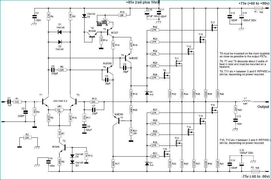

now iam gonna make 3 pair version of actrk400 with 78-0-78 and 95 volts dc
qusasi please give brief description for setting the bias for this amp
iam using the cct posted on your site
thanks in advance
Se my attachment Schematic
for reference!
1. check all components are correctly mounted.
one component turned wrong way can destroy everything!
2. check the D5 + T4 + T5 are corrently mount
3. check D6, D7 zener are put correctly polarity!
note that zeners D6, D7 has got opposite to D5 polarity in circuit.
Cathode towards positive voltage side!
http://en.wikipedia.org/wiki/Zener_diode
4. VR1, 1 kohm, should be in middle position
5. VR2, 50R, should be put wiper FULL to R15 side!
so this trimpot is Full 50 ohm!

hi quasi and lineup
iam ready with new fets with only 2 pairs
using the cct given
with 43.7-0-43.7 3.5 ampere aux rail tied to fet positive rail
i did everything as per your guidelines
i came up with these figures with 10 ohm resistors in both fuse holders
voltage across 10 ohm +rail resistor 0.60 volts for 2 pair of fets
with dc offset of -0.08mv
voltage across
r19-2.70 volt
r17-2.86 volts
voltages on posotivee fet
g = 3.3 volt d =42.6 volt s=0.84mv
negative fet
g= -40.3 d= -111mv s = -42.5 volts
voltages on
T8 T6 T7
e c b e c b e c b
43.4 3.3 42.2 43.4 -2.7 40.5 -2.6 -40.6 -35mv
voltage on T4 bc = 42.7 volts e = 42.2 volts
on t5 c =43.2 volt b = 42.2 volts e = 43 volts
i connected a speaker and touched the input of the amplifier it is giving a clear buzz not that clear.after that i removed the load and
inserted a fuse in negative rail leaving the 10 ohm resistor on positive rail.powered up rebiase it to 0.60 volts across the resistor dc offset of - 0.05mv everything was ok .but when i connect my speaker to it the 10 ohm resistor blew up . i removed everything
and cheked my components all was ok except 10 ohm resistor.i have checcked each and every component twice. powered it up. again i have arrived with the same problem . i have stopped everything . now you guys tell me what to do next.
thanks
ravs
Lets wait until Quasi will reply.
Have you also those output filters:
Zobel: R42, C13
Inductor: L1
This is only one guess:
Before you put in your fuse,
test fuse with one Multimeter in lowest OHM meter range.
Should show very low resistance value = Fuse okay.
If very high value = infinity = no contact .. then is one bad fuse.
If putting in one bad fuse = no contact, in negative
and one 10 ohm resistor in positive,
then maybe the 10 ohm resistor will burn.
When lineup said "check the zoble" he was right.. It sounds
like your amp was oscillating because The resistors blew after you connected the speaker.
#1- ,T4 mounted on one of the fins of the heatsink doesn't give enough thermal feedback and might contribute to oscillation.
You might consider drilling the hole beneath
the board like in the NMOS 350/accutrac construction guide..
#2-Try reducing R7 as you are running very low voltage for this amp (43-0-43).The lowest I've gone on a quasi is 50-0-50
with 15k for r7.
A question.. it looks like you have T4 mounted to the HS
(2 wires bc546) but Quasi mentions Q5, schematic
says Q4..wassup??

hi quasi and lineup
using the cct given
voltage across
r19-2.70 volt
r17-2.86 volts
negative fet
voltages on
T8 T6 T7
e c b e c b e c b
thanks
with 15k for r7.
says Q4..wassup??
hi ostripper
i have tried this way to for T4 mounting
http://i36.tinypic.com/90sidu.jpg
i think quasi is bit confused its t4 in the schematic
