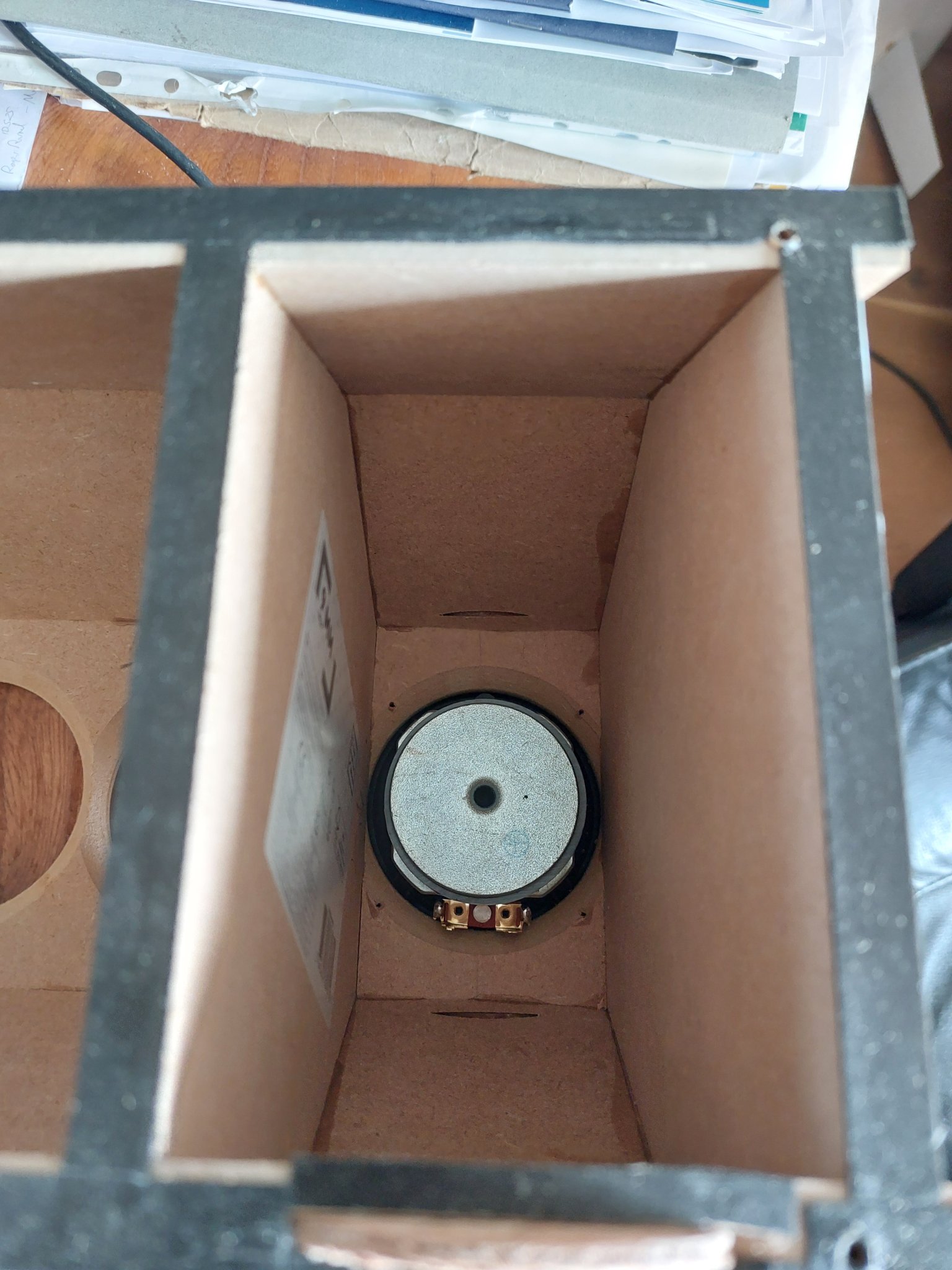

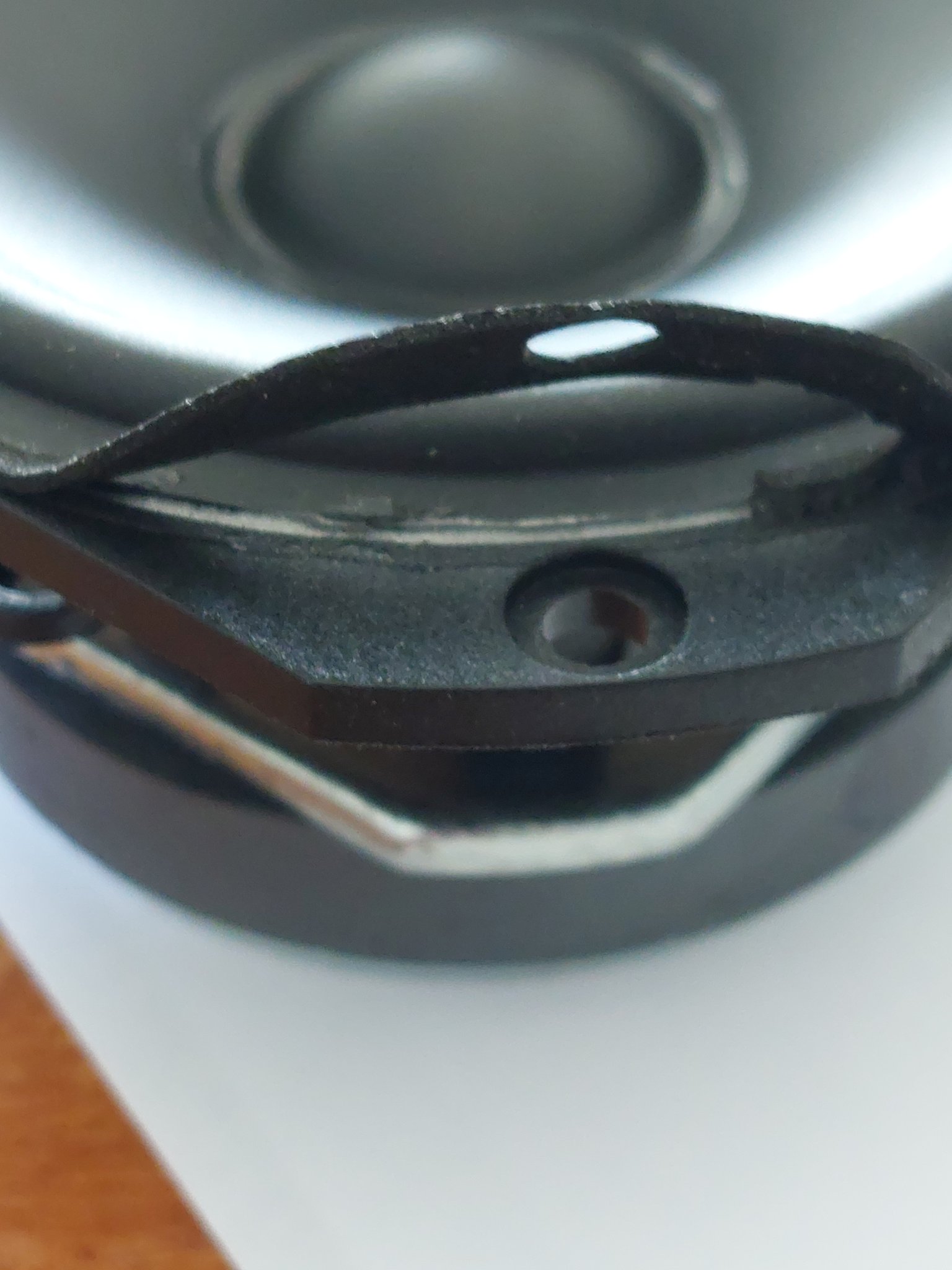

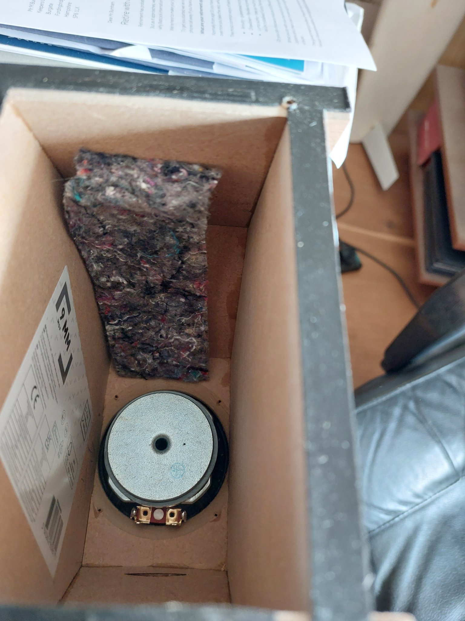

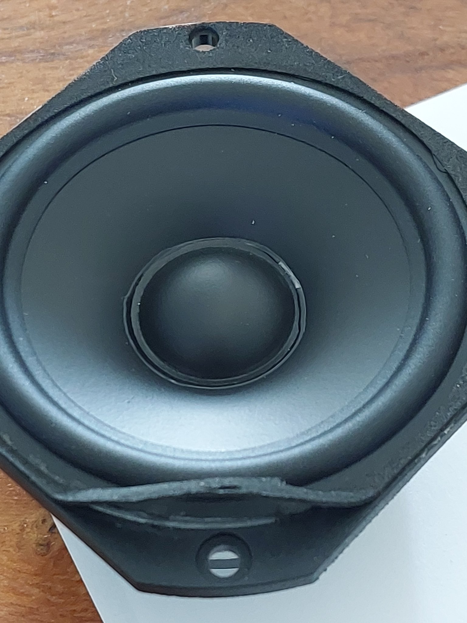

Wood will arrive in a week or so, consequently i decided to get the final ingredients in place.
The pictures show the mock up module with the back removed.
A piece of the felt i will use as padding/absorption is shown, obviously i cannot put this next to the driver at top and bottom, presumably everyone else had the same problem and it works OK?

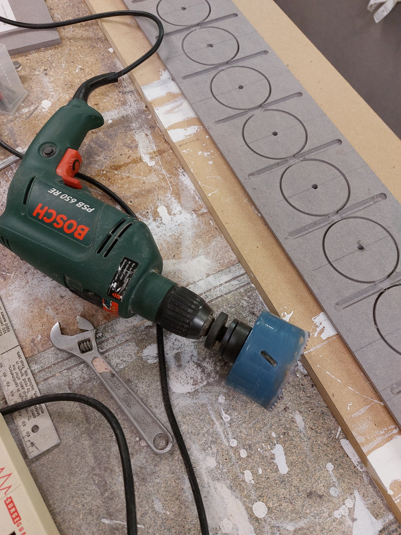

I will soon be ready to cut material for the enclosures.
I have one last decision to make which is where the bottom goes in relation to the floor and ceiling.
I have decided to mount the enclosures on wall bracket/pivots so they can easily be turned in relation to the seats for tuning and so that they are really solidly mounted to the brick walls thus avoiding large and complex stands which would stick out into the room. These will screw into the top and bottom plates of the enclosures, so there needs to be a small space above and below the enclosure.
However, I have about 268mm to distribute either above or below the 25 line of drivers and the cabinet top and bottom plates.
Advice so far seems to be to mount as low as practical and leave the rest of the space above.
This probably means around even distribution of the remaining amount, 130mm above and below.
I would appreciate any further thoughts please.
I haven't completely forgotten that i am building a pair of corner arrays!

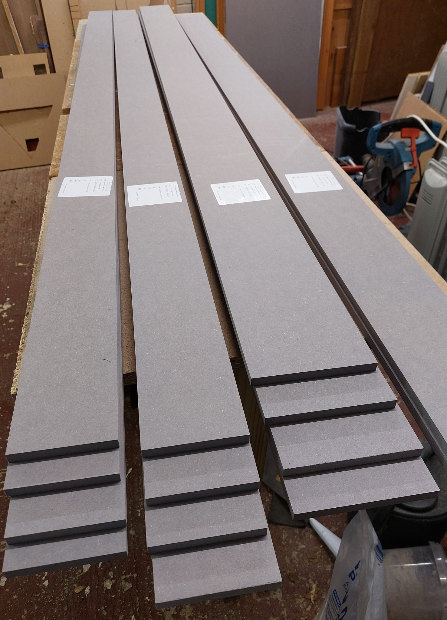

I cut all the vertical parts for the cabinets today, 8 side parts at the top of the heap, fronts and backs at the bottom, each 2400mm long at the moment, the whole stack weighs a bit...........each cabinet will weigh over 20kg, so with the drivers and wires maybe 30kg.....heavy but just a one man carry!
A bit of fettling and sanding but basically done.
Next to mark and cut the baffles, then the cell dividers, then assembly time........

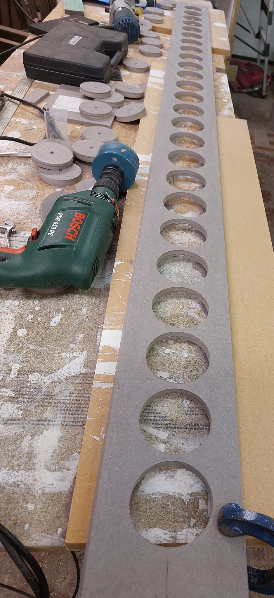

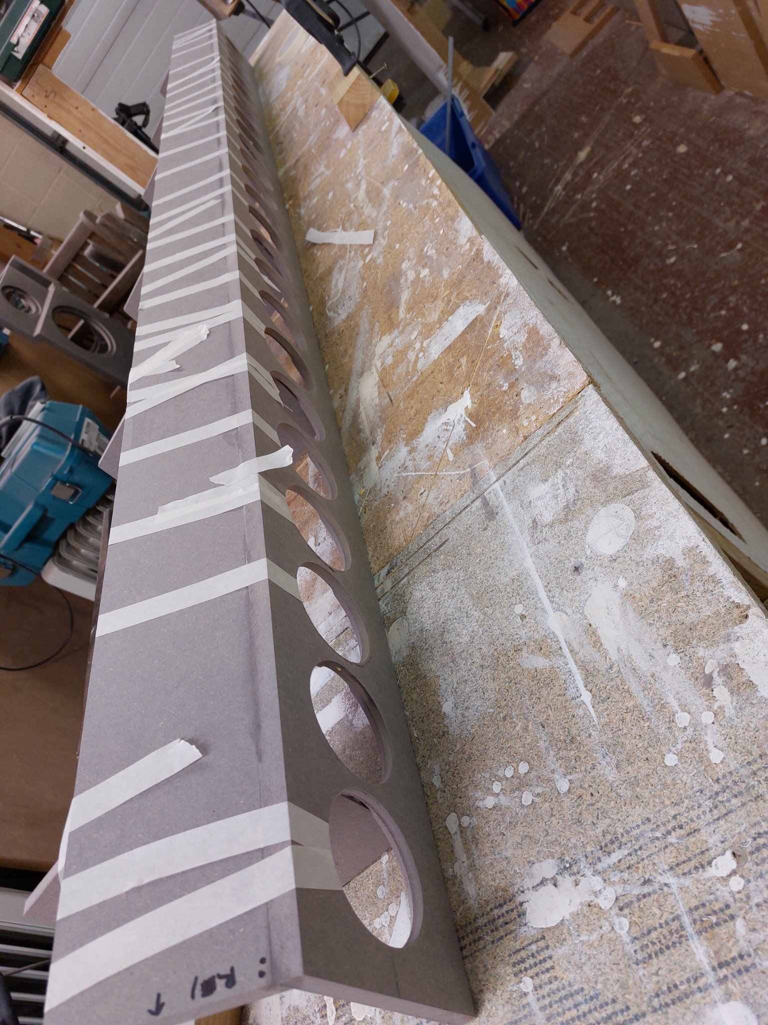

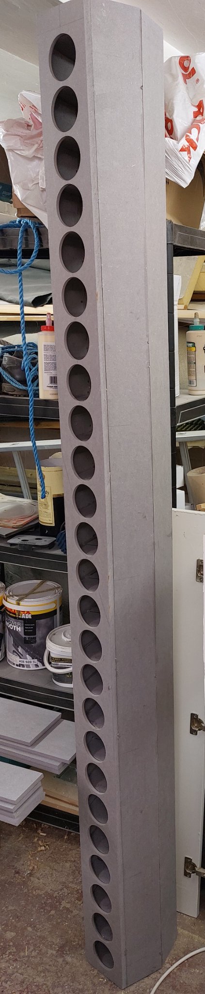

And now i cut the baffles holes and the grooves on the reverse for the cell dividers, next to look at assembly...........but cutting the cell dividers accurately will probably be the most tedious job, i am thinking of a rough cut and a final trim to one template with the router, maybe!
Reactions: perceval

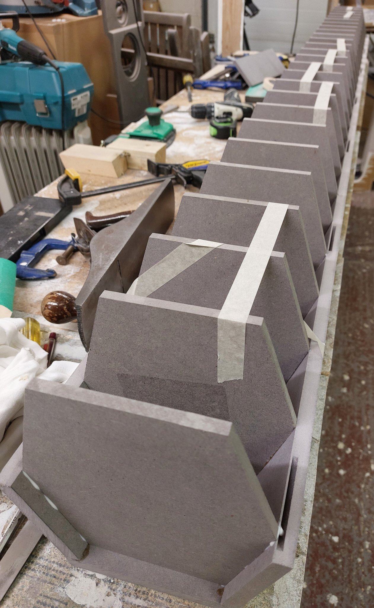

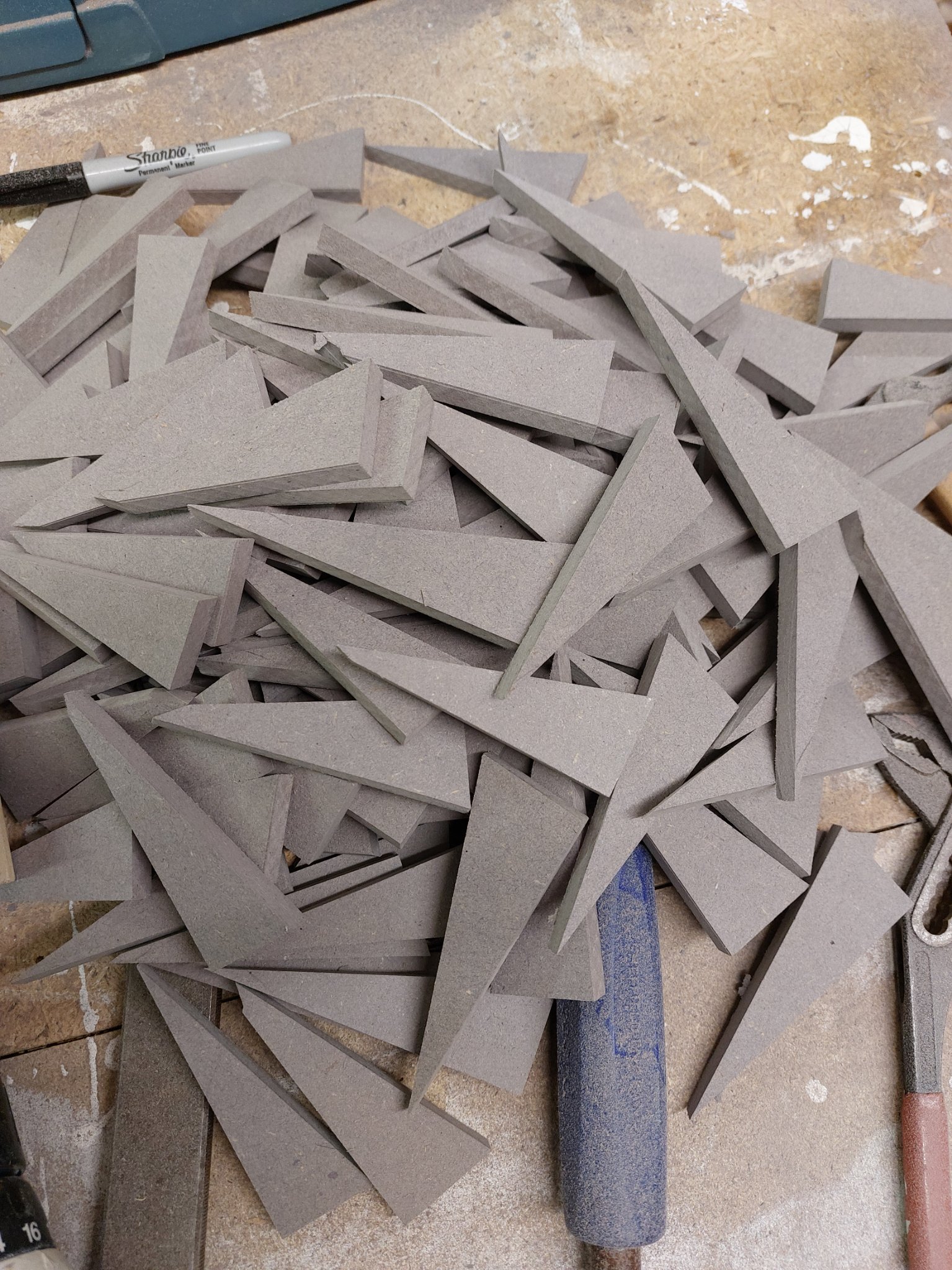

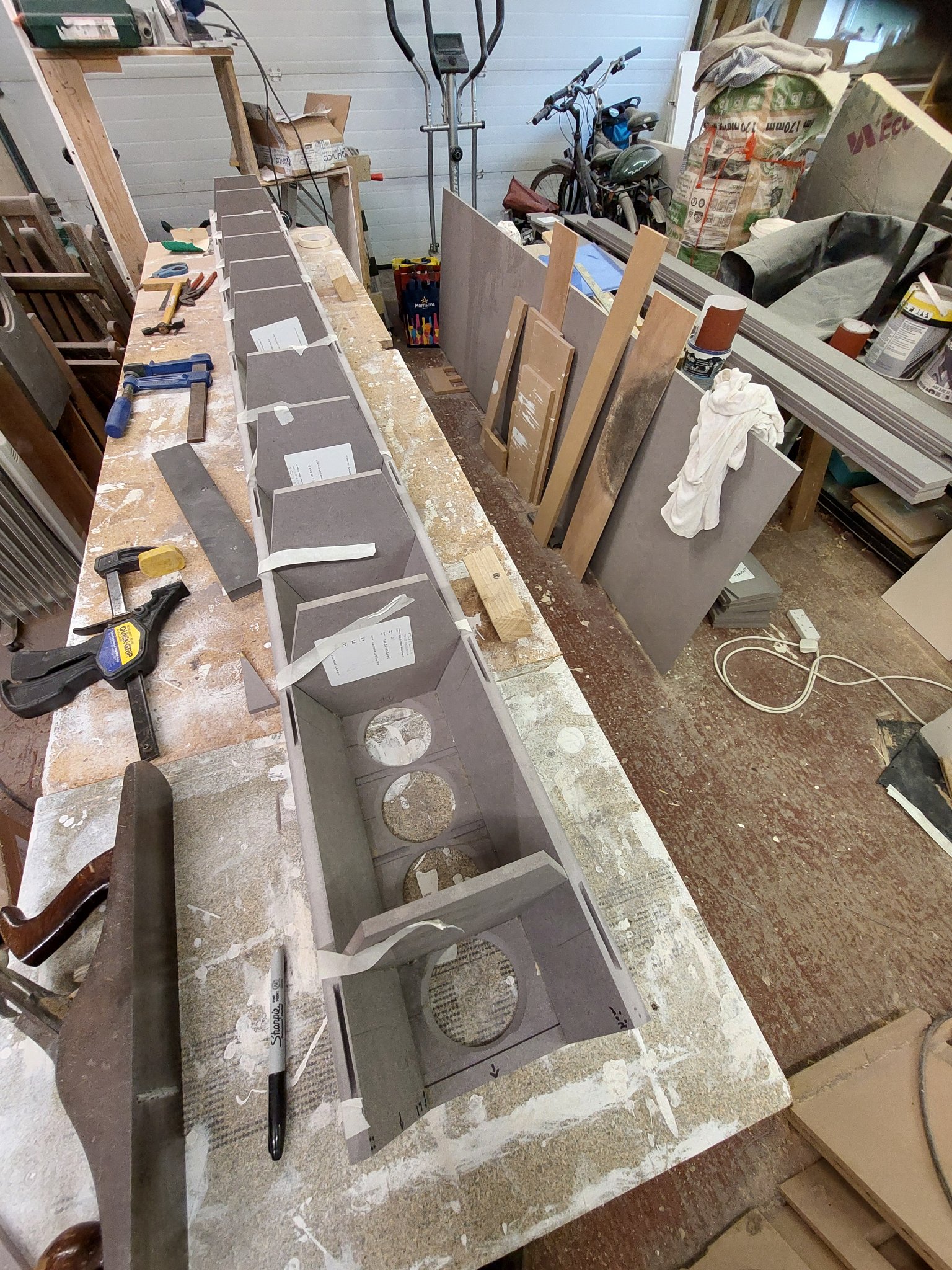

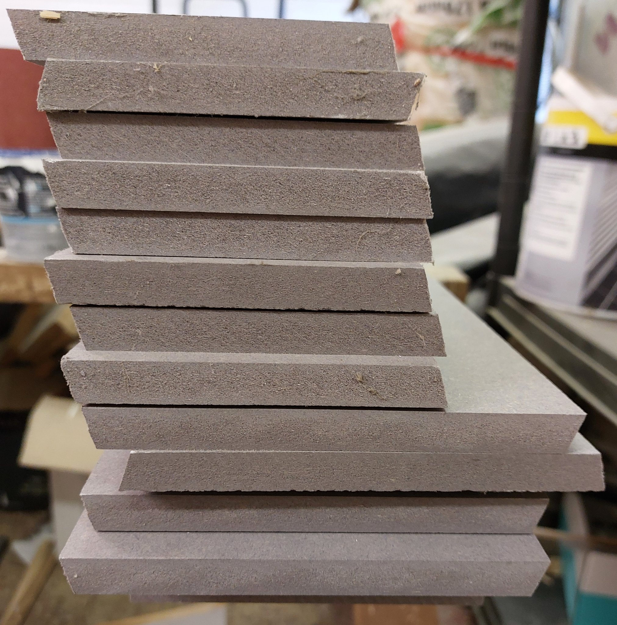

People did mention the repetitive scale.......here is the result (last pic)of 52 cell dividers cut from rectangles. i glued up initially with 6 in place and insert the others when the sides are on, simply gluing 26 faces in one go is long!
