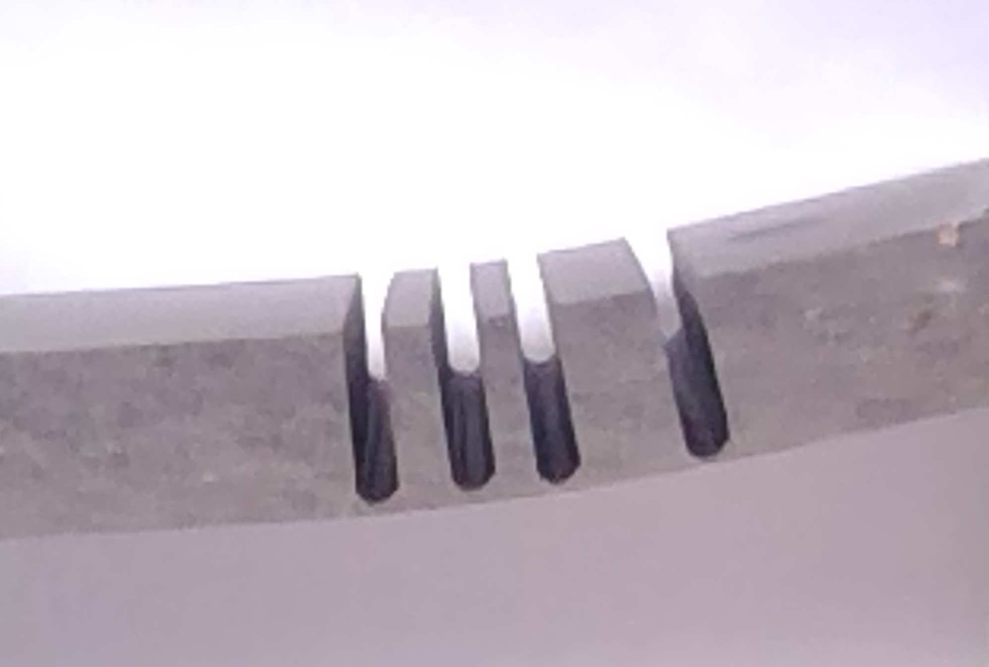

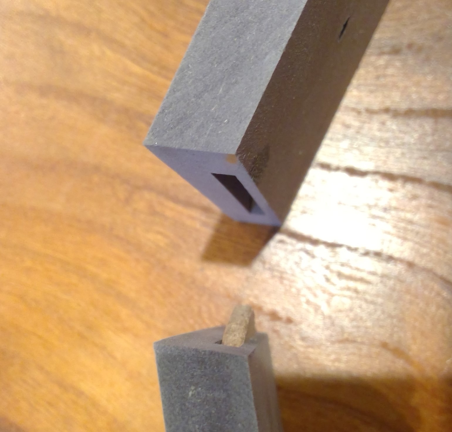

I just did a test slice on MDF, to bend the corners on the side as opposed to joint and round it.
There is a lot of void after slicing and although i would not cut quite as deep it would be a messy glue fill to hold the bend and not much real structure left. is it better to joint and shape the outside?

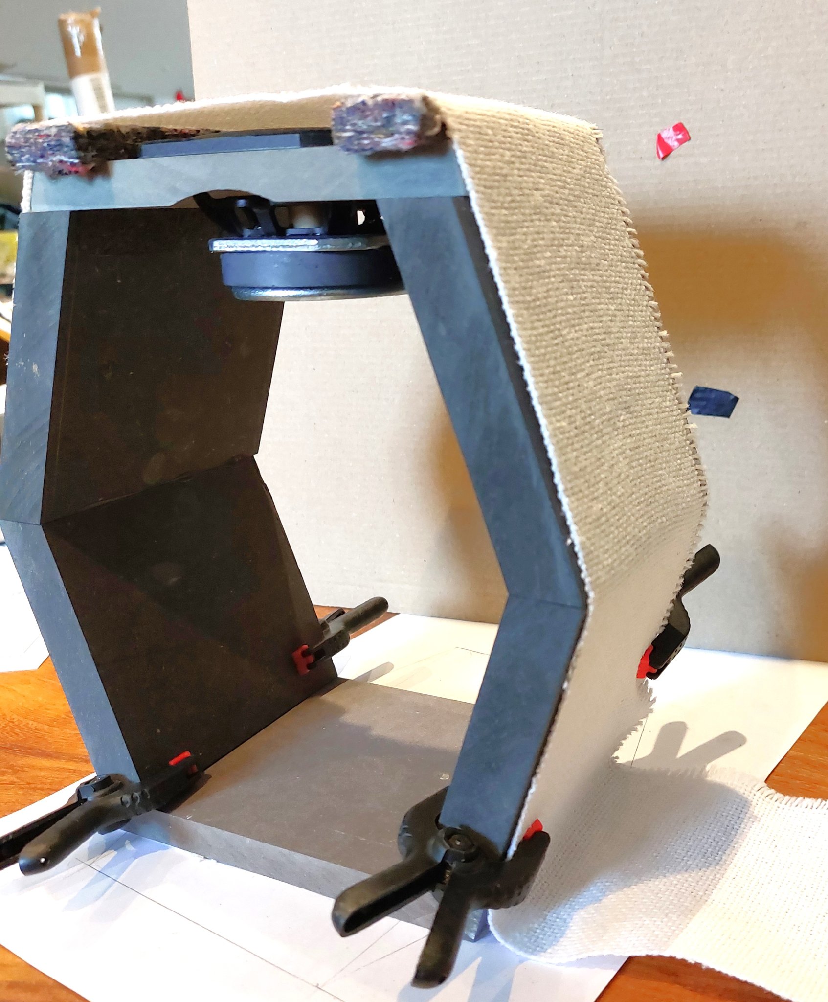

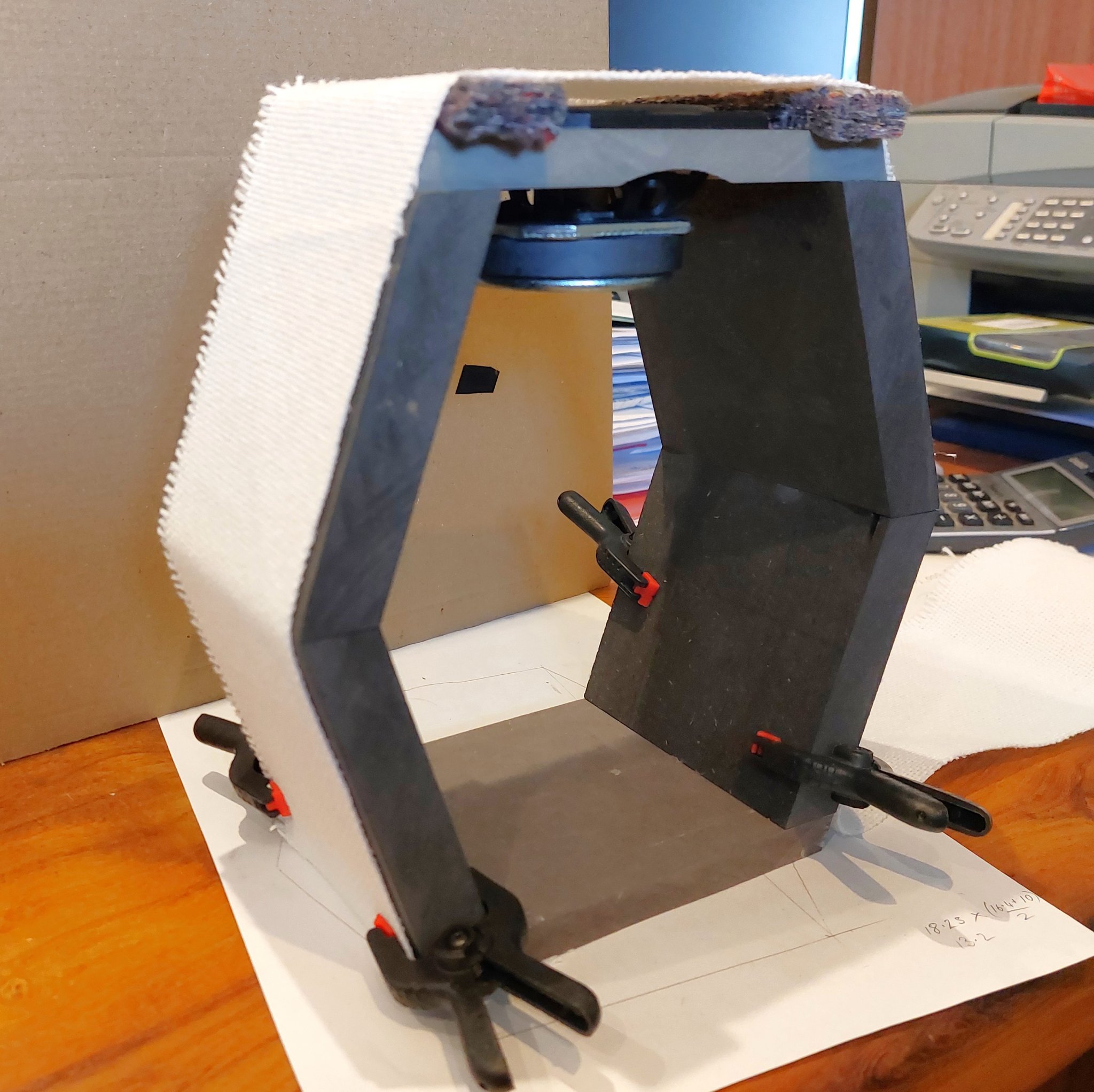

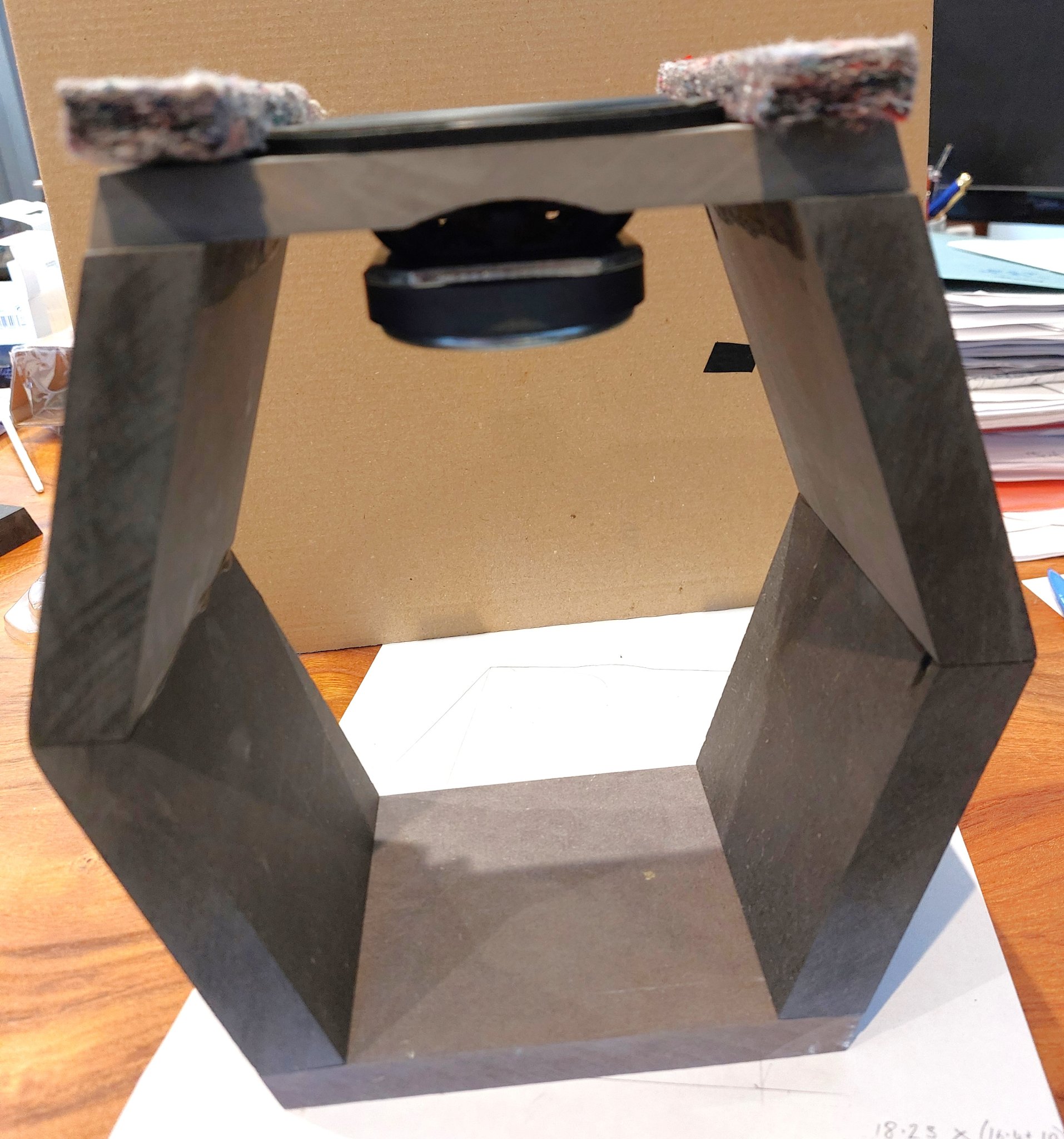

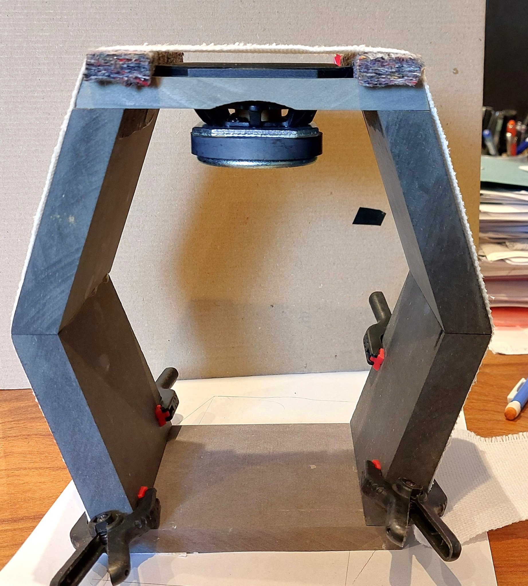

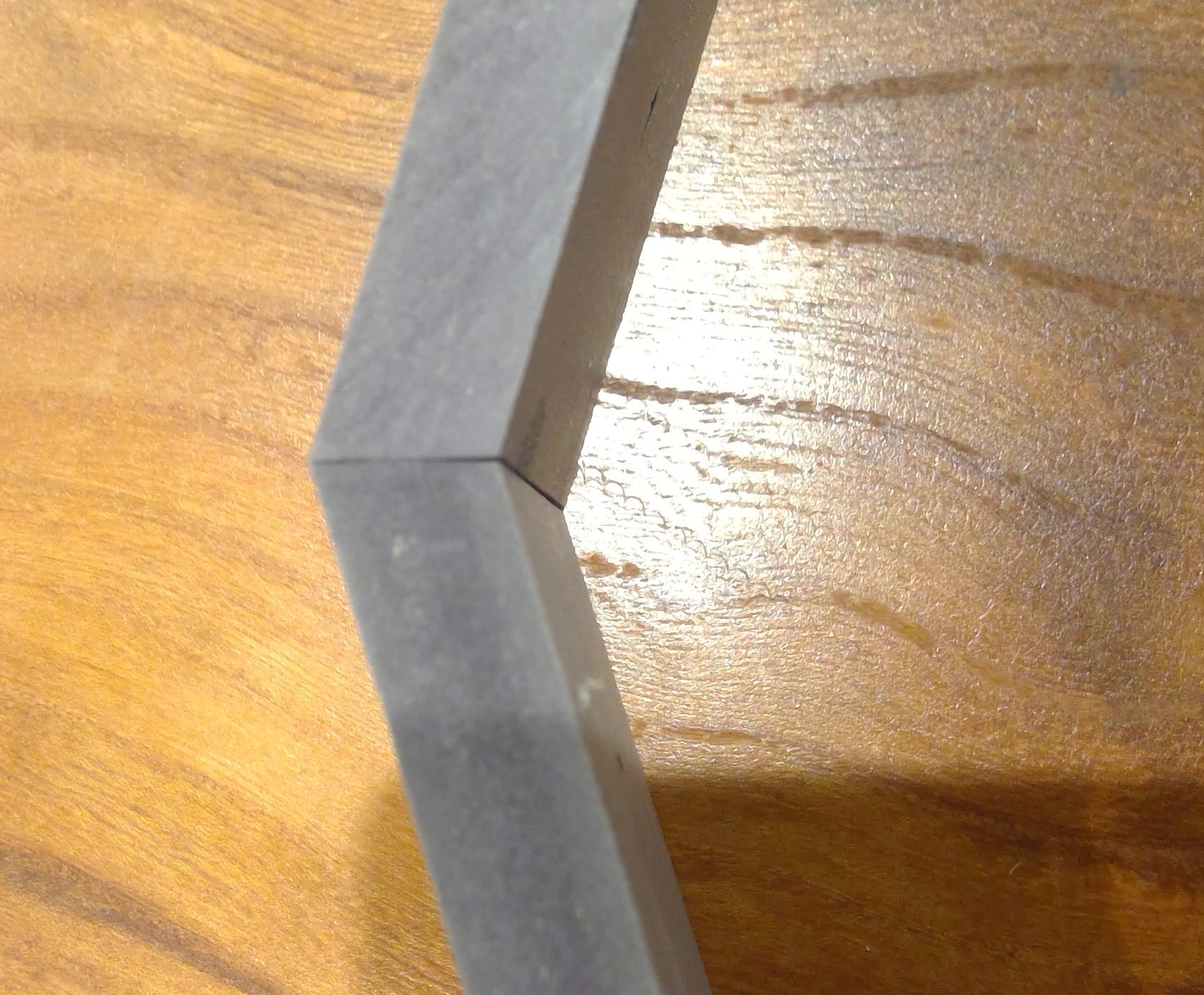

Having now made a section of cabinet, I have decided to stick with a hexagon section, so i made that section as per photos attached.
Each driver section will be split from the next by an 8mm mdf divider, the sides will be 12mm mdf, the same as the baffle and rear in the pics. I made them of 19mm today because that was at hand. Then with the same external dimensions this is a 2litre per driver cabinet. i assume this addresses the point made by Freedom above?
Each section will be lined with the same felt as the driver surround.

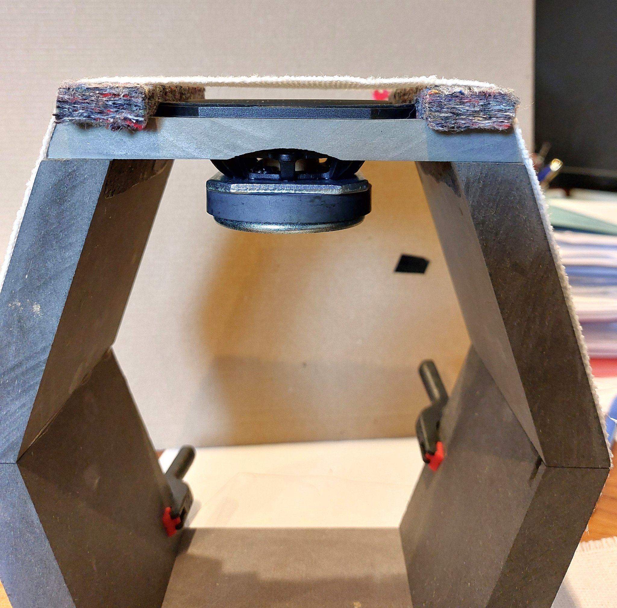

I have one small problem to consider where the router relieved mounting hole crosses the divider, seen as a part circle on the baffle back in the pictures.
I remember discussions about mounting the drivers on a neoprene or similar to seal well/damp some vibration.
If i do that i must remember to put it under the felt as well to retain the clearance.

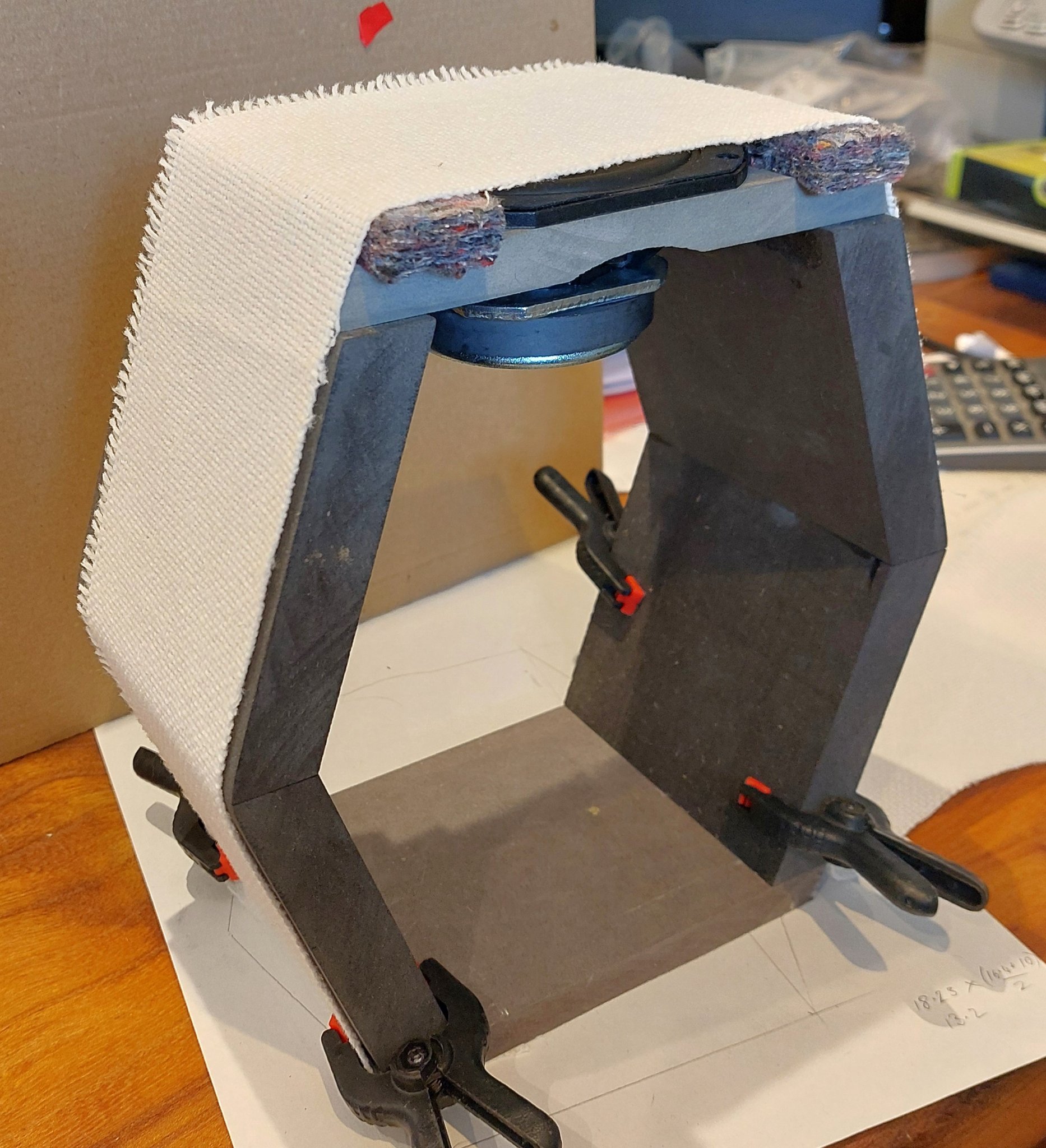

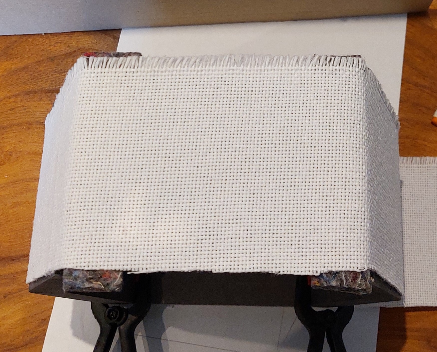

The grille cloth i used for this experiment is quite coarse, i expect to use a finer mesh.
It gives 4mm of top clearance.
The tension of the sock is important, i imagine a velcro strip on each edge, onto the cabinet back, fasten one side and wrap right round adjusting the tension as the second side is fixed.
Does that felt edge look to be a good treatment for the edge diffraction?
With answers to above its about time to order some materials.........

3mm won’t bend too far…..but enough for a curved side/taper. I use a bunch of ratchet straps with furring strips and blocking to keep even pressure. I secure one end with brads first……takes a little practice…do a dry run and you‘ll understand where to put the strips and blockingI have also looked at that Mayhem, what minimum radius will that achieve?
Its also quite complex imagining how to maintain good contact across the entire inter-laminate surfaces as they glue, and keeping it straight without quite complex construction........
M
The curved side appeals, a tall Sonus Faber look, would look nice at the end, i visualised it in walnut veneer, but then i wont have the sock solution available to me, so currently feeling the Mark 1 will be hexagonal section, made in one length, with dividers at each volume, as per the mock-up. I remind myself of the early comments about work involved and currently don't wish to multiply it up. if one day i get sufficiently bored to need another project i can re-make the cabinets............i remember writing at the beginning this would be a one off project though..........
