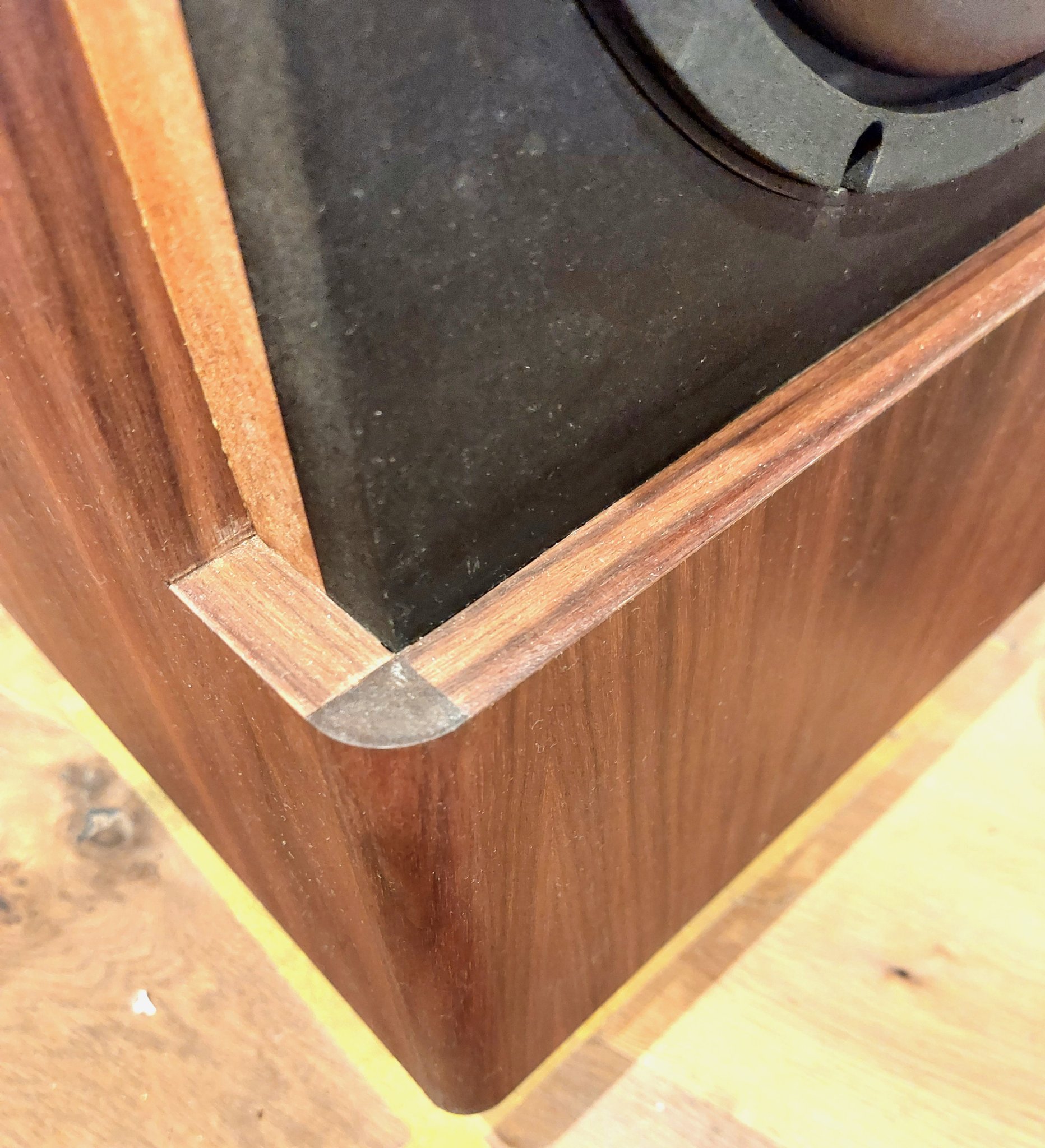

Depending on the answer concerning baffle shape and side ridges i could consider a walnut cabinet detail somewhat related to the section like this i did previously or go with the simple approach of the "sock" that wesayso copied in.

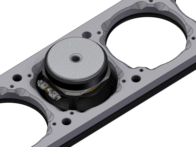

I had a couple of reasons for the aluminum baffle. I wanted a serviceable construction that would hold up fine, even after several rebuilds. I couldn't see that happening with an MDF or even ply construction. @koldby had shown that aluminum could look the part and be firm enough.
8-jpg.264060
I didn't regret making it serviceable. I've had it apart for several different reasons. Most of them just aimed at improving the results, only one out of necessity due to driver failure after moisture damage. (had them stored open in a very damp garage for just about a complete year.
I found evidence online that the back mounted 3.5" driver had advantages over a flush mounted construction as far as off axis results. That evidence isn't available online anymore but the sims we ran years later basically confirmed that line of thought.
I used an inner baffle to hold the drivers and a "beauty baffle" to be able to have that beneficial round-over in front of the drivers. I treated it like a CLD construction with butyl rope damping in-between.
As designed
As fabricated
It has seen several cycles of assembly and still is as fresh as it ever was.

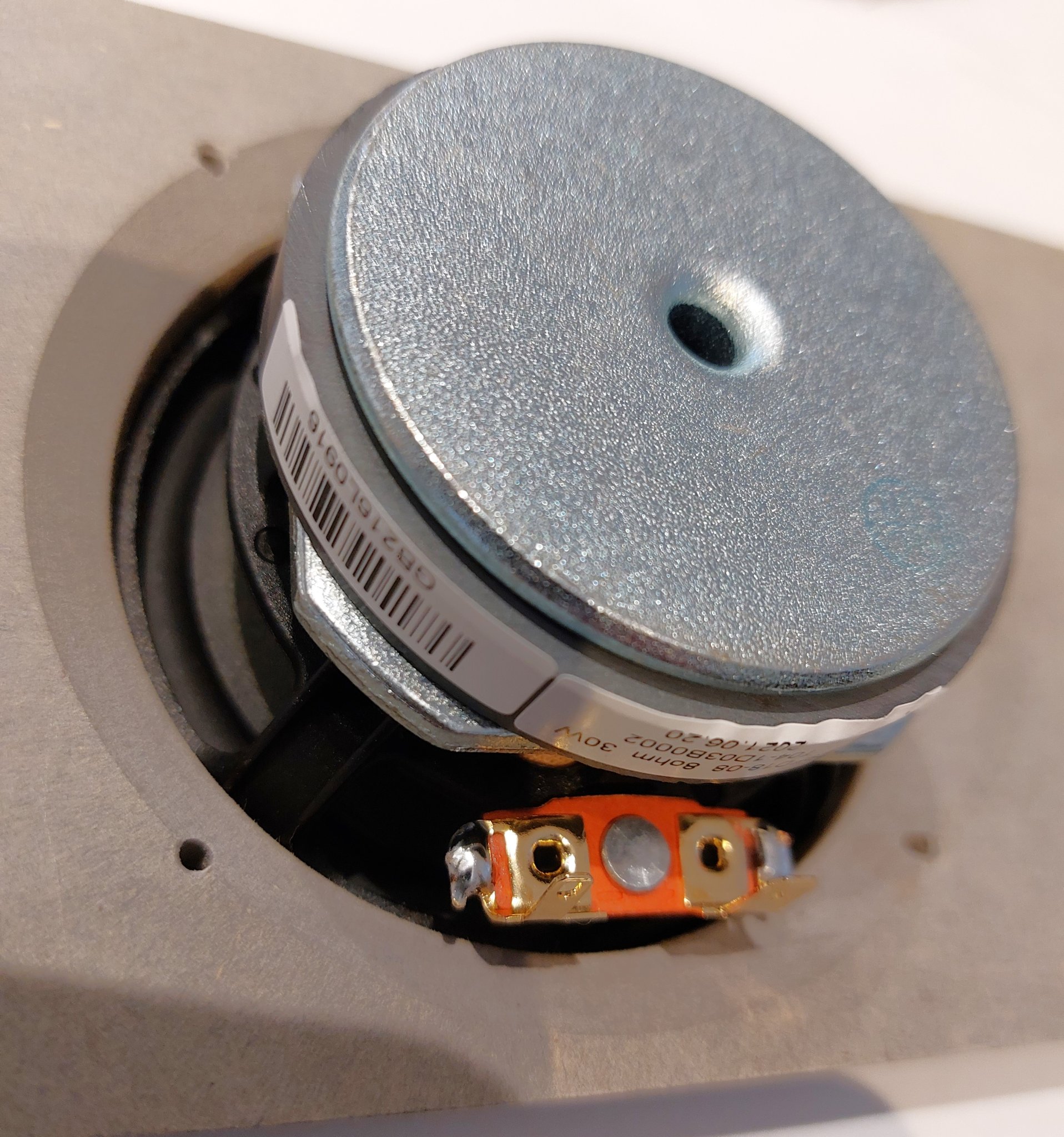

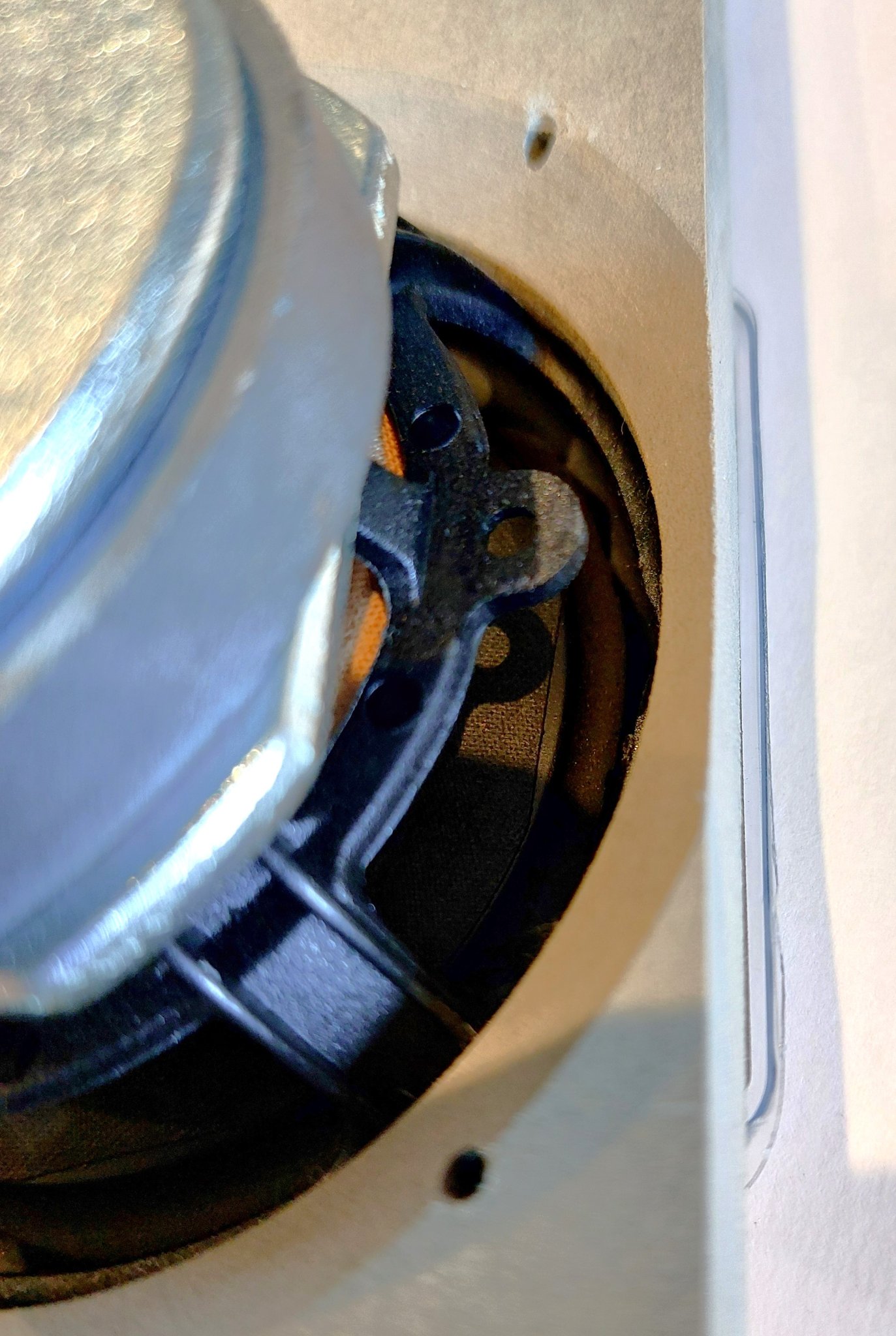

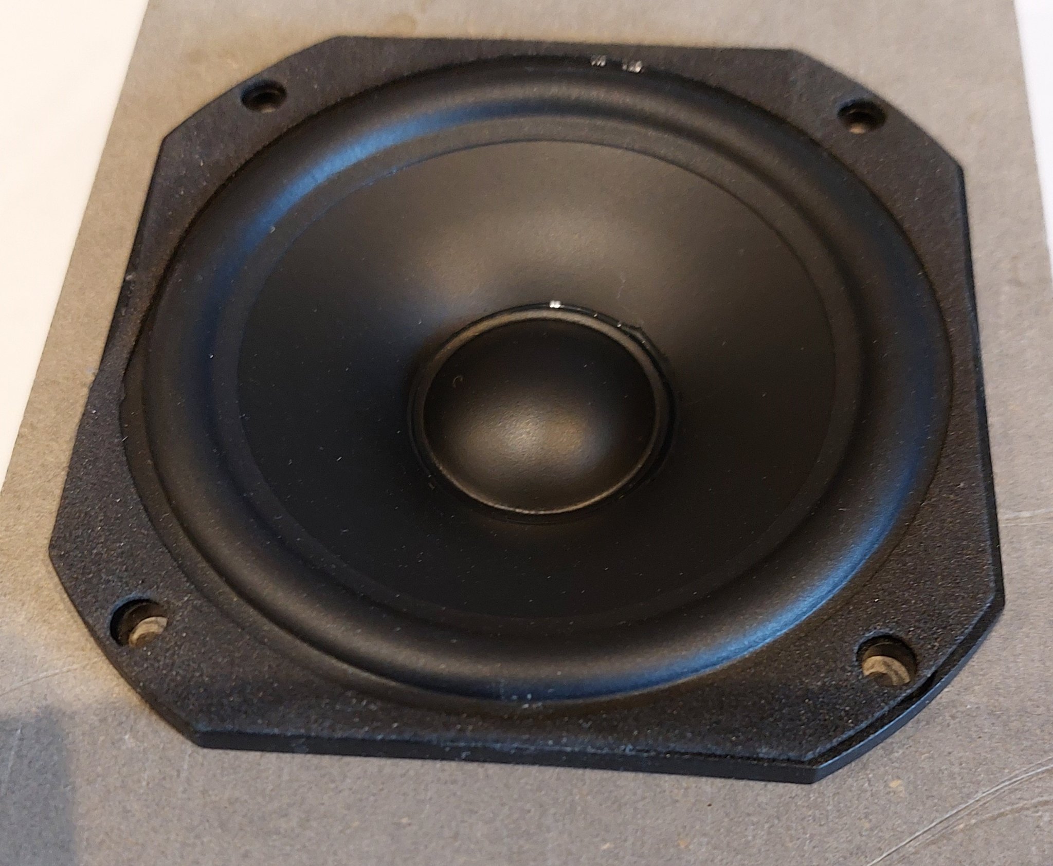

2 days delivery at £12.75 each I have 55 drivers ready to go, 5 spares as someone advised.
I cut some 11mm grey MDF with a 75mm hole saw and 45 degree routed back angle. i would use black on the real version.
That means the fastening holes are just in the chamfer, more than enough material to take a screw or bolt with backnut. The remaining part seems adequately stiff for handling during build.
If the baffle is minimum width i might make it in two parts to ease handling an 8 foot length.
So, at first look that seems adequate to front face mount the drivers. I have some mass loaded vinyl sheet which would fill the gaps between driver plates nicely if they are face fitted as pictured.
I am not looking to add this complexity but i could make a jig and recess each driver, lots of work for how much benefit?
What is the preferred edge treatment for the baffle, the vertical half round on some makes an easy grille/sock fit?
In fact i could just copy the front shape of OPC, why not, his thread reads like he knows what he is doing!
He uses 5 drivers per enclosure, is this preferable to sealed individual ones?

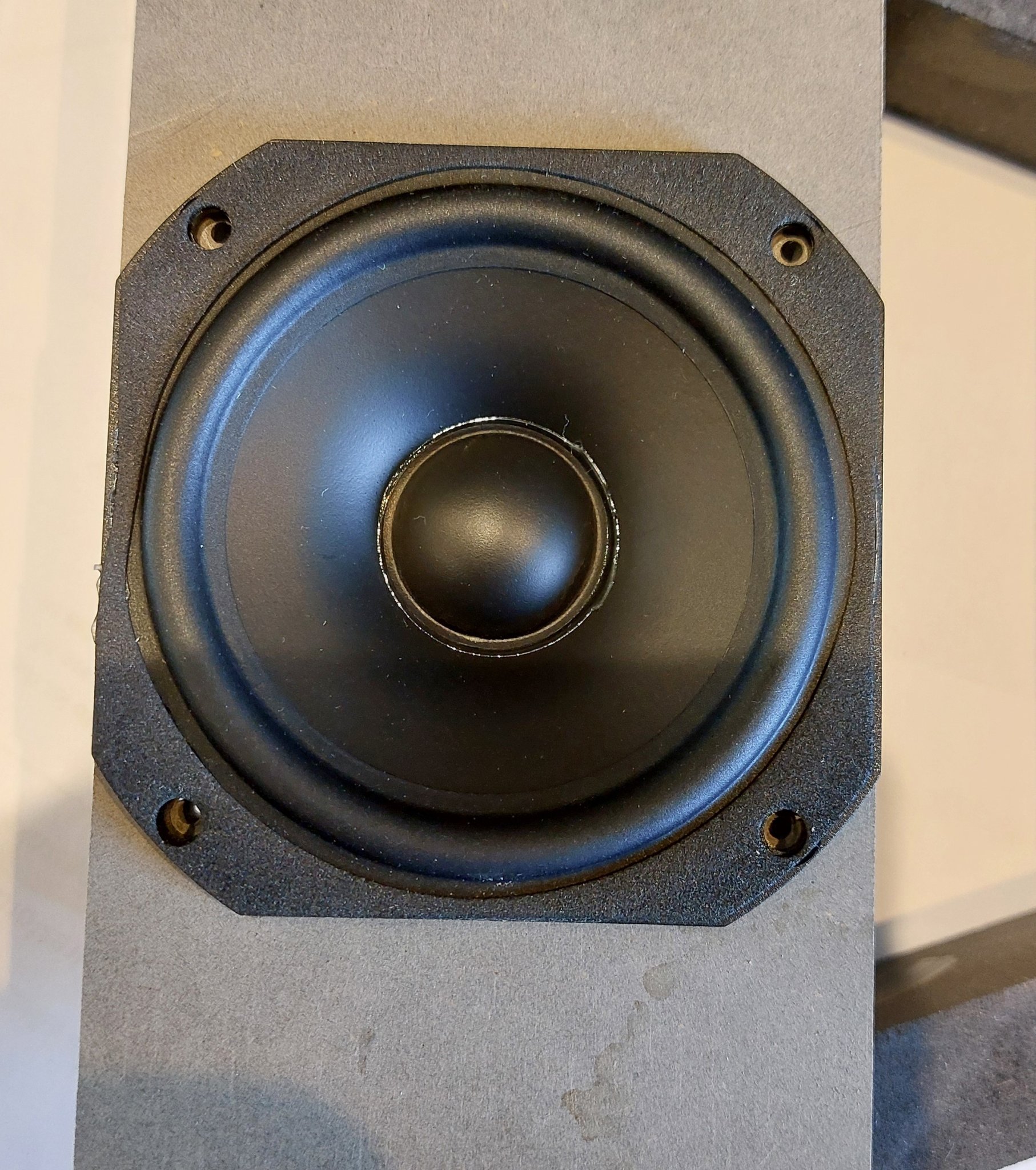

The gasket was damaged on arrival, is this just normal.
I only opened one, assuming i use a grille like OPC is of no consequence.
So here is a baffle with half rounds and a fill piece bottom left, would appear flush in sonic terms?
Paint white like OPC and a white sock overall, or much more complicated a front grille and veneered curved sides.......

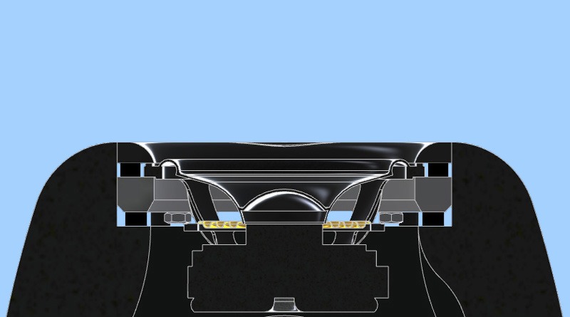

I've put my trust in creating a smooth transition, from the cone out to the enclosure, obviously with a surround that get's in the way somewhat, but think how that cone moves and that surround changes accordingly.
The simulations have shown that it is working: https://www.vandermill-audio.nl/smooth-curves-to-avoid-diffraction/
So if I were you, I'd either put an extra shape in front of the drivers, with a rounded over cut-out like I did, or make sure that the driver "sees" as less of a ridge as possible when you construct those protruding sides. Because if it acts as a ridge, and is just about the same for every driver in that array, it will influence the frequency outcome through diffraction. I wanted to minimise the diffraction footprint. As that would aid in the "speakers disappearing act, while listening to music". That part was very important to me, a set goal if you will. I believe the more gradual change of output as seen moving from on-axis to off-axis frequency curves in the simulations as presented in that link do show it makes a difference.
From flush mount in a rectangle:
To the curved enclosure with that small waveguide in front:
So I would try and make sure that whatever is used to hold off that sock from the cone does not reduce my rounded enclosure to look like a rectangle again to the acoustic output 😉.

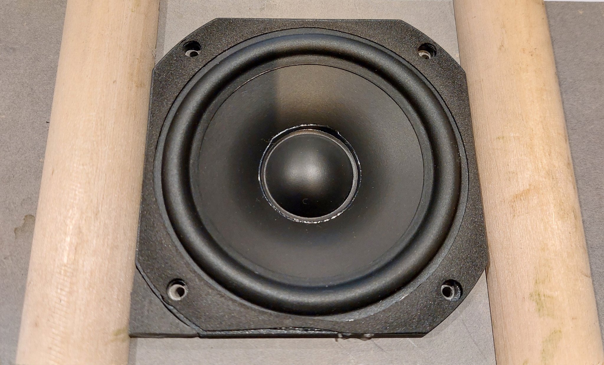

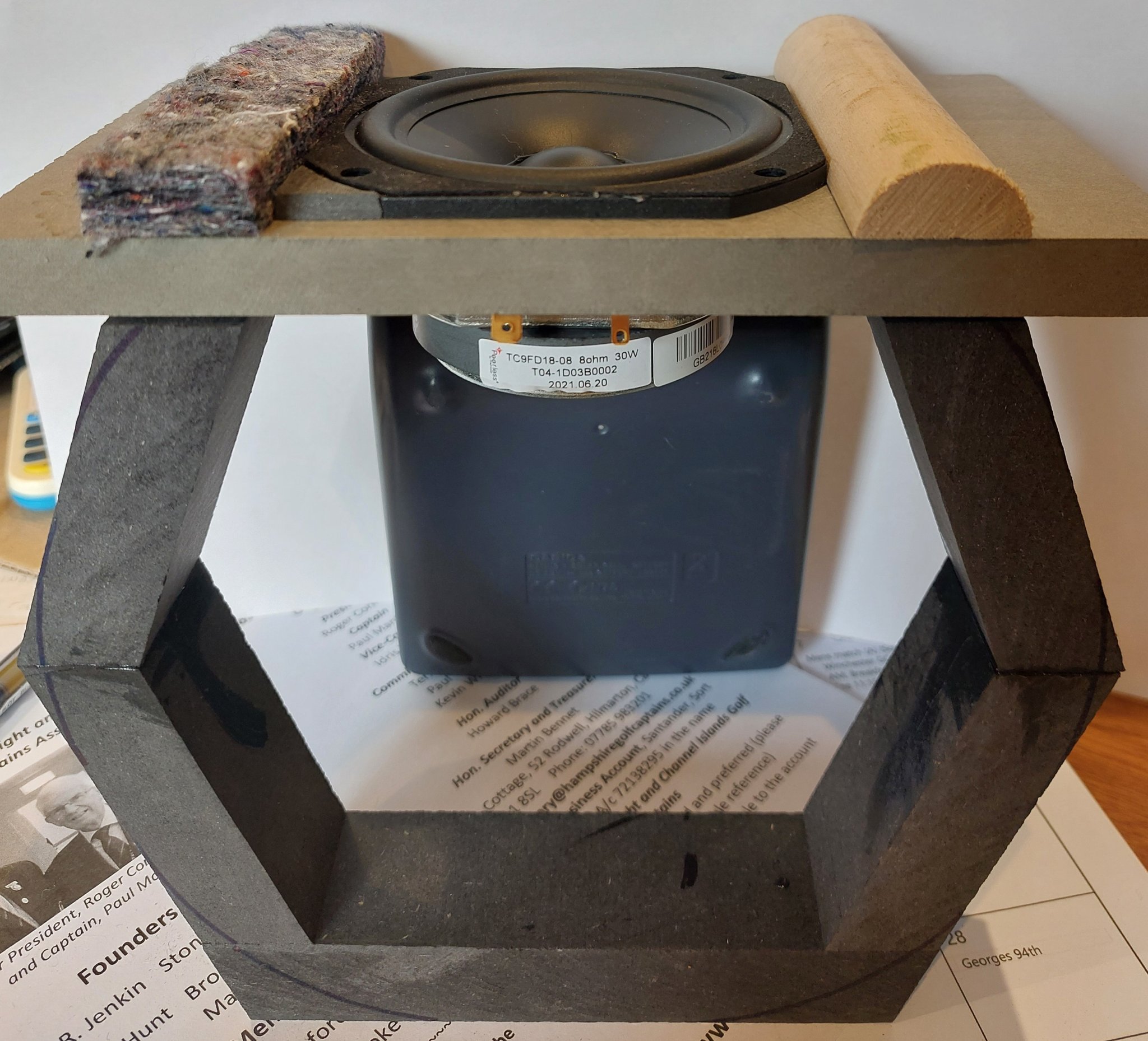

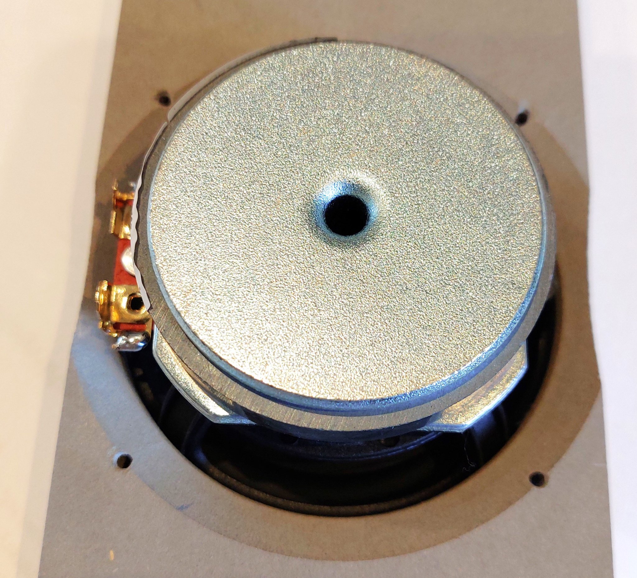

So the baffle "design" is currently a mock-up like this picture.
11mm MDF 132mm wide, with 75mm holes for each speaker so that the speaker chassis fit edge to edge at ~85mm centres
Back of holes 45 degree router relieved as shown in #112
Felt edge 25mm wide and uncompressed at 10mm deep which when wrapped in its sock will give some equivalent to the half round shown in the pic on the right but be absorptive as well.
The felt is Jantzen audio speaker cabinet felt and will go inside the boxes as well.
Little infill pieces to make the front flush at chassis front line.
Obviously the baffle is not yet trimmed to width as i would like to get the back cabinet right first and trim at the correct angles.
I have made the cabinet sides of two pieces so the outside can be rounded and the inner is not a box, then the sock should look reasonable on the outside as well.
Is it beneficial that the back is not parallel to the front? - if so that could be a two piece as well? - it would add marginally to the volume.
I can rout a cable slot in the back, either way, top to bottom.
Then back to volume, with 8mm dividers, this is 1.1 litres per chamber, i can extend the sides readily to get say 1.5 litres. its very neat at this size and would be fine also with the side legs 40% longer
All advice welcome!
