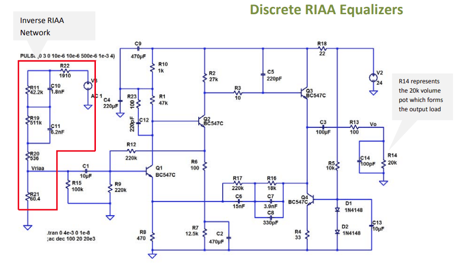

The 3~4 dB figure was quoted by Lipshitz. I agree it is a big spread but +- 1 dB from the era was I think quite the norm on good products - bit like 0.1% distortion being acceptable whereas now we tend to feel we can do better than that.
I have an old Pioneer receiver (from 1967) with a MM phono input under my bench I want to restore. It will be interesting to see what that is. I am not expecting anything better than 1-2 dB
I guess that input impedance is far below 47kOhm due to neg feedback resistor to the input base. With the quite low output impedance of your reverse RIAA-network certainly this will not show up.Here's one I designed and built in 1979. I tweeked the EQ network a few yrs ago in LTspice, so its quite accurate now

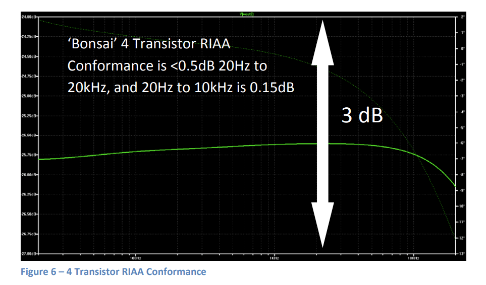

Heres the conformance. Its about 0.5 dB 20 - 20kHz
Heres the square wave performance and loop gain - not as good as an opamp implementation, but this type of performance was pretty much standard back in the 1960's and 1970's. If you can reproduce a good square wave after passing the stimulus through and inverse RIAA, you can rest assured that the conformance of the equalizer if good.
The Zin drops to about 10k at HF IIRC. This is a problem with most circuits of this type unless some sort of bootstrapping is used.
