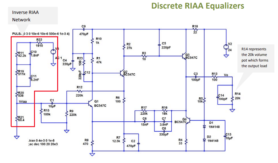

This circuit (from post #1) is a classic based on 1970's three transistors are enough type philosophy when they were quite expensive. But I took the challenge.

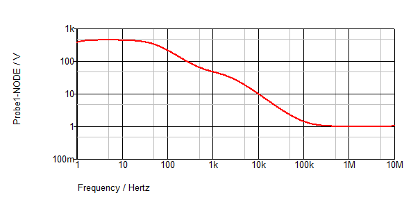

First, the OLG is likely to be low, so I calculated that. It came out at around 3300.
Then I considered that the output was effectively a high output impedance with a 12k load in parallel with the feedback network, so I changed the gain to a transconductance which worked out at about 0.332 A/V.
Then to establish a crude transfer function for the OLG I ran the frequency spectrum and that raised the first problem. The low frequency cut-off was too high to generate a respectable LF RIAA curve, so the gain needed to be increased. THe culprit was the 47 uF capacitor bypassing Tr2 emitter. That was a very common error for designers using the emitter resistor as the LF determining point rather than re, the small signal emitter impedance which at around 1mA is 25 ohms.
Thus, raise this to 220uF.
Next the HF point seemed very low, and the Miller capacitor high for such low current operation. Eliminated the 100pf and it seemed perfectly stable, but I haven't checked that.
The -3dB OLG points were then 24ms and 0.3us.
Then set the target gains at four frequencies and use Newton to home in on the values.
Result:
275k and 12.8nF; 20.3k and 3.73nF.
I hasten to add that just because this may be better (and I have not run the RIAA ideal against this to check yet) it could be that the rest of the circuit eliminated (for example) the peak in the original LF response.
Caveat: because the OLG is low the transistor gains will generate variations in the ideal components.
For stability if 10pF is needed for the Miller it makes little difference. 100pf shows a deviation and would need recalculating. I'd leave the 100pF out, or use as smaller cap as possible.
Centre gain measured 47.5 - that is 166mV for 3.5mV input at 1kHz.
Final edit: transistrs sim'd were grade B for gain.

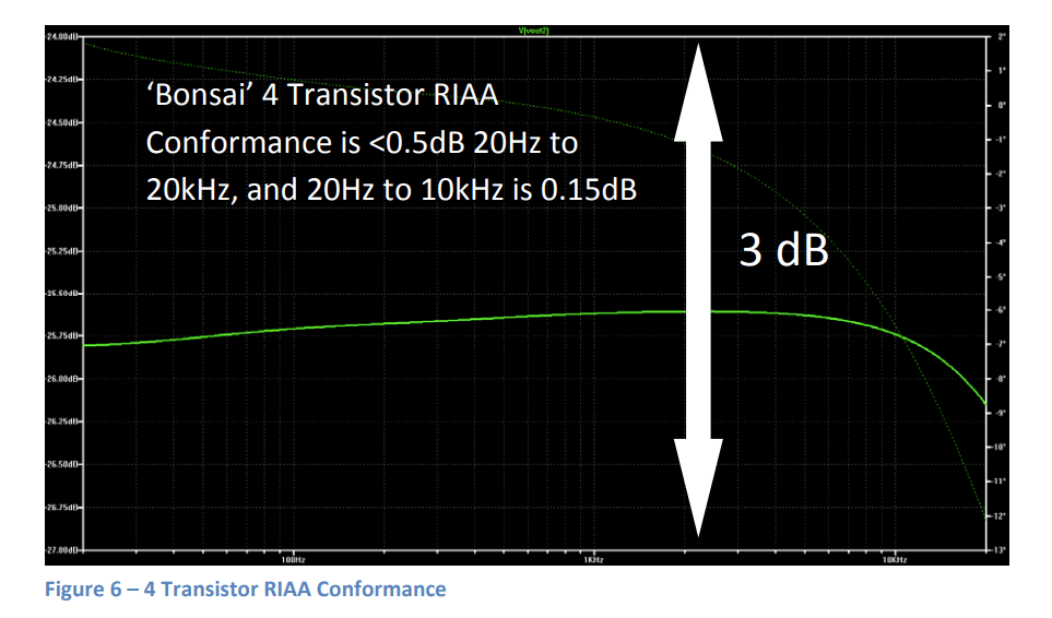

Here's one I designed and built in 1979. I tweeked the EQ network a few yrs ago in LTspice, so its quite accurate now
Heres the conformance. Its about 0.5 dB 20 - 20kHz

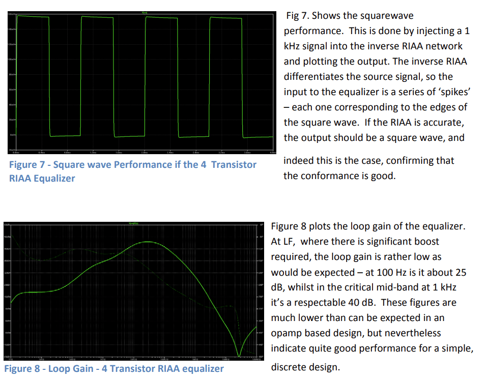

Heres the square wave performance and loop gain - not as good as an opamp implementation, but this type of performance was pretty much standard back in the 1960's and 1970's. If you can reproduce a good square wave after passing the stimulus through and inverse RIAA, you can rest assured that the conformance of the equalizer if good.

Basically, what he found in 1979 was that most commercial all active RIAA EQ networks were up to 3-4 dB out, so he developed a set of equations to resolve the issues.
