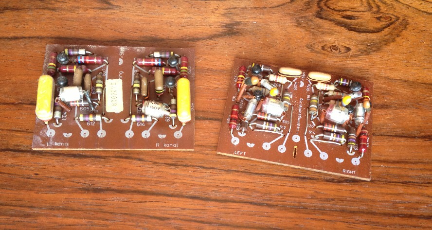

Nonsense......b & o use jfet and that is not good!!!!!!!!!!!!
First of all, jfet´s for riaa is absolutely fine.
Second..... B&O did NOT use jfet´s in their riaa´s previous to year 2000.
From the 1960´ies throughout the 1990´ies, they did with the same circuitry of 2 transistor pr. channel.
Used to be BC149 or similar, but that seemed good enough for all their radio´s/amplifiers for 3 decades.
You should stop making statemens about things, to which you have no knowledge 🙂
The Quad 33 used a 2 transistor cartridge stage. Baxandall, who consulted for Quad, and was instrumental in design of the 303 and ESL57, wanted to include a unity gain stage and used that to drive the the stage feedback from a low impedance. But Quad said no and kept with a two transistor stage. By plugging a circuit card in on its four edges you get two MM sensitivities, a ceramic cartridge, and a blank position that enabled a user to configure their own EQ. Often set up for CD or something similar.
It is worth noting that the transistor count in the 33 was a mere 6 transistors per channel. That took care of MM or ceramic input, tape in and out with selected gains, a Baxandall tone control, and a switchable HF filter with slope control. Comprehensive mono/stereo switching, tone and filter control cancel, and four inputs.
It was a landmark product, and still works exceeding well even today, many many decades on.
@Boydk where is the schematic????????
Here is one from Beomaster 3500. All digital functions, but still the "OLD" 2 transistor riaa pr. channel.
This was in production from 1990 to 1993. Exactly the same circuit, you could buy and mount as an accessory in the Beogram 1000 from the 1960´ies.
