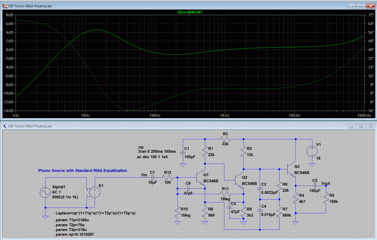

Where do I get that Laplace E1 cir?Here is the frequency response plot. At 1 kHz the gain is 46.88 and there is a greater than 4dB rise at low frequencies which would aggravate rumble. It would take some adjustment of the feedback components to flatten the response.

This is the FR when using the 2.2uF input cap in blue versus the 220nF in red that I used in previous sims.
Indeed, better maximally flat.

I noticed you changed the input capacitor C2 and R7. I can't: 220n and 1M5 serve my needs perfectly.Here you are.
I have used the universal amp 2 and entered all OPA627 parameters into this model.
BW=16Mhz, SR=55V/usec, Noise: 4.5nV/rtHz, Knee point: 400Hz, Offset: 130uV

What do you think of the passive anti-RIAA filter I am using, compared to the Laplace filter you use?
The results I get from your "Laplace" input are different from the ones I get from my RIAA filter, and I wonder which is closer to the real output.
I didn't know how to adjust the settings of "the Laplace" to sim noise and THD.
Do you think the settings I'm using on my sim are correct?
Laplace is the most accurate but can only be used in the .AC mode.
For the .Tran mode you will have to use the RC model.
Hans

Something that puzzles me is the "hump" I get on several on my noise sims on several of these RIAA versions.
I thought it might be related to the opamp model I was using, so I took my single IC Marcel version, with 220n and 1M5 producing the right filter for my needs. Then I used the OPA627 model you made.
Then ran the noise sim... to get the same curve hump.
Is there something wrong on my sim, settings or whatever?
Please run it and check, and tell me what you get.

I see nothing special.
That hump has everything to do with the rumble filter where the gain left of the hump is dropping rapidly.

You should expect to see noise levels following the frequency response fairly closely unless some parts have frequency-dependent noise models (1/f noise etc).
In a good MM RIAA amp the 47k resistor and cartridge series resistance are often the dominant noise sources. Spikes in the noise graph at high frequencies often indicate marginal stability as they are due to insufficiently damped poles.
