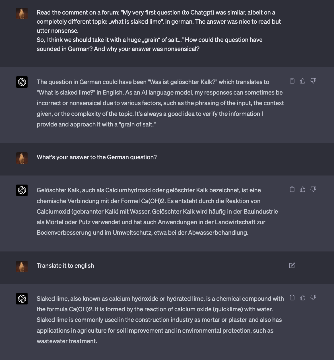

@myleftear I'll end up my part in this OT after this... but I asked GPT about your experience, and here's the answer (attached). I'm curious what's your take on "slaked lime"?

@Siberia ha! Smart move, and I must admit I made a mistake: I asked (in german) what lime putty, not slaked lime, is („sumpfkalk“), which is a different beast. Got trapped myself in the translation. The answer to slaked lime is good, the answer to „sumpfkalk“ is silly walk…)

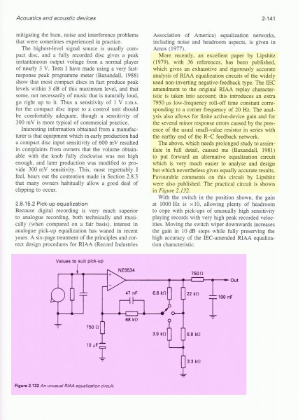

Peter Baxandall achieved much better than 0.1dB from RIAA, along with with switched gains of 20, 30 and 40dB, using standard resistor values and two capacitors of 47n and 100n. Single opamp.
I simulated the thing, and confirmed the accuracy. I then confirmed that 1% tolerances for all the component values resulted in less than +/-0.1dB deviation from RIAA from 20Hz to 20kHz.
Alas the design is in the Journal of the Audio Engineering Society, and is still copywrite in spite of being a 1981 paper.
https://pspatialaudio.com/phono_preamps.htm
Fair use.

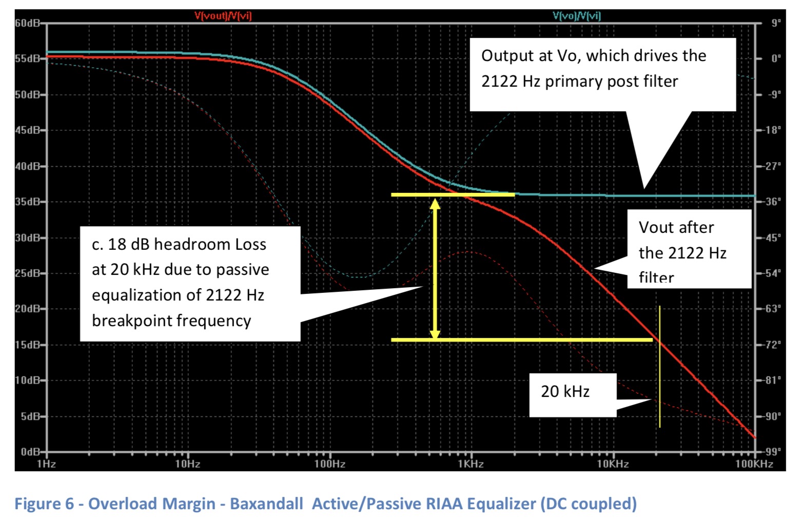

The problem with Baxandal‘s design is that it gives away 18 dB of headroom at 20kHz.
For low supply voltages like those in opamp circuits, it seems to me all active is the way to go, while for tube amps, passive is a good solution since you have more headroom (high supply voltages) and you can make the network impedance’s arbitrarily high to reduce loading (noise concerns notwithstanding).
