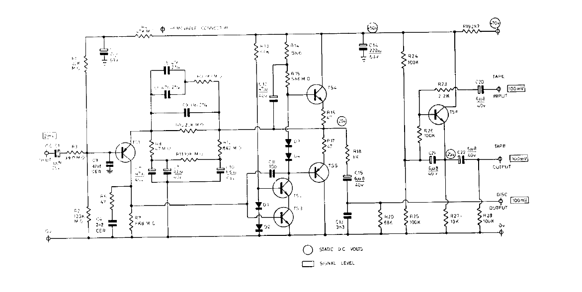

The T4 zero is still nearly 1000uS when it should be 318uS. It's just over 1000uS in the original circuit. T5=72uS which is not bad.Try changing the value of the 560k resistor in the feedback loop to 270k and tell us what you see.
This EQ is hopeless, and changing just one component is never going to fix it.

Well now, some interesting (and also expected) comments so far confirmed my also expected thoughts when I posted this thread.
What's interesting to me is that this somewhat typical RIAA preamp design was used for decades in just about every consumer product brand.... and even in broadcast equipment..
And yes, to those criticizing it's accuracy and inherent flaws, yet, it lasted for all those years with nary a complaint, before the magic of modern integrated circuitry and digital processing came about.
I did some listening tests with it, and compared the results with a modern IC design that surely wouldn't be shot down by critics with golden ears.
That IC driven preamp has a +/- 0.5% deviation to the 'perfect' RIAA curves.
And ya know what?
I really can't complain about the lowly 3-transistor version posted - any differences are so trivial that only an obsessed nitpicker with a loaded up pile of test equipment would notice.
Certain songs/tracks that I'm well used to, were a pleasent joy to hear again.

I don't know what this one is from, but in general I wouldn't say that. Lipschitz was scathing about commercial RIAA accuracy in 1979, as some reviewers already had been, and plenty of people had been getting it right for decades before that.it lasted for all those years with nary a complaint
This one needs more gain, e.g. via a bootstrap, and new EQ by someone who knows how to do it.

I recognize the expressions, and LTspice "Help" says a behavioural voltage source can implement the Laplace transform, although in the voltage controlled voltage source there's a note that the response must end falling with frequency, which the standard RIAA expression doesn't. Have you used this function successfully, perhaps with an asc. file as an example to show how?Better still: use an "E" with a Laplace transform:
- laplace ((75e-6*s+1)*(3.183e-3*s+1))/(3.183e-4*s+1) or
- laplace ((75e-6*s+1)(3.183e-3*s+1))/((3.183e-4*s+1)(3.183e-6*s+1)) if you care for the 3rd "Neumann" pole
On the general point of RIAA accuracy, we can't assume the lathe was right. The Standard for RIAA is defined by assuming a perfect velocity transducer on replay equalised by the three time constants and states that the recorded information should conform to that. In other words, a replay transducer would replay a cut record and equalisation to the cutting head would be tweaked to give a flat response. The cutting head was nothing like linear, so it wasn't simply a case of applying inverse time constants when recording. So, upshot is that recorded accuracy was probably also poor. Especially if that awful two-transistor feedback design was used as part of the reference. Or its direct predecessor using a pentode. Both were inaccurate because there was insufficient gain for equalisation to be defined by feedback without the (variable) open-loop gain being taken into account. And that's even before we get to noting that most people applied the time constants incorrectly so that even passive networks were likely to be wrong. Lipshitz expands on that in his paper, where I think he only found one published expample where the designer got it right. Or that the loading impedance on the cartridge probably didn't conform to what the cartridge manufacturer expected. It's a miracle it worked at all!

Looking onto the simulation, at a first glance it looks hoorible - but:
The frequency axis starts at 1 HZ and the +4dB peak is at 15 Hz. Between 50 Hz and 20 kHz, the deviation is just +/- 1 dB. No wonder that the listening experience does not give huge differences to a circuit with ruler flat response.
Depending on the amp, where this preamp was part of, with its many coupling capacitors following this preamp, it can be expected that this peak is gone when looking on the overall response. As mentioned, the coupling at the output was a 1uF cap into 47k already forming a HP with 3.3 Hz corner frequency already reducing the peak by 1 dB.

Additional to the suggestion by Rongon (reduce the 560k to 270k => 274k) I made some minor changes to the output cap C2 (now 47uF), the load R5 (now 4.7k). Changes in the C3/4-R6/7 network and including the model of Mooly (RIAA source) the deviations boild down to less than 0.5dB from 10Hz to 20kHz. Further notes: The Miller cap for Q2 was missing in the Spice models; I tuned it to 110pF (originally 100pF). The C6 between the base and emiter of Q1 had no effect at all in my simulations, I removed it.
So in theory, this design seems not so bad, but in reality spread in capacitor values and not-included parasitic terms will spoil a lot and the distortion performance mentioned by Baldin above would require further mods or a more refined design.
👍 well spotted.The Miller cap for Q2 was missing in the Spice models; I tuned it to 110pF (originally 100pF).

Not a good scan of the phono stage I'm afraid. The right hand stage is just a tape buffer.
Yes but open loop high transconductance JFETs sandwiching passive EQ. Reminiscent of classic tube phonos. Have also tried BJTs with loop feedback EQ but not as good when very few. Better when more complex developed to discreet op-amp level.Well Nick, you would know about 2 transistor RIAA, wouldn’t you? 😉
