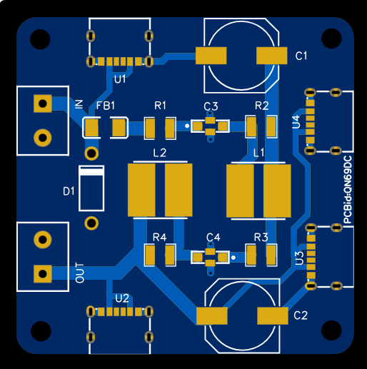

Trying to layout w/ usb-c connector.
嘗試使用 USB-C 連接器進行佈局。
I will make pcbs next month and verify it.
You got inspired by Raspberry Pi I see 🙂 It really is better to have connections at 1, maximum 2 sides and not on all 4. Also using the very same connector for both inputs and output may be confusing. Not at first but after a while. If you use vertical USB-C PCB mount connectors and regroup all outputs at the same side and input as a horizontal version at the opposite side (or at a distance) it will be one fault possibility less.
Some members made versions with Meanwell IRM-15-5 module and mains fuse integrated which saves 1 cheap switcher, 2 connectors, cabling and clutter.
Reactions: iitzex
Strange that AmyAlice (post #1 of this thread) uses a surface mount part for D1, while you've chosen a thru hole D1 instead. Also it appears that your layout has plenty of room to enlarge the landing pads for component leads, to make it easier to assemble and rework the board. From post #18 in this thread:
Notice how large and roomy the component footprints are, with generous extra solderpad (copper) extending way beyond the component body. This gives you more room for, um, imperfect component placement and imperfect component rotation during soldering. The extra room also allows you to touch up the board with a standard pencil soldering iron and wire solder; there's plenty of clearance and plenty of PCB copper to fit both the iron and the solder wire.
In fact, every single component on the board you see here, was soldered with a chisel tip soldering pencil and wire solder. No stencil, no solder paste, no hot plate, no hot air rework blower, no reflow oven. Just a Hakko FX-888 fitted with (this bog-standard tip) and using (this unexotic wire solder). Of course you are free to solder your AmyAlice any way you wish, and I certainly do not claim a solder pencil is better than the others. It is merely an example of a very old-school soldering method that happens to work extremely well on AmyAlice. This PCB gives you enough room to try several different soldering options. Thanks to the spacious, roomy component footprints. Wasteful? I don't think so but others may disagree.

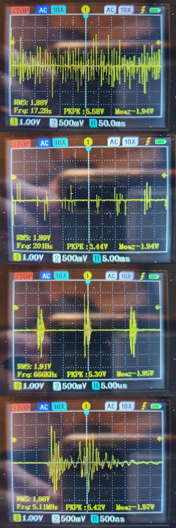

Hello everyone,
I've got a problem with MCU (arduino nano) when I turn on my inverter (12.8V lifepo4 > inverter 2500w 230V).
If I calculated right, the inverter produce this noise @50kHz in the 12V DC supply path. Other 12V devices work fine.
Someone suggested AmyAlice filter, and suggested to ask here if it is good to solve my problem or could be modified to achieve my purpose.
Thanks in advance

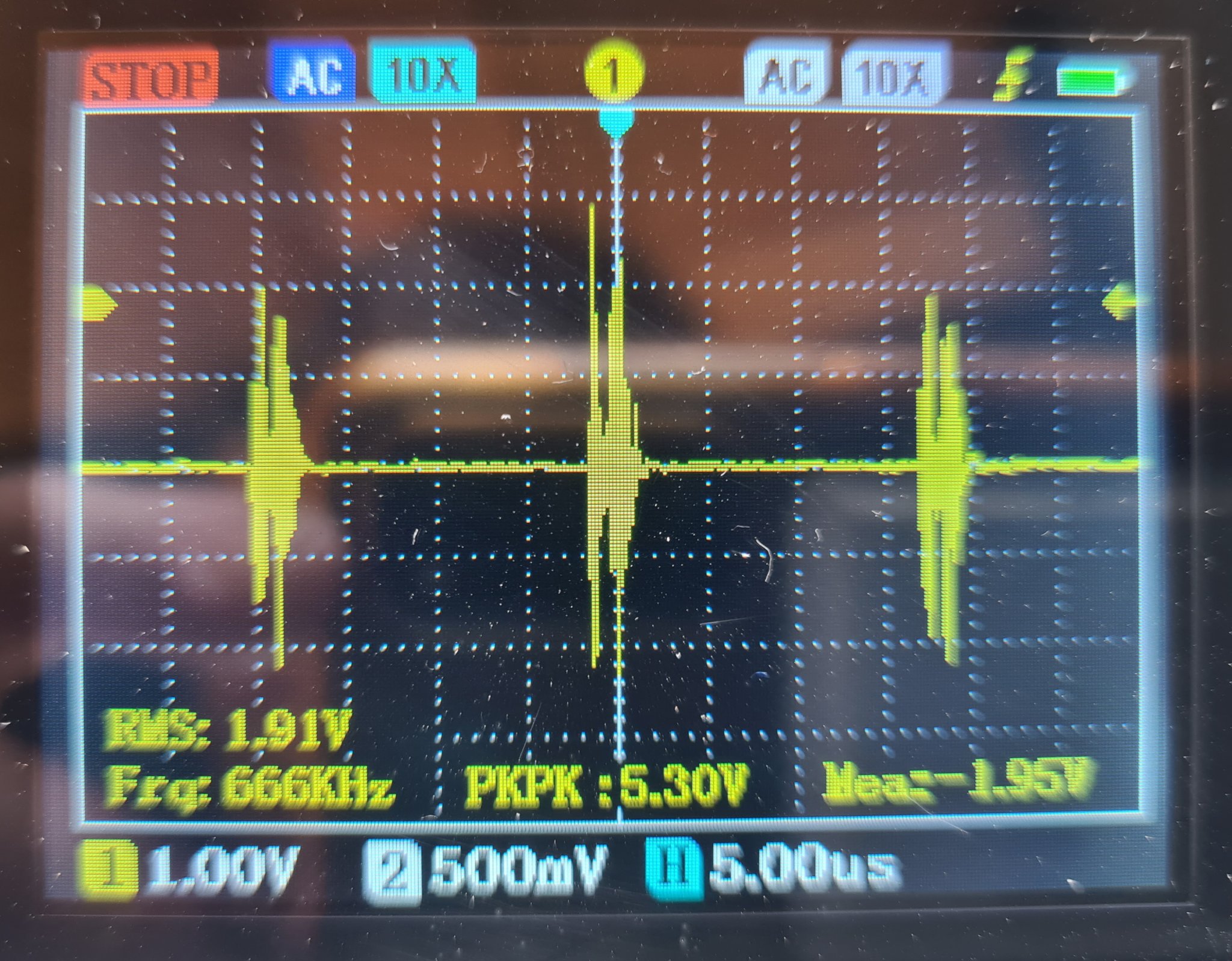

Tired today and on the road, but had quick glance on my phone... I see roughly 500kHz (bit less than half a square which seems to be 5us, so say 2us)... and even twice that.
Says 666kHz frequency on screen, consistent with the above, could it be just that... and its double. So 0,5 to 1.5MHz to be covered?
AmyAlice would love it
Claude
I have not understand why you (and DSO) calculate 666kHz from the time lenght of the peaks (so yes, less than half square so 2us) while I calculate the empty space between these noise peaks.
While switching happens at 50kHz (correct me if Im wrong) the noise is in the range of 666kHz?
I've calculated 50kHz because between peaks I see 5us x4 (a bit less, like 3.7).
5us x 4 = 20us > 1/20us = 50kHz
Also, i really doubt that an inverter has 666kHz switching frequency because it means:
  • with 50kHz and AC out freq 50Hz the factor is 1000. So 1000 steps are used to create the sine wave, full period.
  • with 666kHz the steps would be 13320, a bit crazy for an inverter to simulate a pure sine wave
I'm new to oscilloscope world so correct me if Im wrong. Thank you

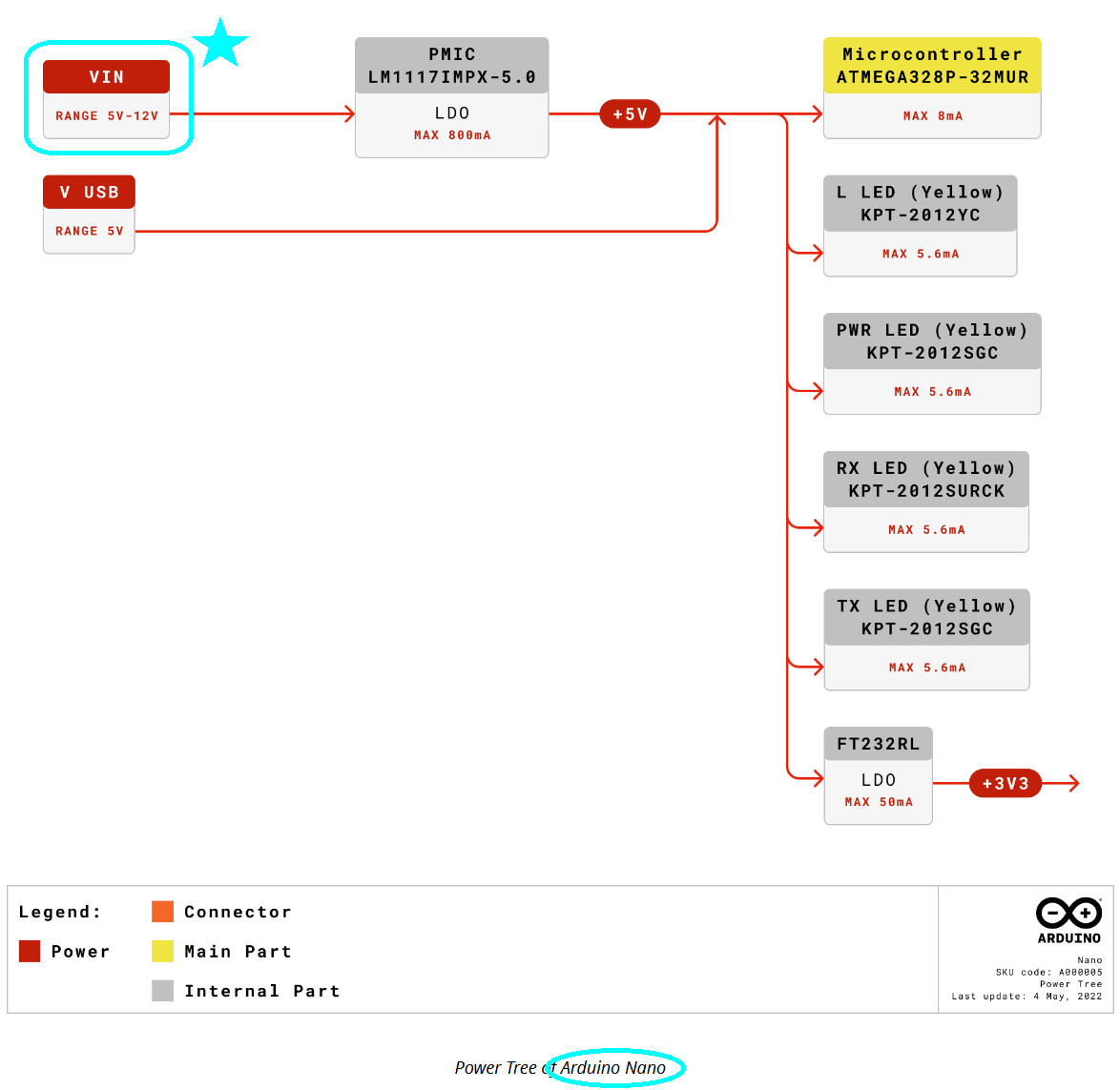

I looked at the datasheet of the Arduino Nano, and only found one place where it is legal to apply a 12V power supply. It is marked with a blue five pointed star in the attached image.
Apparently the Nano will accept any DC supply voltage between 5V and 12V. So it appears that you can install any filter (or series connection of several filters) that you wish, between your noisy 12V supply and the Arduino Nano "VIN" connector ----> as long as the voltage dropped across the filter(s) is less than about 6.5 volts. If the current flowing is the maximum allowed by the LT1117 voltage regulator on the Nano board (0.8 amperes), that means your filter(s) must have a total DC resistance, end to end, which is less than 8.1 ohms.
Perfect analysis. I can reduce 12V to 5V by myself but even with DieNoiser LM317 regulator, the problem start when I turn on inverter. Obv, if I use 230V to 5V usb charger the MCU works as expected.
The total load will be 30mA x 8 sensor, + 30mA per MCU + 50mA per LCD2004 display (I'm generous). So 320 mA and 20ohm.
Can you tell me which frequencies I aiming for? I really can't understand which Hz I need to suppress.
I post more useful scope screenshots
As you can see frequency vary if I zoom in time axis. But amplitude of ±1.9V RMS is the same. A bit aggressive for every kind of DC DC or regulator, if spiked at high frequencies.
To tame that someone suggested big ferrite beads on 70mmq wires that supply power to the inverter. But I'm sure that can't solve the problem.
The ripple of SMPS is, in amplitude, way smaller. For that I'm concerned. But if I have 6.5V to "sacrify" to achieve this instense-spikes noise suppression I'm confident that I can find a solution, even if is not a proper AmyAlice filter but a sort of (like PZ filter).
