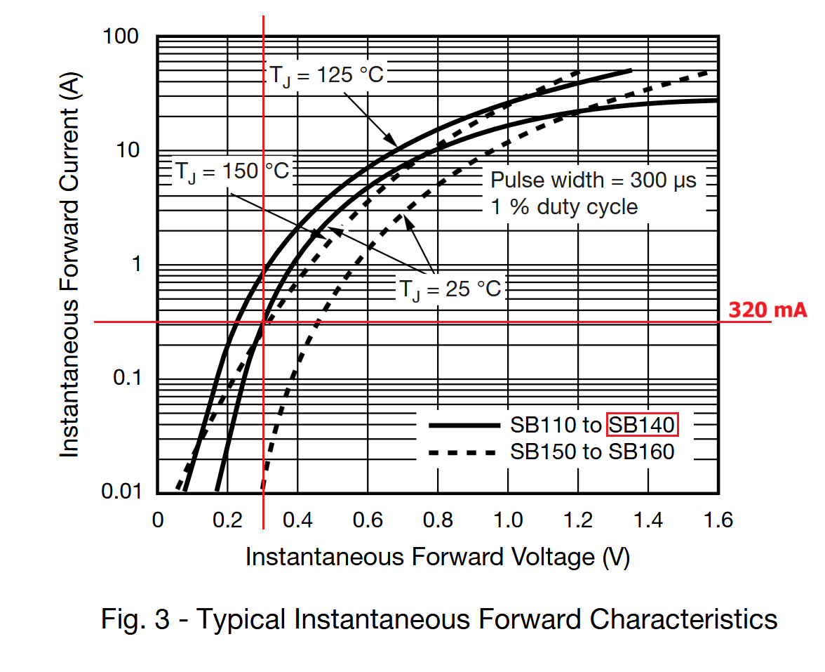

This single electronic component costs USD 0.28 at DigiKey (qty=1) and cuts your noise amplitude in half. Its voltage drop at 320 mA is about 300 mV , thus you still have 6.2V more voltage drop which you can divide up among subsequent series filters.

Diode Schottky Barrier SB140This single electronic component costs USD 0.28 at DigiKey (qty=1) and cuts your noise amplitude in half. Its voltage drop at 320 mA is about 300 mV , thus you still have 6.2V more voltage drop which you can divide up among subsequent series filters
If we suppose 1A current we have 0.4V drop and we can put up to 16 diodes in series.
But while I can reverse eng. your snap of datasheet, I'm not confident on the layout of the filter. I simply put 1~16 diodes in series, forward bias, on the positive terminal that go to Vin? Seems so.

A diode (and subsequent filter capacitances) removes the bottom half of the noise waveform. But you can only remove the bottom half once. After it's been removed you can't remove it again. So there's no noise removal benefit if you try adding a second or third or additional diode after the first one. Sixteen diodes is a bad idea.

I got it about diode, it is logic. I wansn't thinking about how it would operate. I missunderstood your "subsequent series filters" referring not to diodes but to LC or similar filters.A diode (and subsequent filter capacitances) removes the bottom half of the noise waveform. But you can only remove the bottom half once.

Diode doesn't work. Maybe is fake? It is from aliexpress.A diode (and subsequent filter capacitances) removes the bottom half of the noise waveform. But you can only remove the bottom half once. After it's been removed you can't remove it again. So there's no noise removal benefit if you try adding a second or third or additional diode after the first one. Sixteen diodes is a bad idea.

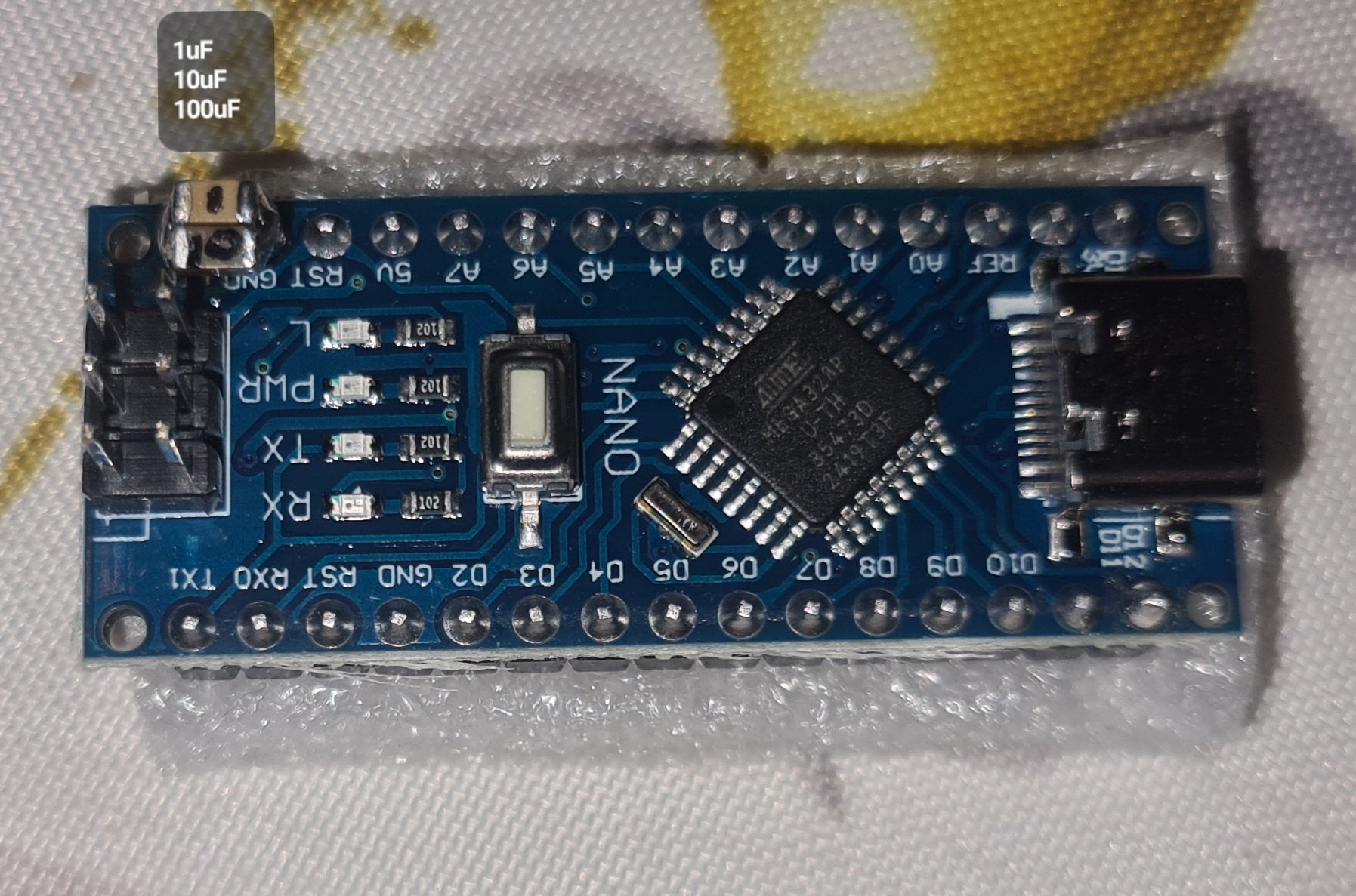

0.1,1,10,100uF 1206 SMD parallels caps on Vin/GND of Arduino have not solved (shortest path possible).
Isolated optocoupled 7-80V AC/DC to 5VDC SOLVED the issue on Arduino side but OBV not the general ripple on 12V rails.

I'm calling out on this assertion - forward biased diodes act rather like a low value resistance in parallel with substantial capacitance - not going to filter out RF much at all. RF switching with PIN diodes uses this property explicitly - forward biased acts as low-loss RF conductor, reverse bias acts as very small value capacitor (for a PIN structure at least). Ordinary PN diodes are similar but with higher off-capacitances and not very linear (with strong RF).

I've read that 1206 SMD capacitor are the best compromise for ESL since no leads reduce inductance path. I've connected between Vin and GND pins (look at photo) so the shortest path possible BUT the spikes are so BIG (2.5-8Vpp) that I doubt they could properly help.You want high values of capacitance with low ESL to shunt

Well, new diodes added to the collection 😆 Yes now you say that I totally misunderstood the behavior under RF.forward biased diodes act rather like a low value resistance in parallel with substantial capacitance - not going to filter out RF much at all.
It blocks reverse current (negative half wave) at lowest frequencies while going up to RF these freq bypass the component because the "equivalent parallel capacitance".
