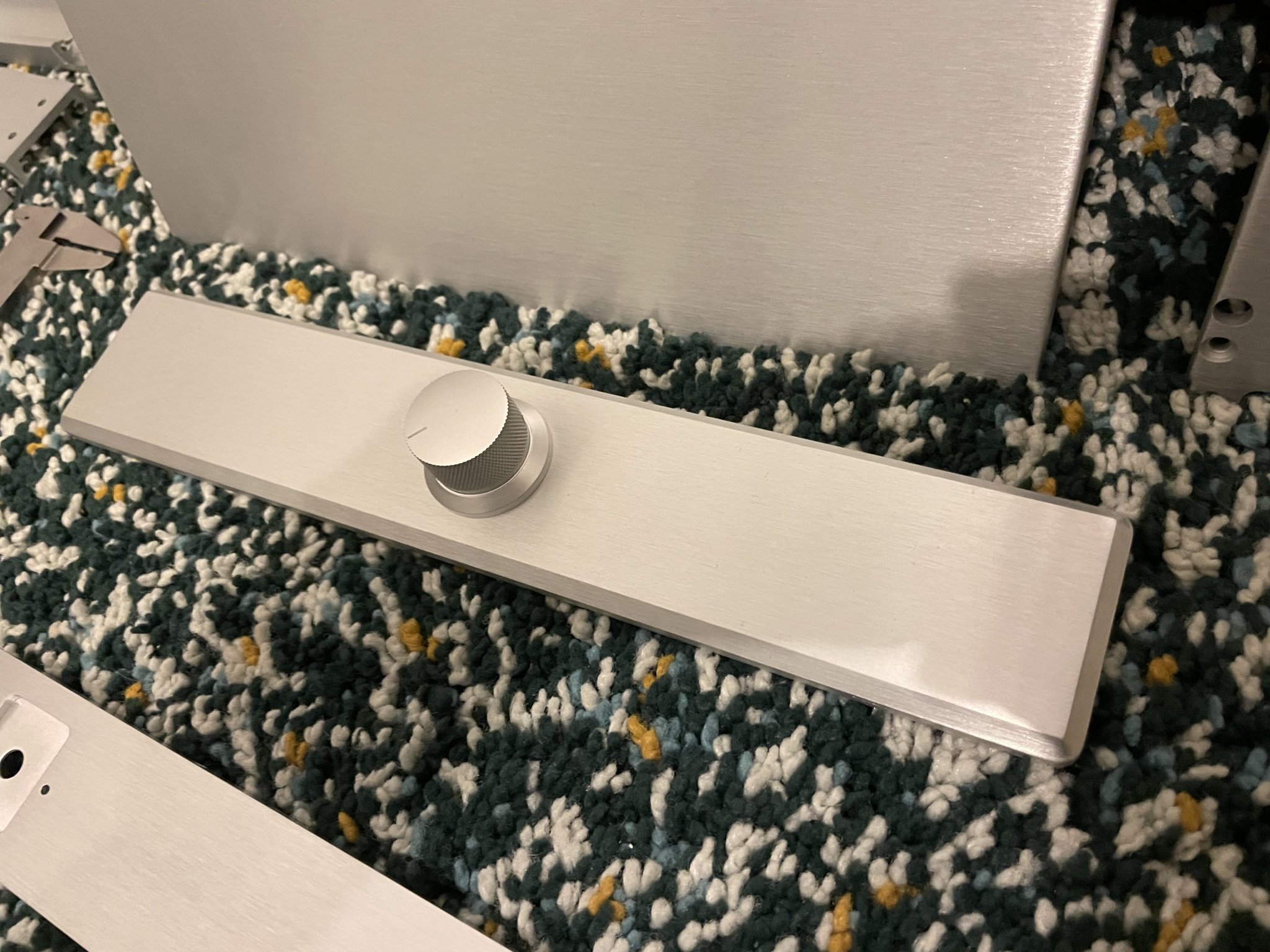

Is it possible to get the source of the volume button from the store kit? I built this kit, but I would like to esthetically match this component with another (original B1). Hopefully this is possible.
The volume potentiometer in the kits is an ALPS Blue RK28 100KA, but you could use a 50k too. This is the same model used by many of the preamp projects around diy audio. Excellent quality and performance. And the diyaudio store also carries break-out boards that fit them for ease of installation.

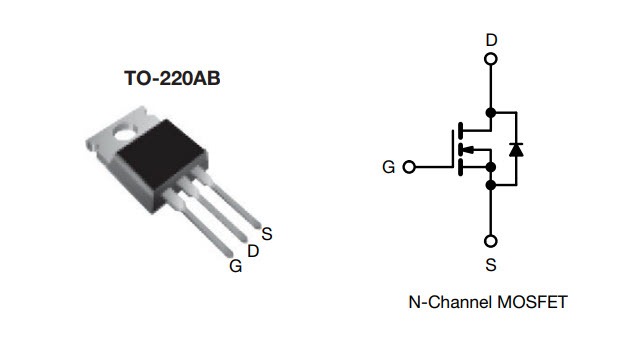

So.. started my first diy amp build, things are going pretty good and I want to solder in the fets. I bought some spares so it would be nice if I could match the J113’s and also the IRFP610’s.

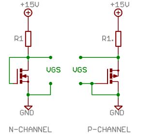

For the Jfets, I found this diagram but as I am a complete beginner with electronics, I wanted to make sure I was correct.
I connect the positive of a 9v battery to the drain. With a 100ohm resistor in between, then ground to source and to the negative of the battery? And measure voltage across the resistor? And then calculate the current? What value would be ideal?
For the IRFP610 I can use the same method?
So i was able to match the J113's. i followed the method with a 9V battery and an 100 ohm resistor, measuring across it. found values from 2.3v to 2.7v. I had 2 closely matched at 2.6V
For the IRFP 610 i dont have much luck in using the same method. dont get a reading on the DMM.
Also tried a variation on the article linked above, but as i dont have a 15V supply i used the 9V supply and the 100 ohm resistor. not sure if i do it right but if i measure the voltage between gate and source, i get a certain voltage ( i think it starts at 12mV), that is rising, but when i disconnect the supply, and reconnect, it will keep rising further on the previous voltage, so it keeps going up every time i reconnect. it also seems to measure irregurarly. i just tried one fet, cause i dont want to mess up the rest if i did something incorrect. could someone maybe explain it in a easy way how i can measure the irfp610, with the test setup i have? I have 10 610's so would like to find 4 similar ones.
9V battery, 100 ohm resistor ( i do have some more lying around, biggest one is 1.5K)
i used the diagram attached, but not sure if i did it correctly.

ZzerO, Please read Nelson's article that amandarae referenced again. Note that different currents for the various devices and the formula for calculating the resistor value. Use Ohm's Law to calculate the resistor values.
After reading the article, ask if you need further assistance.

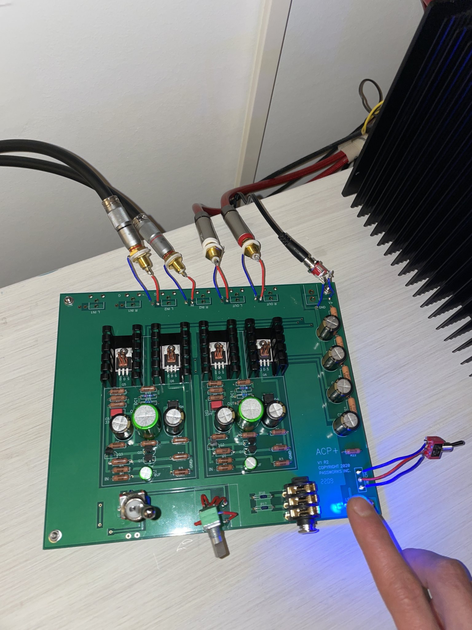

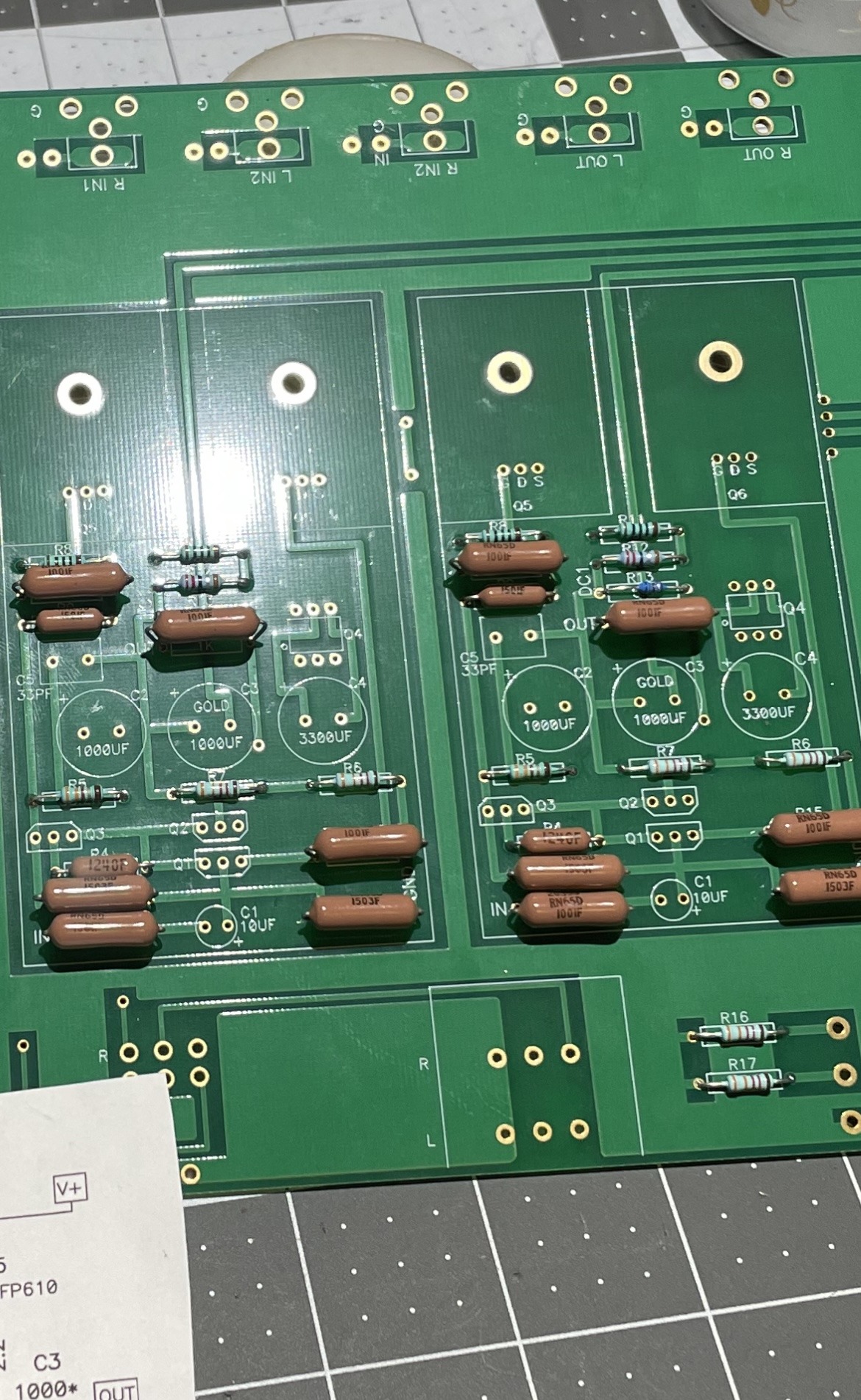

Hello, noob here. I recently received and finished the ACP+ “naked” yesterday. the build went easy enough the parts selection sent with the kit was very nice. It powers up, I have 24v, led is lit, however I have absolutely no sound through the rca outputs or the headphone Jack. I only get a thud when powering off, ive tried different sources and cables. I’ve also noticed that both Q5 get quite warm and both Q6 stay cool. Any help figuring this thing out would be greatly appreciated.

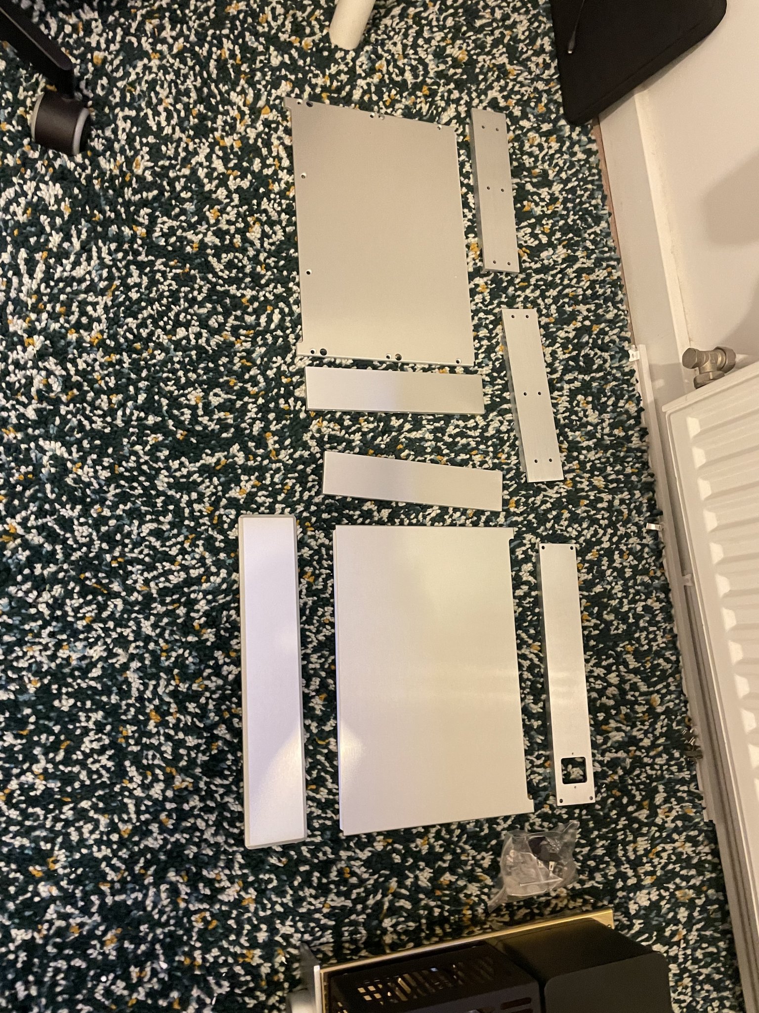

This is the case I got
It’s 330mm x 228mm x 62mm full aluminum so plenty of room to add the diy power filter later on.
Started the drilling at the back
Because the case is completely closed I think it could be beneficial to make some vents in the back and the underside? To get some heat out? Any opinions?

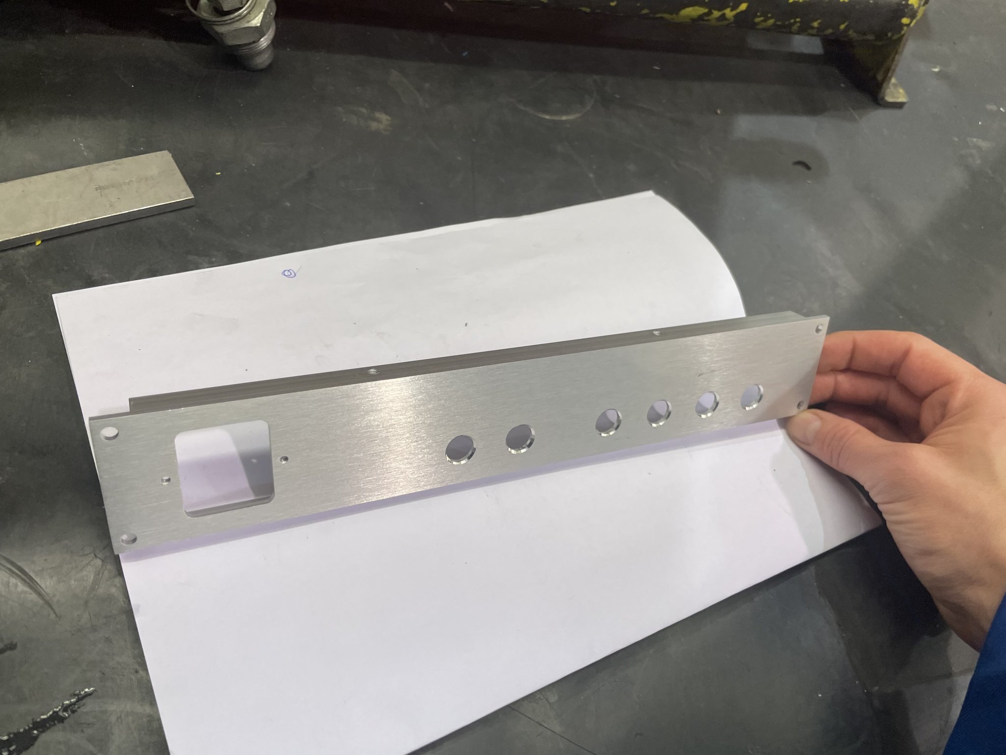

Allright, Will see if I can get some sleeves milled at work, always looks nicer than holes 😄. If not then a lot of small holes will do.

Did you take any voltage measurements that Nelson recommended in his article?
Please measure the following DC voltages:
1. Voltage across R18
2. Voltage across R4
3. Voltage across R15
4. Voltage between test point DC1 and Ground

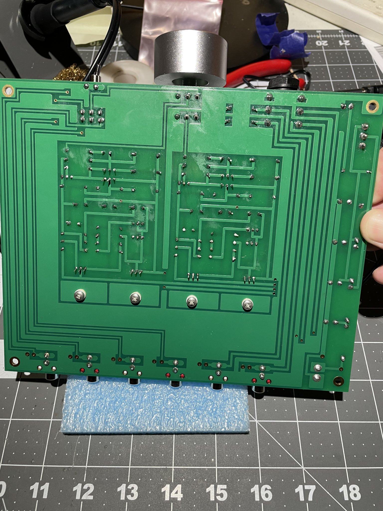

A picture of the bottom of the board would also be useful to check for possible issues.
Ben I appreciate the response!
i didn’t see where it mentions correct voltages for R4 and R15 in the article. Here’s what I have. I’m not sure if I’m measuring Dc1 correctly. Is it measured from ground and each point at dc1? (R12 R13)?
Here’s what I have.
R18 .4
R4 11.7
R15 10
Dc1 1.4

R12 and R13 are connected together at DC1 so either resistor lead will give the same voltage.
When stating a measurement, always include its unit of measure. I assume that your numbers are in Volts. Are the measurements the same for both channels?
Looking at the numbers there is an issue with the bias voltage to the output mosfet. Q3 is working properly, but there are issues with Q1 and Q2. Q1 has too much current through it and most likely Q2 has no current through it. So either Q2 is damaged or there is an issue with the circuit around it, or possibly Q1 is damaged (shorted).
Did you measure each resistor to verify their resistances before installing them? Looking at you picture it is hard to see the colours of R5, R6, R7. They should be 33.2K. You need to verify the resistors that you have on the board. What are the colours? You can go online and find a calculator that will convert the colours to Ohms.
