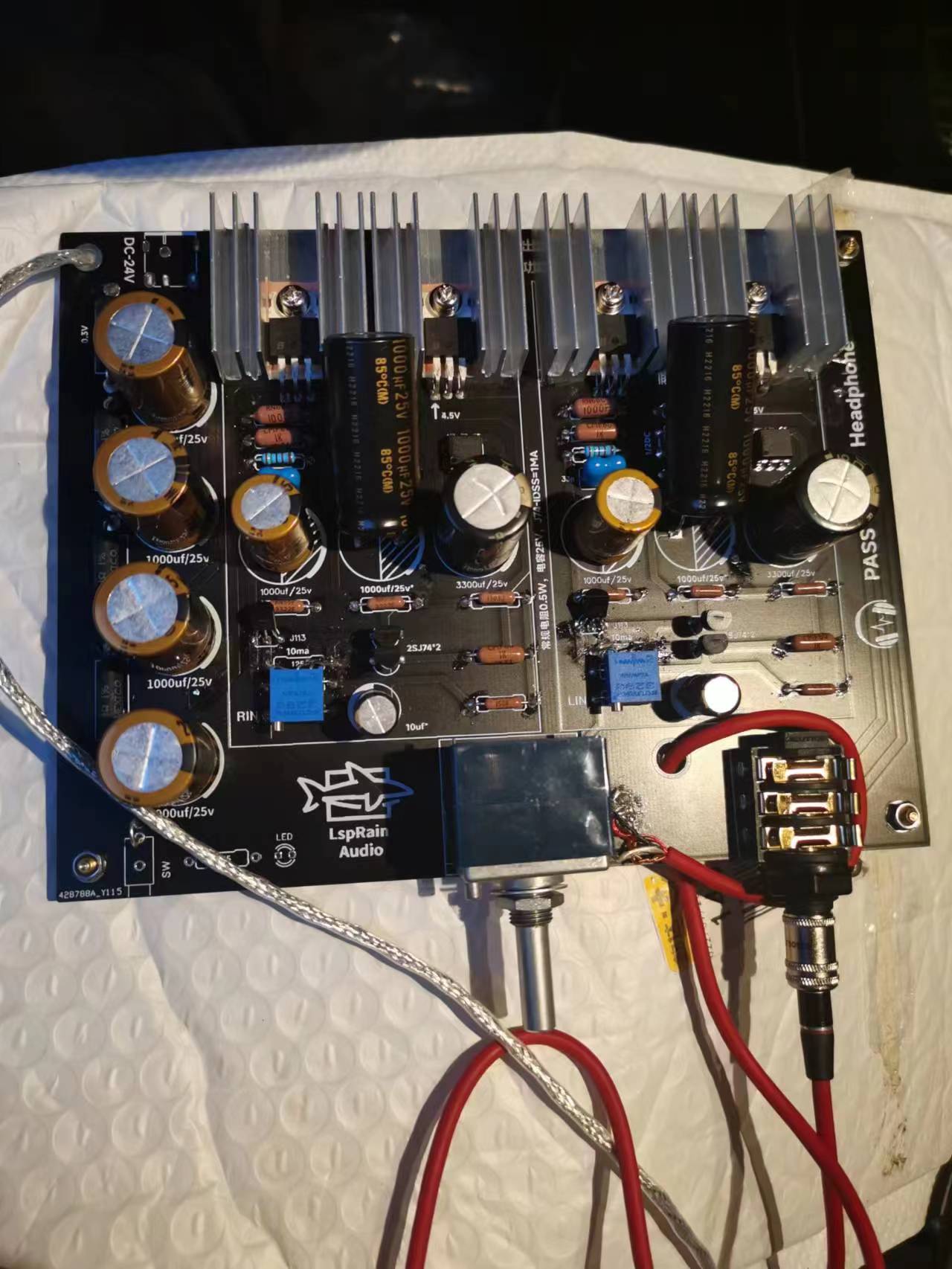

Just completed my ACP+ and realized that I forgot to order my headphone jack. Kinda would like to wait to order it until I need some more parts. Will the circuit work without the jack or will I need to temp jumper wires in place of it?
The circuit will work without the jack as the default output is to the RCAs on the rear (i.e.: the headphone adaptor is really a little 2-way switch, and when you do not have the 1/4 jack installed, the in/out pins are connected. When you insert the jack, it lifts the contacts off and connects the outputs to the 1/4 points. You will have to temporarily jump the "in/out" pins for the L and R to be connected as the switch would connect them when clamped down (i.e.: no 1/4 inserted). If this sounds confusing, feel free to DM me or just wait until your connector arrives. 🙂Just completed my ACP+ and realized that I forgot to order my headphone jack. Kinda would like to wait to order it until I need some more parts. Will the circuit work without the jack or will I need to temp jumper wires in place of it?
Thanks Thomas!The circuit will work without the jack as the default output is to the RCAs on the rear (i.e.: the headphone adaptor is really a little 2-way switch, and when you do not have the 1/4 jack installed, the in/out pins are connected. When you insert the jack, it lifts the contacts off and connects the outputs to the 1/4 points. You will have to temporarily jump the "in/out" pins for the L and R to be connected as the switch would connect them when clamped down (i.e.: no 1/4 inserted). If this sounds confusing, feel free to DM me or just wait until your connector arrives. 🙂

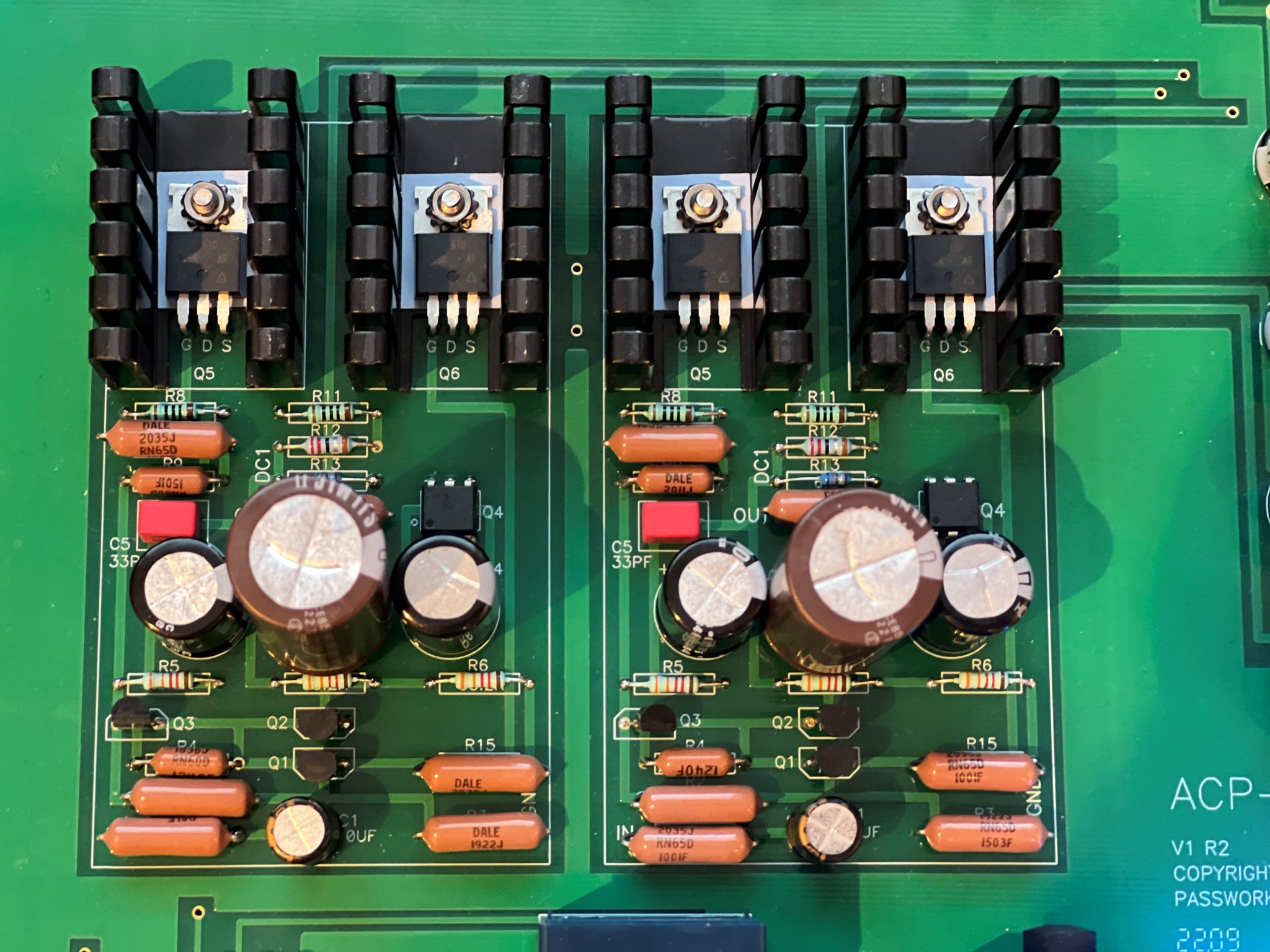

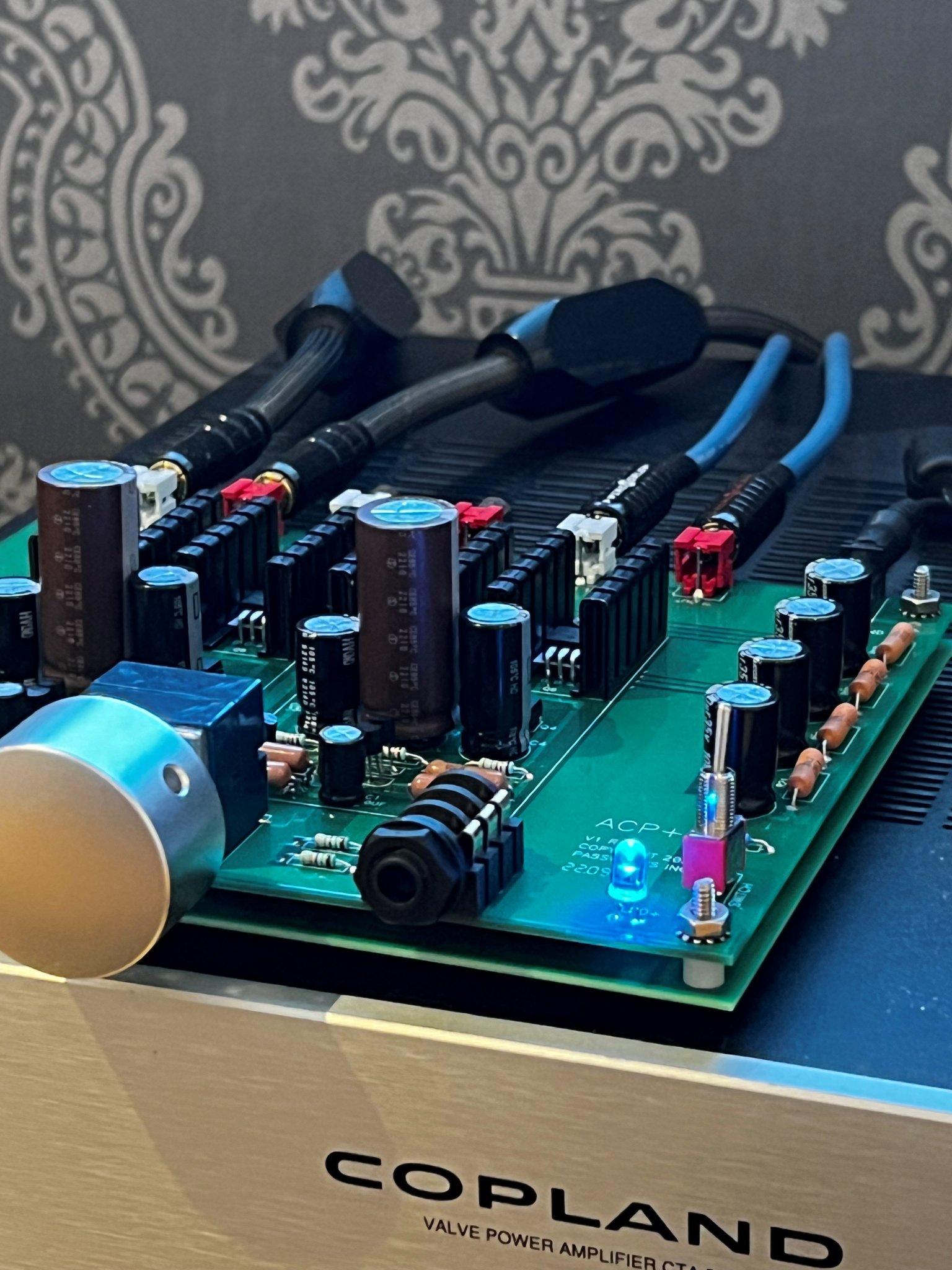

Completed my ACP+. Very satisfied with the result both appearance and sound quality. Made some minor changes. Both C1 and C3 are bypasses with 0,1 uF Wima, between PCB and ground plane, and C3 is replaced with Elna Silmic II. No particular reason for the change, but more that I feel that use of decoupling capacitors make sense and I like Simlic. I do not use the supplied wall-mount PSU, but the PSU from the ACA mini kit. ACA mini, when finished, will have PSU from Meanwell 24v/5A. Both amps will have SMPS DC filter,P089ZB.
In summary
Very happy with the sound quality from ACP+ and looking forward to completing the set-up with ACA mini. Speakers are Klipsch Heresy and hopefully it will make a nice combo with these amps.

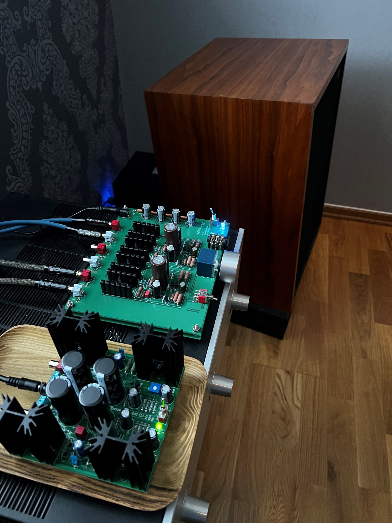

Then we have finished building ACP+ and ACA mini. ACP+ is operational while ACA mini is adjusted and waiting adapter for speaker connection.
