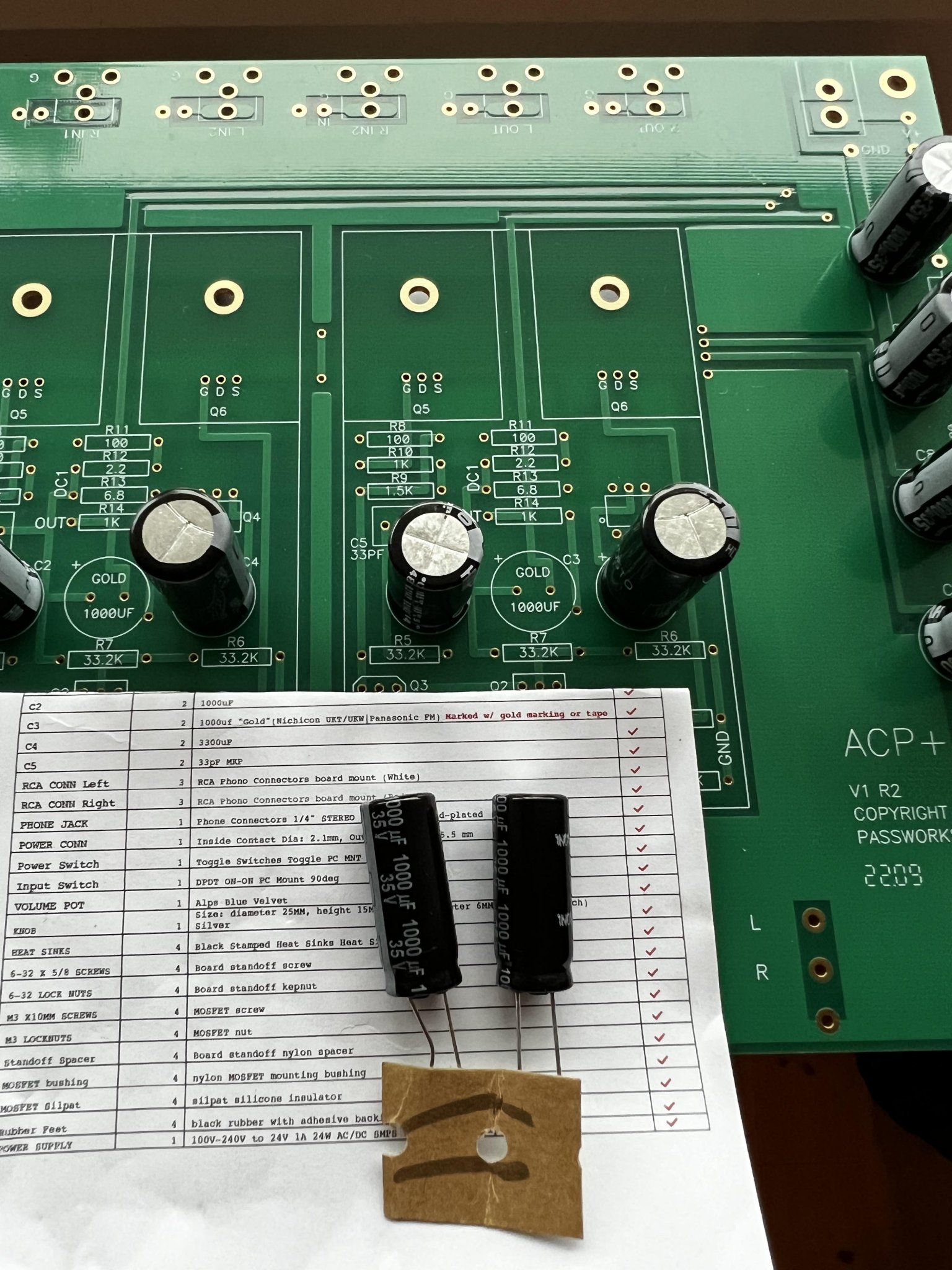

Lol… it’s not a no-name cap, it’s a 105C Panasonic FM series EEU-FM1V102, and sadly the heat-shrink wrapper they install at the factory is plain and boring black. Amazing capacitors, that currently have understated and stealthy wrappings.
You are welcome to try and find a better spec’d capacitor than that, particularly in impedance/ESR, but it’s going to be a very long search.
Yes, in the past the FM- and FC- series caps had fancy shrinkwrap with gold on the label. The FC- looked particularly dashing with blue/gold. But I’d assume their supply chain for wrappings has been simplified and they just have basic black.

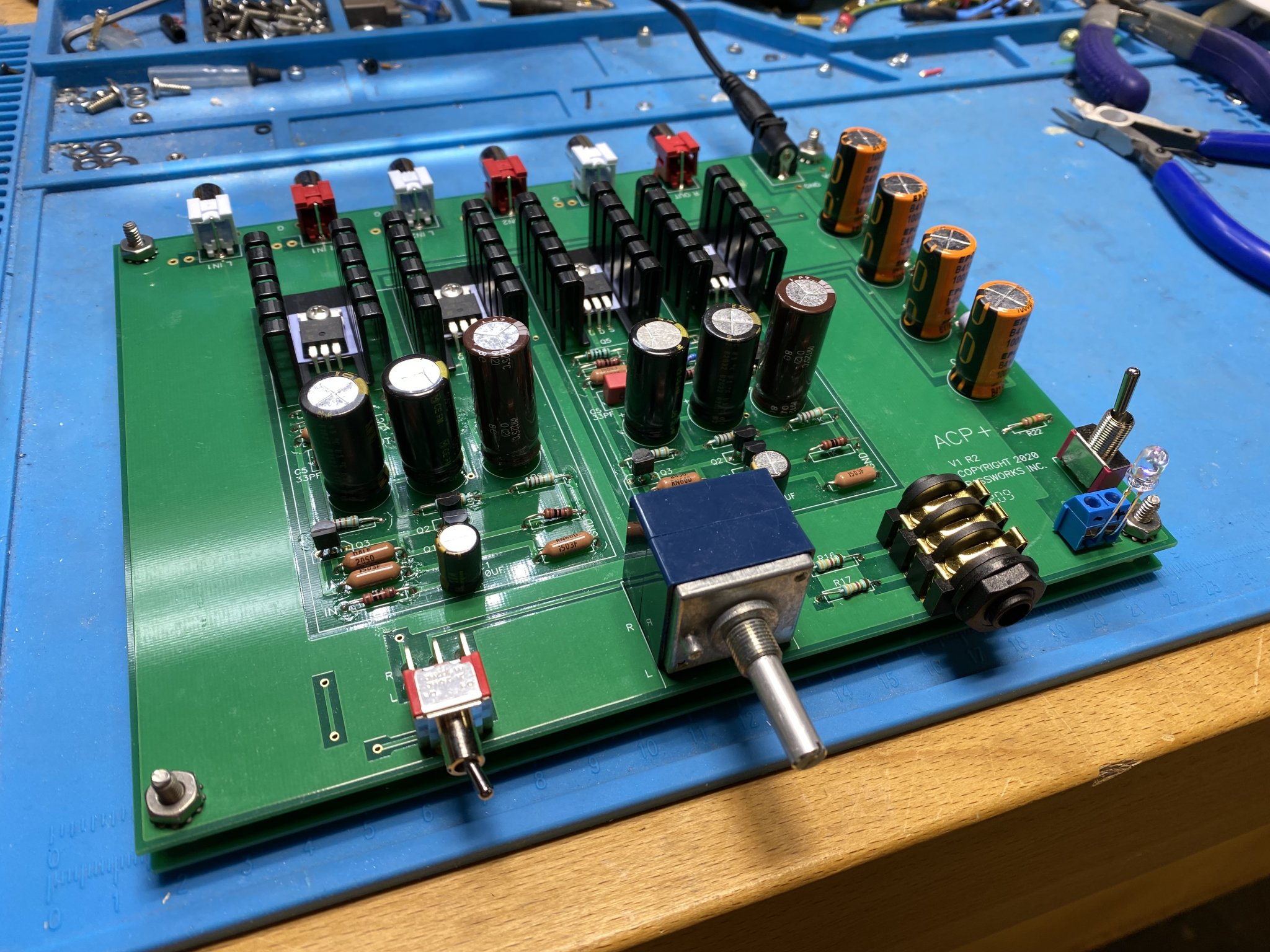

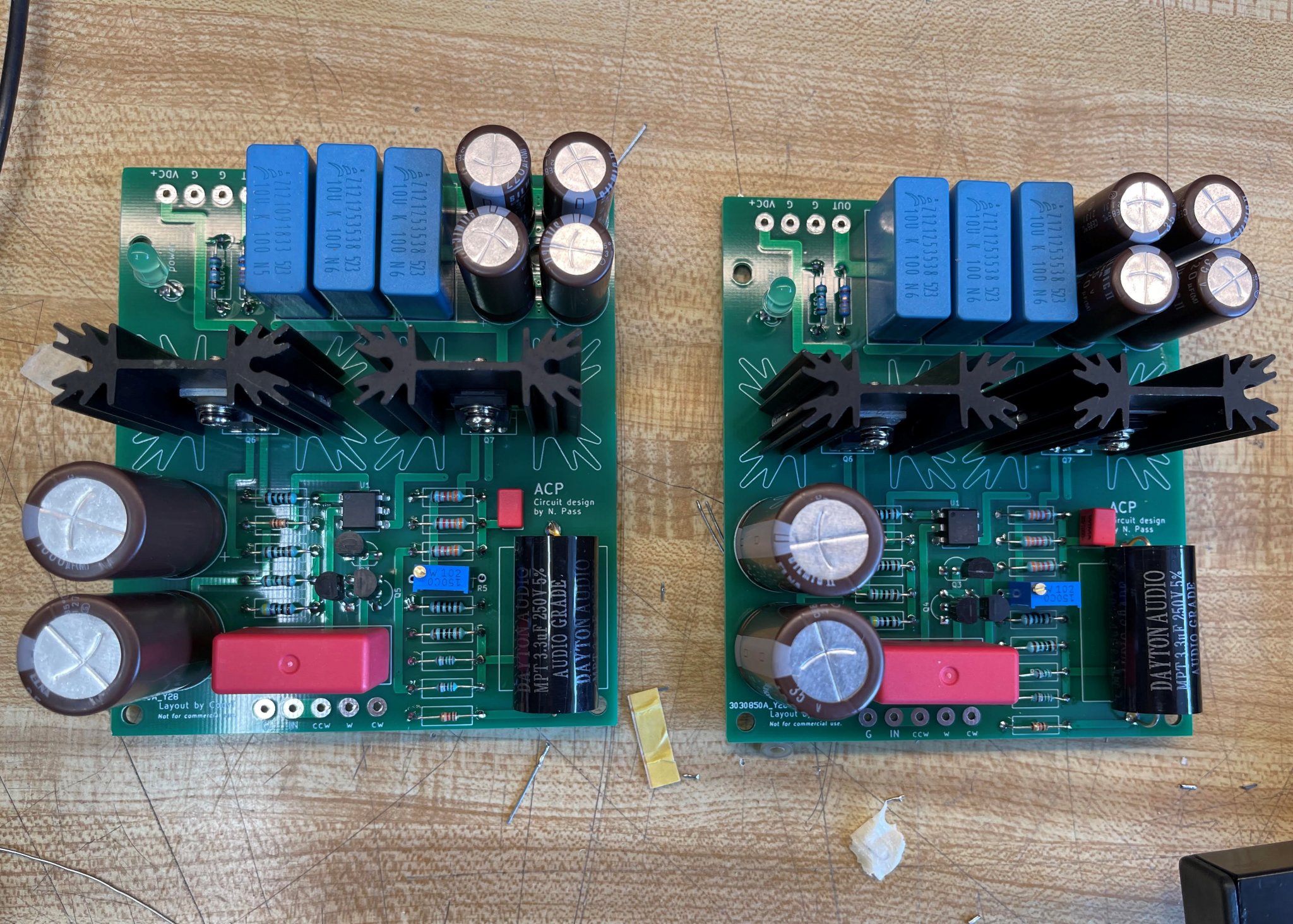

ACP: CAP-TASTIC EDITION
This build has been a bit of a slow burn.
I built Papa's ACP+ at it's Burning Amp introduction. I've used the ACP+ as a headphone amp and as a preamp. It still gets a regular rotation and brings back a fond memory every time it plays.
When Cody T introduced his layout of the ACP+ (post #1901 with gerbers / BOM post #1913, this thread), I had to try it. The Cap Tastic Edition seemed like all of Papa's original design with some added tweaks to push it more into the preamp world. Perfect for a guy who doesn't go to the office or listen to headphones much any more.
I ordered the gerbers and built the boards. Life got in way and everything got put in a box on a shelf. I'd check this thread now and then but no one ever fessed up to following Papa's and Cody T's path. Which is a shame. More of us should try this version of the ACP+.
I've finally got my boards up and running and they sound great. I'm impressed how good it all sounds in front my Vfet amp. It's an easy build and you can still use a +24v SMPS to power both channels. A small box, some RCA jacks, an Alps pot and an SMPS filter are all you need.
I've got it all running on my sloppy preamp test rig. I'll post some better photos once I get it into a permanent home. Until then, I've added a pic of the boards as proof I'm not just making this stuff up.
Disclaimers/Notes-
As always, I blame Pa and Cody T, too!
Disclaimers/Notes-
- I tried to use nice components and I did have a spare pair of 2SK2013 handy. I know, I know.....
- I used 2SJ74's and 2SK170 for the input buffer.
- I found the LED pins +- on the boards were backwards.
- I connected my signal out from the Alps pot to W and the signal out ground to CW. ( I have no idea what CCW, W and CW mean). I'm sure someone will share their wisdom.
- The 1K pot adjusts the voltage into Q7 as measured across R15. Set one probe to ground and the other (+) to the side of R15 closest to the center of the board. Adjust the pot to see half the supply voltage. 24V in, so set to 12v. Easy, right?
