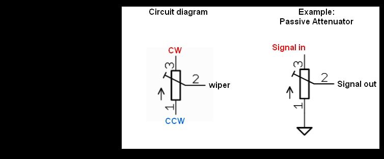

Hello wg45,
cw = clockwise = right turn of the pot
ccw = counterclockwise = left turn of the pot
w = wiper.

As a follow up, why would you need a clockwise and a counterclockwise connection? I can imagine that a volume pot might turn in either direction but why would a specific input be needed?
You want your volume-pot acting from turned completely left= ccw (=silence = high resistance for audio signal / low resistance to ground) to fully turned right = cw (= full volume = low resistance for audio signal from input to wiper out / high resistance from wiper to ground).
You can change that into the opposite direction.
You could also use the trimpot as a variable resistor inline the audio signal without shunting it to ground.
Cheers
Dirk

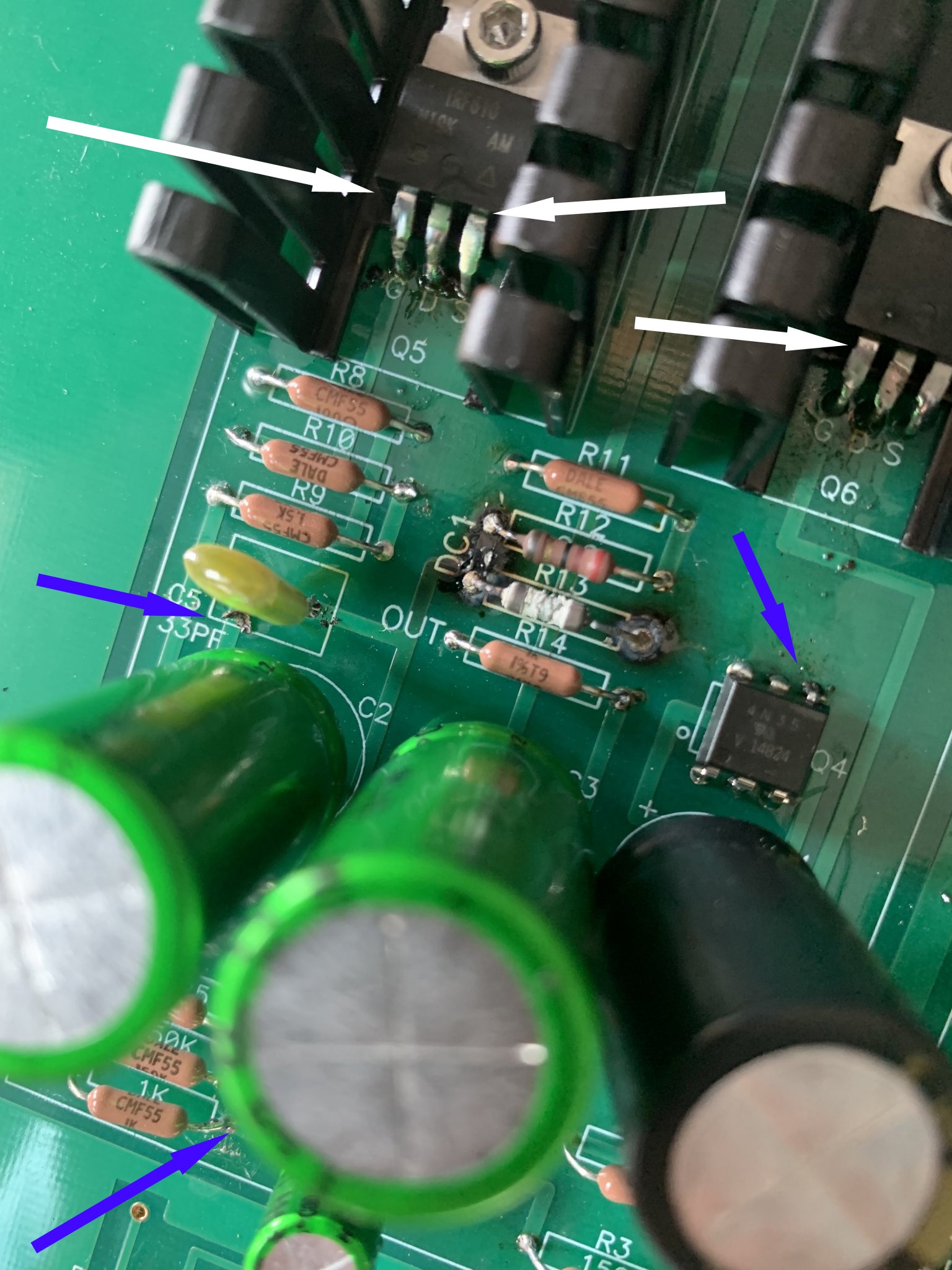

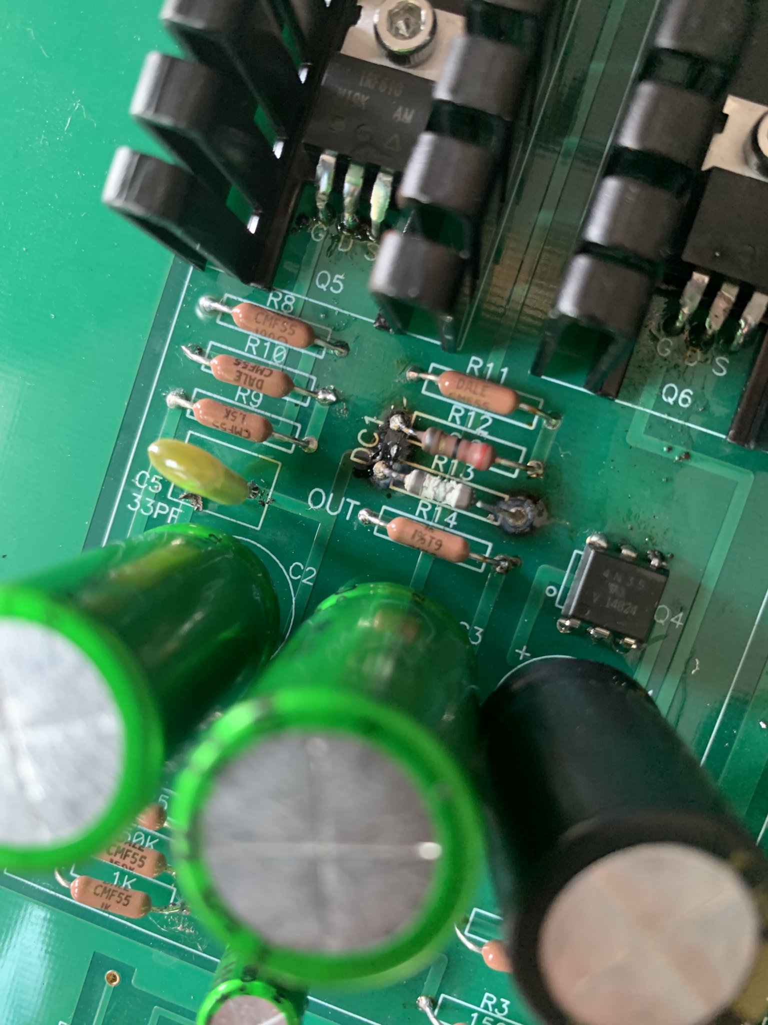

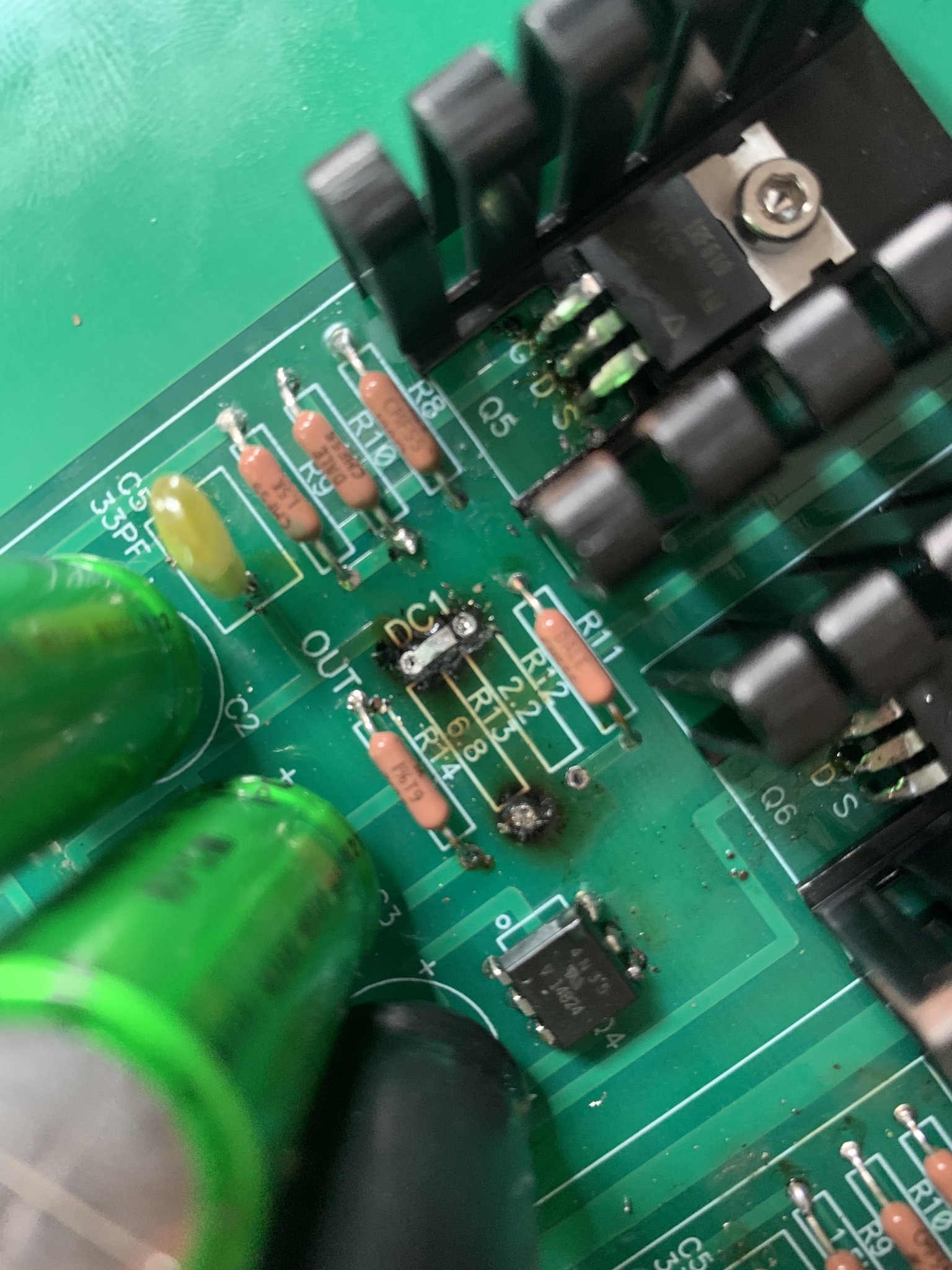

Hey y’all, so this is the first time this has happened to me. I’ve been using this for about a week when suddenly I lost a couple resistors. Still not sure how it happened. I have a couple back ups I’m about to put in, but I wanted to see what the proper procedure is before popping them back in here to ensure there’s no further issues. I’ve got the picture as is after the failure and one showing it cleaned up. At first I thought there was solder that wasn’t getting wicked up but now I think it’s the pcb having gotten removed in that area. Thanks!
What on earth happened to roast those resistors?
Figure out the failure mode before replacing them...

Yeah, I’m trying to figure that out. The voltage matches from the left side of the board to the right side at that node. I’m not quite sure where to proceed from there.What on earth happened to roast those resistors?

I should note that I put in new resistors in that spot to test the voltages with, turning them on and then off as soon as the voltage reading stabilizedYeah, I’m trying to figure that out. The voltage matches from the left side of the board to the right side at that node. I’m not quite sure where to proceed from there.
Well it looks like I’m no longer drawing .3V at R18 but .8V. Maybe there’s a short somewhere.What on earth happened to roast those resistors?

Too much current, so toasted resistors.
R9, R11, Q4, and Q5 set the current, so those need checking.

I checked R9 and R10 and they were fine. I’m not really sure how to check Q4 or Q5Too much current, so toasted resistors.

I see microfractures... check the white arrows. Always mount the transistors on the heatsink & tighten them first, and then solder them.

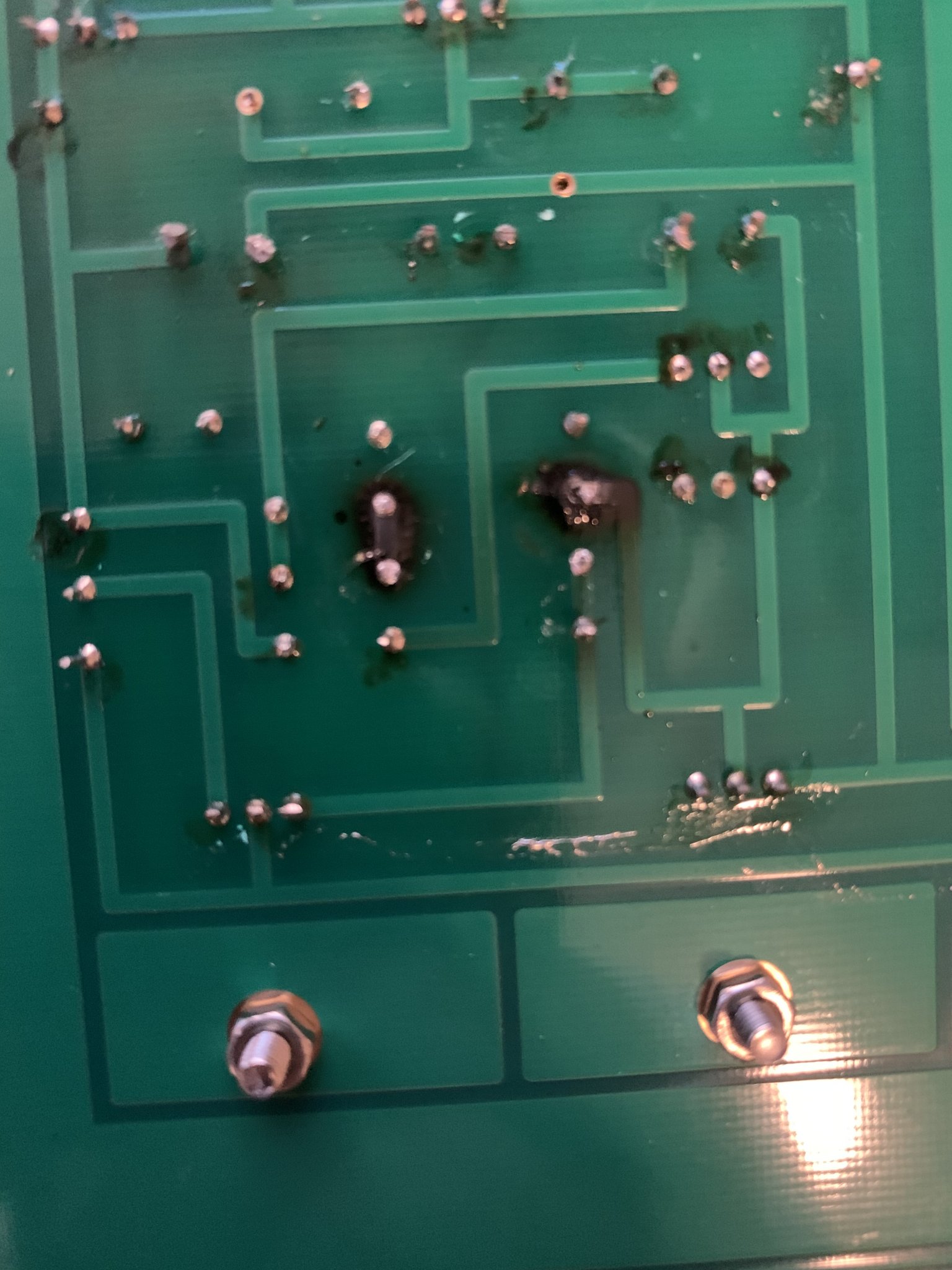

Also, a lot of solder leftovers - blue arrows... dare to show us the underside?

Thanks for the feedback, sure!

i think you need a lot of practice soldering components to a PCB - a lot of potential dry joints, a lot of too much solder on the pads or not enough. plus some of the comp legs are not trimmed properly
not sure what equipment you use but you need a temp controlled soldering station with a number of different size tips
ideally your tip temp should be 300 - 350 C but you need to learn to select the right size tip for the pads and components because the trick is to solder in the quickest possible way at the right temp, so for example for a thicker pad or comp leg you need a larger tip and so on.
i personally use a kind of universal chisel tip @350C for almost all of my work but i have 30 odd years of experience plus being trained to do military grade soldering.
so in short practice makes a big difference and the right tools help make the entire work easier.
as a final note - do not use lead free solder, it has compelety different requirements, 60/40 tin lead or 60/35/5 tin lead copper is all you need
