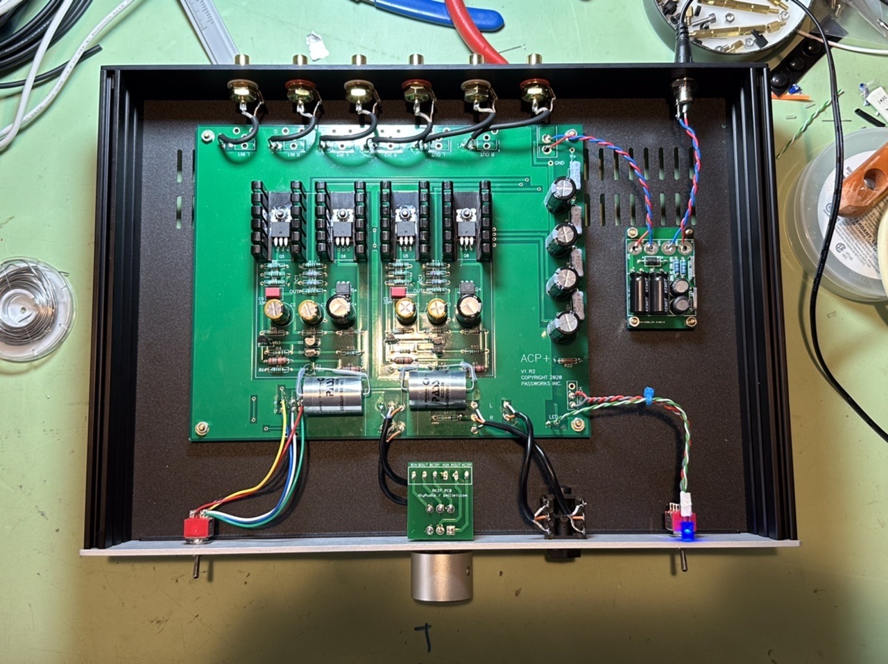

Built up an ACP+ in a chassis. HiFi2000/Modushop Galaxy 330x230 1U. This is a very nice size to work in. Yes, it will fit in smaller, but I like a little room and I quite like this form factor.

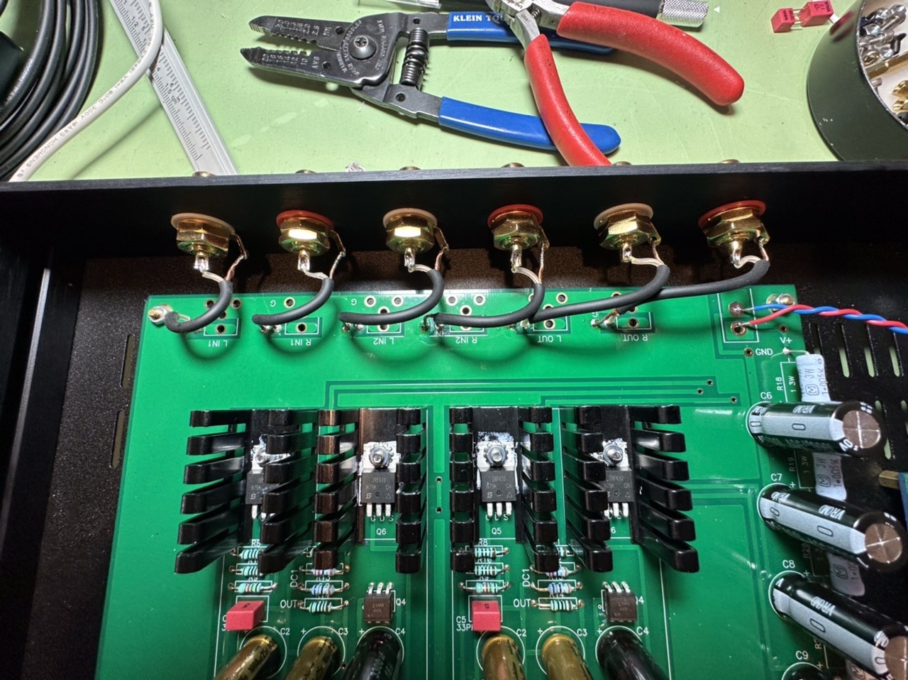

Hard-wired the P089ZB filter. Needed a couple of panel mount switches. DPDT On-On for select, and although I used the same for power, you only need SPST On-Off.

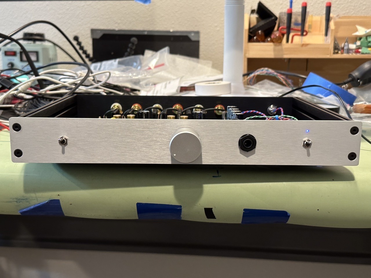

All the holes could be made with a hand drill, this is a very simple project. (Although an inexpensive pillar drill/drill press is worth every penny for this kind of work.)

Great job of banishing SMPS noise and high frequency crud. LCLC filter on outrigger board, followed by RCRC filter on ACP+ main board, is extremely powerful medicine. A pleasant way to achieve Noise Be Gone.

I'm assuming the big chonkers are just 10uf film caps to sub for the stock electrolytics?
I recently acquired a hobbyist Bosch bench drill, and so I was considering this in the little 230x170 Galaxy, although looking at yours I'm seeing the benefit of going big (i.e. getting the sockets and pot off the boards means I don't have to be 100% accurate with my drilling, and also means there's no stress on the board, AND I can fit filtering in).
I built the ACP+ similar to 6L6 and used the SMPS filter board from the store. This is currently my favorite headphone amp and works really really well for my desktop audio system feeding the ACA. I have a WAMMY also which is more portable, I can take it to work with me in a backpack. But I like the ACP+ just a little bit better for headphone listening.
@twofires The input film caps are actually 2.2uF, that's more than enough to get the cap time constant low enough. The stock 10uF was chosen because Nelson had a bajillion Silmic caps available to use, and they have a very compact footprint.

Ah, nice. Are the film caps any particular kind of fancy? I like fancy but I'm on more of a Dayton sort of budget.
