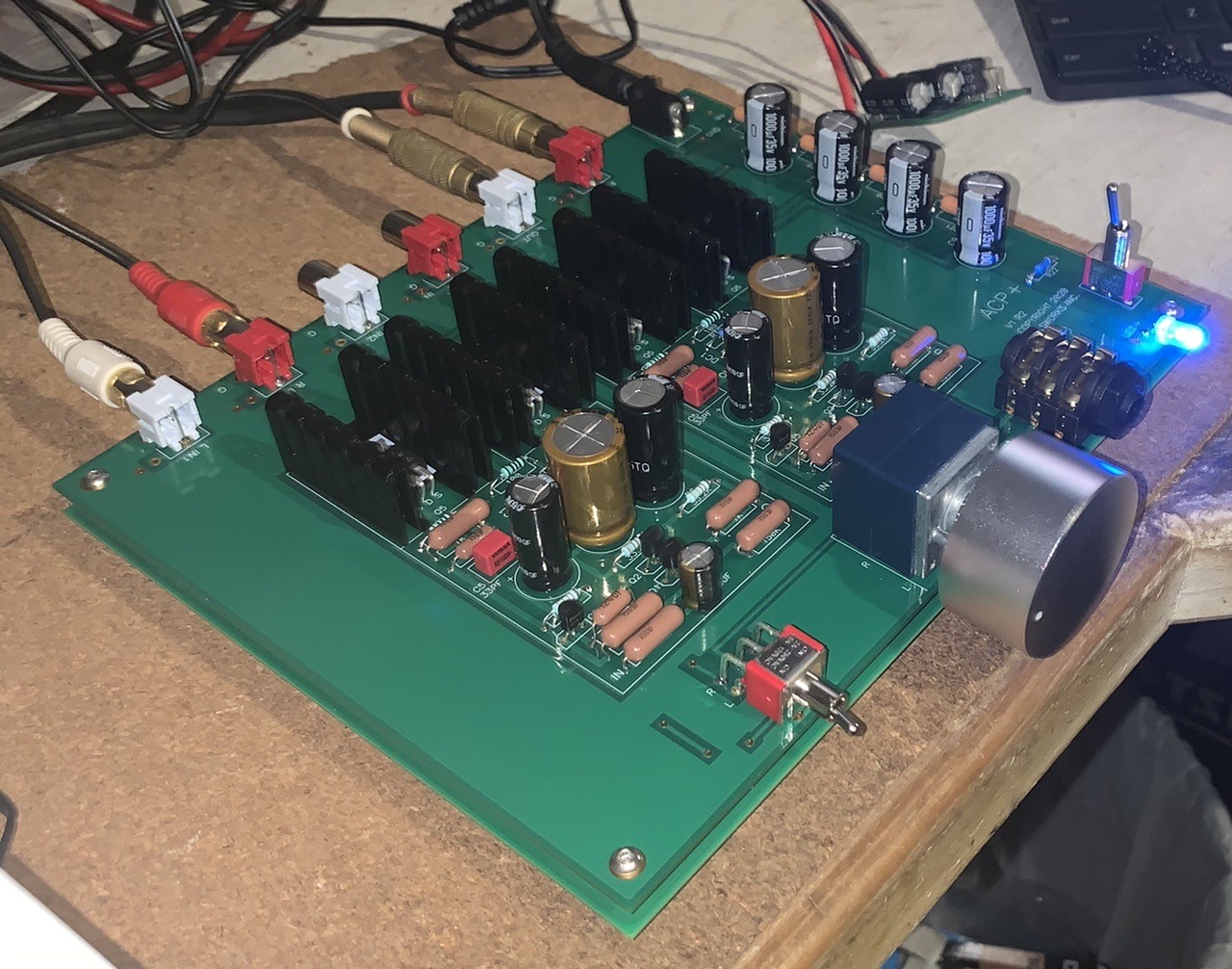

Another store kit build. What can I say? Another musical treat from The Wizard - thank you. Again. And please ignore any low frequency vibrations you may pick up along the lines of ‘It’s 2am!! Are you STILL listening to That Thing?!! (on the plus side, she also thinks it belongs in the MOMA - score one for you, Papa).
Thanks, too, to Tom and all at the Store for their help. Like that chunky 40mm knob, Tom.

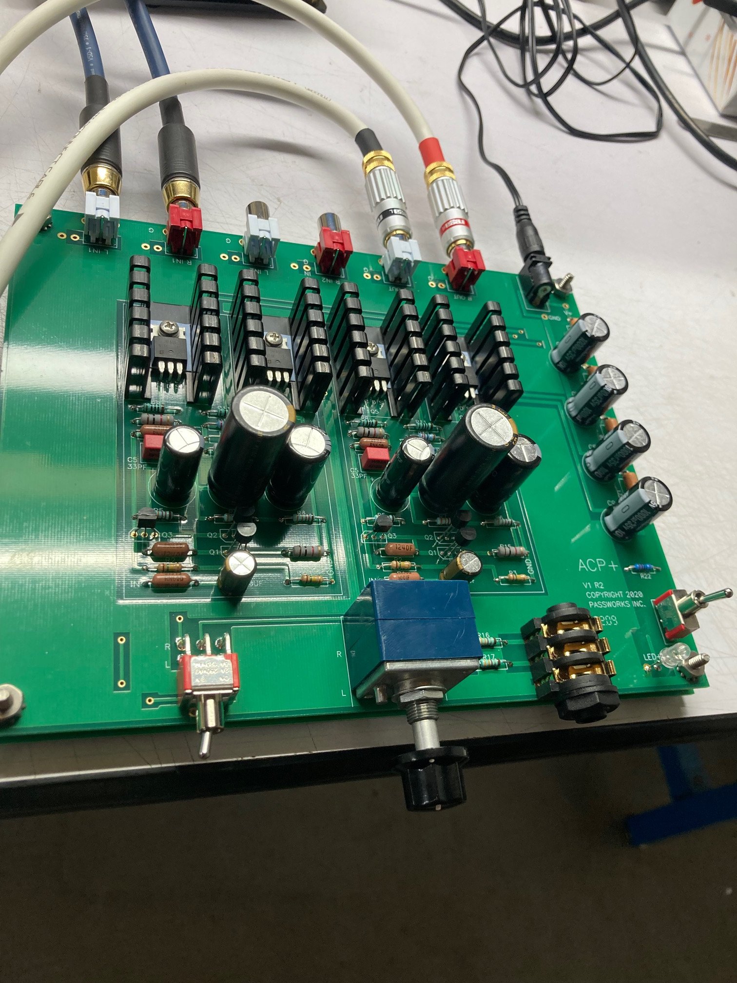

Yet another store kit build to share. I made some minor substitutions, mostly because I had the parts- 10k volume pot with a different knob, a power switch without threading, smol footprint resistors for the RN65's. I also had to provide a pair of 1000uF caps to complete the build, the ones I had are too big for their footprint but they're Muse and fine for now. Also using the same wall wart that came with my B1 Korg, and was used for a B1 buffer. I love repurposing.
This thing sounds amazing, with or without headphones, and it has the voltage gain needed to bring out the best in ZM's Redneck DEFiSIT. Thanks so much to Papa for the gift of this design and the unobtainium actives, and to all the volunteers at the diyaudio store who make this kit available at all, much less for the bargain it is.

Both builds look very nice.... The parts layout on the ACP+ PCB looks very pleasing visually. Elegant with a good dose of symmetry comes to mind...
Glad it worked out. Putting these things is a ton of work, but its a means to a super cool end as you are finding listening to the ACP+. I am glad you all are enjoying the new knob. The last run's knobs were a little disappointing, so we decided to go big (literally) this time! 🙂Another store kit build. What can I say? Another musical treat from The Wizard - thank you. Again. And please ignore any low frequency vibrations you may pick up along the lines of ‘It’s 2am!! Are you STILL listening to That Thing?!! (on the plus side, she also thinks it belongs in the MOMA - score one for you, Papa).

Indeed. The RN resistors were a challenge to find like the Pani 3W resistors. For one of the R values we ended up using a larger wattage value because thats all that was available, hence a slightly more snug fit.I'm never impressed when I see part bigger than footprint on pcb

Yea, as I said earlier that is all I could find in that value in that series. These are really well testing and performing Rs so we wanted to stick with them.Thanks, Cody. The RN65s came with the Store kit, not my choice.
While on this topic, I wanted to address that topic as I've received a few questions on these from folks that recently got the kit. The smaller wattage versions of those Dale/Vishay RN resistors was out of stock everywhere, so we chose to go with the same value with the next bump in wattage. We went with the RNs because these are some of the best measuring (and sounding) Rs out there. So while the fit might be a snug, rest assured that they fit the thru-holes and slots just with a little more persuasion but will work. You may need to linger on them a little longer with your soldering iron as they are in 2W bodies and can take some more heat.Nice, clean build! I like that you went all in on the RN65's. Go big or go home! 🙂
