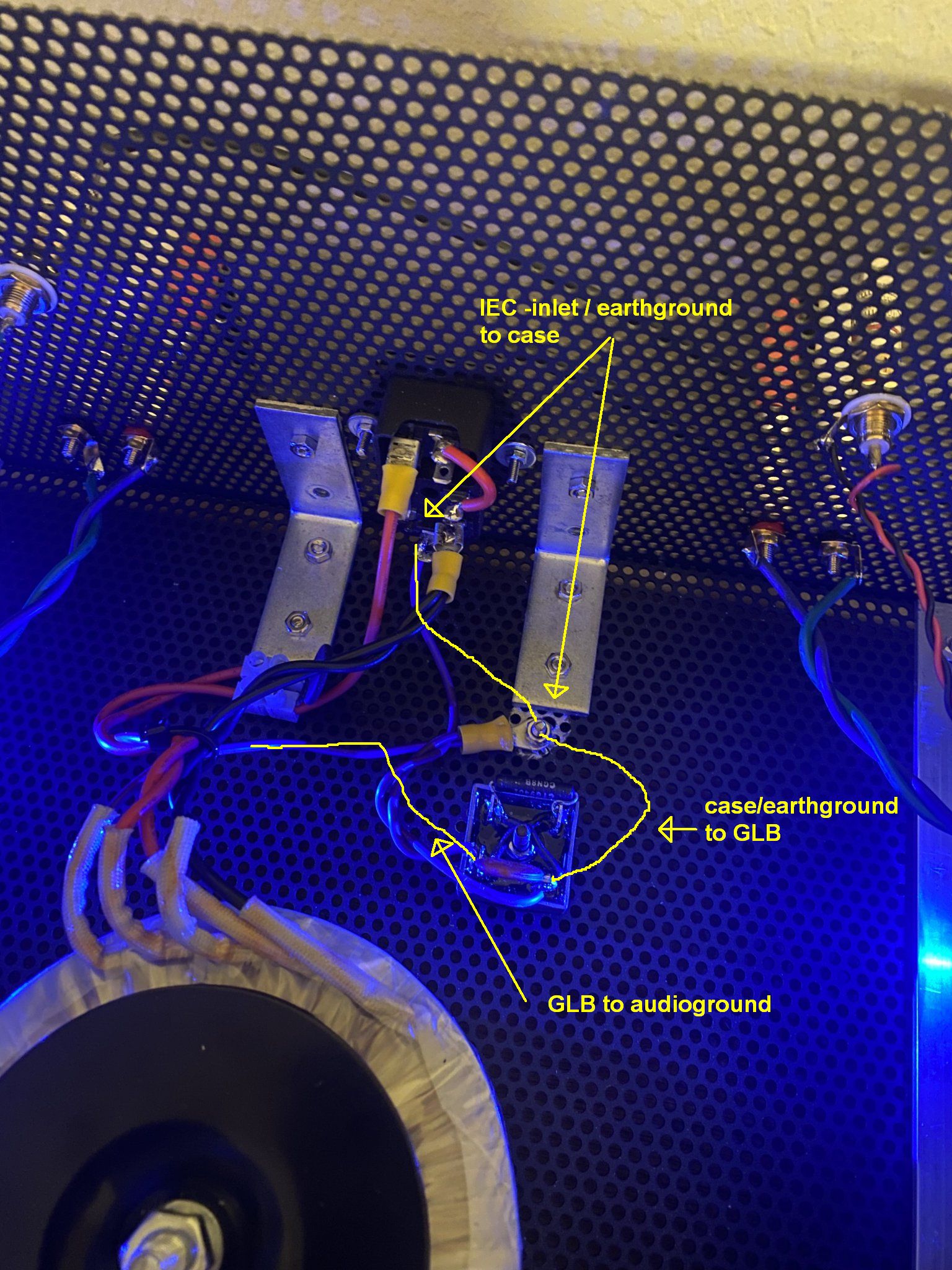

Hello Dneu2011,
I was perhaps a little bit fast with my assessment?
But I add a pic how your groundloopbreaker should be connected.

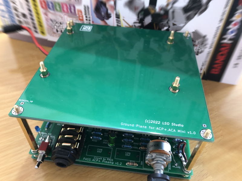

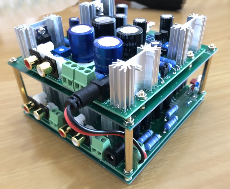

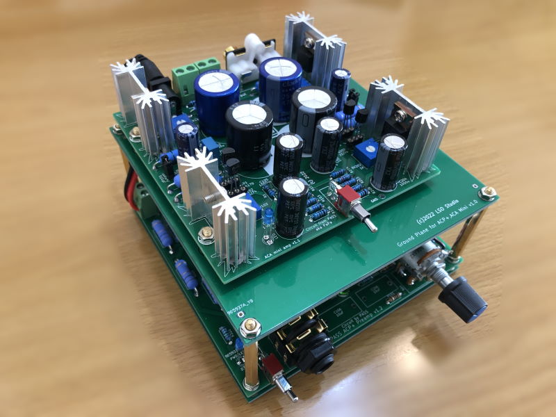

I have done a new PCB layout with smaller form factor (12cm x 12cm), the layout is heavily refer to the original. The power switch is a real power switch and phone jack acts as switch to pre-amp and phone-amp mode. The sound fit my preferences and thanks for PaPa to share this great phone amp.
Ground plane is used for bare-amp and also used to stack up with the ACAmini.
The ACP+ board also have a +24V output to share the power supply for the ACA mini.
So, a whole system is setup for phone amp, pre-amp, and power amplifier. Can enjoy the music with headphone or speakers.

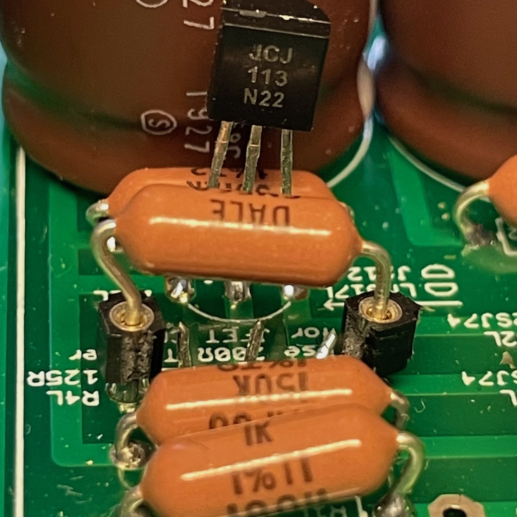

Thanks Tom. I ought to have waited for the full kit to come online, but I was impatient. Not very cost effective to make another shipment to the UK just for parts, so I will cobble them together from UK suppliers.
Actually I’ve made a start and it’s not quite so arduous as I’d imagined. I’ve gone for Vishay 1% resistors and Silmic / Nicichon caps. I’ll get some extra resistors to test the J113s as per the guidance earlier in this thread.
Am I correct in thinking the 610 Mosfets don’t need to be matched?

610: no need to match.
113’s: Good to have a bunch. RS has them.
JFETs: good, 6-8mA preferred.
regarding 113’s, be sure to confirm pinout as there are multiple suppliers who seem to make a habit out of inverting the legs on these.

That is correct. The MOSFETs do not need matching; just the JFETs (and resistor with the matching J113). Nelson has described how to do the matching of the resistor to j113, and I posted an article earlier in the thread but reach out if you can't figure out how its done.

Any of the J113 can be used. However it is convenient to use the same value of R4 for both channels so select the closest matching pair of J113, in this case the two in the middle.
The resistor needs to be selected for 10mA of current through the J113. Use Ohm's Law to calculate the current:
I = V/R, therefore I = 1.695V/100 Ohm = 0.017A = 17 mA
I used the average Voltage drop so one J113 will have slightly higher actual current and the other slightly lower actually current, but close enough.
The 17mA is higher than 10mA. If the current is too high, increase the value of R4. If the current is too low, decrease the value of R4. So in your case R4 needs to be increased. This will be a case of increase R4, then measure the voltage drop, and recalculate. Then adjust R4 further if necessary.
Since you are quite a ways off, try something closer to 150 Ohm to start.
