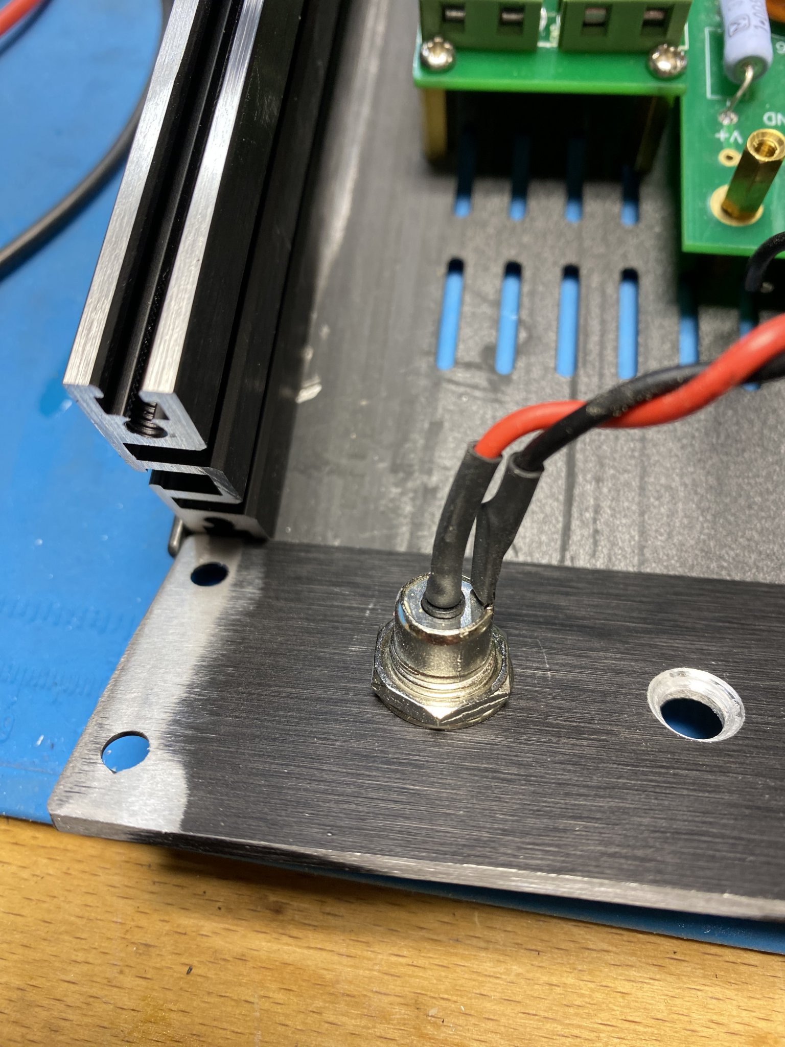

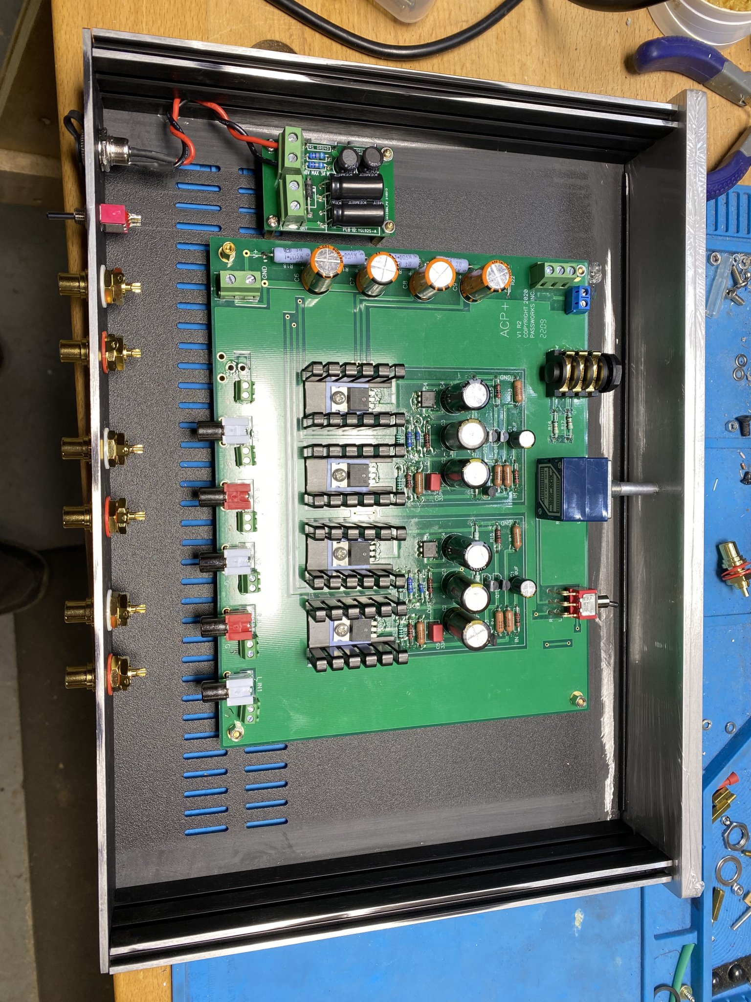

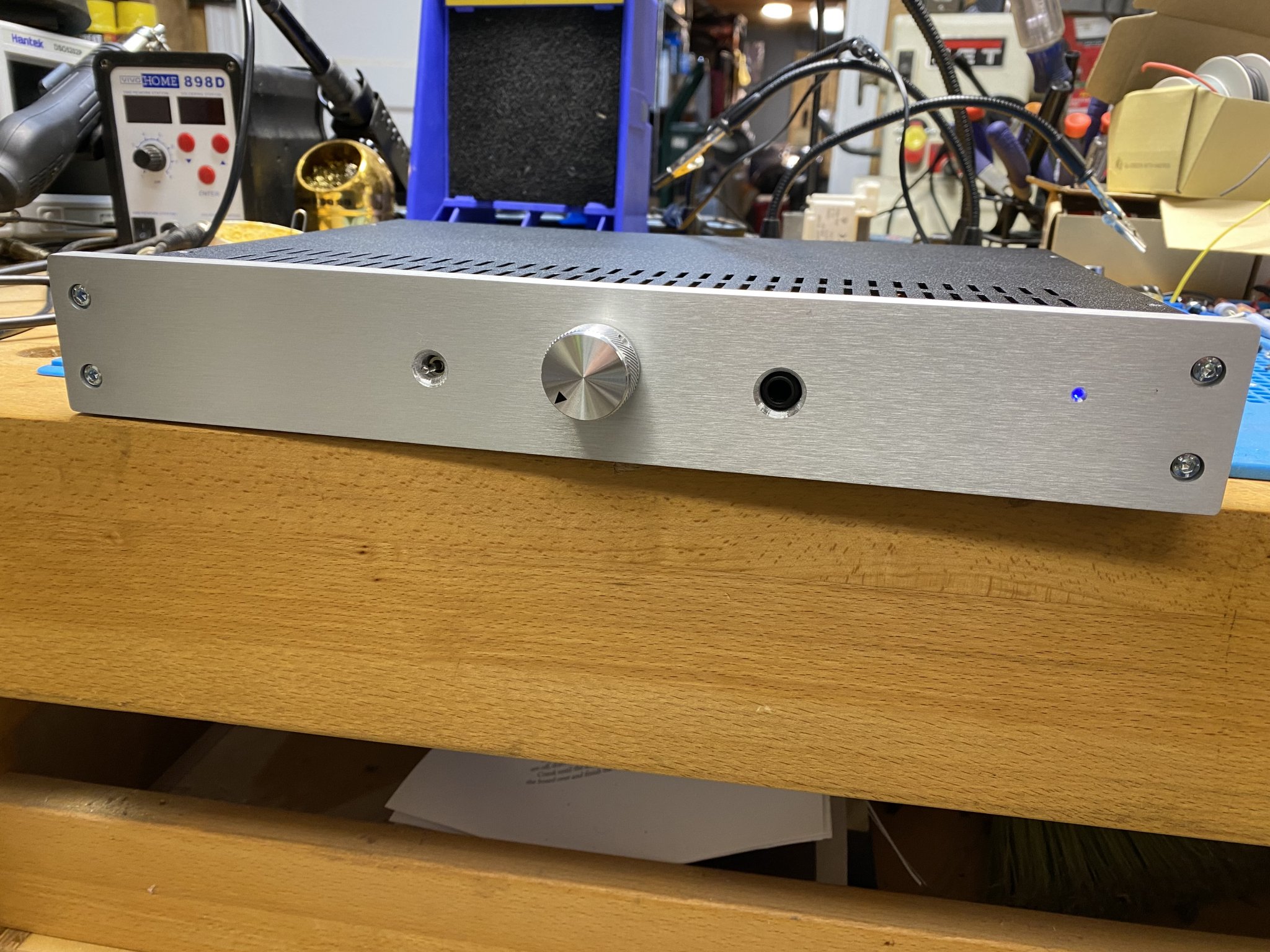

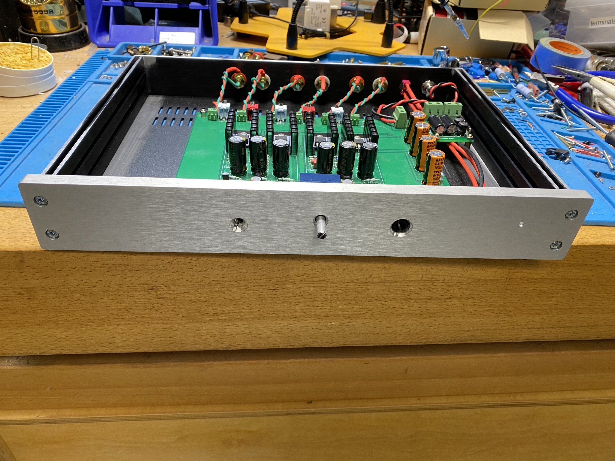

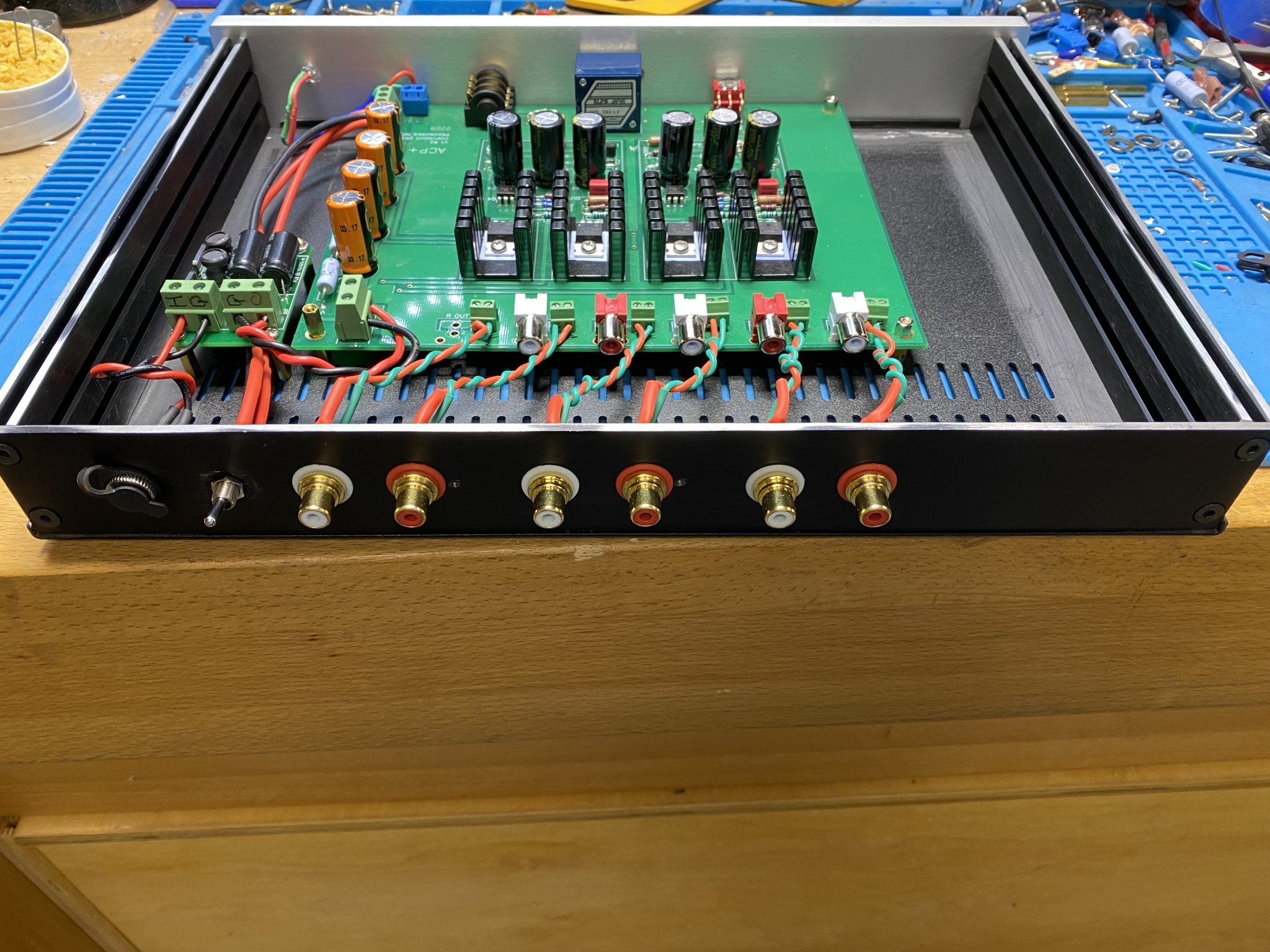

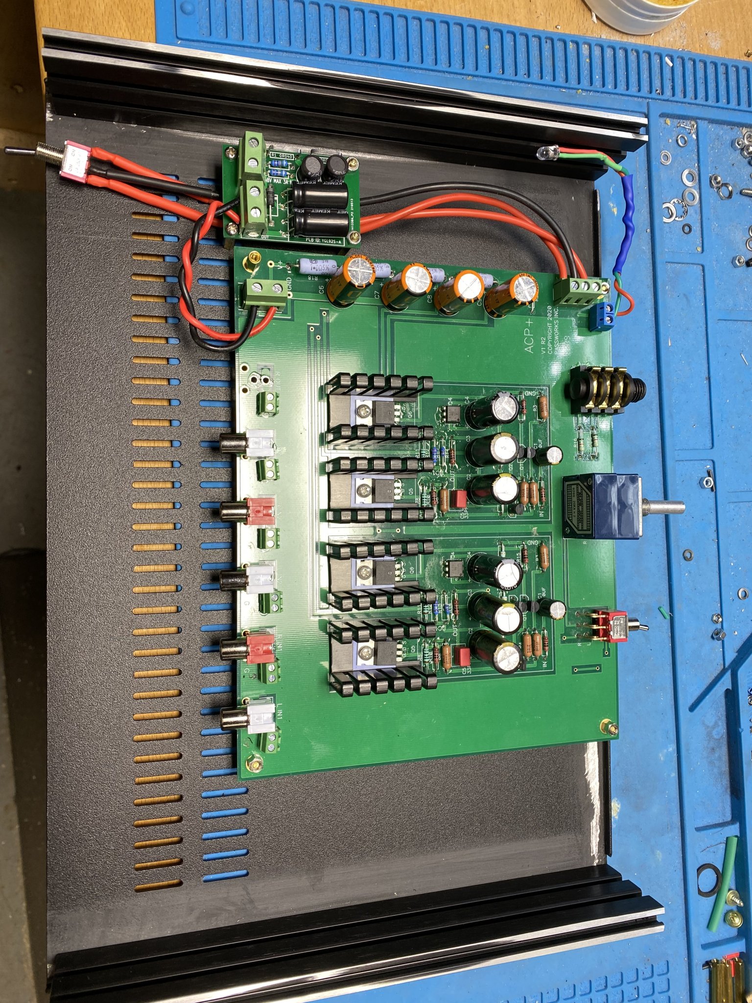

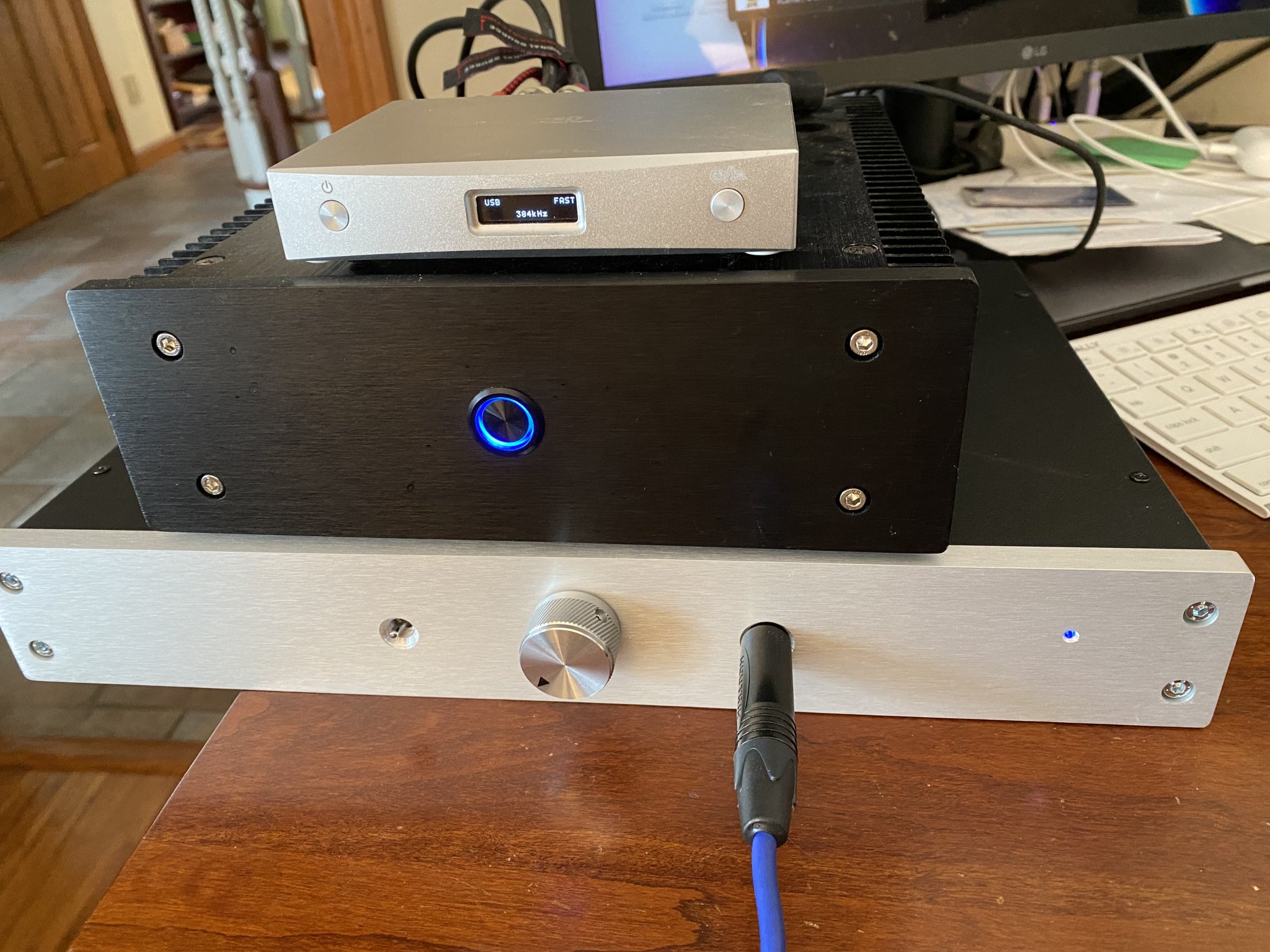

After Gary had taken a couple of months to listen to his ACP+ he decided he really liked it but wanted it in a more lets say, less accident-prone form factor for his daily desk, so he went ahead and purchased the same chassis 6L6 used. Last weekend I helped him fabricate the chassis and stuff the ACP+ in there. Like Jim's build, I also included an SMPS DC Filter kit (p089zb) on the DC power inlet. I can report that the build was very straight-forward. I (re)discovered that Nelson left 2 extra +/- holes next to each RCA, so for all of the I/O (the RCAs) there is no need to remove them from the board to solder in fly wires; just connect those and leave the board-mounted ones as-is. If you look, I used euro blocks/phenix connectors to make connecting things easier but also easier to remote/experiment with in the future. As you can see, I mounted the board with all of its board-mounted front panel components right to the front panel except for the LED which I used a fly wire to mount elsewhere. We mounted the power switch off board on the rear panel of the chassis again via fly wires.
I've had it sitting on my desk all day listening to it on my AKG712pros and its really fantastic. Quiet as can be with loads of dynamics and detail as we've come to expect from Nelson's awesome creations.
Enjoy!

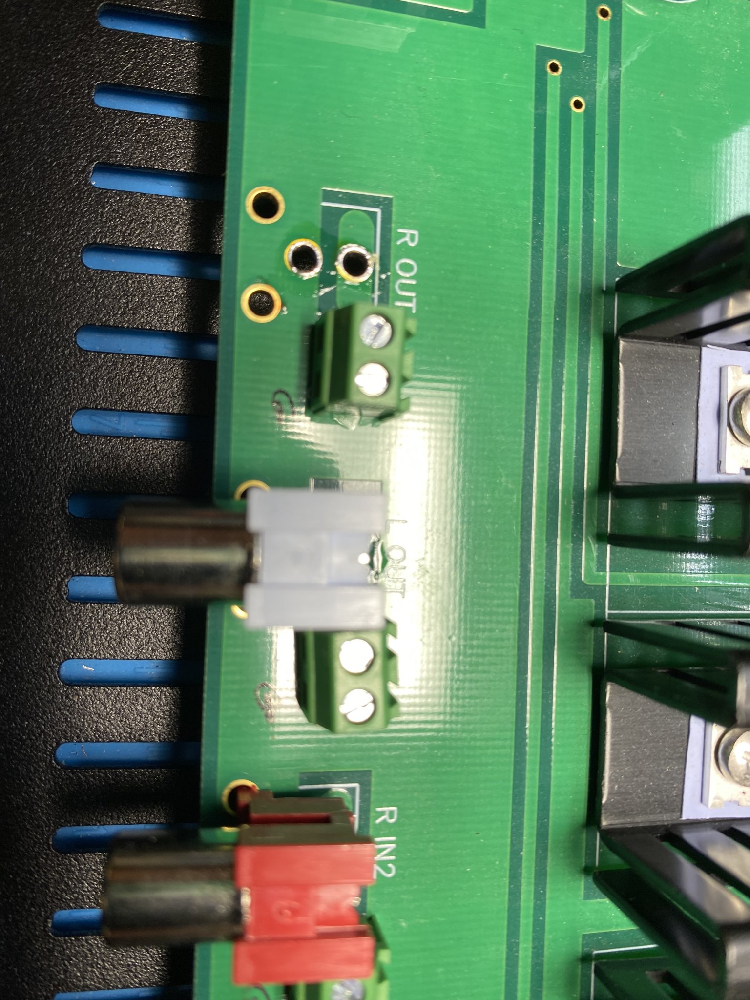

Exactly. Do yourself a favor and don't board-mount any of the I/O or controls. On the built i showed, @g262isaud and I had built the ACP+ in its "stock" setup he used it that way for a few months until wanting to put it into a case, and in that case it is far easier to leave at least the front panel-mounted components as is and mount them thru the front panel.
But if i were to start from scratch, I would probably leave them off because its just less constrained to be able to mount them wherever on the front panel versus exactly where they have to be due to board mounting. Also for newbies or folks that want to experiment, I also recommend use of euroblocks anyways as that allows for easy insert/removal of the entire board, parts swaps or general fat fingering which I am guilty of too many times. like on this build I first swapped the + and - on the rear RCAs and had to fix that. Because I had euroblocks on the board, I just unscrewed the blocks, flipped the wires and put them back. No fuss, no muss. 😉

Ah good point. As you can see I mounted the DPDT switch on the PCB and thru the front panel but its not attached to the front panel with a nut because its not that type. Same with the volume pot and headphone jack. These are all actually mounted to the PCB which is standoff-mounted to the bottom of the case. Think ahead or prepare to drill many times. 😉Don’t connect the jacks, switch, or pot to the PCB. This way you’ll be able to mount them exactly where you want on the chassis. You may need a different DPDT switch that is panel mount.
