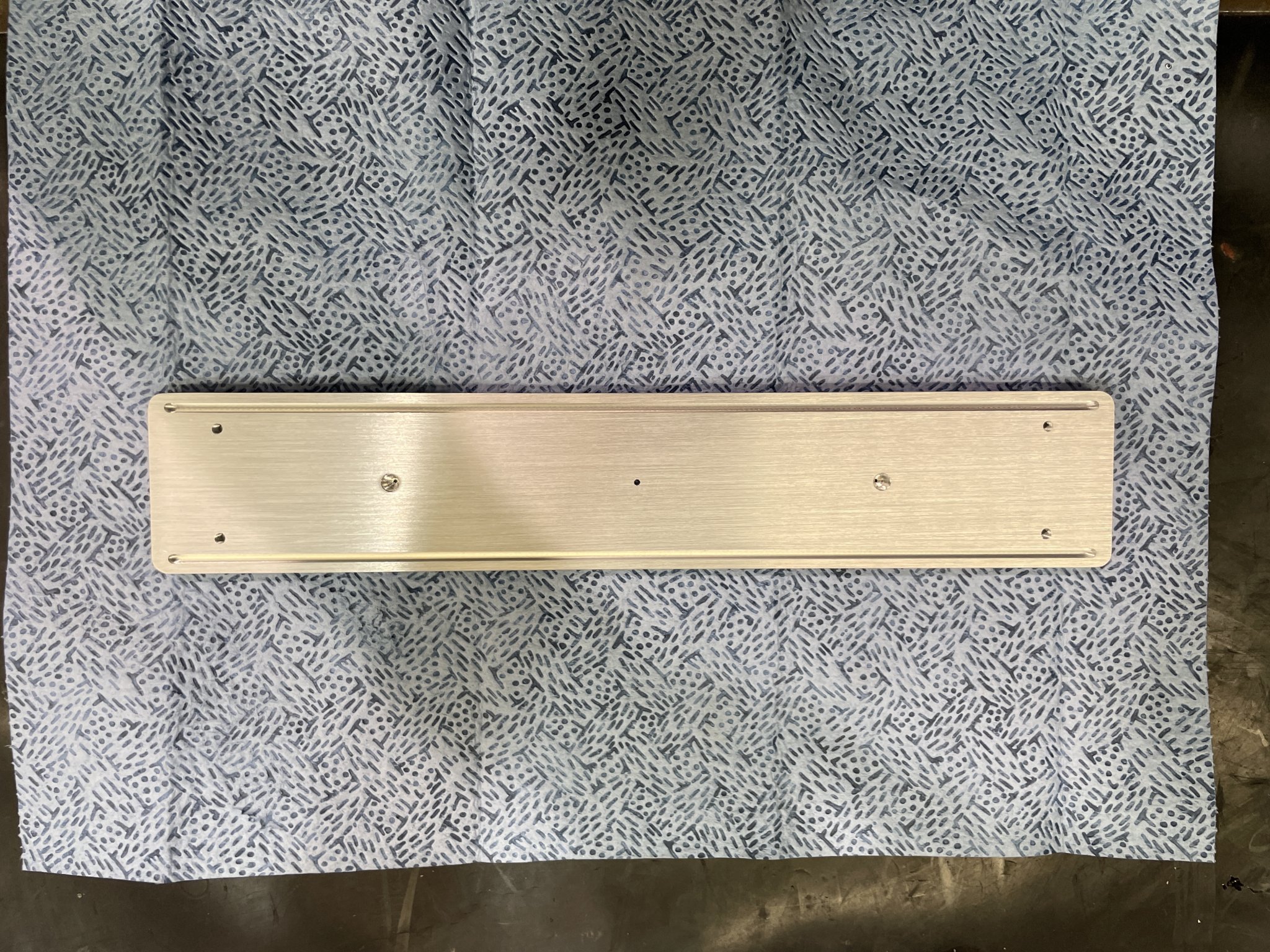

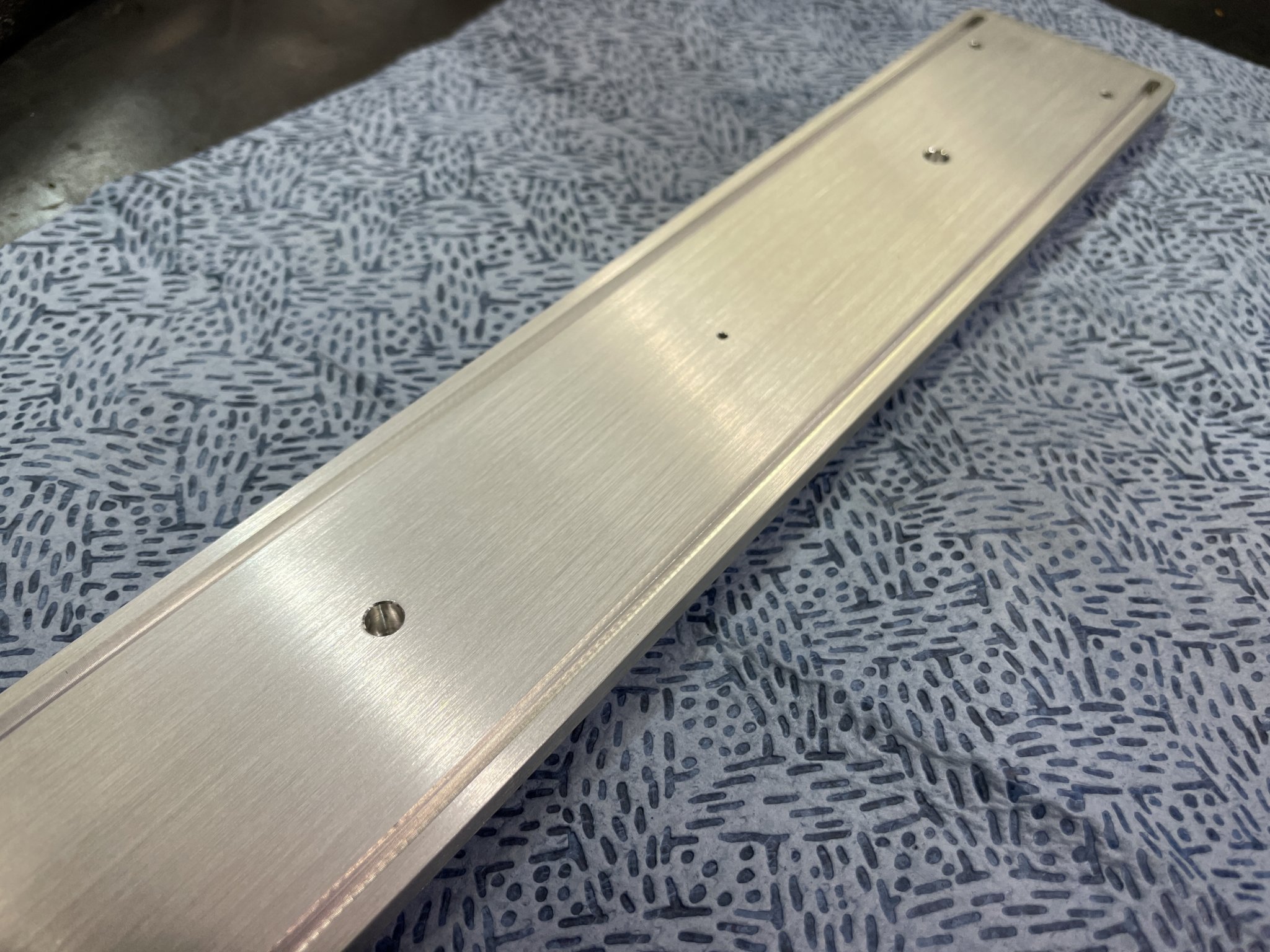

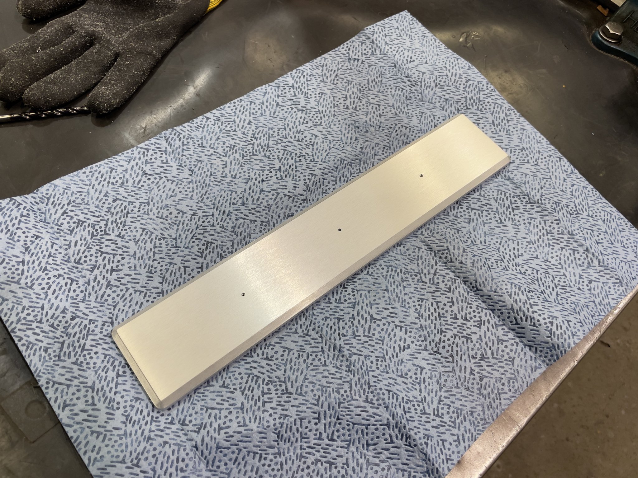

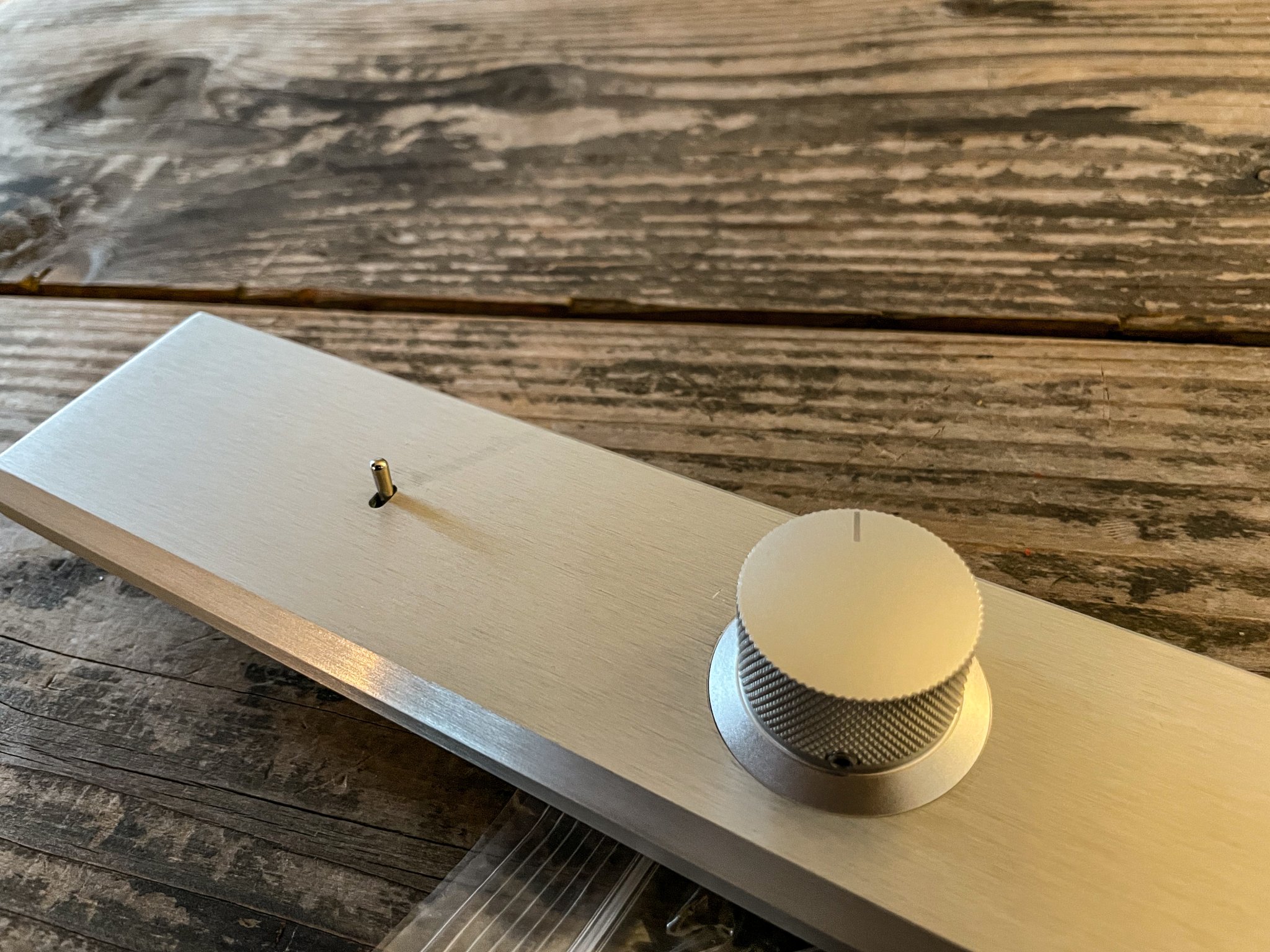

Started on the front panel. First drilled 3 holes for the locations of the 2 switches and the volume knob, then drilled out the switch holes to tap the holes with a 1/4 40 tap. I want to mount them from the inside of the chassis, and make 2 vertical sleeves on the front for the switches. That will be for next week when I find some time

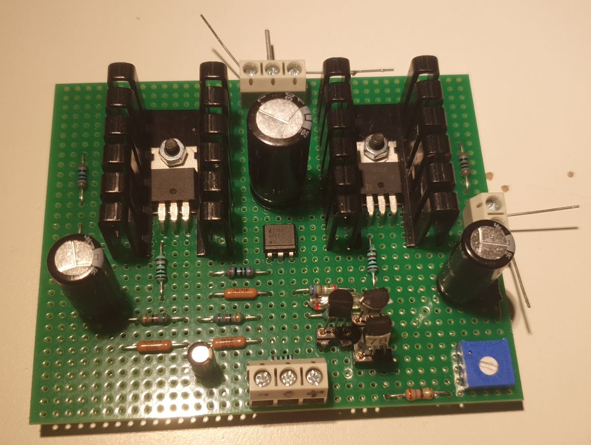

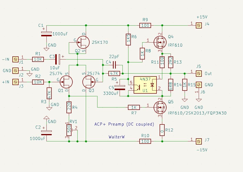

The schematic I made, is a mix of the BA1 frontend, the J2 and this ACP+.
I made on experimental board first the original version and rebuild it to the schematic below, all works fine, output offset of the original was from 40mV to zero in few minutes, this version is from 10mv to zero in a few minutes. Maybe I'll experiment with a simple servo to keep it at 0 volts at the output.
JFET's are 10.0mA 2SK170BL and two perfectly matched 2SJ74BL's of 8.3mA. I will be playing with the 3 specified output transistors. And maybe degeneration of them, that's why I put in the 0 Ohm resistor.

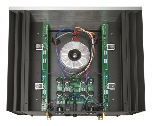

Gate Stopper on Mosfet2?
I am thinking of creating my own mono APC+ boards as has WalterW in the above comment. But I have a question of why Mosfet2 on the ACP+ article by Nelson has no gate stopper resistor. Based on experience with Mosfet output power amplifiers, such as the various Zens, F4, F5, and BA 1, 2, and 3, the output Mosfets have gate stopper resistors in the range of 100 to 221 ohms to control oscillation.
There appears, in fact, to be a fairly stout gate resistor on Mosfet1 of the ACP+ of 1K ohms, but nothing on Mosfet2. Nelson says that the APC+ “resembles a miniature version of the First Watt J2 amplifier.” If I’m not mistaken, from the picture of the J2 boards below, they appear to have gate stoppers. I also note that in WalterW’s schematic in the prior comment, a gate stopper on Mosfet2 which is symmetrical with the 1k ohm on Mosfet1.
I would appreciate input on this before I finish laying out my mono boards.
Put the resistor into your PCB layout while you wait for Nelson Pass to answer your question "Is This A Design Error?".
Then when you build the boards you can either populate that resistor position with a 1Kohm resistor, or with a jumper wire, whichever makes you most comfortable at the time.

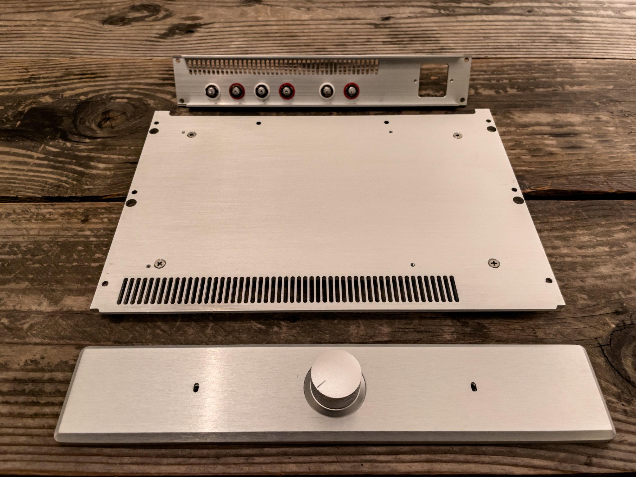

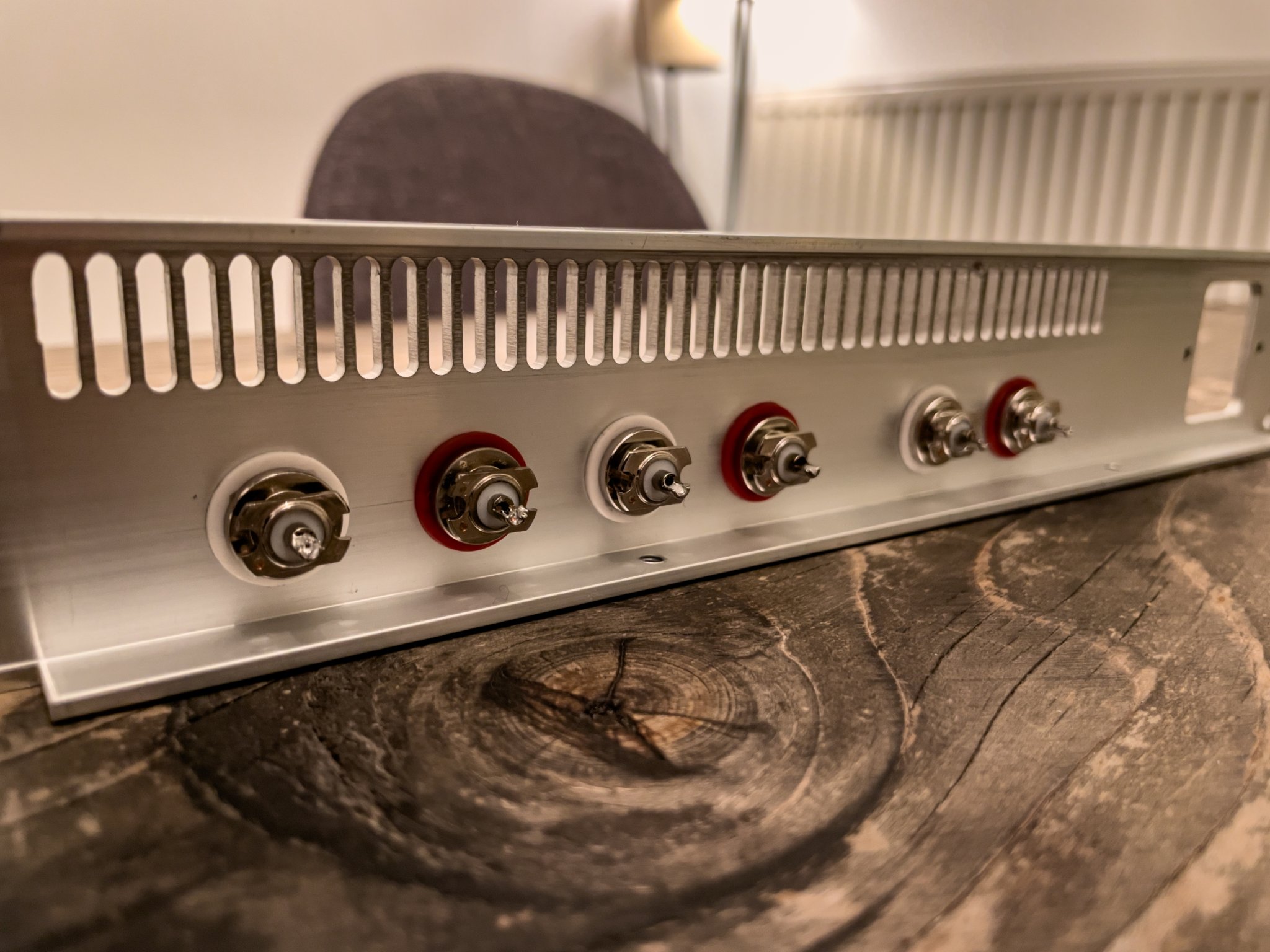

I finally got my chassis parts back from the metal workshop at my work, they did a good job, except for nicking the front plate a little bit near the volume knob. still happy with the the result.

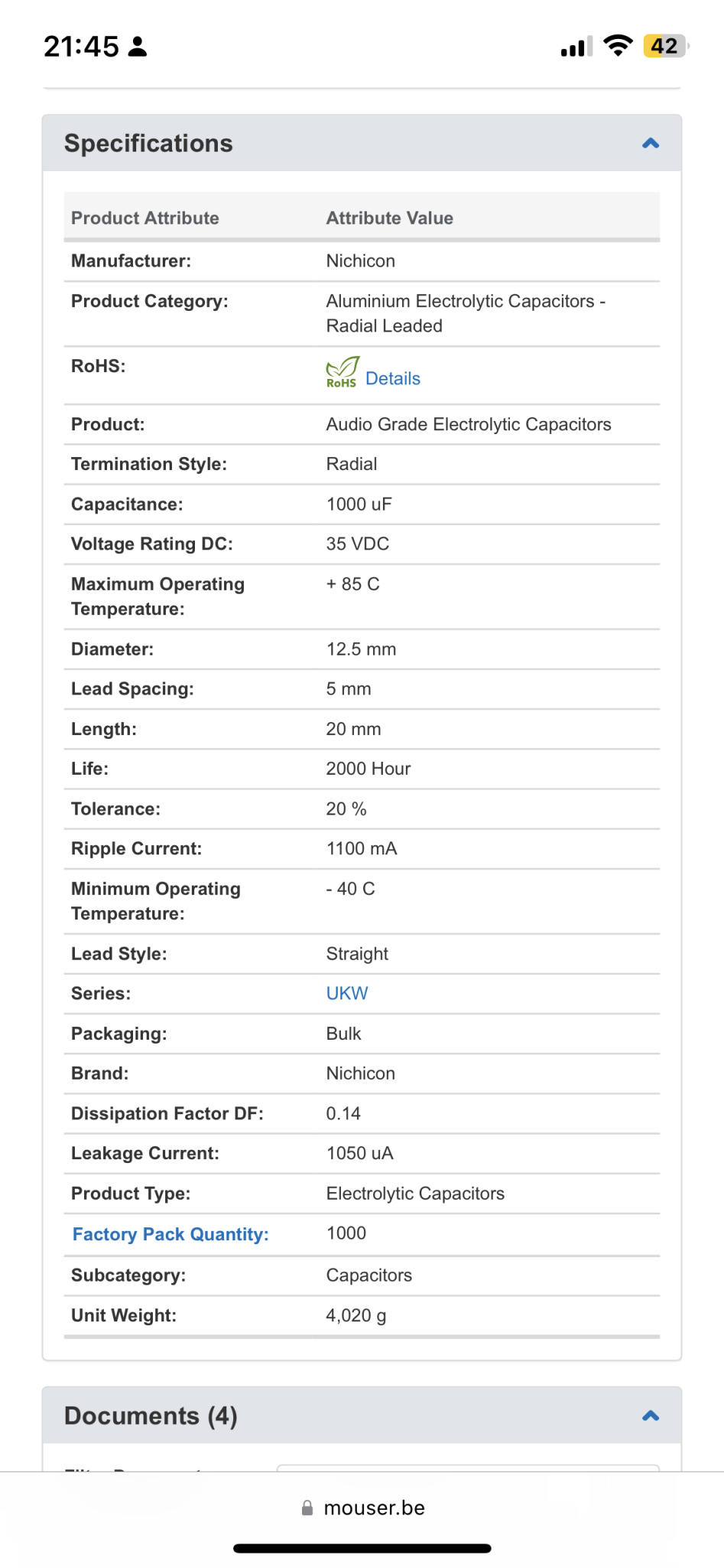

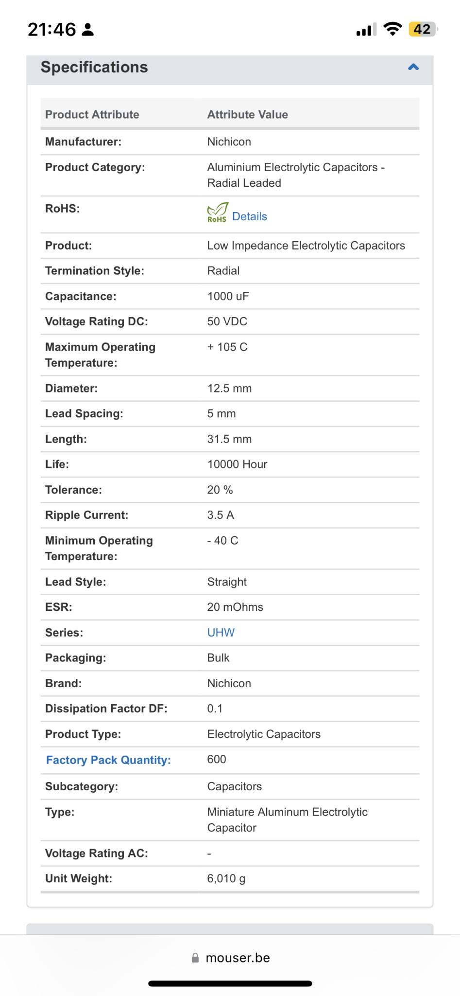

I will try to finish the build this weekend, but before I do that, the conversation above got my thinking about the filter caps on this pre amp. The R-C filter will benefit from a good quality cap, with, I assume, a low esr, high ripple value. The caps that are on the board now are 1000uF 35v UKW.
Specs are:
I ordered 4 UHW caps but decided to use the above caps, cause I saw a lot of builds with audio grade caps in this position.
The UHW specs are:
On paper these are much better, should I try these ones in the power supply? Or is there any benefit using audio grade caps?
I read that C8 and C9 provide local decoupling between channels, will the UKW provide any benefits? Or still better use the UHW with better ripple rating, lower ESR and DF?

In the Passlabs pre-amps I see they are using Panasonic FC capacitors and Elna Silmic II a lot, maybe have a look at those?
I think after your rectifier bridge, low ESR and max. ripple current are most important. For instance the good old Panasonic TS-HA.
