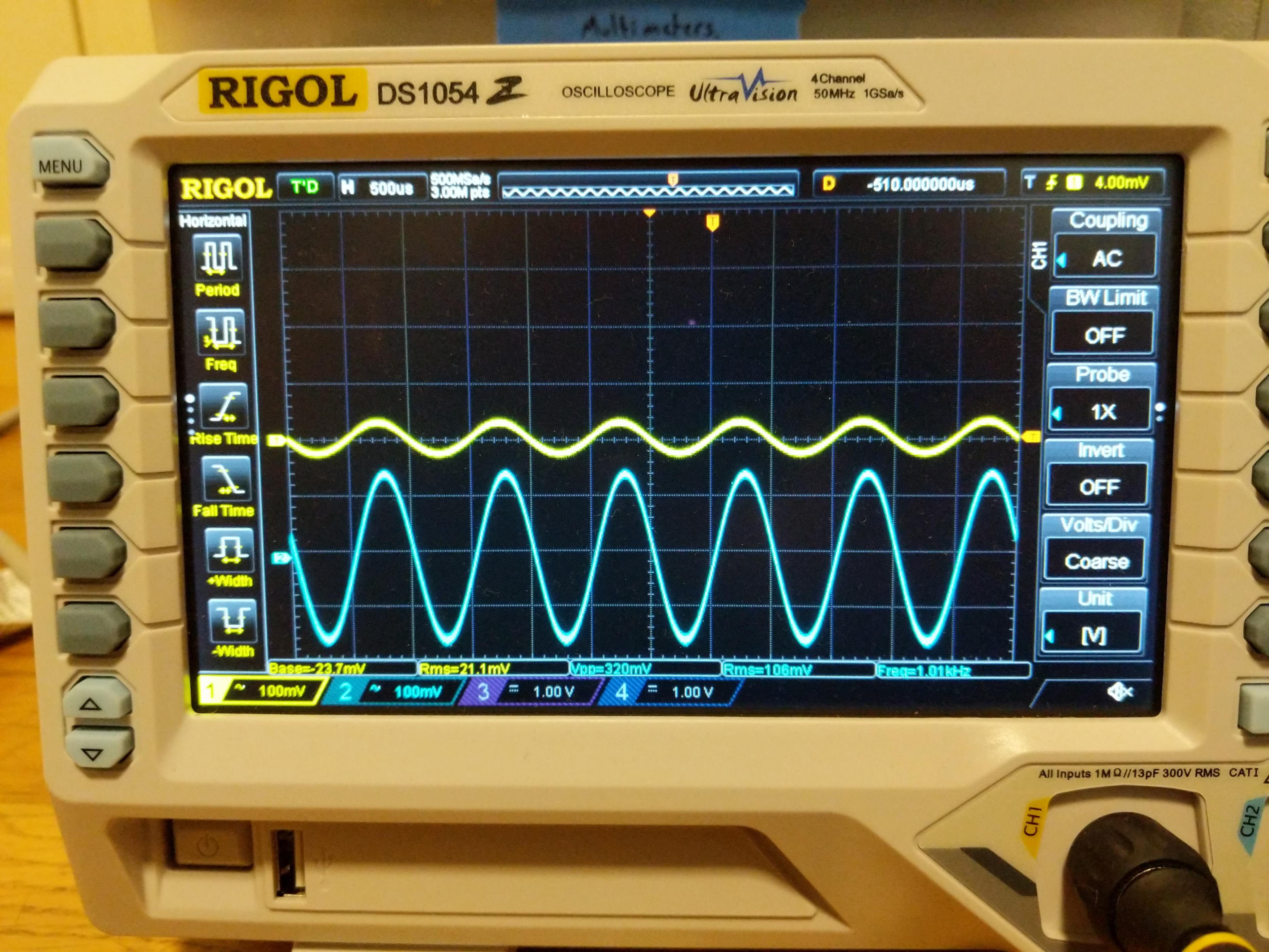

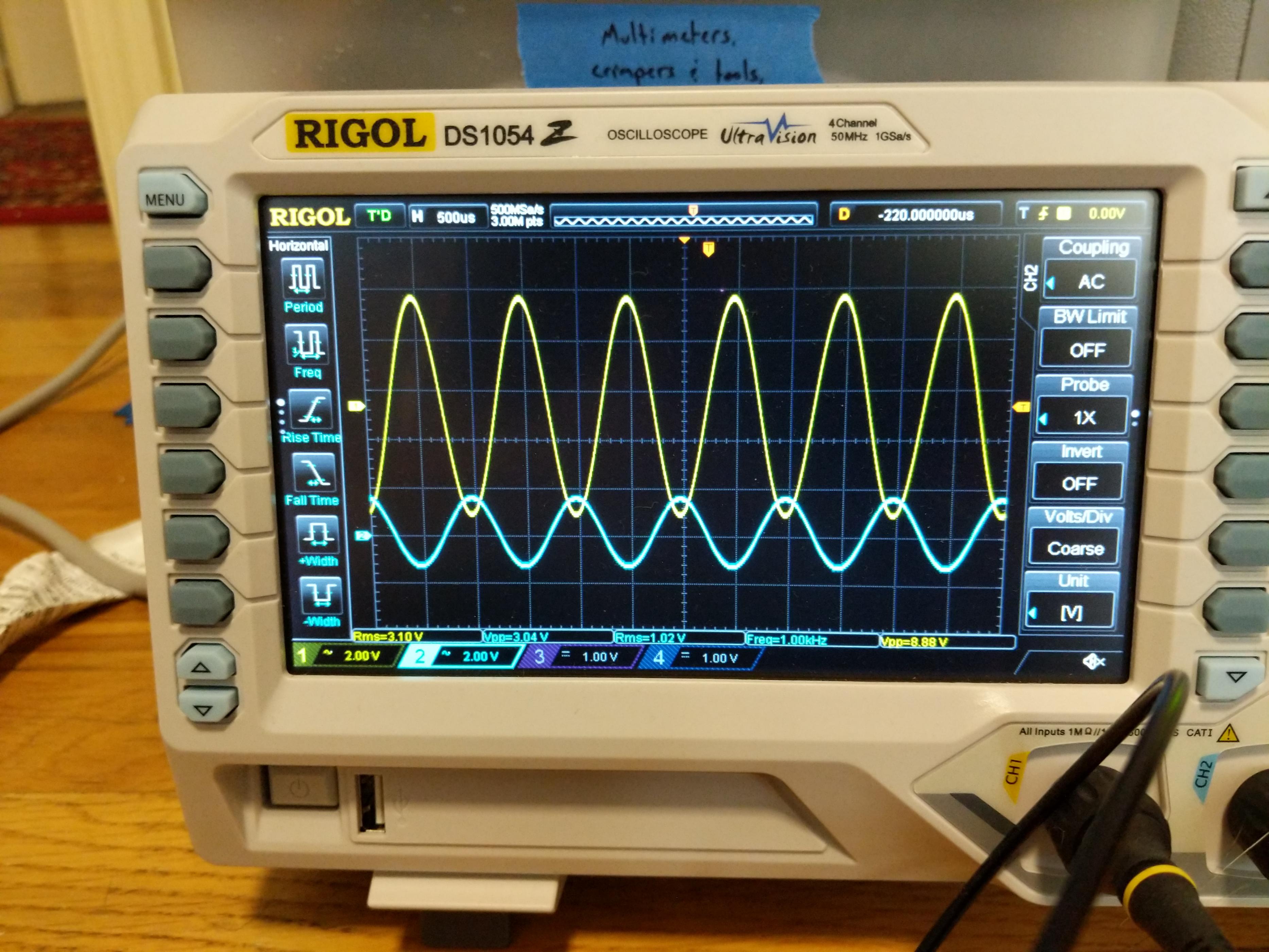

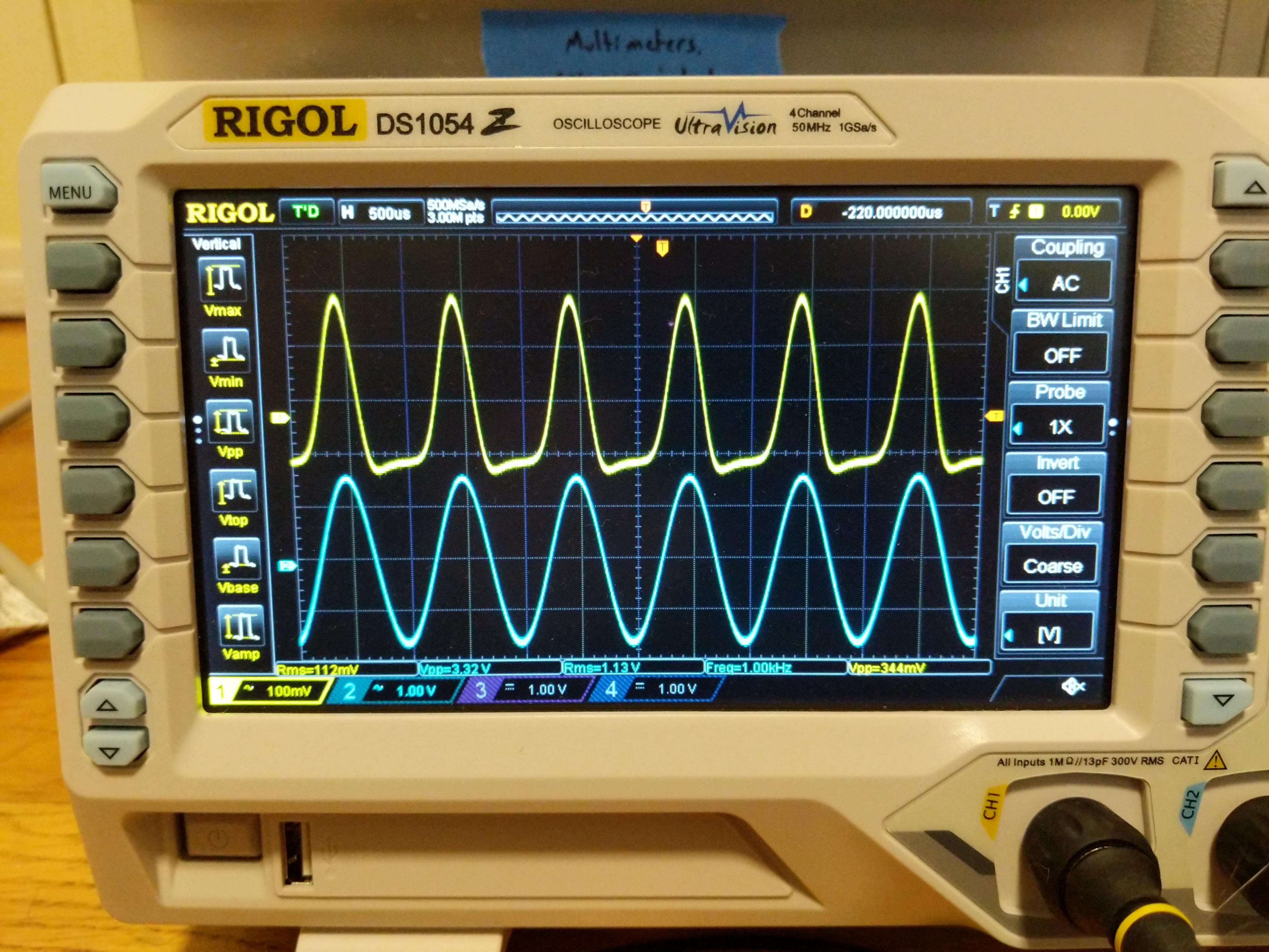

I built the ACA 1.6 this past summer. I was happy with the way it sounded and the volume level it produced w/ my ~90dB sensitivity speakers. All voltages looked good (double-checked again today), etc. No issues.
A few months ago I picked up my first oscilloscope and an 8 ohm non-inductive dummy load resistor and decided to measure the output level of the ACA. I've used the same setup to measure other amps without any issues.
But the measurements I'm getting from the ACA don't make any sense, and the 1KHz tone gets distorted at very low levels.
In the following photos I've got the dummy load on CH1 (yellow trace) and the output of my volume-adjustable DAC on CH2 (blue trace). I'm confused by what I'm seeing.
Any idea what is going on? Music does start to sound a little funky at higher volume levels.
I'm a total newbie w/ the scope so maybe I'm missing something here.
First image is w/ volume very low - here you can see the scale is set the same for both channels on the scope (100mV)
Second two images show the point at which the sine wave starts to distort and then the DAC output at its maximum level. Notice that the scale is set 10x higher on CH2 (DAC output) than CH1 (dummy load attached to ACA). Both probes are set to 1x both on the probe and on the scope. (Not sure why one of them is showing upside-down...)

Be careful, the black output ls connector is signal, red is gnd. If you connect the gnd of the probe to the black connector you short the output, if you connect the second probe gnd clip on the input at the gnd of the rca connector.
Welp, thank you for the quick help. That solved it.
Here's the scope with the probe leads reversed, same test signal, etc.
Seems w/ a 1V signal in I'm getting a max of about 1.2W out. I see what Nelson is saying all the time about "1W is louder than you think." 🙂

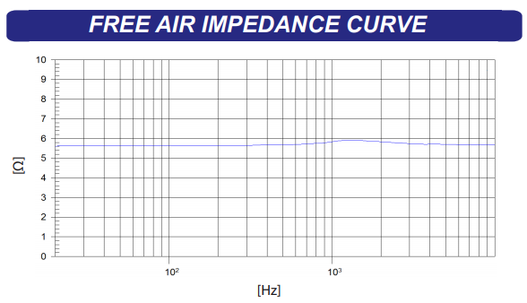

I'm doing a 4-way active build with Two (2 pcs) Firstwatt M2's. One on midbass (2 x 15") and one on midrange (2 x 8"). Sub (2 x 21") will be powered by a Crown XLS. As tweeter I will use Beyma TPL-150B.
Would a Amp Camp Amp be suitable for the TPL's? Total system sensitivity will be around 100dB so I guess the power of the ACA is enough.
The TPL also seems to be an easy load, see pic.
