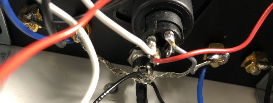

As I continue my intermittent troubleshooting it seems one of the most obvious issues I have is that on one board Q1 S is registering 24v when it should be zero. On close inspection nothing seems to be obvious on the board itself. Could this instead be an issue with how I have attached the ground wire?
You need to make a really good solder job where the 2 black wires and the 'twisted' wire meet the input connector. From the picture it does not look soldered at all.
The other solder joints do not look special either. They look 'blobby'. You should hold the iron against the joint a little longer, then the solder will flow into and around the joints when you get it right.
The source of Q1 should be connected directly to ground and so I suggest you check carefully where you are measuring your voltage from... in other words where the black meter lead is connected to.
An ideal point would be the outer part (ground) of the RCA input sockets or the positive speaker terminal assuming you have wired these as per the instructions.
