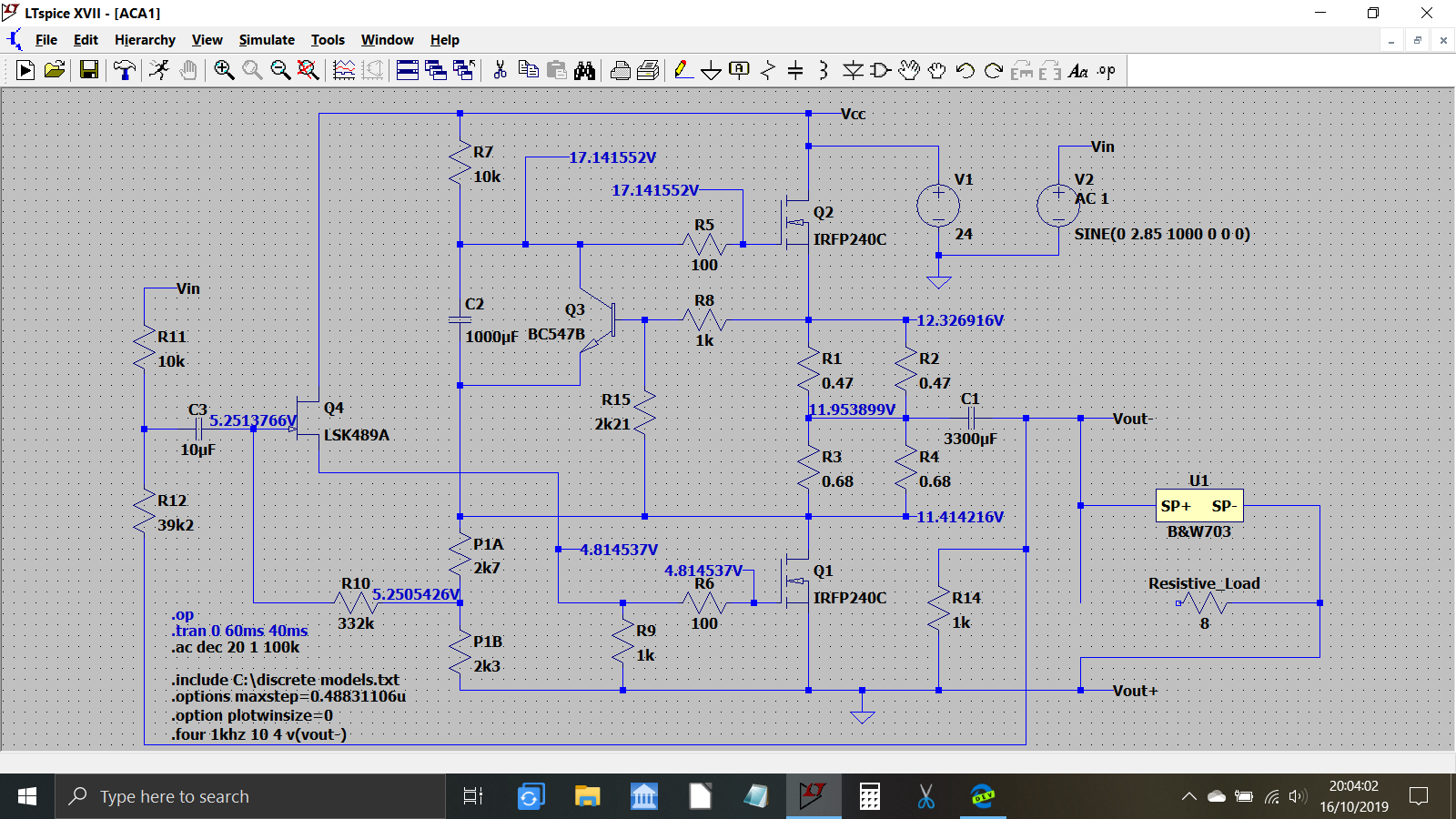

This shows you the typical voltages for a working amp, what you are looking for are gross variations. We know your midpoint voltage won't go above around 0.2 volts on the faulty channel, but that reading should reflect in errors elsewhere, so see where it falls down by measuring.

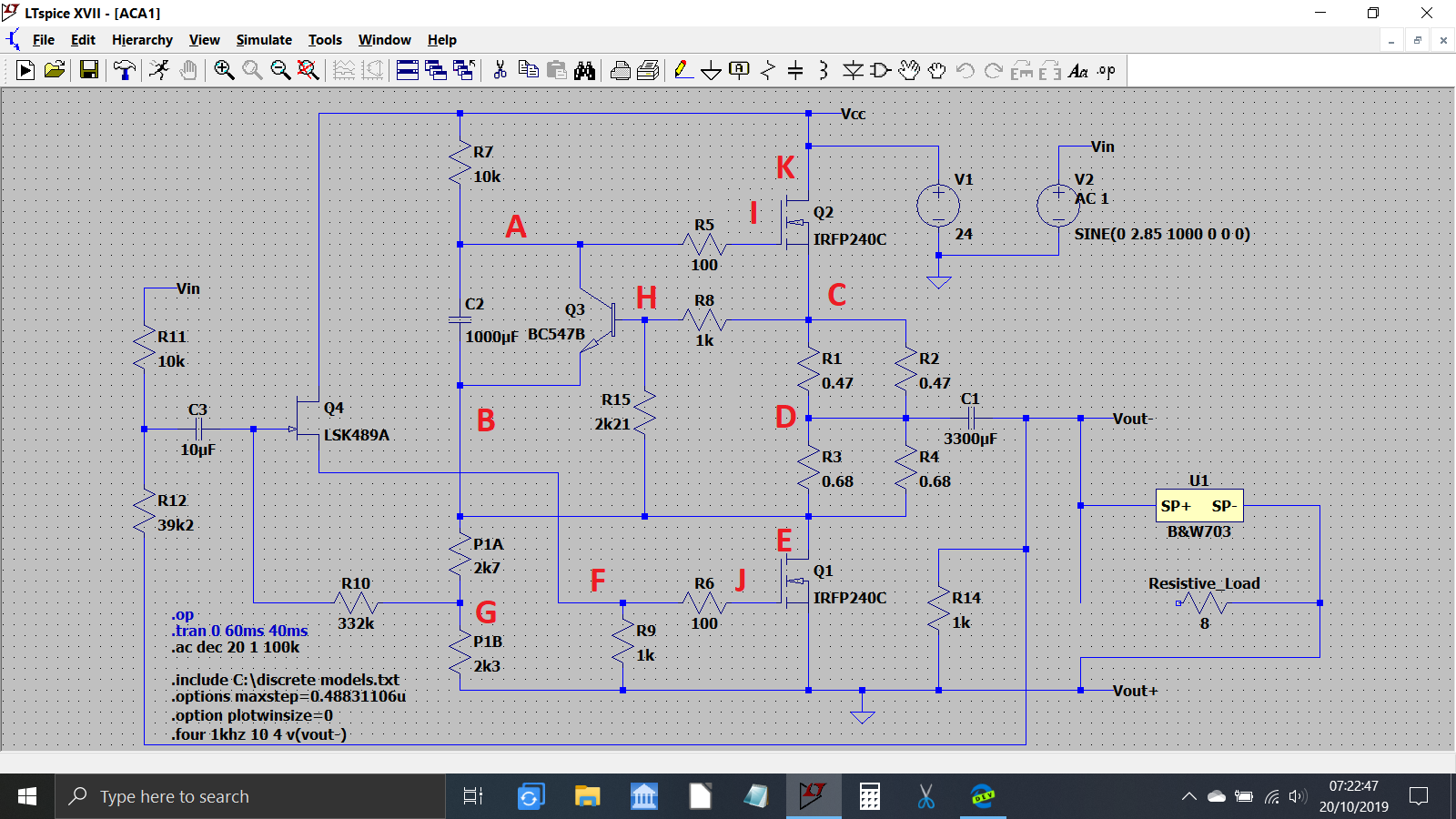

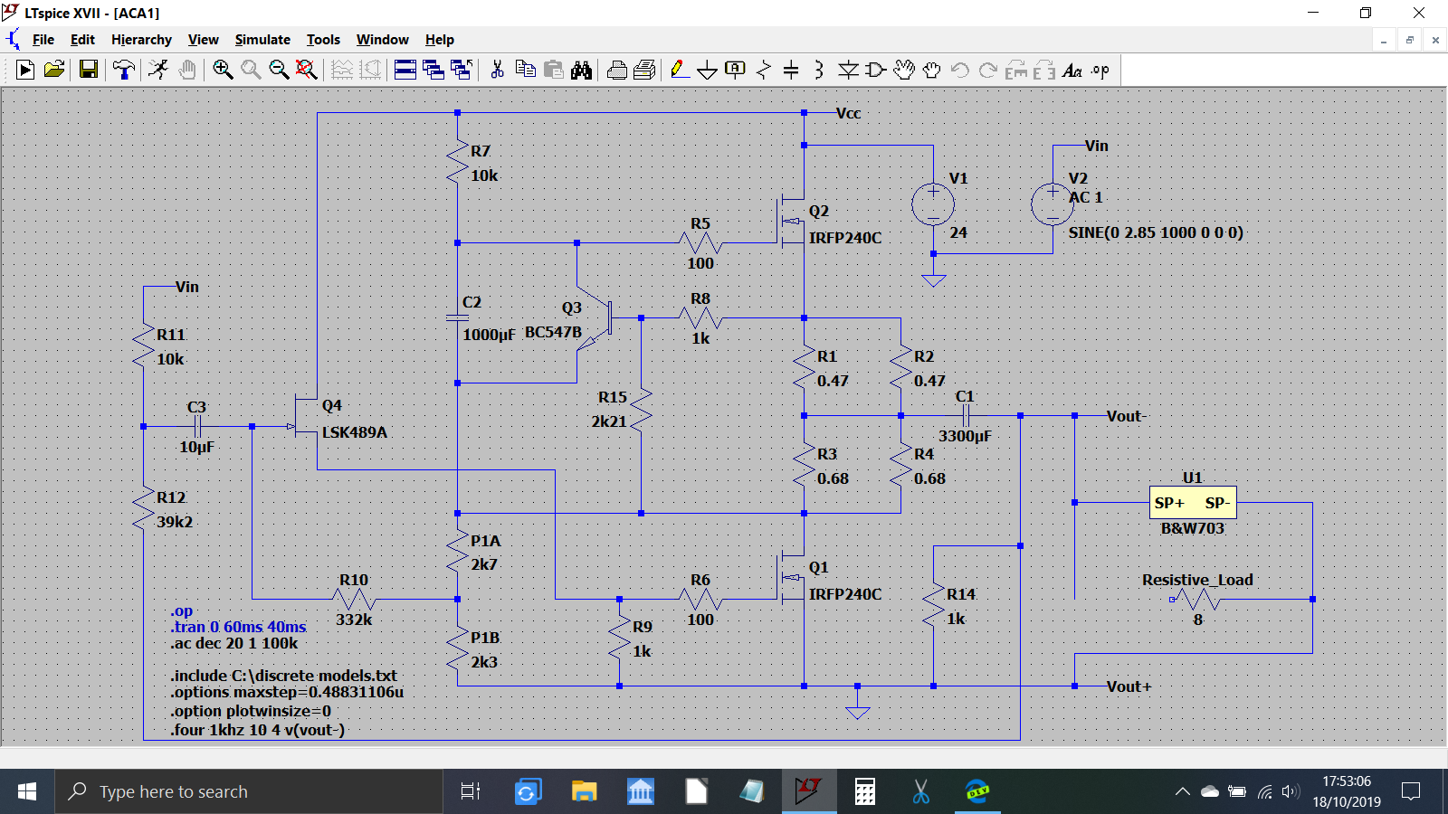

If you want to take this plain image of the circuit and then write all the voltages down that you measure then we should be able to compare to what we know should be present and determine what has happened.
I'd suggest cross checking the LT Spice info from Mooly with the build guide.

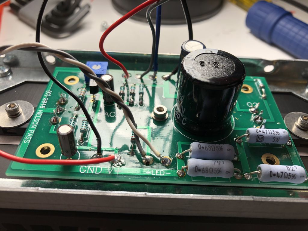

One other thing that I forgot to mention is that one of the heat sinks gets very hot while the other does not. Is that indicative of the side with the bad board? I'm assuming the visual check is to look for any solders that are touching or wires that may touch the case?

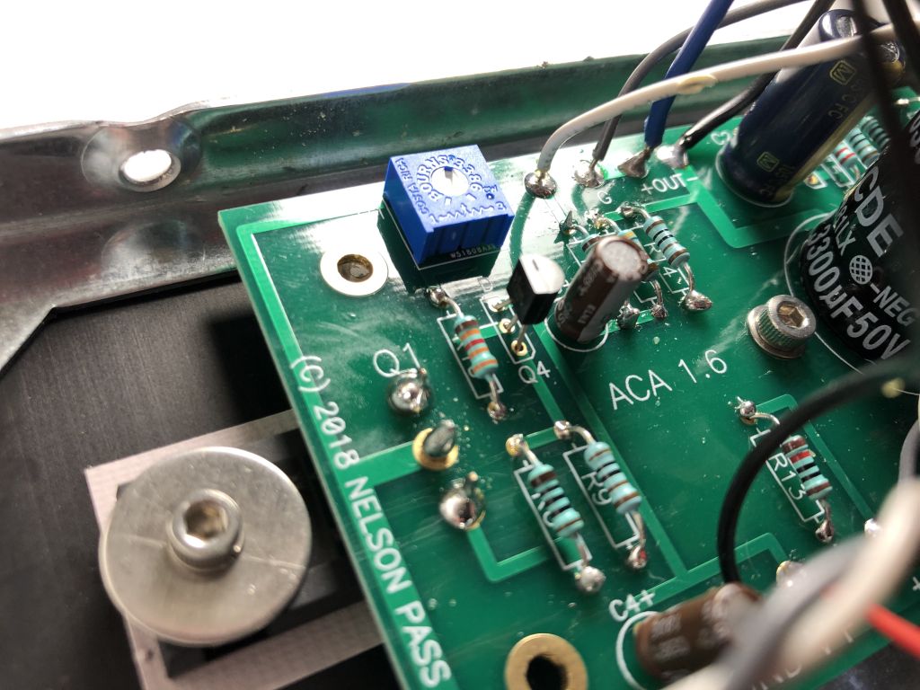

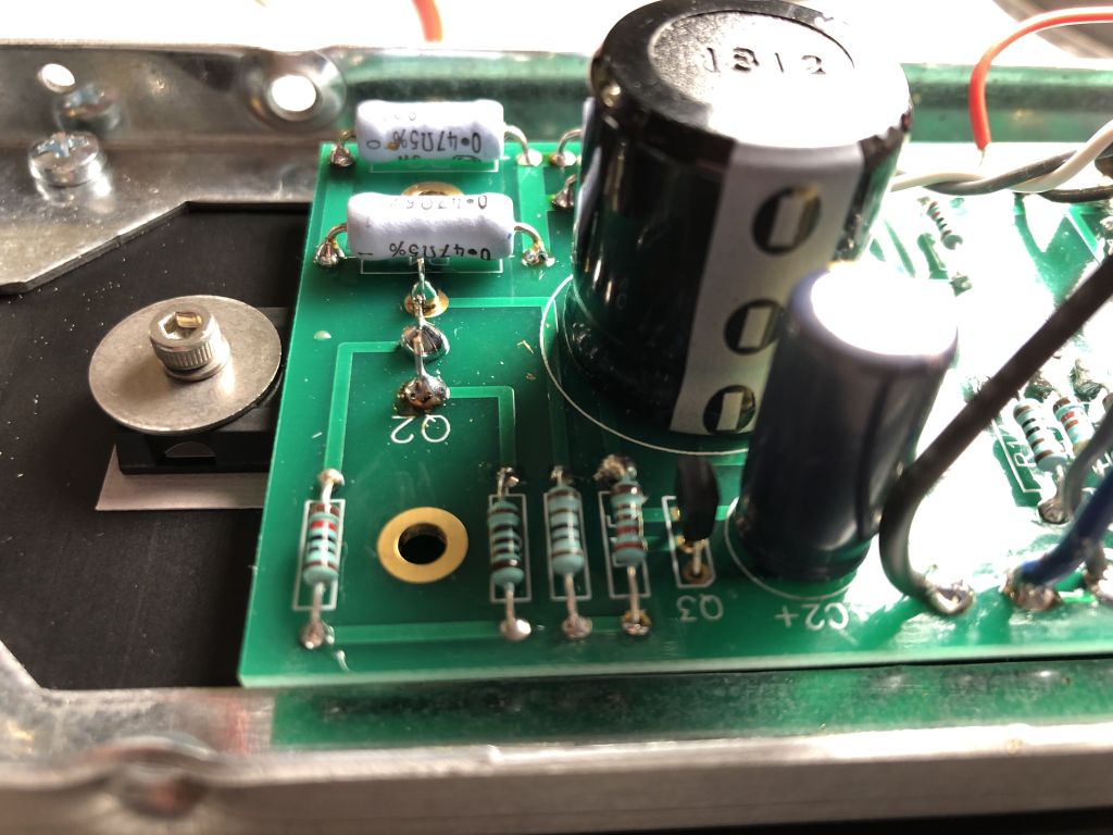

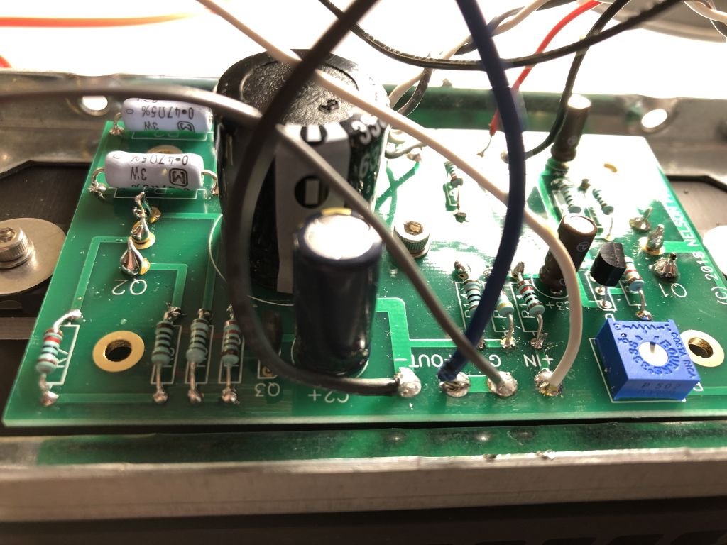

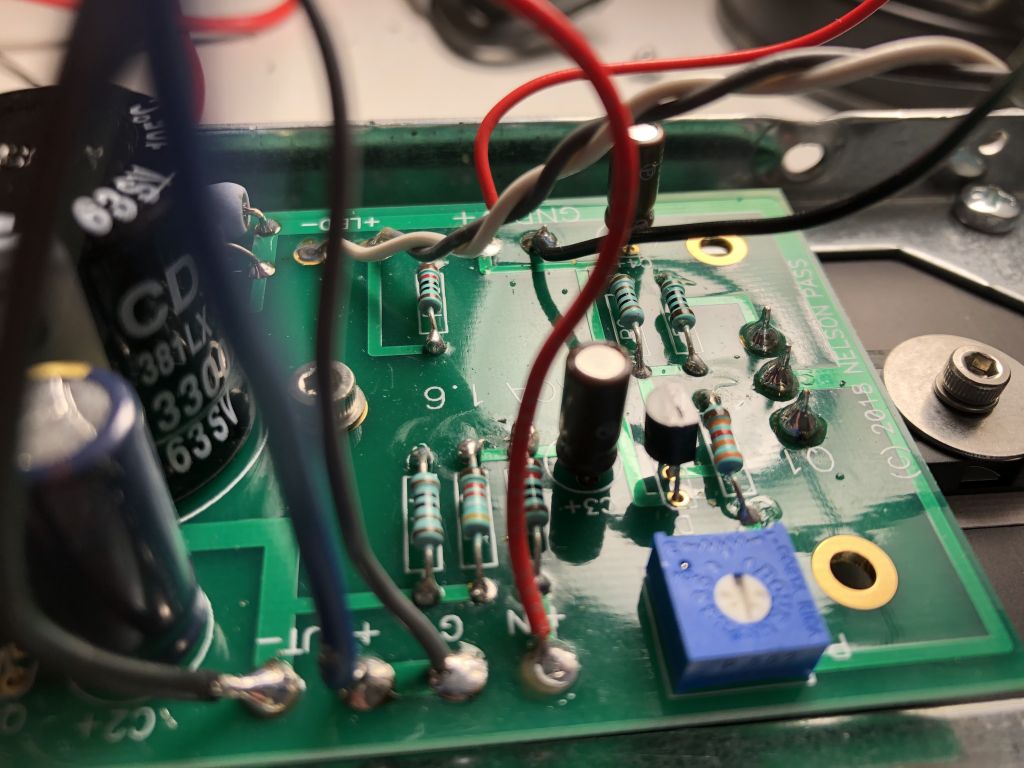

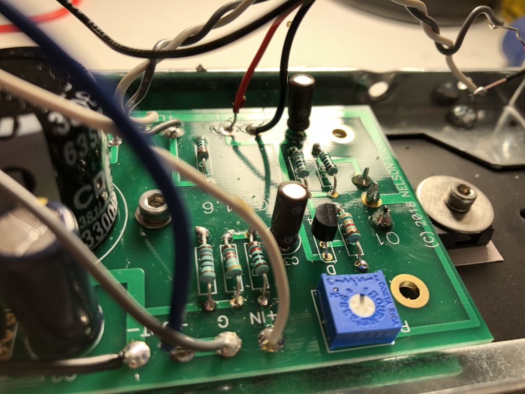

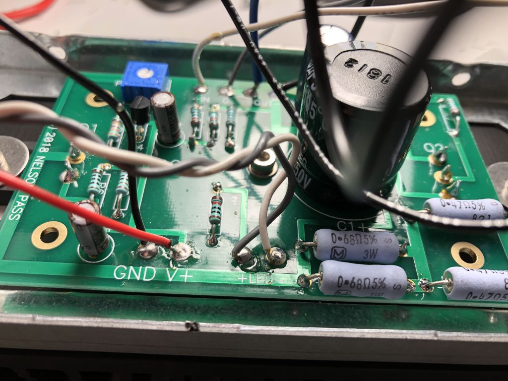

Can you post some well-lit, in-focus photos of your build? It would be extremely helpful with troubleshooting. 🙂
Here are a bunch of photos from several angles. Hopefully these are clear enough. Please let me know if you'd like close ups of any specific areas.

The heatsink question isn't definitive unfortunately because the ACA when operating normally does get hot...
That said I would probably suspect that the channel that is hot has an issue and also the channel that is cold.
The cold channel sounds like it is not drawing current (faulty) but that would not load the power supply.

Concentrate on one channel. I would disconnect the 24V supply to the HOT channel and lets see where the cold one is at with regard to voltage measurements. This cold channel could be the one that originally failed (smoked) and this now has some open circuit parts preventing current flow.

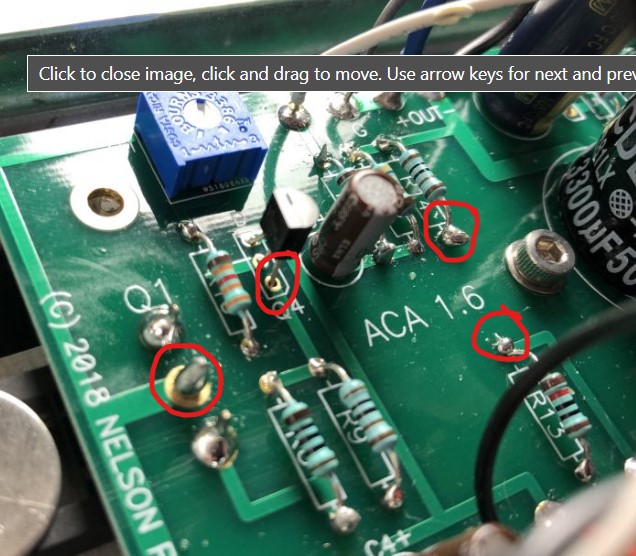

Things like this (also look at the underside of the board) need looking at. Don't be afraid to use a large tipped iron to put plenty of heat down. A small croc clip makes a good heat shunt that you can clip to the lead being soldered to protect the part from excess heat.

Then more generally there are a number of issues with your soldering. Several components are not soldered properly. This will let you down later if it is not causing a problem right now... Difficult to see too, but the RCA inputs look shorted? Can you check?
