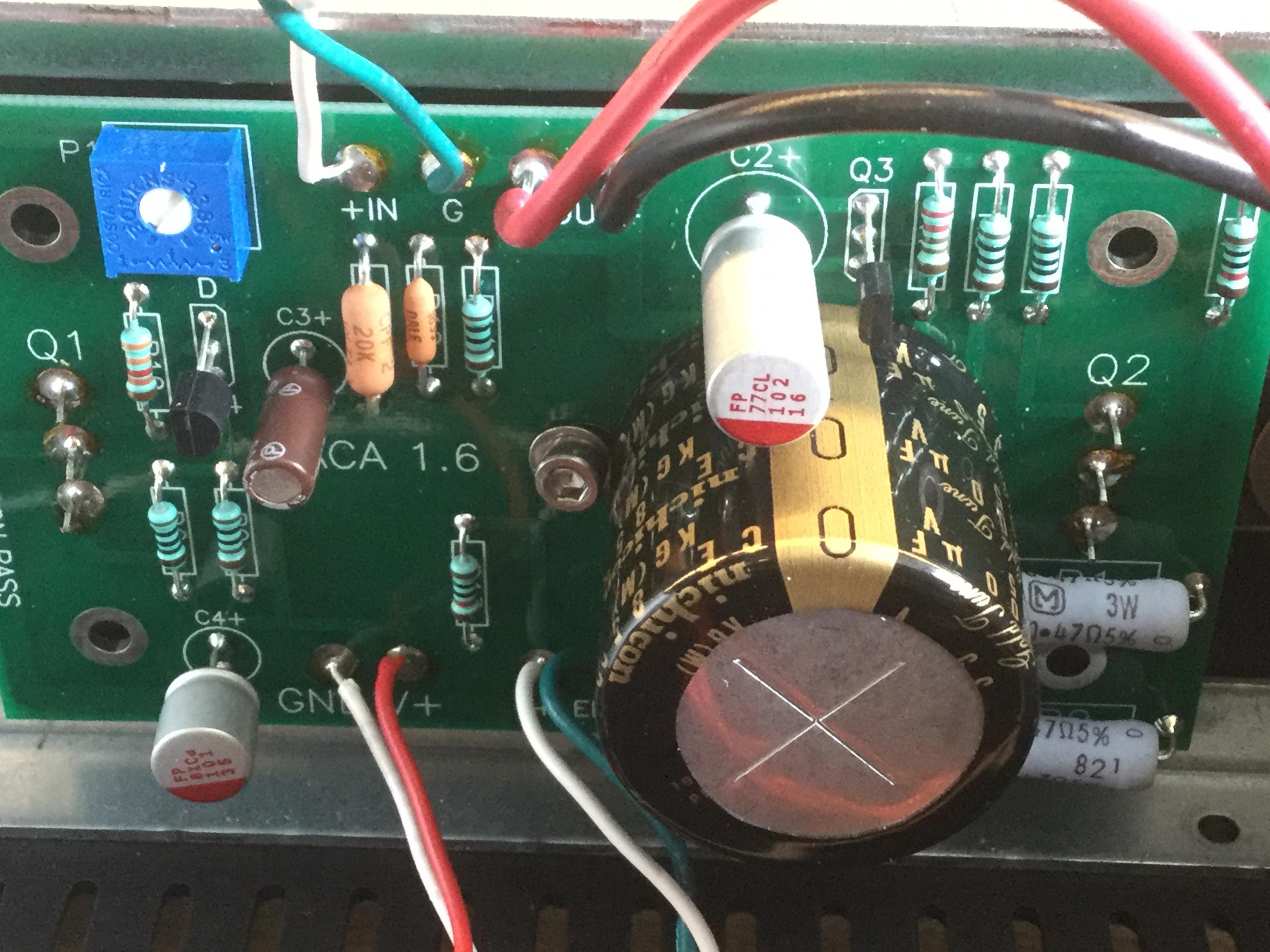

I recently purchased a second ACA 1.6 to run a monoblock pair. I built the second amp with a modified build to better match my low impedance speakers.
R11=20k
R12=90.9k
C1=4700uf
C2= 1000uf
C4= 100uf
R4=.50k
The second amp with the mods sounds great. When I used both amps as monoblocks (1st one original spec, 2nd one modded, parallel rca) the second was louder and seemed like it had more gain. I had to use the balance knob to even out the sound. I figured the second amp did have more gain due to the mods and I just needed to update the 1st original amp to match the 2nd.
I used the extra set of mod parts I ordered and updated the 1st amp. And it still has less gain than the 2nd amp. I’ve compared the two amps and can’t see any differences in parts or wiring. ( attached is a pic of the modded 1st amp board).
Any thoughts where to start?

If you feed a fixed input signal to both amps, do you measure the same output? Or does measurements follow what you are hearing?

I don’t think so.
When I noticed the difference in volume, I disconnected the amps and switched the amps to the opposite channel. I figured it was the easiest way to eliminate the room, cables, source and preamp. I found the same issue: my first amp wasn’t playing as loud as the second amp, no matter what channel it was driving.
When I play the first amp only, that amp driving both channels, it sounds good. No odd sounds, no missing sounds, no hum.... When I play he second amp only, it’s sound great. More dynamic, more interesting.
Some of that or most of it might just be the difference in gain. I don’t have a golden ear, so it’s hard to hear subtle differences.
A few questions,
Are both the PSUs 24 volt units? Have you swapped them round?
Are both the amplifier 'modules' in the quieter side working correctly? I.e. are they both as loud as each other if you do not use them in mono-block mode.
Have you used 'bridge' or parallel mode for the mono-blocks?

Thanks for the help.
Yes, both PSUs are 24 volt and I left each one with a channel as I swapped the amps. The lower volume signal followed the first amp.
If I compare the two amps when one amp is driving both channels, playing the same music with the same preamp settings, I’d say he first amp is quieter than the second. Both channels on the first amp play and there’s no difference in volume between the two channels, though.
I’ve only played them as monoblocks using the bridged monoblock RCA input from the build guide. I’m not sure if that is parallel mode.
I do have a balanced preamp and I ordered XLR cables, due to arrive this week. I’ll try them with the bridged monoblock XLR input next.
Update- I re-biased the amps and set up them up as bridged monoblocks using balanced connections to my preamp. Everything seems to be working well and each channel seems correct.
The overall system sounds great. It's a noticeable improvement over running a single ACA with single ended connections. It's worth the time and investment.
