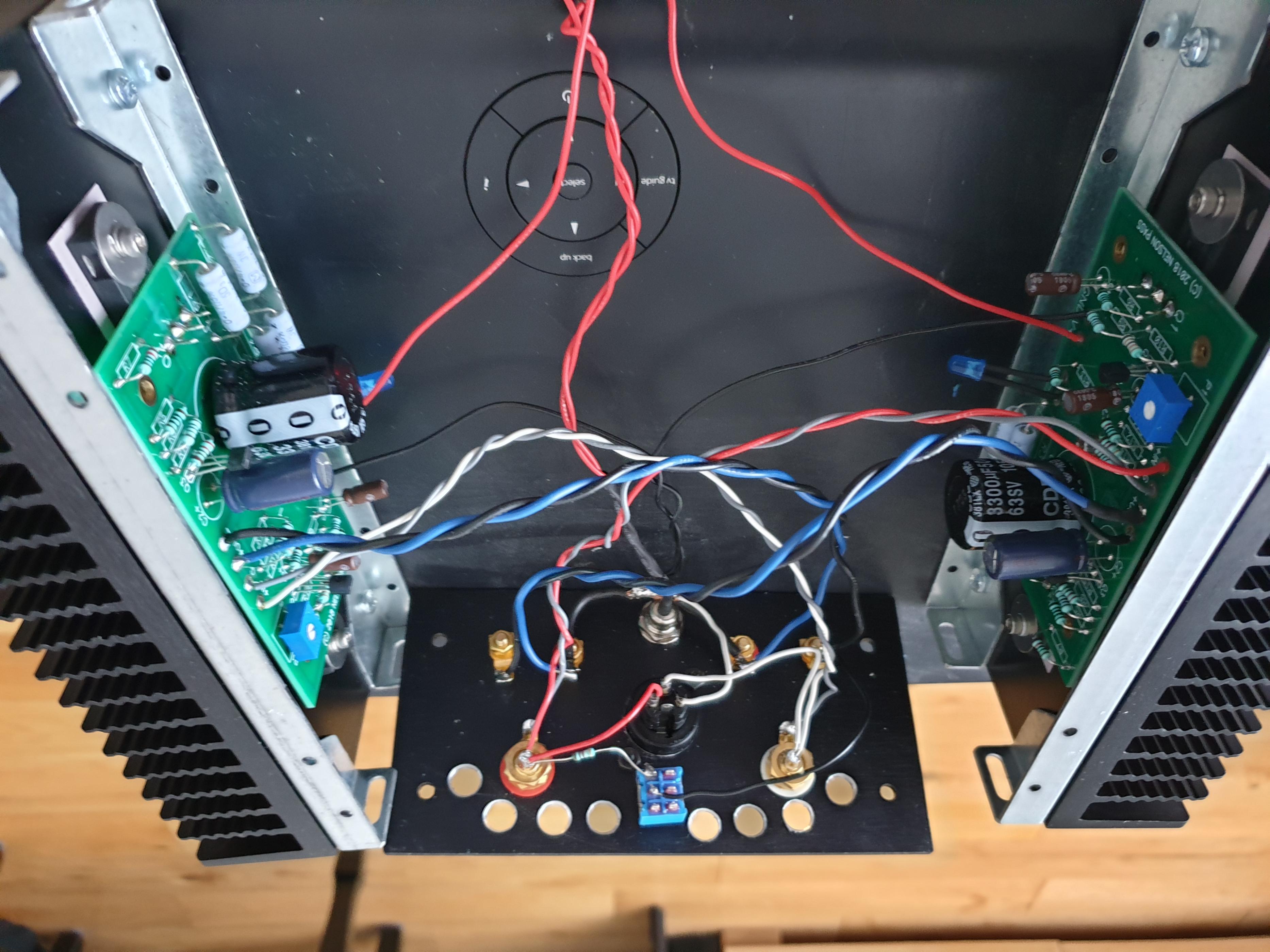

If you just move the PCBs without changing any wiring, that won’t change anything. The PCBs are identical, which side they are on is immaterial. The input wiring and output wiring is the only thing that matters.
That said, I’m not entirely sure what you are describing, could you post a couple photos?
The wiring appears on-side for input and output. So it doesn't matter for operation.
If you want symmetry, it looks like the easiest thing to do would be rotate the front and back panels 180deg.
Thanks 6L6.
It might be my imagination, but it seemed to take a lot longer this time to set the bias to 12v it seemed to jump about a lot.
Also, when I turn the power on (having left the test leads on the boards, I noticed that initially the voltage jumps up to around 16v, then descends to about 10.5v and slowly creeps back to 12v after about 45 seconds, is this normal? In truth I didn't check to see if this happened on the first ACA I built.
Same model of Meanwell psu used on this amp.
Normal. Things take a bit of time to settle in on power up.
As for jumpyness on setting the DC point, you may have a not solid connection somewhere, or perhaps it’s just that the amp takes a bit of time to react to the changes, and you are trying to have it change too fast? Make a change in pot position, wait for it to settle, make another change, let it settle. It does not track the pot immediately.

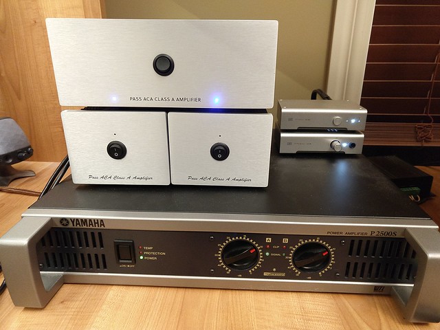

We Have Lift Off
Got the first one up and going on it's maiden voyage. Sitting here on top of it's little brothers. Robbed their setup to run a quick test. I'm always amazed when I flip that switch and get wonderful sound instead of puffs of smoke.....
This one does not have the manners of it's little brothers, it farts lightly on startup. I'm sure the family will be amused. 😀
Yes, but it's a musical fart.
Eating too many beans. Duh.
The “fart” is normal on startup, it’s the output capacitor charging.
So true, Mazeppa, so true.Yes, but it's a musical fart.
I have noticed that my MF'ers (that's Musical Farters, of course) only do it in stereo mode. In bridged mode, they hold it, very quiet on start-up. 😀
If you miss those cute little noises, parallel mono mode will bring them back.
