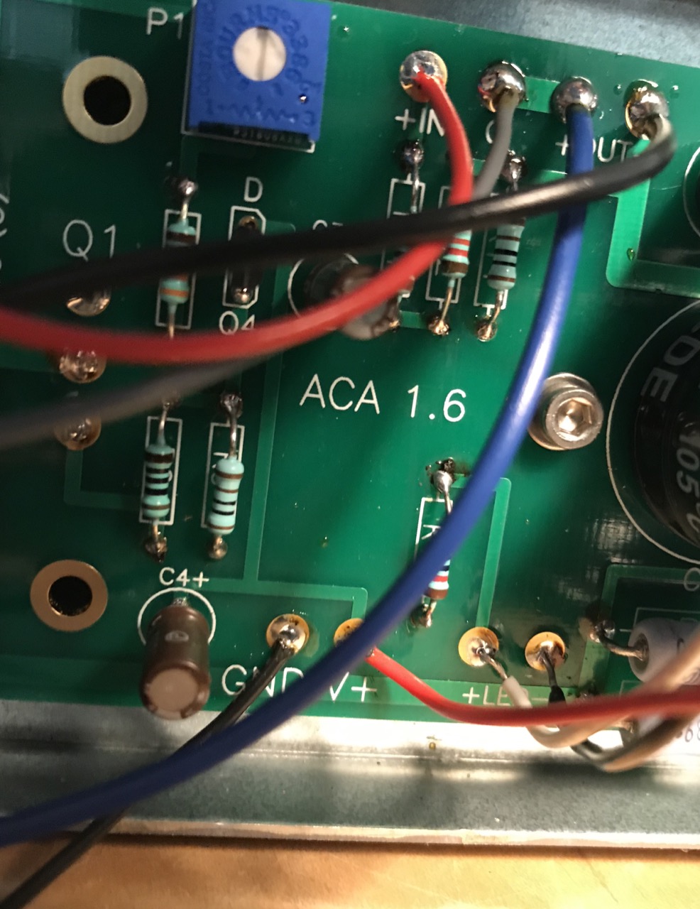

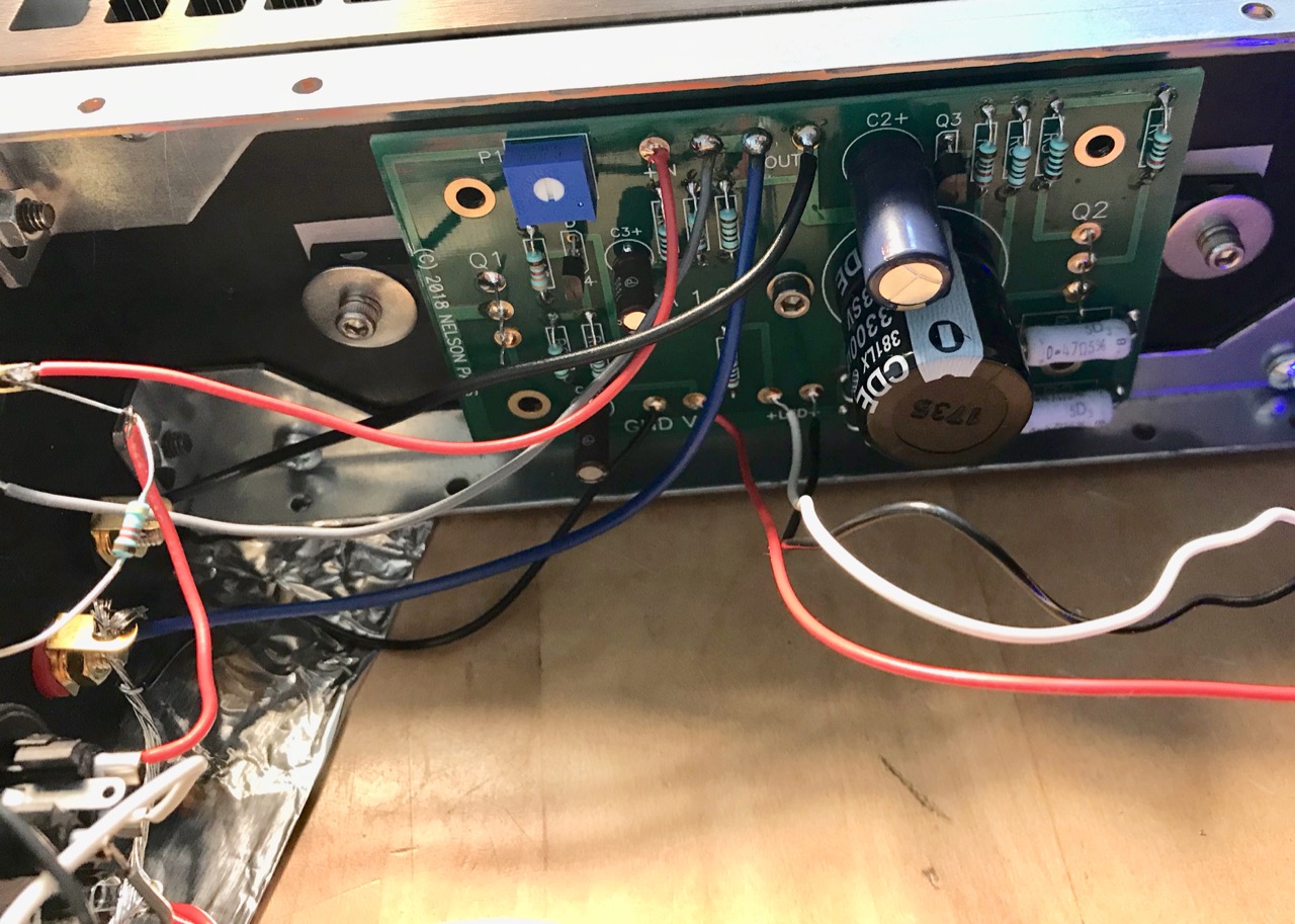

one blue diode active, no heat from heatsinks, how to reflow?
Great to see that persistence and stepping through carefully pays off with a working amp. I've built mine over a few spare hours in the past week or so and must have bad soldering or mis-wiring.
If I have one diode lit, the other one not, no heat from the heatsinks, and of course no sound... where do I start with troubleshooting?
I'd like to try re-soldering everything. How do I get the bits that are in there now out -- how to remove all the solder that's now holding things in place?

I wouldn't start pulling parts out tbh, that's a recipe for disaster. Look at each part in turn, confirm its correct and correctly orientated and then reflow the joints if they look suspect.
A suitable iron and bit should make a good joint in just two or three seconds. Always use suitable solder as well. The joint should be bright and shiny.
Maybe post a picture of the board and the joints and we can advise how best to proceed.

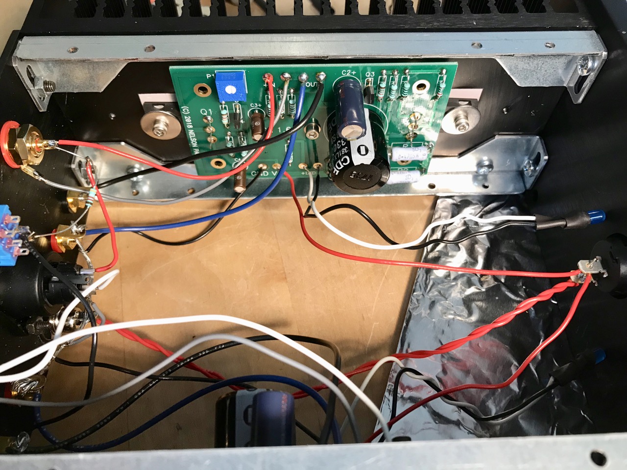

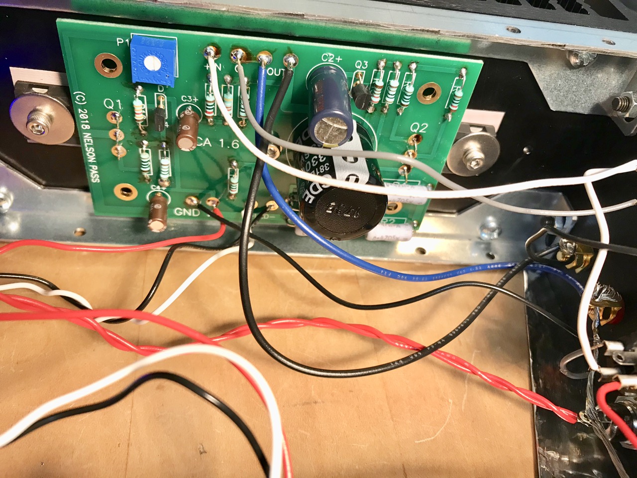

Thanks! I'll do that. A few pictures should be attached.

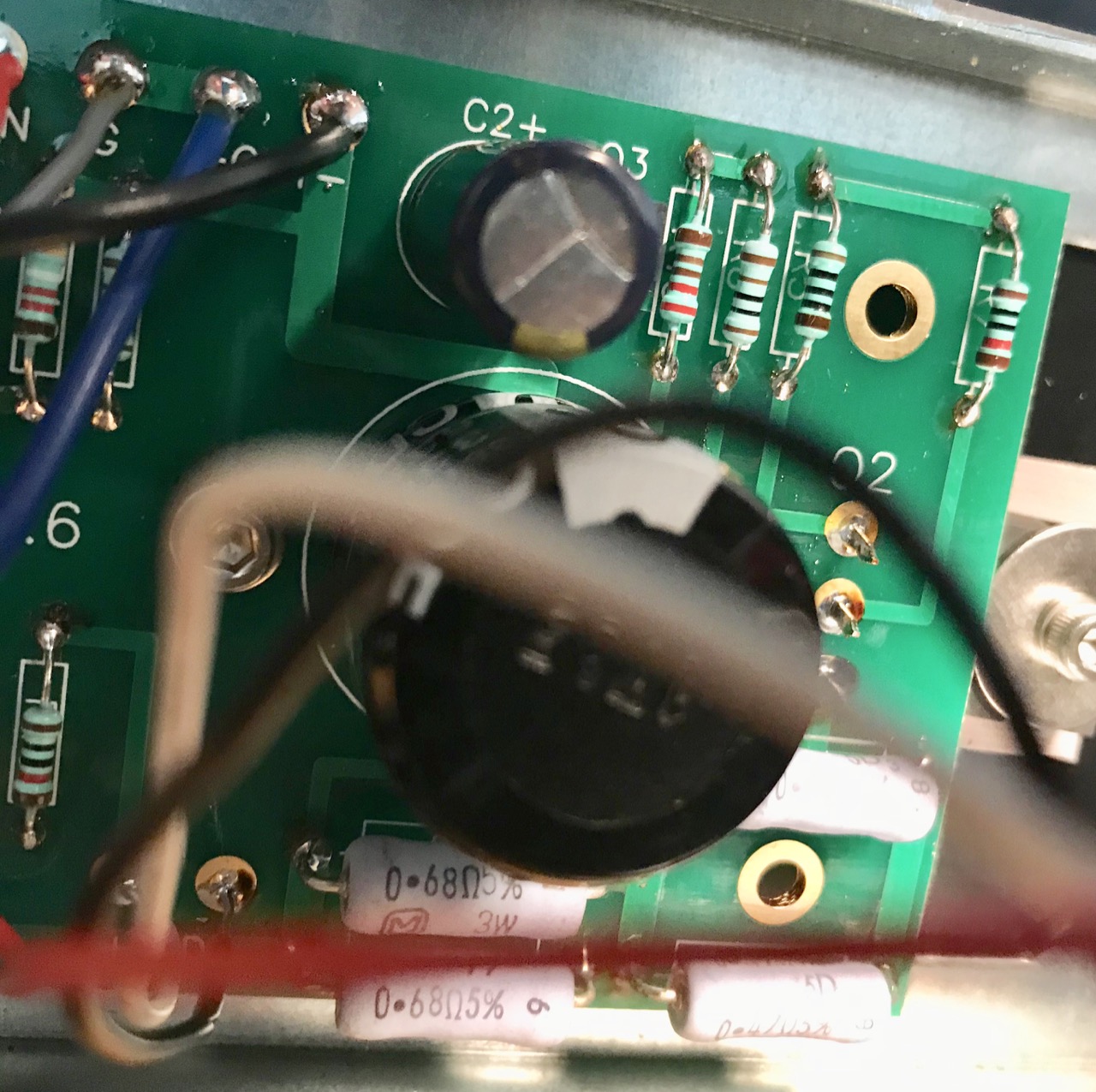

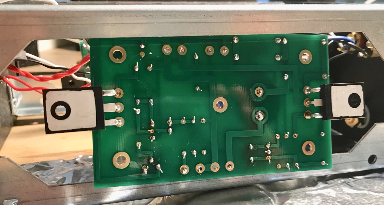

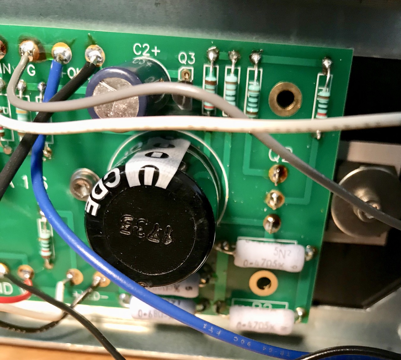

OK, so that definitely looks salvageable to me.
I can see a lot of joints that have virtually no solder on them so what you need to do is reflow these correctly. I'm assuming your iron is OK and my choice would be to use a fairly large tip for this as that will hold the heat. A good iron and tip really is crucial.
Apply the iron to a joint while at the same time applying solder to the iron/joint interface. Don't be afraid to put a little pressure on the iron to really contact the board. The solder should flow instantly around and into the joint. If it doesn't then something in the technique or equipment is amiss.
Its important not to overheat small parts and one way to avoid that is to mentally count... one, two, three and four. Any longer is to long. You should ideally only need around a couple of seconds per joint on the small stuff.
A tiny croc clip attached to the component lead on the opposite side of the board is a great way to reduce heat into a component although you shouldn't really need to be doing that here.

Jng, if you look at the schematic, the led is only one resistor after the voltage input. If that one is not lighting up, you may have an issue with the voltage input, the ground or something very basic that is missing.
So I'd start there. Make sure that voltage is reaching the PCB before taking the PCB apart.

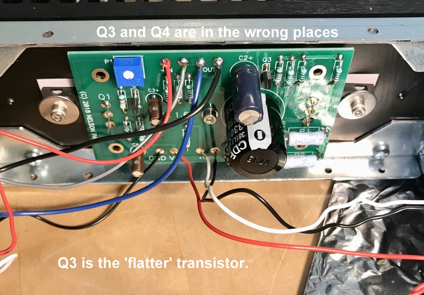

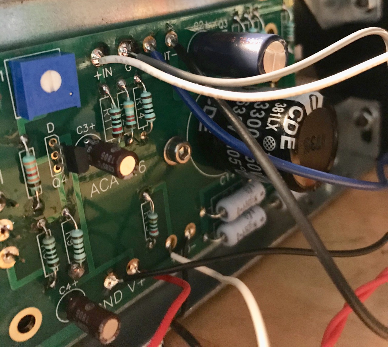

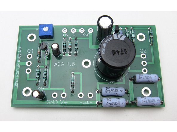

Jng,
There is a more obvious problem with your build, you have put Q3 and Q4 in the wrong places...
Q3 (ZTX450) has the 2 flatter sides. Q4 has the rounded shape and one flat side.
See the pictures. See the pictures please.
The other problem, as Mooly and Mazeppa has pointed out, is that there are numerous joints that are not soldered. Both on the boards and on the wiring.
You will need to remove both Q3s and Q4s first. You need to use a 'solder sucker' or 'solder braid' to remover the solder holding them in.
Then you can inspect and correct all the poor joints one a a time...
It will work at the end I'm sure, Alan

Thanks, Rafa, Alan, and all, for soldering tips and careful inspection of those pics!
Each time I compare my circuit to reference pictures and diagrams on the how-to, it makes a little more sense. I didn't see the difference between Q3 and Q4 in the first go-round.
I used an iron and tip from a $30 Anbes kit from Amazon and Cardas quad solder. It would be nice to have extra hands; looks like tools are available from Amazon that will hold things in place while soldering.
I was worried about applying too much solder to the joints and must have erred quite a bit on the side of not enough. What should I use to vent or absorb solder fumes? We're in the northeast, so opening windows is an option but not my favorite.
