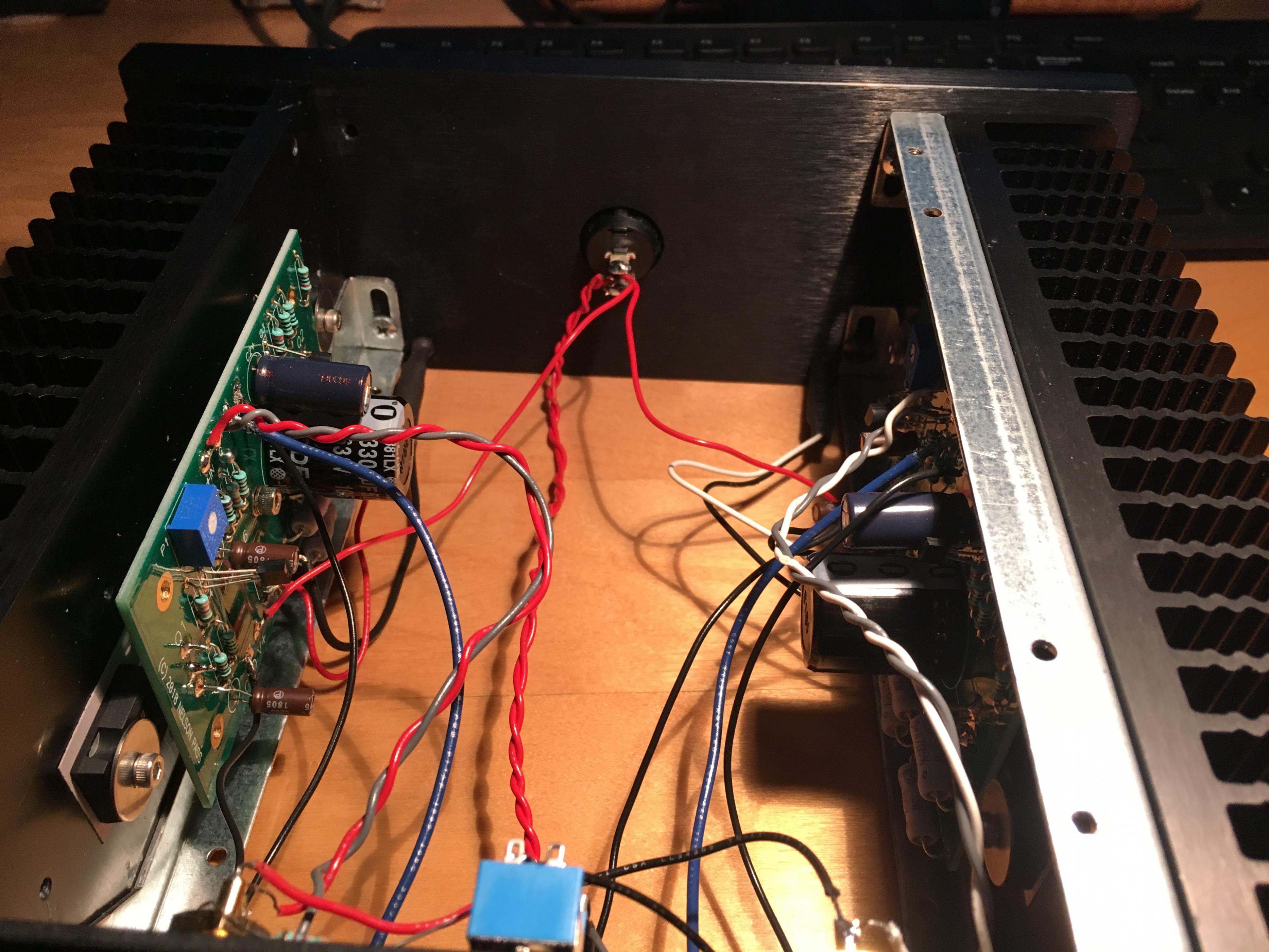

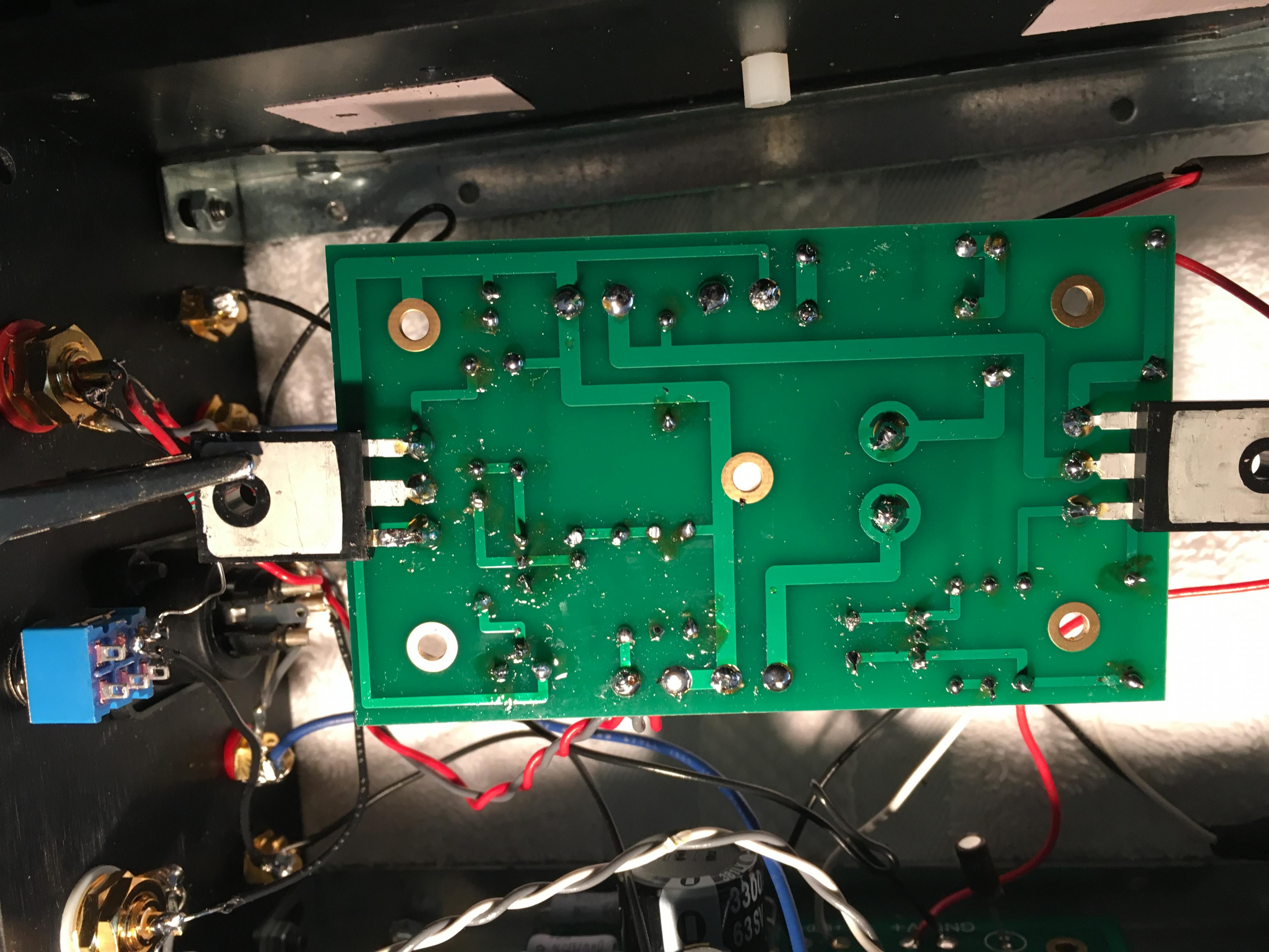

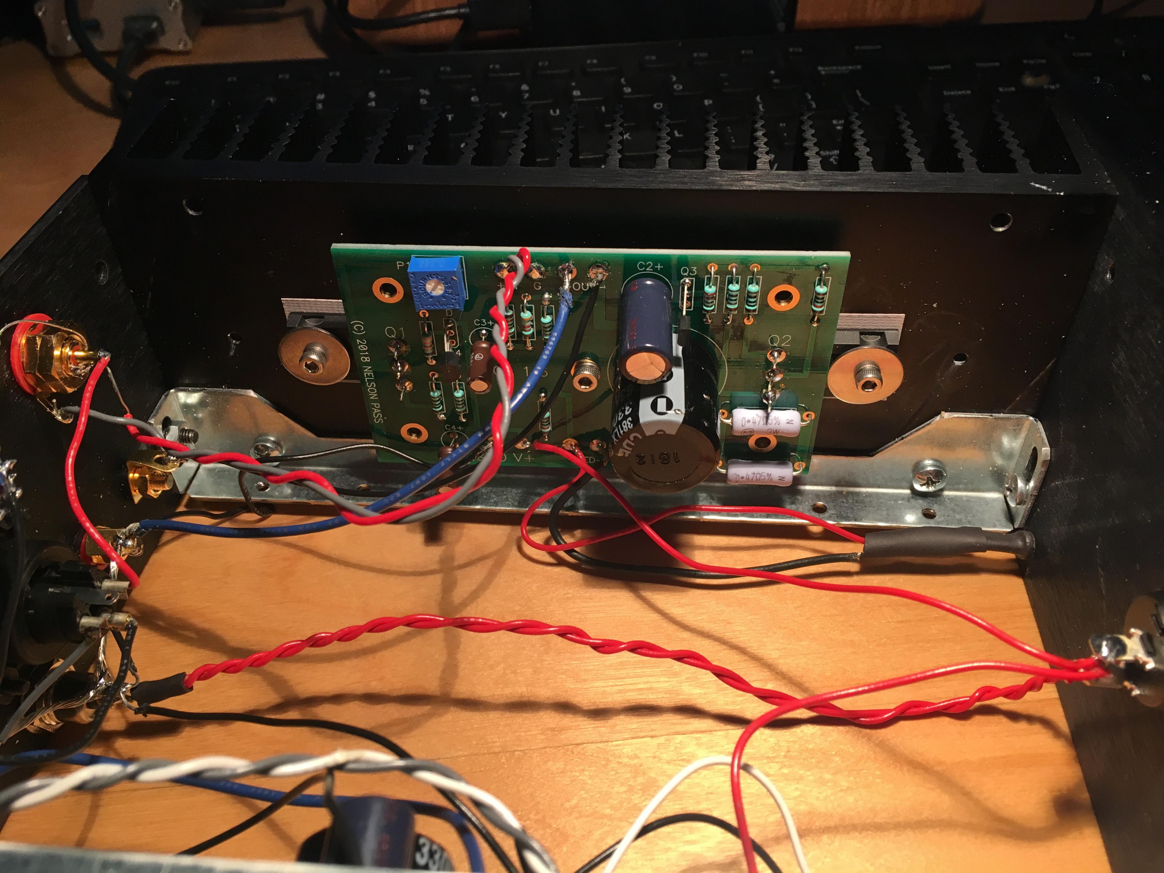

I just completed the ACA build with some new parts. I was able to set the bias to 12v on both channels. However, there's audio output on the left channel only. I used my DMM to test continuity for all the wires I soldered. All passed. I removed the rail and confirmed none of the wires I soldered to the board were touching the heatsink. I checked the wiring against the wiring diagram and all appears to be in order. Given my complete lack of soldering skills it's likely the problem is down to a bad solder. I'm just not sure how to proceed at this point. I'm hoping someone can point me in the right direction. Again, I know the soldering is terrible. Thanks.
To coin a well read phrase, post a series of well lit, in focus shots of the board on both sides. Those with the smarts and experience will very probably offer you good guidance.
EDIT: I wouldn't be surprised if the underside of the PCB tells the story.

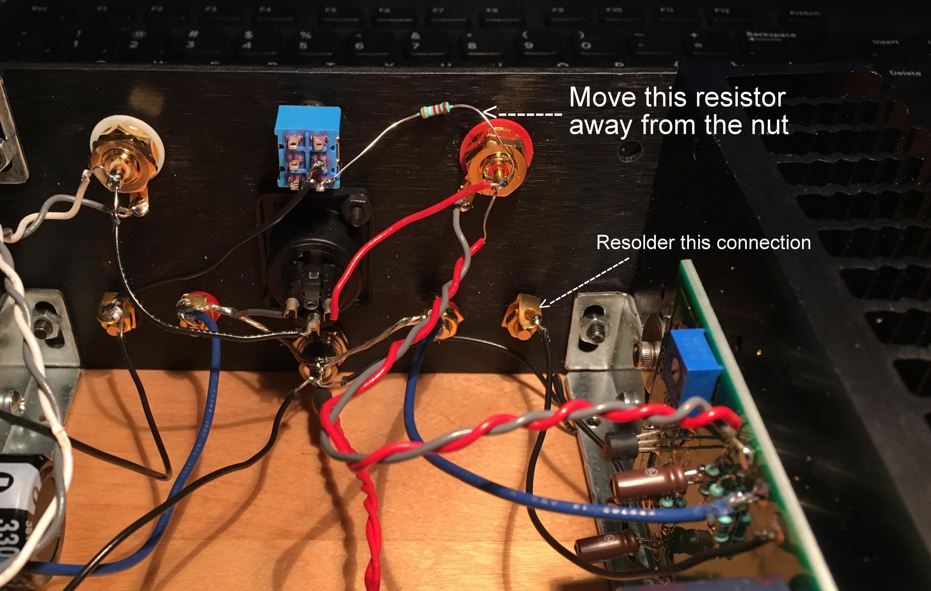

Gary,
First thing is move the resistor shown in the picture away from the nut. If it touches it it will short your input and you will get no sound. And re-solder the speaker connection.
If that does not fix it, do both amplifier heatsinks get hot after a few minutes of being switched on?
Then the way forward is to remove the faulty board and take pictures so we can see it too as astromo says.
Now we can see the top of the board, I still suspect a poor solder joint.
As you get the 12 volt 'bias' ok, I would think the large capacitor C1 is not soldered in correctly?

Gary,

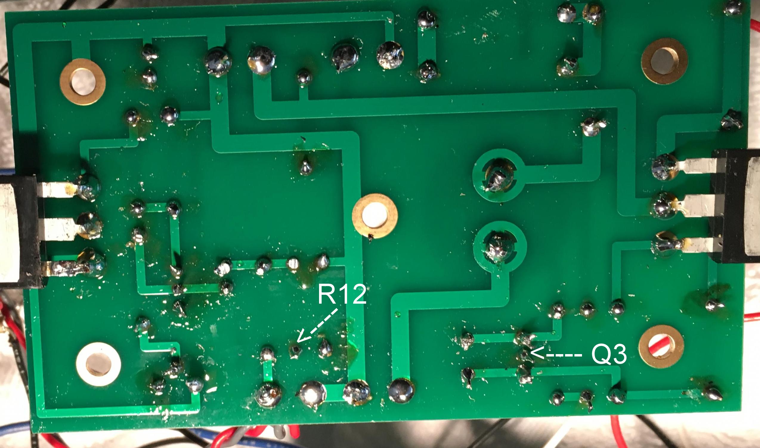

Hi garyalex,
As you say not the best soldering job!
If you look closely there are a couple of holes at R12 and Q3. You have to ensure the component leg comes through the board then soldered. Also there are some joints where the solder has not flowed. Quite a few possible 'cold' or 'dry' joints.
Start by re-soldering every connection and checking all the legs are fully through the holes.
I would suggest you leave the iron on the joint (the leg and the pad) a little longer before applying the solder, then it will flow better. A good sign is that you get a cone of solder round the leg on the front as well as the back of the board. If it is blobby or not through the board, do it again. Practice ehy?
Warnings now. Do not switch on until you remount the board onto the heatsink, you will pop the Q1 and Q2 MosFets... When you re-fit it make sure the thermal pads and faces of Q1 and Q2 are spotlessly clean.

Hi garyalex,
Alan
