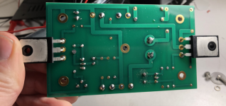

After a pause I'm back at my troubleshooting. I'm the guy who has something going on that's causing the LEDs to blink. I did figure our that it's only when the right channel's V+ is connected that the blinking occurs. I unscrewed the boards to see if there is an obvious problem. I'm a novice at soldering so there some cases (like Q4) I soldered from the bottom of the board since the spacing was so tight. Can that cause issues?
I have attached two better images of what appears to be the bad (right) board. Does anyone see any problems with any connections?
You where supposed to solder everything from the bottom except the main transistors and the cabling which you do carefully from the top. So no problem soldering on the bottom. Try going over the bottom with the soldering iron - it could be some of the joints on top only look OK. They look a little heavy like you added solder till you thought you had enough rather than wait for the heat to get in and leave you with volcano shaped joints. Fingers crossed for you - they sound excellent once done . Worth persevering with.
Hi bobertbk,
There is nothing obvious on those pictures to cause a short or to make the LEDs blink. Unless one of the joints was / is long enough to touch the chassis when the board is installed. The joints are suspect in lots of places, as has been mentioned a few times, you will need to correct them, but they are not causing the blinking problem.

Is this the board that you had smoke from in your original post? Is this the 'cold' or 'hot' board?
Then please give us some resistance readings from the bad board. Use the troubleshooting section Step 56 of the build guide.
Please Do not switch the unit on with the board off the chassis or you will fry Q1 and Q2.

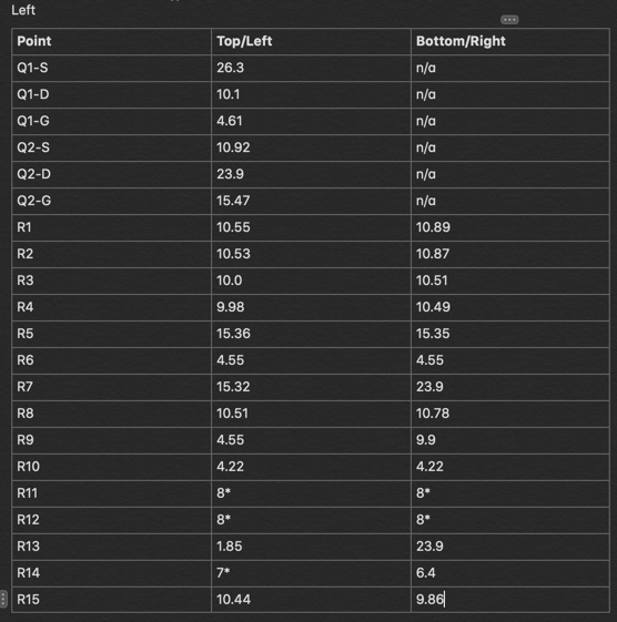

Ok. I wish I had read that last post before testing since I did detach the left (hot) board from the chassis to solder some of the connections under the board and then turned it on. The Q1 and Q2 did get blazing hot. I'm not sure if I destroyed them.
In any case I left the right board attached to the chassis and took all resistor and Q readings with the board facing me (R1-R4 closest to me). I recorded either the top/bottom or left/right resistor reading, depending on its orientation. You can see the results in the attached image. Many strange readings.
R11, R12, and R14 are particularly strange because the reading isn't stable. I indicated the voltage as 8* because it seemed to bounce between 6.5 and 10 or so.
bobertbk, question - where did you put your Negative meter lead to take the readings?
Yes some of those readings are strange, Q1S for instance is (should be) connected to the GND / 0 volts track, so cannot measure +24 volts, it should be 0 volts...
The resistor R9 is also (should be) connected to the GND track, so also should measure 0 volts where you have 9.9 volts. The 4.5 volt reading is reasonable.
Same again for R14 which also has one end connected to the GND track... you should not measure any voltage on either end.
So you either have a bad connection somewhere, likely to do with the 0 volt lines, or possibly you have a wire strand, solder blob or lead touching or bridging?
The other readings (apart from the R11 and R12 ones, which will be due to what ever is causing the the R9 /14 problem) look within a working range.

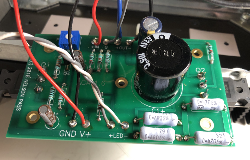

Here is a stupid question that I have looked all over for, and the feedback is too general for me to act. Also, the ACA 1.6 build guide is extremely vague.
Which are the positive and negative leads on the C1 Cap? There is a Neg marker on the label but it is offset. Also one of the leads has a stamp that means something.
Unless I am missing something, which is highly possible, this is a really severe oversight in the build guide not to clearly (REALLY CLEARLY) let the person tell which lead is which. The other Caps are no problem - long lead is positive.

The wrapper identifying the negative on a large cap should not be offset enough to cause confusion... maybe a picture of your actual cap might help.
C1 Positive and Negative
Thanks so much. This solved it for me.
