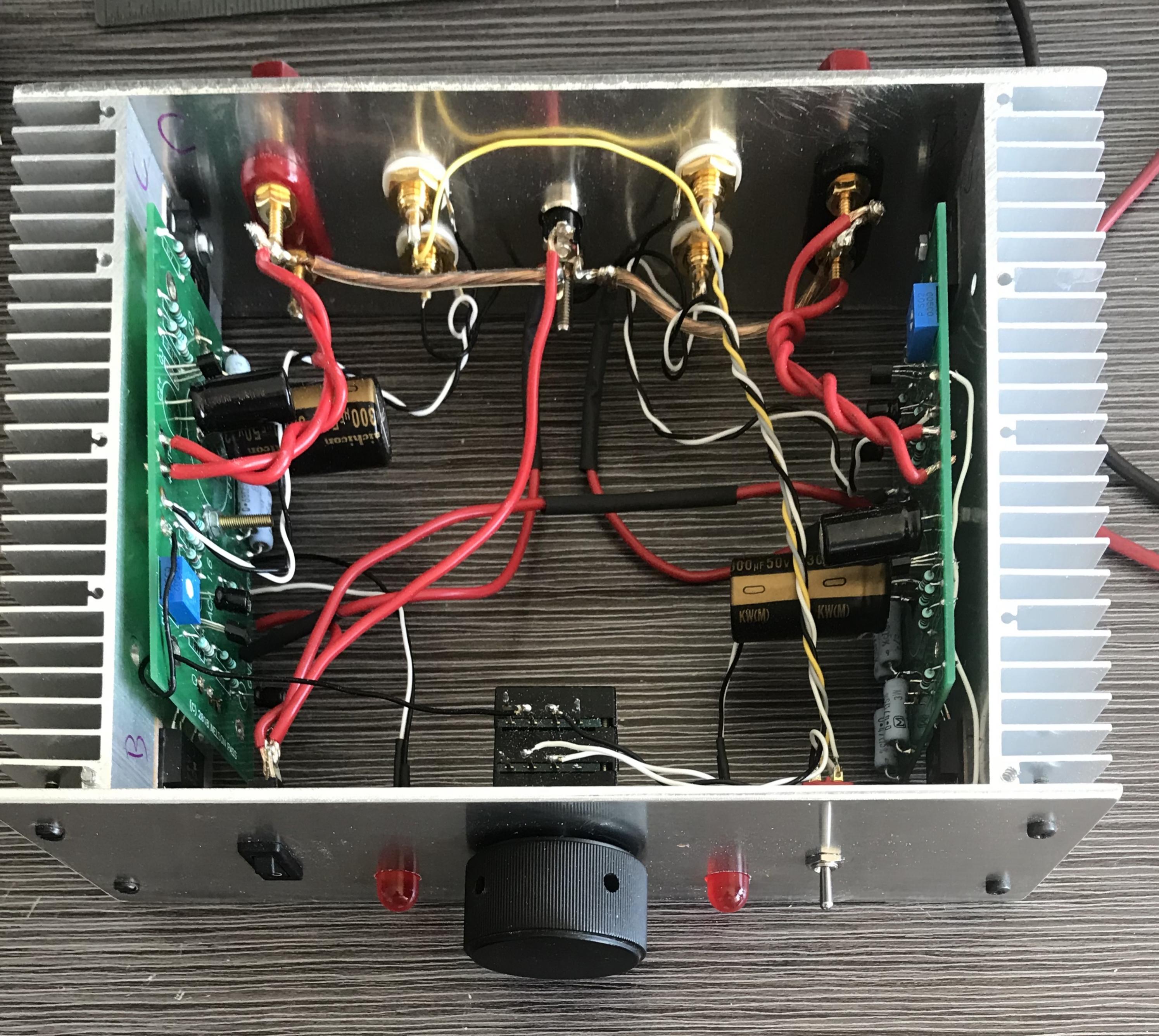

The kit was sold out, so I gave it a go bareback buying the boards and 2SK170 from the store, the other components from Digi-Key and heatsinks and aluminum plate off eBay.
I have experience building tube gear, but this is my first solid state build.
And not so good so far.
It is making a small muffled distorted sound at full volume (preamp and amp pot). I am driving it with a tube preamp I built. The preamp line level out is about a CD player's 2V. I recall reading that ACA 1.6 has a 1.73V input sensitivity.
At that sensitivity, I figured I could just put a pot on it.
The voltages are all pretty much in spec.
The RCA 2 inputs through a toggle to the boards and returns check out fine.
But the positive speaker post (wired to ground on power jack and boards) AND the negative posts are a short circuit to ground. Does that make sense.
And yes, this sucker runs hot and I figure my heatsinks are undersized.
Any thoughts while I check the resistances?

Sounds like you have the outputs shorted... you're not the first.
Check you have about 1k ohms between the red and black speaker sockets.
Lift those 'clear' wires off the red terminals. Then check.
The outputs on the board are confusing unless you match them to the circuit diagram. The OUT + goes to ground (GND) and the OUT - is 'free' floating.
Yes way too small heatsinking. Twice as much at least or fit a fan? And it still has to dissipate 2 x 36 watts so does get hot.
